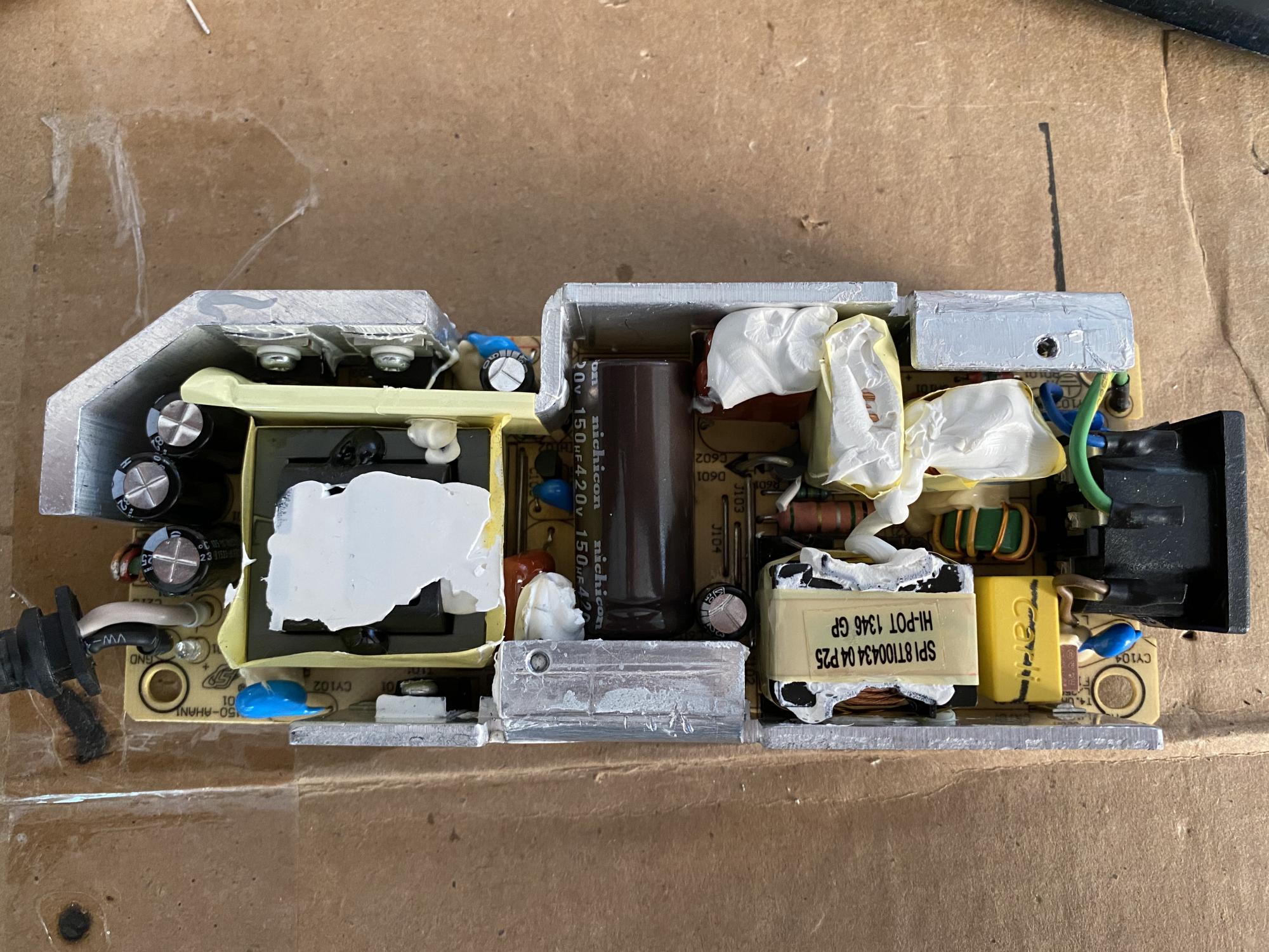

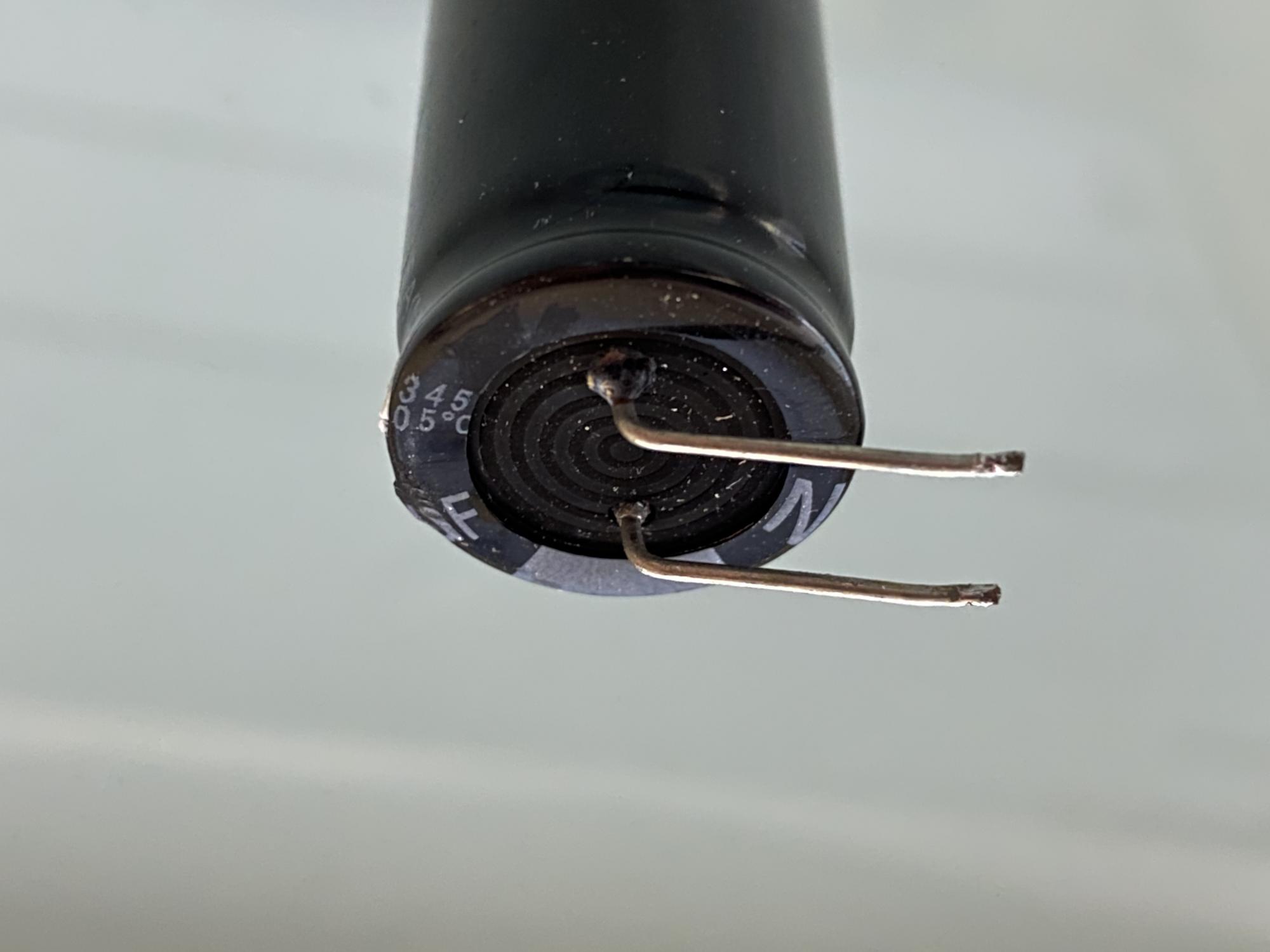

    Hi all-

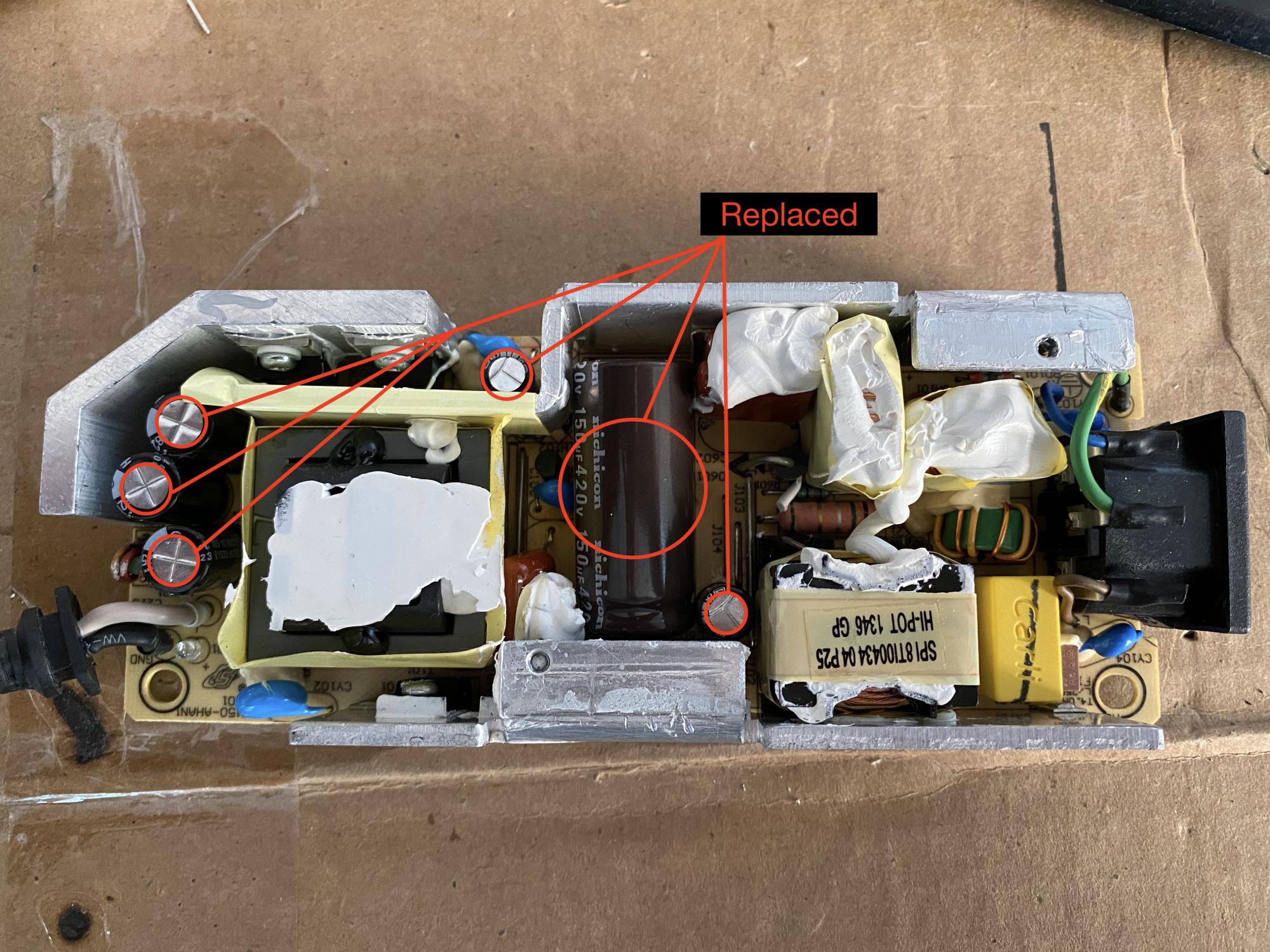

    I had a 12v 12.5A external power adapter fail the other night after being powered continuously for 6-8 years. I've replaced a few capacitors in other projects now, so I decided to replace the 6 obvious and large caps on the board, but this didn't fix the problem. I'm getting 0v out of the supply when powered up.
    When replacing the caps, I used same spec replacements:
    1. 25v 820uF x3
    2. 35v 220uF
    3. 25v 330uF
    4. 420volts 150uF
    Any help in further troubleshooting would be greatly appreciated. Pics of the board are attached.

                While I'm setting up another order, any other components I should consider replacing? I strongly suspect that the large cap was the culprit as it had some small leakage on one leg.

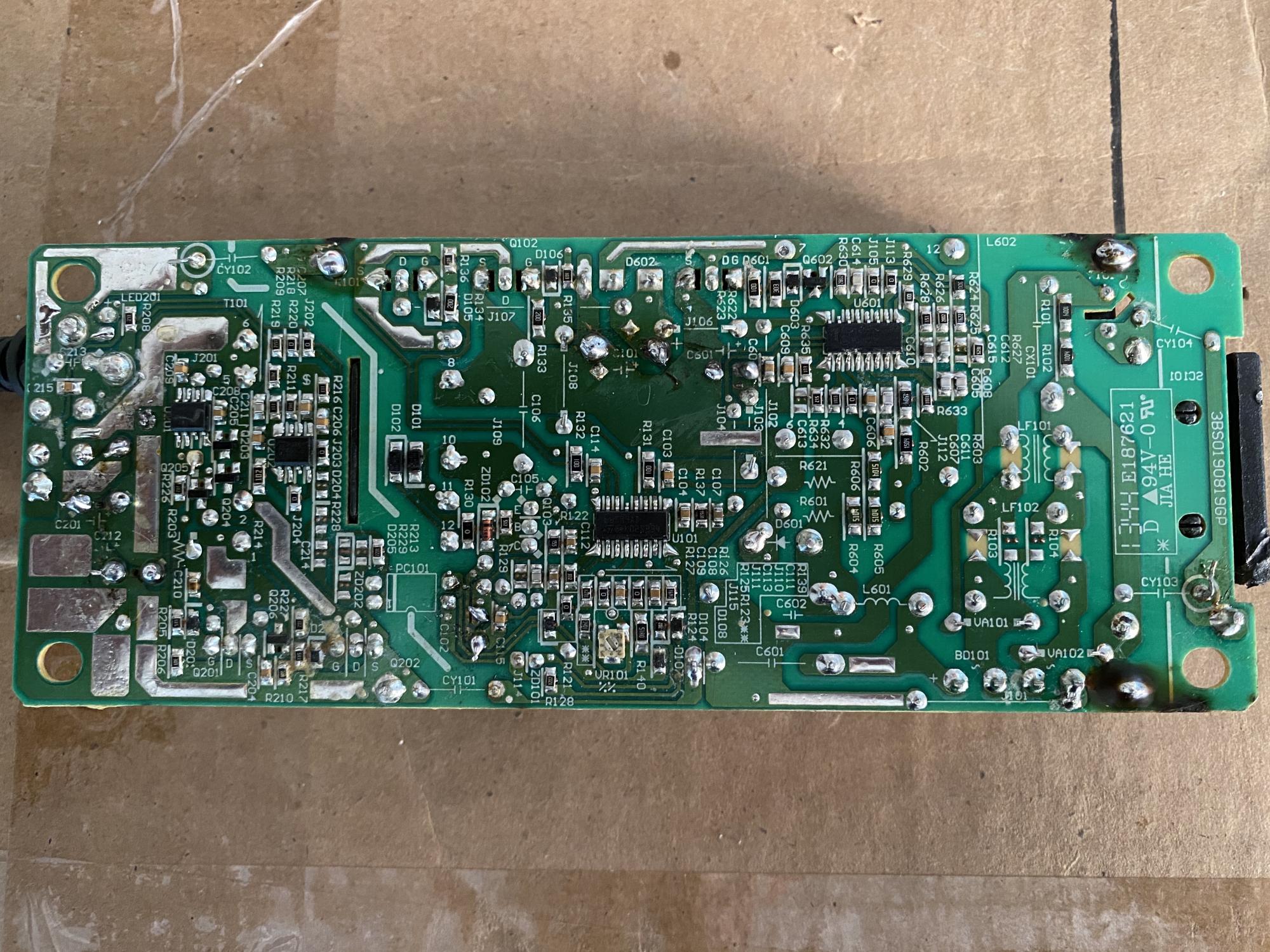

                    Re: Troubleshooting External Power Supply
                    Can you help me locate the bridge rectifier on this board? I'm not seeing the 4 diode configuration, although the LF102 appears to be square..?
                    (This might be going beyond my ability to repair.)
                    • petehall347
                      • Jan 2015
                      • 4434
                      • United Kingdom
                      on your pic of underside of the board rectifier is bottom right . 4 pins .

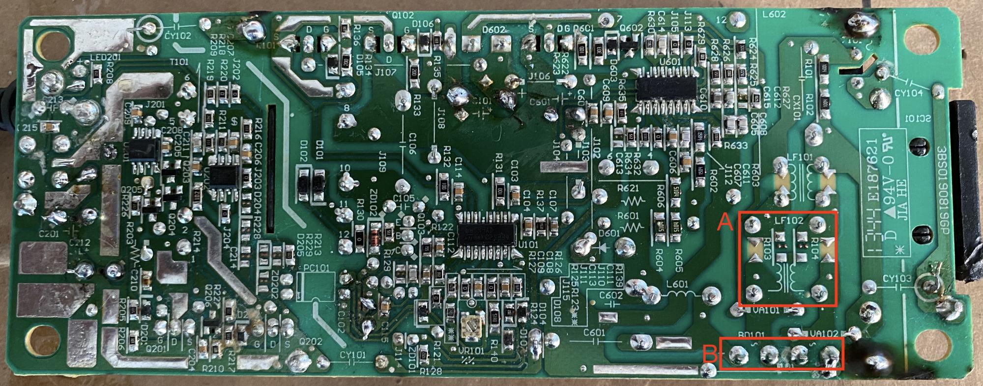

                        Square "A" or Rectangle "B"?
                        • diif
                          • Feb 2014
                          • 6978
                          • England
                          Rectangle B, This video will show you how to test it. https://www.youtube.com/watch?v=dqkT6hF0O3E
                            https://www.badcaps.net/forum/attach...9&d=1584303207
                            Check the resistance between S and D pin of the PFC MOSFET Q601 to see if it shows really low resistance reading or not.

                              If the fet and bridge rectifier check ok, I know If the main cap is bad (as in open) this will blow the main fuse. So it might be that all that is wrong IS the main filter.
