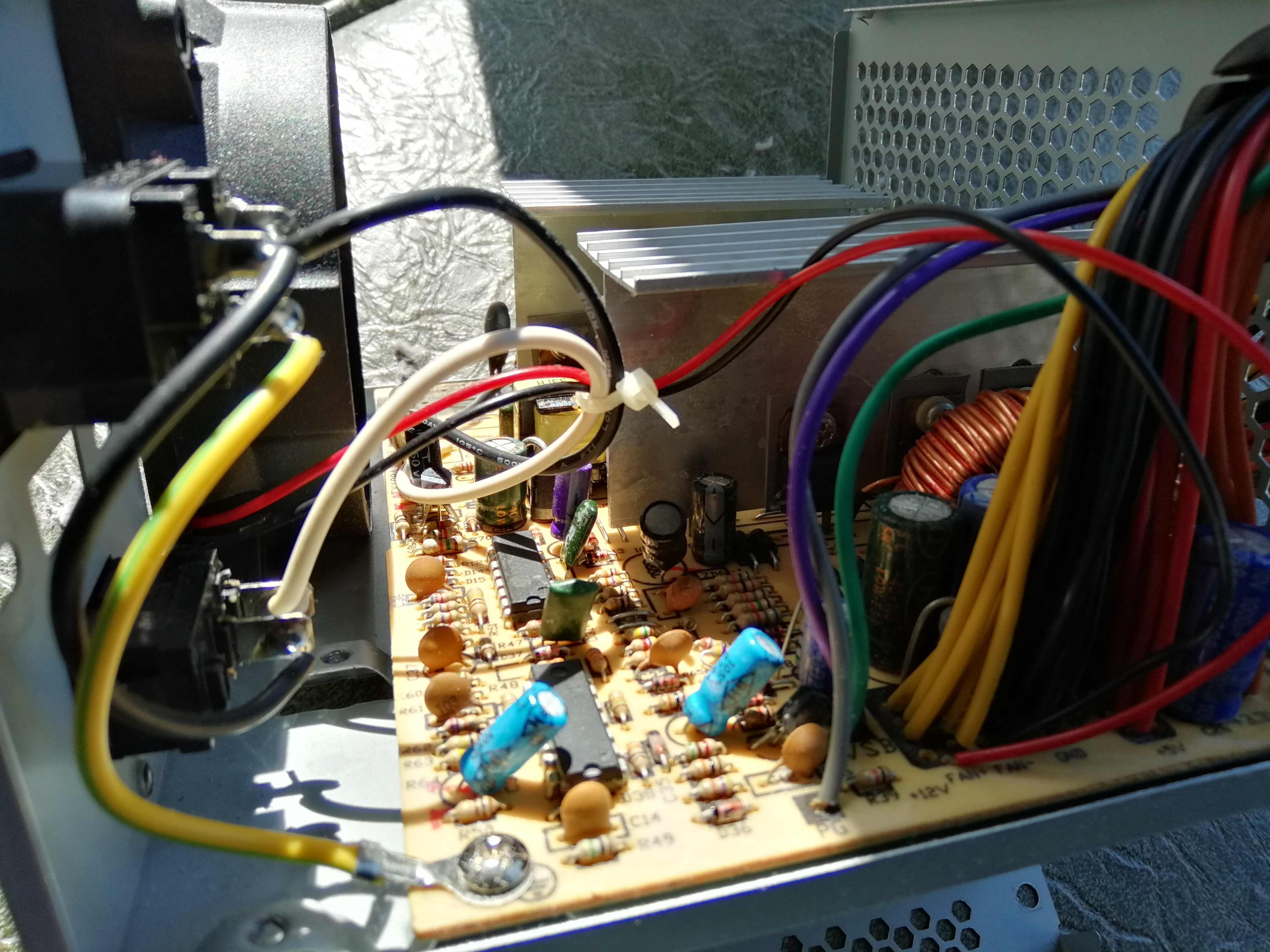

    Hi, this is for troubleshooting and, hopefully, repairing a Delta Power psu
    that is still quite new, as it worked OK for some months until it failed.
    At the time I was not into power supply electronics; it was put
    aside and a new power supply installed inside the computer. Also at the time
    power supplies were half the price of today's.

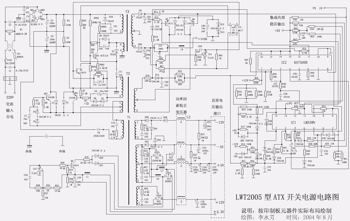

    On the PCB there are a D339 and 7500B chips.
    I have found that schematics with these 2 chips (see included file).
    Does it represent the actual circuit of the MAX-500ATX, I cannot tell.
    Some measurements, but first: In my country power is 120 V. / 60 Hz.
    V standby is OK at 5.0x volts
    On the high voltage rectifier diodes I read +166 and -166 V.
    On the high voltage heatsink measure is -166 V.

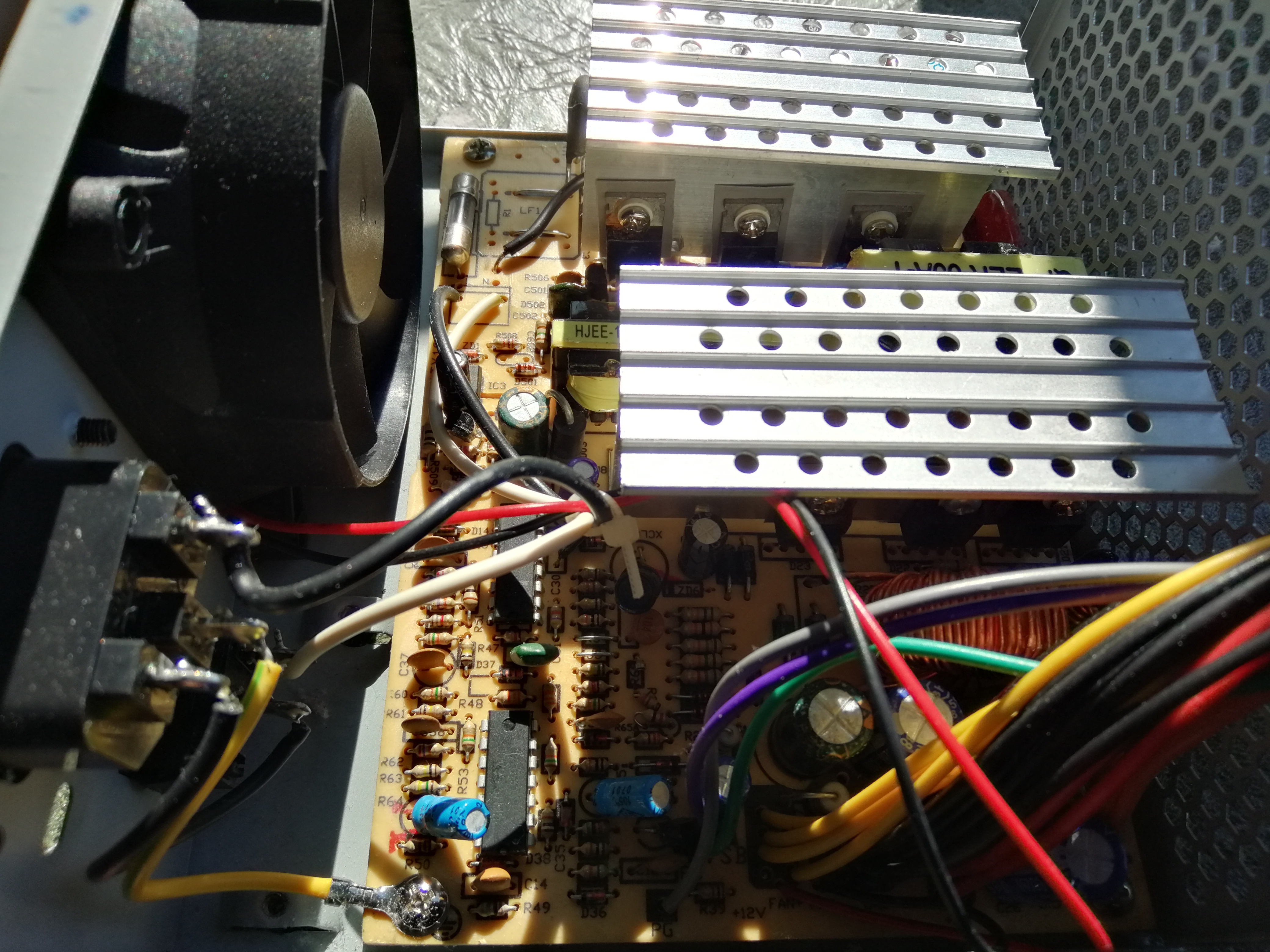

    So far so good. But there is no "good" anymore. No 12 V., no 5 V.,
    no 3.3 V.
    Inside the power supply box itself there is no apparent sign of
    burnt/defective part (see photo included).
    To debug that circuit what would be the next measurements ?
    ​Thanks for your time and interest.

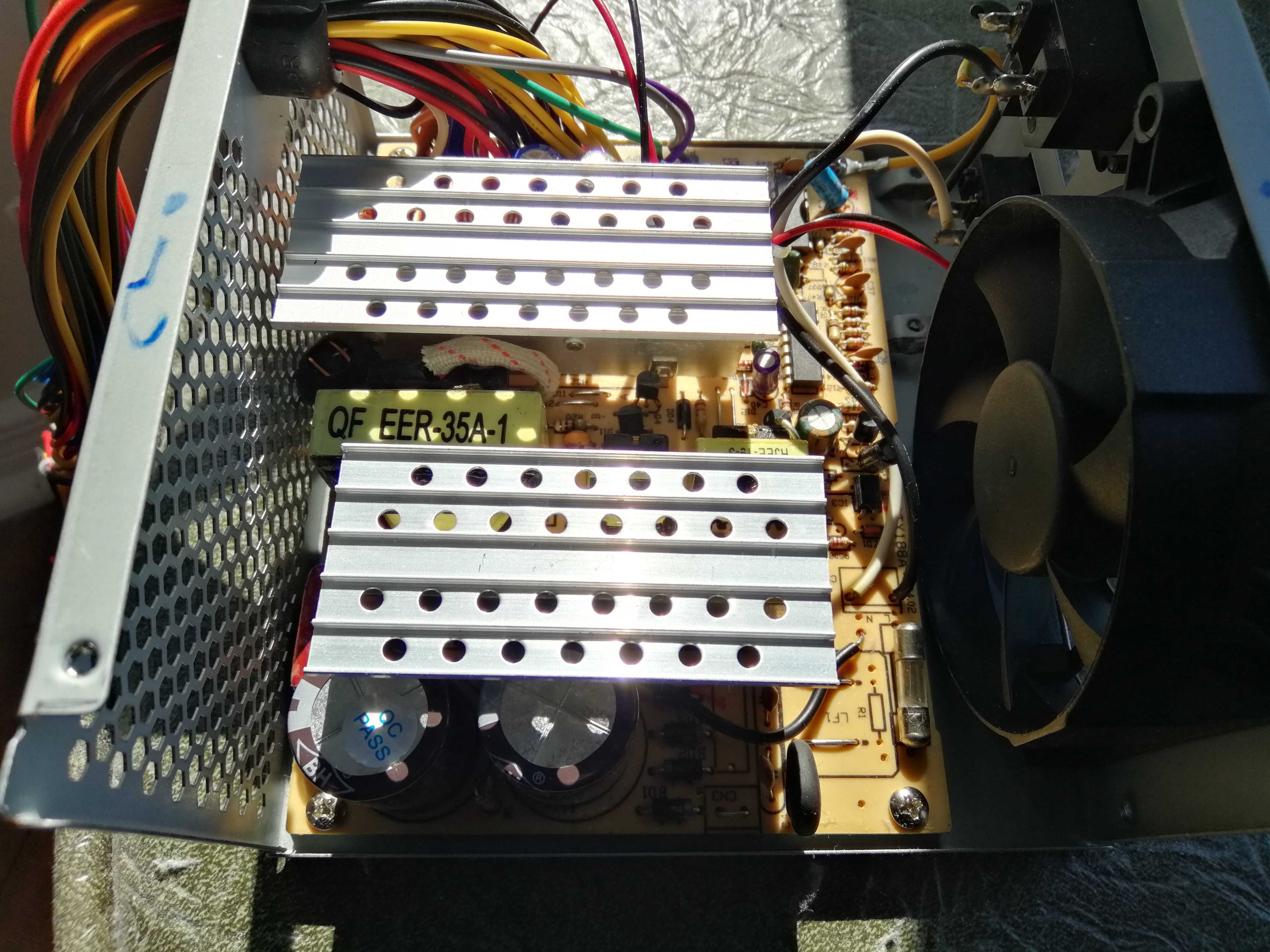

        What is resistance of 12, 5 and 3v3 output?
        If you find it shorted, look the diode on secondary side, often fails.
        If it is not shorts then for any reason switching do not work, maybe faulty mosfet or failure of poweron signal circuit, or drivers.
        Regardless to Delta, I think that all of them have mandatory their logo on pcb board.
        The heatsink looks so thin...

          Hi, @stj: the voltage switch has been removed and a jumper wire soldered on the pcb for the 120 V. selection.
          Here are power transistor voltages on the high-voltage heat sink.
          In front of these transistors, from left to right:
          Q1-Pin 1: -163 V.
          Q1-Pin 2: +163 V.
          Q1-Pin 3: -163 V.
          Q2-Pin 1: 0 V.
          Q2-Pin 2: +163 V.
          Q2-Pin 3: 0 V. (connected to Q3-Pin 2)
          Q3-Pin 1: -163 V.
          Q3-Pin 2: 0 V. (connected to Q2-Pin 3)
          Q3-Pin 3: -163 V.
          Heat sink vltage: -163 V.

            Hi, harp : With power supply not connected to 120 V., resistance to ground is:
            for 12 V. : 230 ohms
            for 5 V. : 22 ohms
            for 3.3 V. : 15 ohms
            Hoping this will help somewhat.

              It looks ok, I have simmilar atx 450w with 12v/250R, 5v/25.5R and 3.3v/25.0R...
              Ok, offline check first:
              - main mosfet, to confirm thre is no short on them
              - 7500 and 339, check supply rail to this chip there is no short
              Online mains check, with 60w current limit bulb in series:
              -can you describe exactly whats going on output when it is connected to mains
              -fan spins, a even little?
              -if you grounded power-on is something changes? Is steady 0.00v or fluctating from where to where?
              So you say (purple) standby 5v is ok, what is voltage on green wire?
              - voltages on both IC supply pin, is steady, fluctating...?
              What dmm you have, can you measure whats going on gate of mosfet?

                As dmill89​ pointed out above, that is not a Delta Electronics//Delta Products power supply. Delta would not use wimpy heatsinks like that for a 500W power supply, and probably not even for a 250W unit. Delta doesn't install jumper wires where common mode inductors belong. Delta would NEVER use 1KV DC or 2KV DC ceramic caps instead of agency-approved Y-caps! Never!!! That output filter section is pretty pathetic. The input rectifiers are pretty small, and the output transformer core would not be good for much over 250W. I would not apply power to the thing without removing those unsafe caps in the Y-cap locations, but I think the 200-250 W estimate above is probably correct.
                The 7500B is a clone of the venerable TL494. It's a decent enough voltage mode PWM, but Delta Products uses 384x series current mode PWMs or custom ASICs in its consumer-grade power supplies. The venerable LM339 is a very decent quad comparator, but Delta uses ASIC or dedicated supervisor ICs.
                Do each of the input electrolytics have ~165V across them? Or about half that. If the latter is the case, then voltage doubler is not working or the jumper you think hard-wires it does something else.

                  Yesterday while I was doing some measurements a small wire fell on the PCB.
                  Result: 2 resistors 1/8 watt are broken and the 5 V. standby is gone. To repair
                  I need a schematics. The included "DeltaPower_MAX-500ATX_Schematics.png"
                  in my initial message at first seemed OK but now I need precision and something
                  doesn't work in the schematics resistors around the 2 ICs compared with the
                  MAX-500ATX psu.
                  If KA7500B is a clone of the TL494 then I will search schematics with TL494 + LM339.
                  This is the situation for now and I continue my detective work on this.

                    Hi, this is an update about that Delta Power MAX 500ATX project.
                    After searching on internet I realised I could not find the exact schematics needed. Some "seem" to have
                    the same exact topology and same parts but, looking more attentively, many parts are not identified.
                    Others are well documented but the topology/circuit itself is not the same.
                    Then I tought why not remove/unsolder the resistors, capacitors etc. and after that build a new PSU from an
                    exact schematics that I have found. Anyway I cannot repair the actual Delta Power, what choice do I have ?
