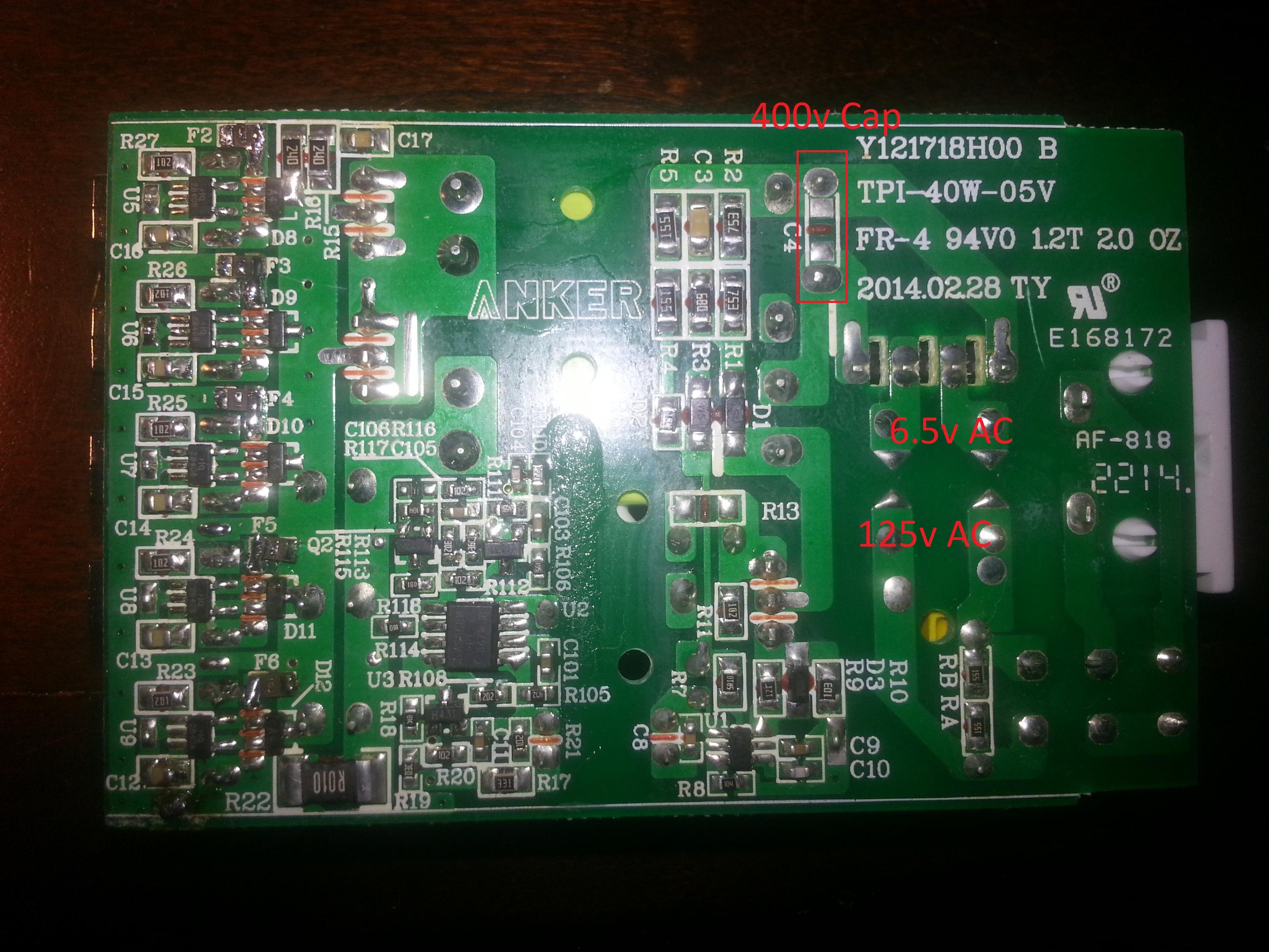

    Anyway, usb charger is dead, it won't charge anything. It seems to be something on the high side. Here is what I have done so far.
    Removed main transformer to remove the low side from the equation.
    Swapped rectifier with a known working one. The original seemed to test ok with diode mode on my meter.
    Tested high side mosfet on my lcr-4. Checked ok.
    Tested high side diodes on board with main transformer out. Checked ok.
    Checked high side cap on lcr-4. Was 10% less than label.
    Here's what I observe. With the main transformer, and high side mosfet out, I see 125v AC going into the toroidal transformer (I think that's what it is) that is right before the rectifier. Coming out, I get around 6.5v. On a known working model, it's around 160v-180v AC(can't remember exactly). On the bad model, with the rectifier out, it measures 160-180v. So the toroidal transformer is ok. With a known good rectifier on the bad board, it still measures 6.5v. I have left it plugged in for a while and checked for heat (unplugged), but nothing seems hot. I labeled in the picture where I am measuring.
    Anyone have an idea?

    Dose this switching power supply have a ic chip that is a switching power regulator
    You will have to look up the ic chip numbers to figure out which it is now more than likely it is on the hot side of the board
    I can find it with the picture that you posted
    What is the voltage on the optic sensor ic chip on a good one and what is the voltage on the one that does not work correctly

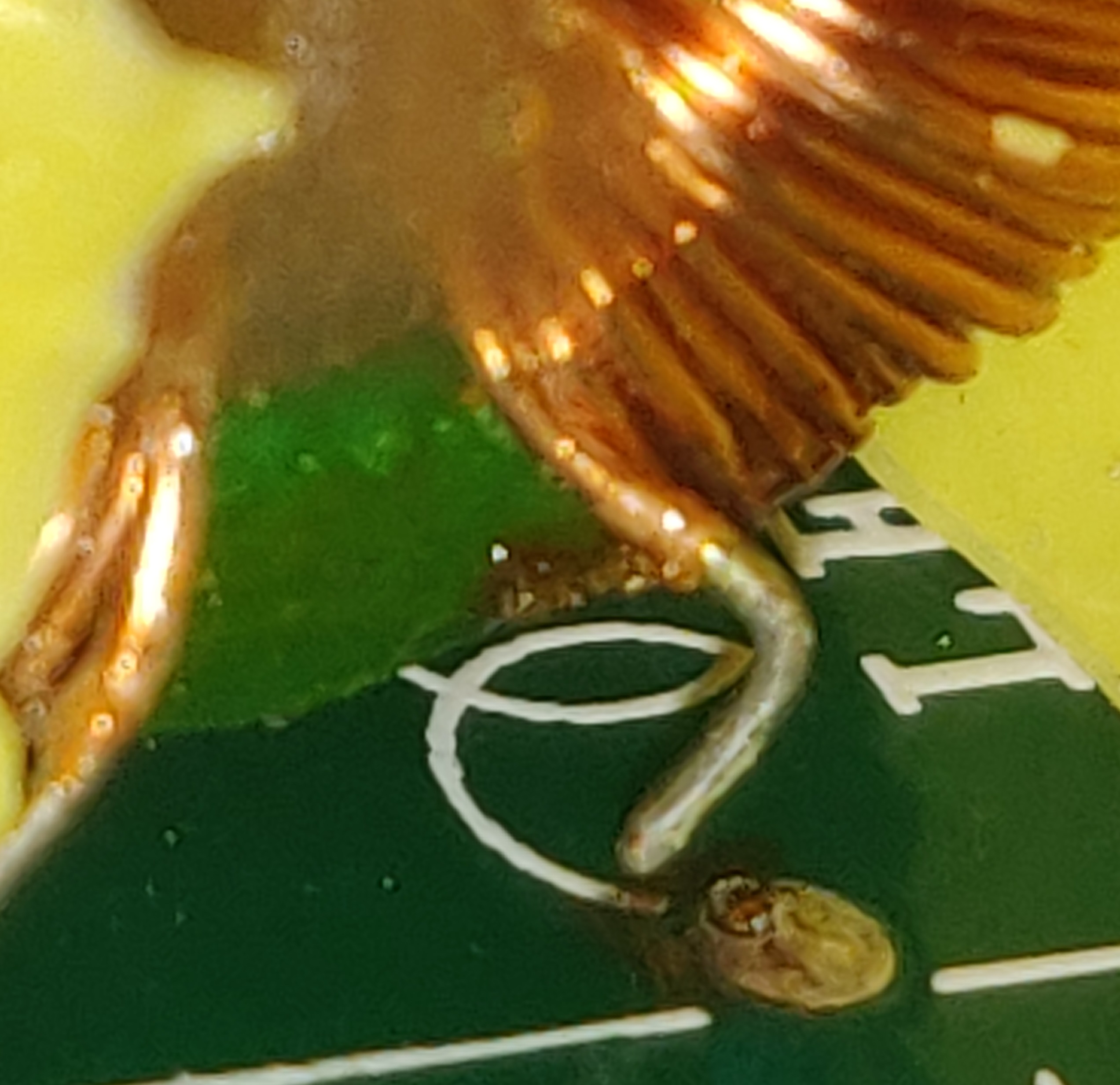

      Something just didn't smell right in my testing. Turns out one of my probes was going intermittent. Once I used a new set of probes, I was able to chase it down to this. I'm surprised I was even seeing 6-9v with one of the legs on the toroidal transformer broken off.
      I resoldered it, but haven't tested it yet. This looks pretty conclusive though unless I broke it during disassembly.

        You could have but from this picture I kind-a doubt it looks to me either a bad soldering joint that broke loose or could broke when you took apart but if this is case why did it not tare the trace apart

          It looks like poor solder works to me, probably that is all wrong with it, I would re-solder all 4 legs of that TOROID, I would also do the same on the other TOROID and the transformer legs as well, just use flux and new lead solder.

            Well, the wire actually broke, the other end of the wire was sticking out the opposite side of the board. The toroid was glued in place, but it was probably dropped a few too many times, and the wire broke. This was my wife's travel charger, so I'm sure it was jostled a bit, one too many times apparently. Or it was nicked during installation, and just fully fractured over time. The bend in the wire is pretty strange, that's how I found it.
            I reassembled it and tested it, all is good now, so that also eliminates the possibility of my breaking it when I took it apart.
            Thanks everyone, the charger lives on!
