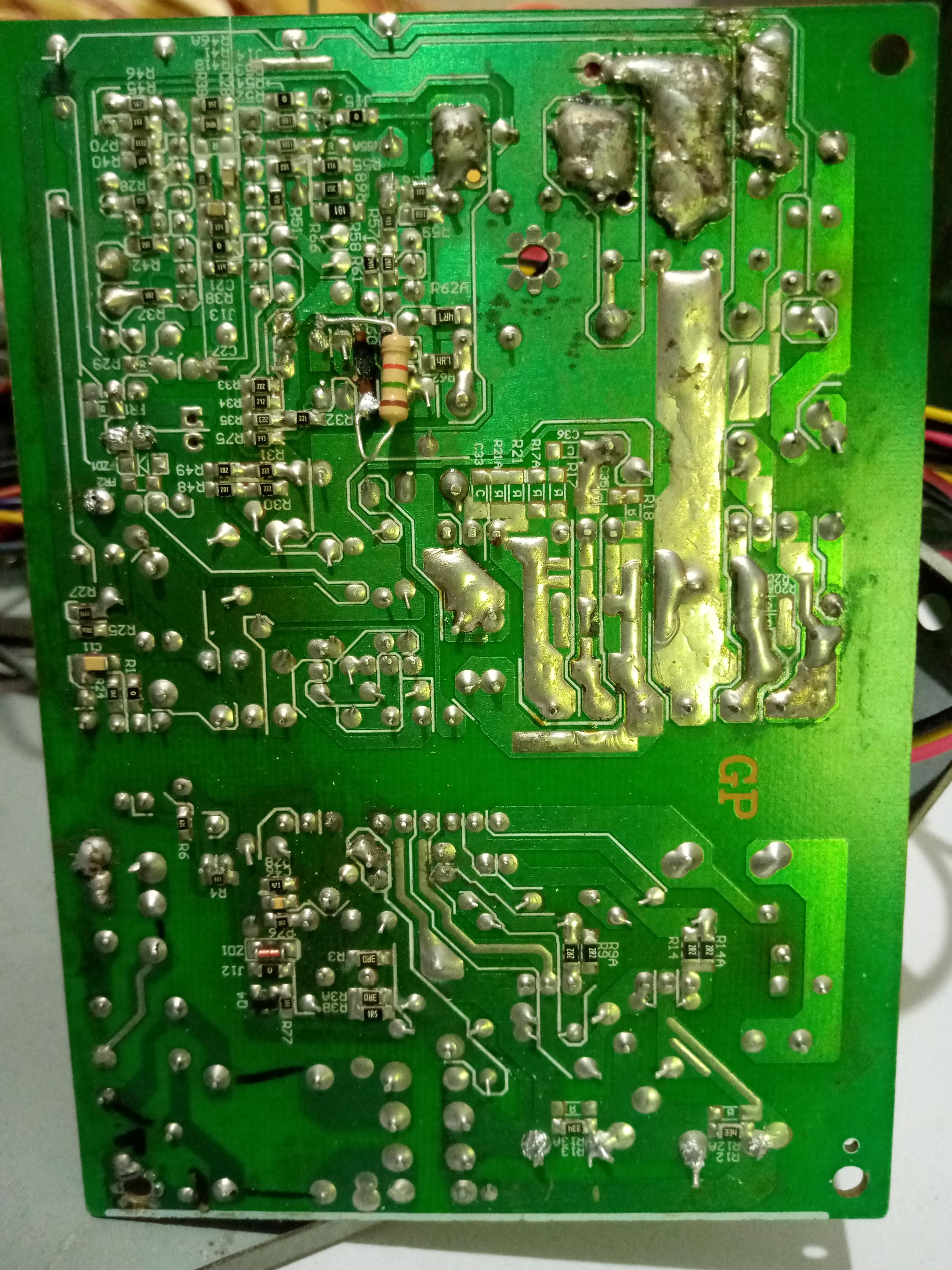

      hi RJ this is how it looks now.. i tried my best to put the resistor on R23 and to the jumper ,as no pads are there,they got lifted and teared.. i am sorry i am asking too much.. please do reply when you have time,thanks
      • playit
        • Feb 2020
        • 182
        • india
        #43
        Re: mercury pc power supply only 5vsb supply.
        oh you replied i dint see it, transmitter game me one continuous beep ,also there is another problem now..the circuit slided and fell 2 times ,then no power came to board,no 5vsb,then i tried to switch on from back,the switch clip was broken loose,now i will get it ,and try again for the voltages.. is there anything else i should try checking again before i list components to be bought ?
        also i found one of the 4148 zener diode(in pairs) was dead-no reading ,it was at place of R23. i replaced with ph4148

          A 1n4148 is not a zener diode, When checking a transistor or diode with diode test, a silicone junction usually reads about .6xx in diode test. (this number is the voltage drop across the junction) meters with continuity "BEEP" will beep betwen 0 and 150Ω.

            in the mean time..i will test the diodes ,transistors again,i have an doubt are R23- R32- jumper are connected someway in the middle,i see a little copper head there,
            also i want to ask you about this pair 4148 zeners, the pair which is d25,d29. i get reading when i touch negative of d25 and positive of d29 ,as if they working in pairs, but i dont get the same reading for zeners pair near R23 like working in double,but ok when i measure single

                  yes they give readings when read together, but the d9-d10 doesnt give reading like that.. did i fix it wrong... d9 was the one dint give any reading,i removed it and replaced it with ph4148
                  also could you please compare the old and new R23 areas.. i doubt the jumper/R23/d9 was together soldered ???

                        d10 positive has continuity with the copper foil near the junction..i tested the continuity,so according to old pic in which i dint rip off .. are these junction/d10 4148 positive/resistor all soldered together?

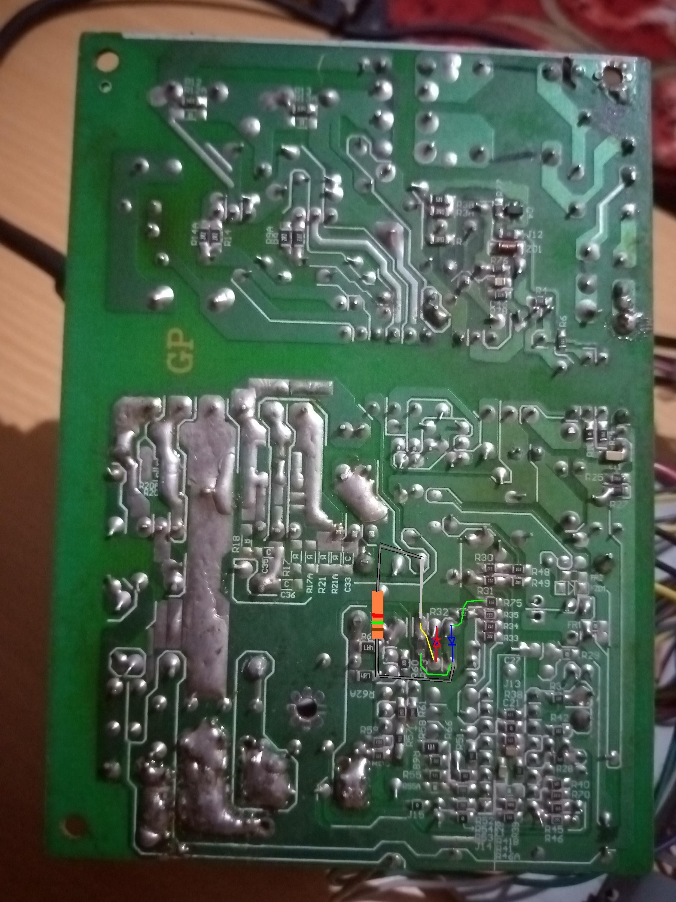

                          should d9 and d10 to be soldered or shorted in someway..
                          what could be the reason for not getting 16 v or any voltage at other side of the resistor.. any idea how the circuit joins with 2 x 4148 and a resistor.. ? i tried to google it..not much help there..

                            This is how the trace should be. and this is how to connect that 1.5k resistor. You need to connect the RED diode anode to the grey jumper wire (yellow trace)
                            One end of the resistor can connect to the jumper wire and the otherend to the blue diode cathode.
                            Your R23 should be the same as R24 on the schematic

                              thank you for replying.. i will do it.. after doing it what voltage should i expect on the other side of resistor ? and i am confused whether i really saw 2 4148 diodes ? is that correct there would be 2 4148 there or i am mistaken for some other diodes ?

                                  There are lots of 1N4148 diodes in this power supply, Plese look at the schematic and you will see they are used everywhere. The two diodes (D9,D10) are likely the same as D10 and D15 on the schematic.
                                  On one side of R23 you should have 16v on the other side it could be around 10~12 volts?
