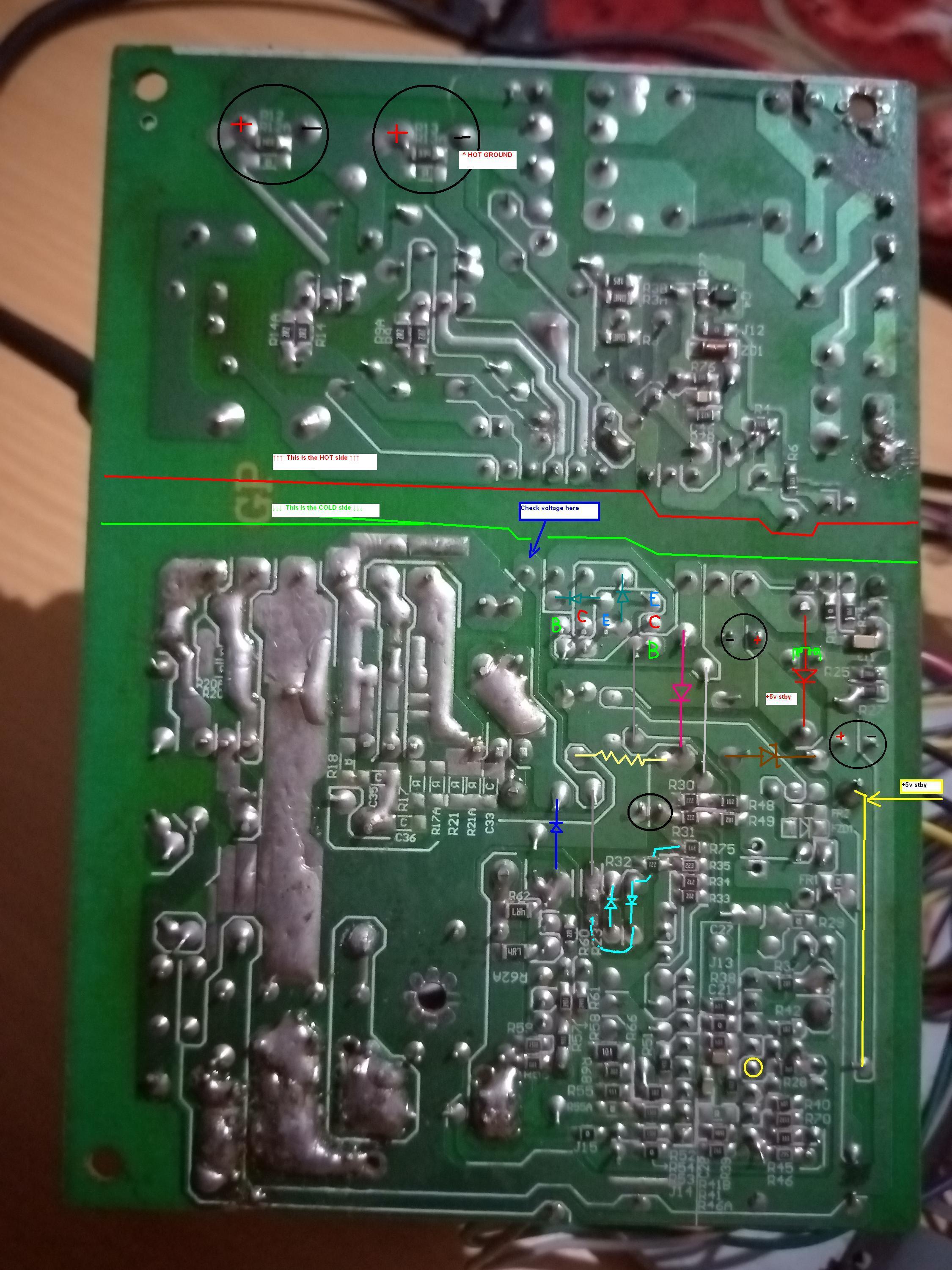

    oh thers a mistake in my post 19.i misunderstood the both sides wrong and i tested one of r32 which showed 16v, and by the way.. only one side of r23 shows 16v and 0.6 v at other side of r23 which connects with jumper.
    • R_J
      • Jun 2012
      • 9607
      Re: mercury pc power supply only 5vsb supply.
      Then R23 is open, I don't know what it's value would be, it might be a 1.5k ½watt. I checked a couple schematics and they both used a 1K in that position. Before replacing it, Check the two diodes on the other side of of the board of R23. Also check the two transistors and the 2 diodes that are connected to that drive transformer.
          Check the parts with power disconnected. check that none of the parts are shorted.
          Check the diodes and transistors using diode test on your meter, The reading is usually around .6xx for a diode one way and open the other way. for the transistors check them from base to collector and base to emitter, then reverse the leads and repeat the test, then check between collector and emitter (this should check open)
              All those components are likely ok, I ment to check the diodes I marked green and the transistors on the drive transformer, if those transistor readings were for those transistors, they are likely ok. I would try replacing that R23 with a 1.5K and see what happens.

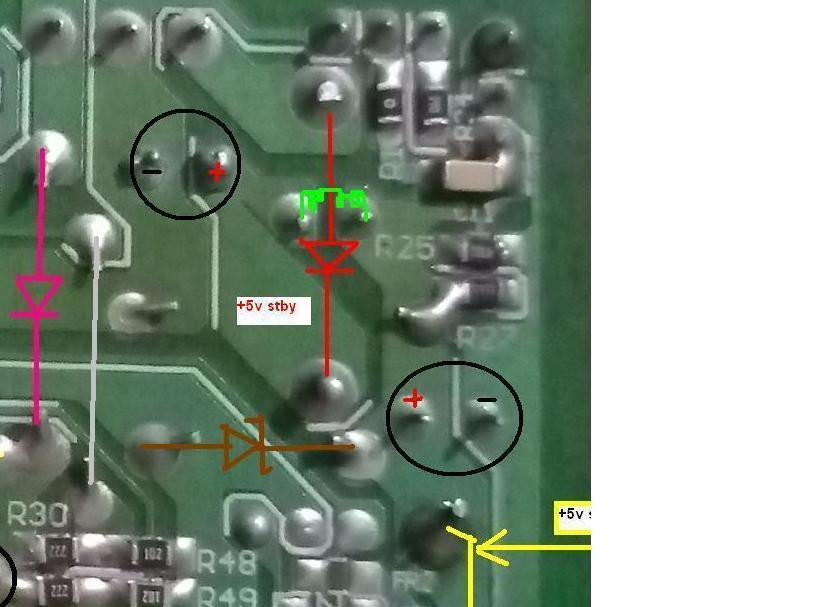

                oh ok , will get the resister after few hours here and the diodes reading marked in green-- horizontal zener diode- negative probe to positive- 520 and reversed 1072.
                vertical zener diode - -ve to +ve probe- 523 and reversed 1073,are they ok?
                • R_J
                  • Jun 2012
                  • 9607
                  There is only one zener diode that I marked, it is ok because you have +5 volts on it. The other diodes I marked are just regular glass diodes, likely 1N4148. there were two next to R23 and two next to the transistors (I marked EBC)

                    #29
                    i checked three orange diodes around that transistor(zener glass diodes i guess),they all gave readings similar to post #27, and the 2 orange diodes closer to r23 gives reading around 523 only when with negative to positive ,reverse gives no reading.

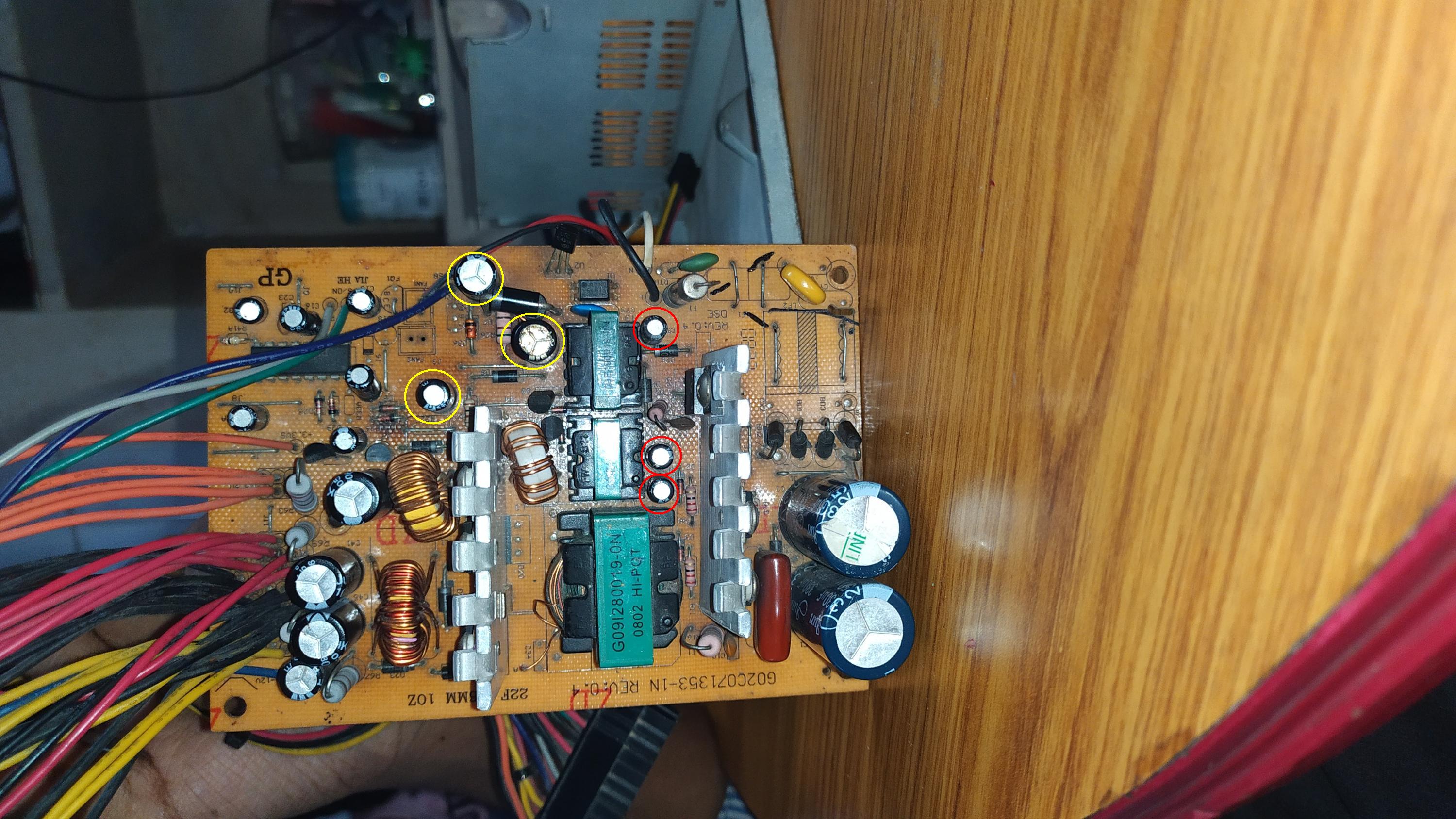

                        #31
                        Stop worrying about the Red and brown diodes I marked, They are ok, good, have no problem, are fine, not bad. If they were bad you would not have any 5 volt standby at all.
                        The diode I marked in pink checks fine also, it is supplying the 16 volts in standby that you measured on the one side of R23
                        I would replace the three caps (red circle) in the primary and the three in the secondary. this is a minimum, If the power supply works, then I would consider replacing all the small caps and maybe some of the larger ones. The small caps dry out fast and go open and don't usually leak or bulge so the get overlooked.
                          thank you ,nice explanation,tomorrow i am gona get the resister and caps too then,if incase needed,by the way.. at first when i opened -- this 16v 1000 microfarad capacitor was bulged ,so i thought to replace it,at shops nearby i dint get the right volts of the same type,so replaced it from a old dead motherboard..
                          at first i am not sure if mis-soldered the polarity..i swtiched it on-- the capacitor burst !
                          then i again took other capacitor and placed it..but anyway.as you said i will buy all those caps ,just wanted to let you know if it might help more.
                            Which capacitor did you replace that was bulged and that blew up after you replaced it? What was the voltage on the capacitor they gave you?
                            You should have mentioned this as it might point to other problems

                              #34
                              this 16v 1000 microfarad capacitor was bulged-- the capacitor you marked in yellow, the center one near the transformer. i wasnt sure if i soldered it in reverse polarity ,as i searched they said reverse polarity capacitor could burst so then i soldered the other capacitor (16v 1000 microfarad ) at correct polarity..then it dint burst .
                                That cap is only for the standby 5 volts, so it should be ok.
