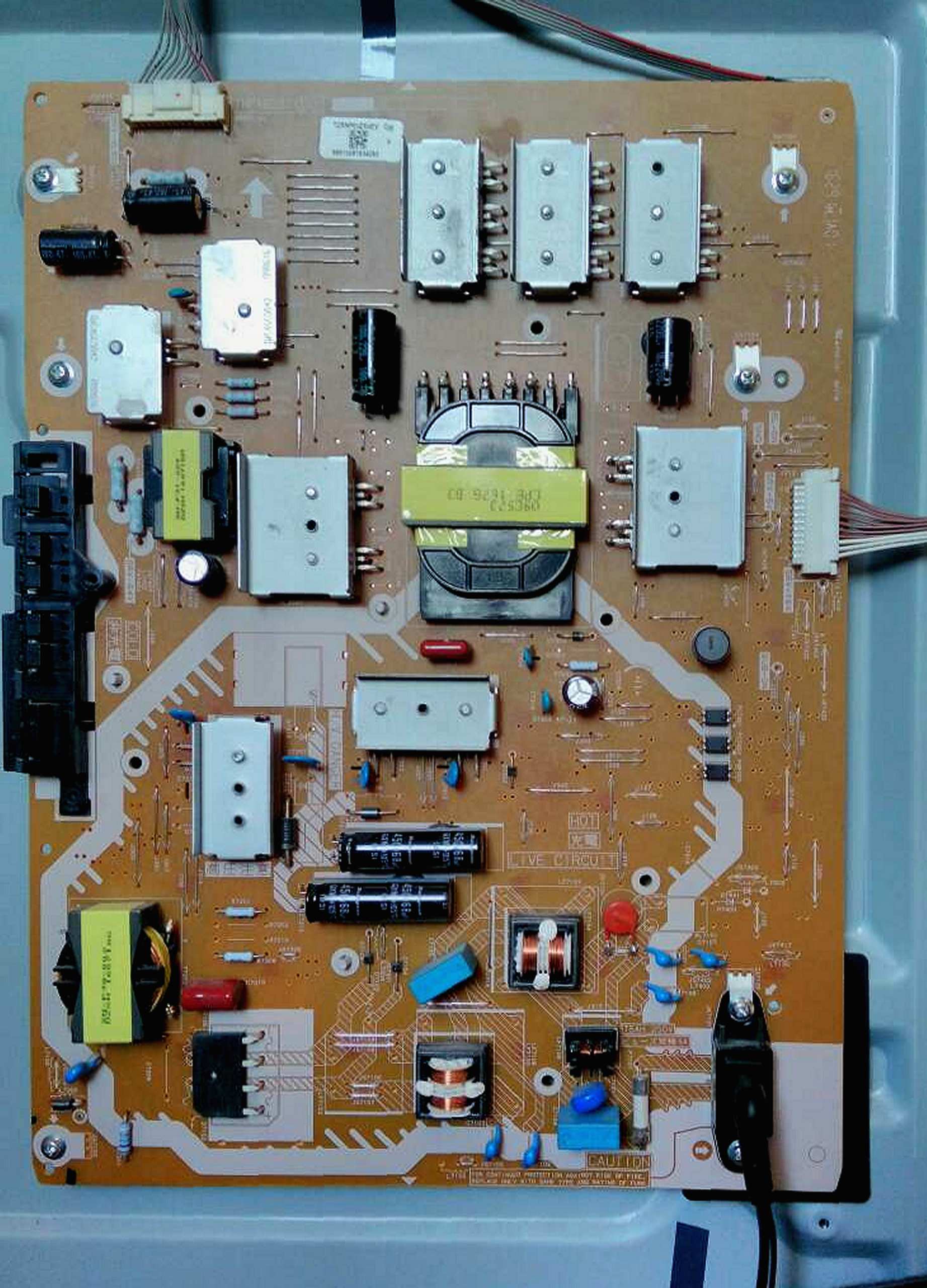

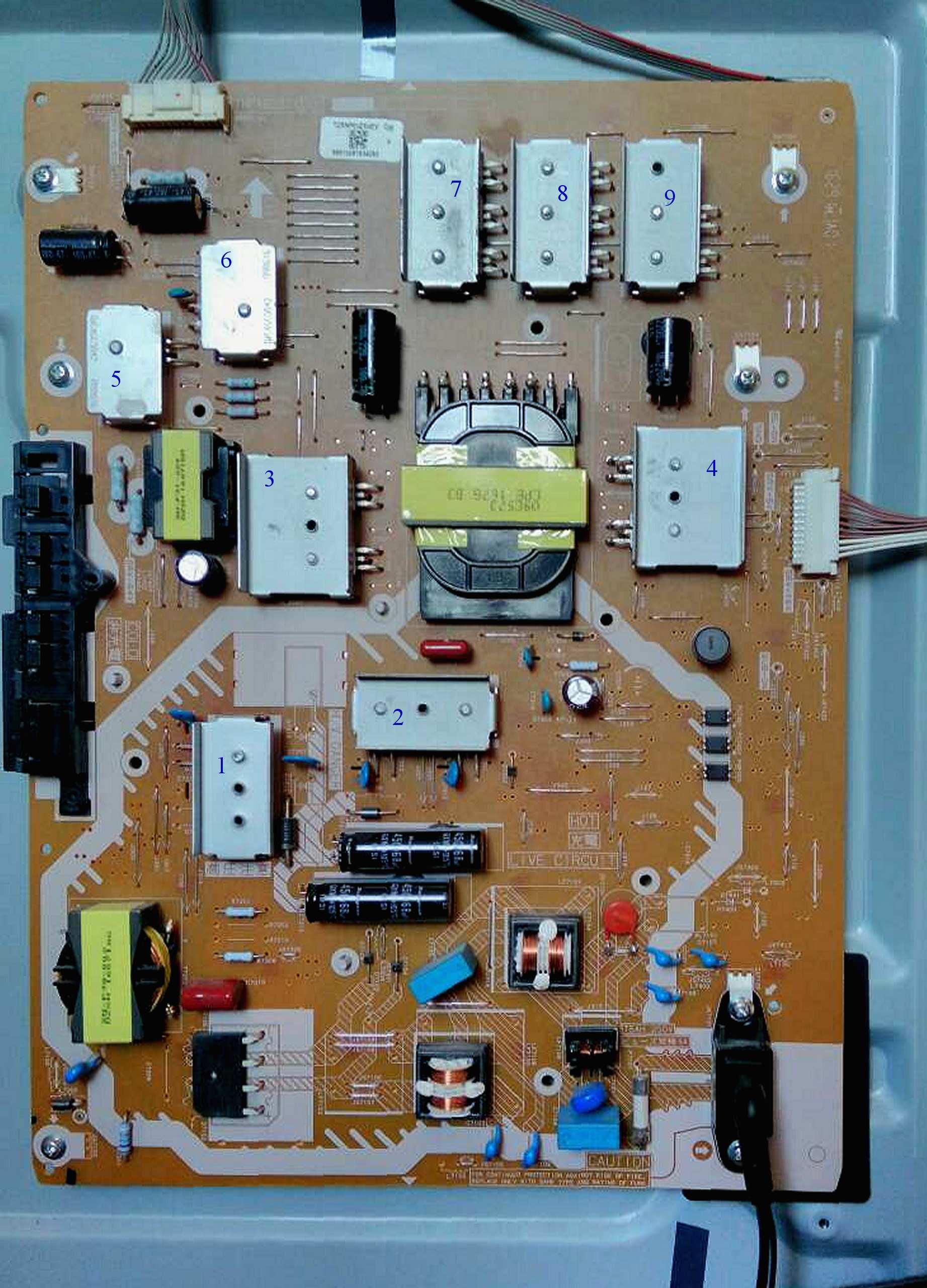

    Hi everyone, I have just acquired this Panasonic TX-49DX600B 4K HDTV, which is to all intents and purposes totally dead. There is no power LED, no picture or screen brightness, no sound, nor any response to the remote control.
    However, there is power on the TNPA6232 power board, mains in, high voltage on the main caps (450V, rising to 600 odd volts - and the caps are only rated at 450V!) and 80V rising to 100V and 18V rising to 24V on the top centre caps. Inititally, the voltages are at the lower figures, then after a minute or so, the higher voltages can be measured, but the TV still fails to show any signs, or respond to the remote control. I daren't leave it on very long, as the main caps will likely blow!
    Does anyone have any experience of these, any known/common failures, known voltages to check, or a circuit diagram? Any help much appreciated, thanks.

    Re: Panasonic TX-49DX600B Dead! TNPA6232 Power Board
    High voltage in bulk/main capacitor can be cause of something wrong in apfc section.
    Usually pfc controller ic.
    what is under the (white) heatsink?
      Hi Quaddro, I'm not sure which heatsink you mean, they are all metal and only look silver, or a bit white, depending on how the light is reflecting off of them. I have now numbered the heatsinks in this new photo though.
      However, all of the devices under the heatsinks are three-legged devices, so possibly the control device is on the main board? I would expect a contol IC to have at least four pins!

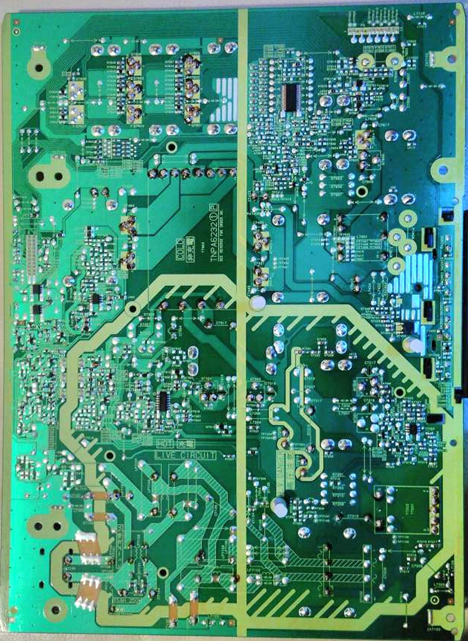

        It looks like the power control IC could be the small-ish one on the reverse side, near the middle. There's no sign of any blow-out damage, though it could of course just be malfunctioning, but without any voltages to check, this is just a guess. Anybody got any knowledge of these sets and boards before I just order a new power board and cross my fingers?
          What are you using for ground when measuring the primary caps voltage?
            Straight across the caps themselves.
              It could be your meter, some meters don't like the high frequency of the pfc circuit, have you checked if you have any of the standby voltages like SRV-5V
              Also what is the voltage on SUB_ON
              It could also be your meter battery is low causing the wrong voltage readings
                Thanks RJ. I don't think it's my meter, as I've not had problems like that with it before, but it could be that. As I'm measuring across the main caps themselves and because the voltages increase shortly after powering up, I think the voltages are correct, but I'll bear it in mind, as they are ridiculously high, even at first power up, if they are correct!
                I've not measured any other voltages yet, due to the worry of leaving it powered up for too long with such high voltages (maybe) across the primary caps.
                On closer inspection, I see that there are a few voltages marked, both on the power board and on the main/signals board, so I'll check them out in a while and will post what I find.

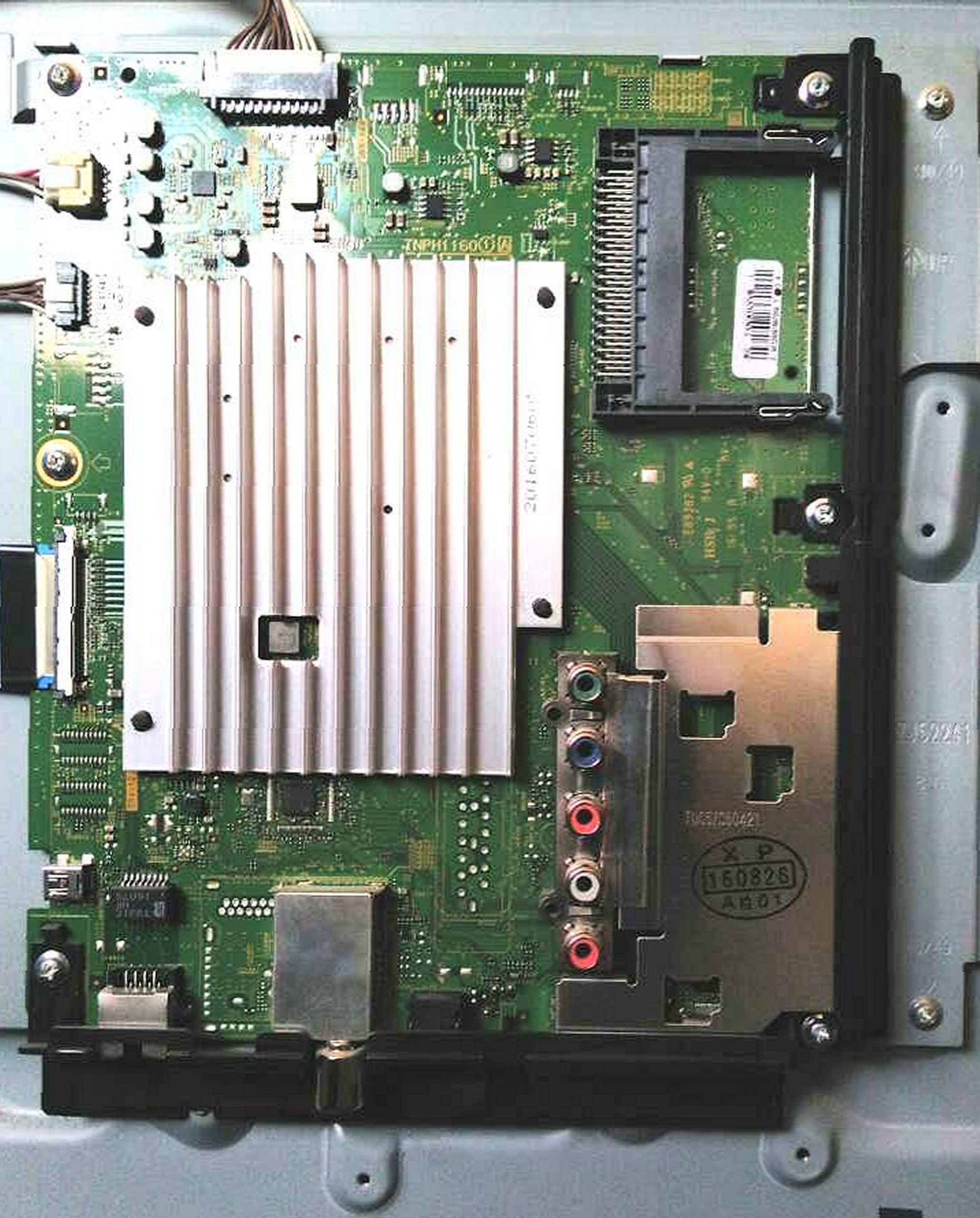

                          Well, I'm pretty convinced it's the main/signals board, it looks like the main processor chip IC8000 has failed - no 12V or SUB_ON outputs, whereas everything coming in looks OK. Only a new board now will prove if I'm right or not.
                          I did find a write-up (originally in Polish/translated: https://www.elektroda.pl/rtvforum/topic3623194.html) about one of these sets with a failed backlight causing no picture or sound, but that had a pulsing fault code on the TV Power LED (as it should do). Mine has nothing at all on the LED, totally black, despite the LED circuit having power, so I don't think that is very likely and I don't really want to pull the whole set apart to check it.
                          The problem is, the main boards are coded to work with specific screens, so I need a TNPH1160 with the TNX/A1LVVB code (marked with a sticker in the CA slot) and these seem to be impossible to find. There are some suppliers with them listed, but all the ones I've found are out of stock, so I've signed up for availability notifications, but until I can find one - at a reasonable price - I'm stuck. Anyone know where to get one from (there are none currently on ebay either)?

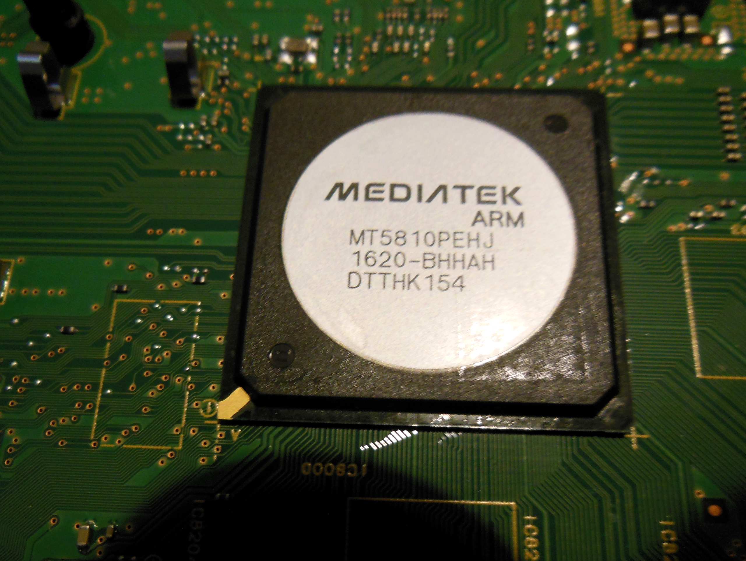

                                  Hi Diff, thanks for your interest and help. IC8000 is a Mediatek MT5810PEHJ (see photo). This is available for around £25 or so (not in this country though, as far as I can see), but as you say, this is not necessarily the actual cause of the problem anyway.
                                  You're right, this chip doesn't drop the 16V line to 12V itself, it switches it via another chip. According to the description, this is IC5500 (or IC5300 according to one of the drawings!). Having looked at the board very closely, many times though, there is no IC5500 or 5300, they just don't exist.
                                  The likely candidate is actually IC5704, an LD1117AG, which is a low-drop voltage regulator which is locate on the back of the board. I don’t know that this is the right chip, but there’s a chance that it is. I’ve not measured the voltages on this as yet (what with it being on the back of the board), but as all of the connections are on the left side, I should be able to find a way to prop the whole board out somehow to get to the back of it and do this. I'll give that a go tomorrow, if I have time.
                                    Right, having finally got round to measuring voltages around IC5704, it is clearly not the 12V regulator. However, I have found that this TV uses the LA64 chassis and have found a couple of circuit diagrams for other models that uses the same chassis ( and https://www.electronica-pt.com/esque...sis-la64-66216).
                                    Not exactly the right manuals, but good enough and I can see that IC 5260 is the 12V regulator on the main board. This has power coming in, but no control voltage from IC8000. As the SUB_ON also comes from IC8000 and is not changing and the Red LED output also comes from IC 8000 and is not coming on, I am even more convinced that this is the cause of the problem, especially as all other start-up voltages seem to be OK.
                                    Unfortunately, the correct main board for this model and screen is simply not available at the moment (not that I can find anyway), so it looks like I'm just going to have to wait until I can find one and hope that does indeed fix it.
                                      I finally managed to get a new main board for this TV and it has fixed it! I now have a brilliant, fully working TV. As far as I can tell, the fault was with IC8000, but I can't confirm that of course. The indications that it was faulty were the missing 12V line, no change of SUB_ON when pressing the on/off button and no indication whatsoever on the front Red LED. Hope this helps someone else and thanks for everyone's input.
