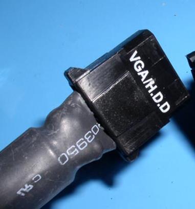

    Caps on the connectors
    Topower does this, puts little 100uf or so caps on the molex connectors
    Would it be worth doing on a rebuilt power supply that dosen't have enough filtering caps on the secondary? The trouble would be getting them in there, you would need a tool to remove the pins from the connectors.

    Re: Caps on the connectors
    What?
    That just looks too stupid IMO
    And very easy to knock the capacitor off, or worse short it, since as we know Molex connectors can be so stuck you need a V8 truck and a towing wire to pull them out!

        @Per Hansson, you put shrink wrap over it. That connector in that pic had it at one time, but it was peeled off to show the caps on the connector.

                  These are what they look like with the sleeving on them.

                    still could get damaged if some dumbass used pliers to remove a stuck plug. also, if one used a y cable then you could get problems.

                      If you have a small cap inside PSU does adding a 100uF make difference?
                      I think it is completely useless to add caps on connector: if you want to minimize ripple you have to put good caps close to the transformer/rectifier. Read some PSU application notes from ST, Onsemi, Unitrode, Fairchild, etc... all of them tell you to reduce current path between power element (transformer/rectifier/caps) to have good regulation, good performances and low ripple/noise.
                      Like Keri wrote: but wouldn't it be better just to get a good PSU?

                          but wouldnt having it right by the connector mean less interference?
                          Maybe... I'm not quite sure.
                          What do you mean with "interference"?
                          AFAIK every piece of hardware has his own input filter capacitor so if the voltage/power comes from a good PSU there's non need for extra cap.
                          Large capacitor reduce ripple and voltage fluctuation but if you want to reduce/eliminate spikes and high frequency noise you need MLCC.

                              Uh... isn't that 100 picofarads?

                                        Caps with that small a capacitance are there for EMI, not ripple, and from an engineering standpoint it's a great idea.
