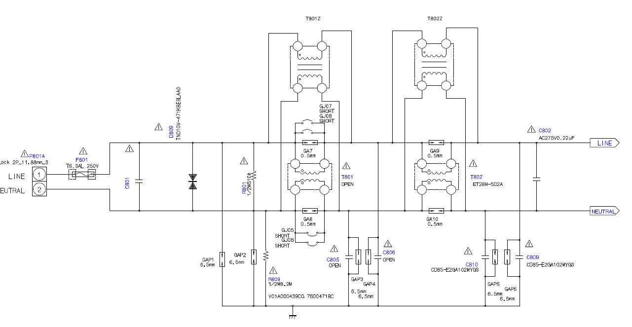

    Is this really a 540 Ohm resistor? Why is there a completely different share of green printed on it? Like olive green of sort. Am I reading this wrong? Seems wrong for it's application. It is on power supply board input.

    Looks like 150kΩ post a picture of the board, Is the location marked as R** or L**

      Re: Component identification - weird resistor
      It is R801 so clearly marked as a resistor.
        I think it is across the a/c line or to ground, I suspect it is 150k. Is it in a tv? Post a picture of the whole board
          Yep, traced the mains input and it is across parallel to a MOV. How come if it's 150k it does not match the color bands whatsoever? 150k would be "brown green black orange brown" right? This one is clearly "black green(?) yellow brown green" Which adds up to 540 Ohm.
            What does it measure on your ohm meter? or it could be read the other way 51.4MΩ 1%

              Here you go
              Yes this is a Toshiba TV.
                510kOhm right now, the leg fell off. Before it was showing high megaohms so its a little burned.
                  It is a 510k 1/2watt will not effect the power supply's operation.
                    R809 is in series with that spark gap, this is R801 and it is in parallel with a MOV and, a big capacitor and the rest of circuit. Seems to be a part of input RC filter.
                      I edited my post, here is the diagram of that circuit
                        510kOhm it is then. Why they marked that resistor completely wrong is beyond me. Thanks for the help.
                          If you read the resistor:
                          Green (5) 1st digit
                          Brown(1) 2nd digit
                          Yellow(5) multiplier
                          Green (±0.5%) tolerence
                          Brown (100ppm/°C) temperature coefficient
                          So what is wrong with the tv/power supply?
                              Green (5) 1st digit
                              Brown(1) 2nd digit
                              Yeah, decoding it like 4 band resistor works. The fact that it has 5 bands is not typical as it does not decode as a 5 band resistor properly.
                              Lightning damage, input protection was scorched. New MOV, two 6.3A fuses and this dreaded resistor and we're up and running again.
                              Originally posted by stj
                              watch your fingers, that resistor is to discharge the polyester caps!
                              I thought it's primary function was to form some sort of parallel RC filter at the input, but yeah, it will dissipate charge from that capacitor nicely.
