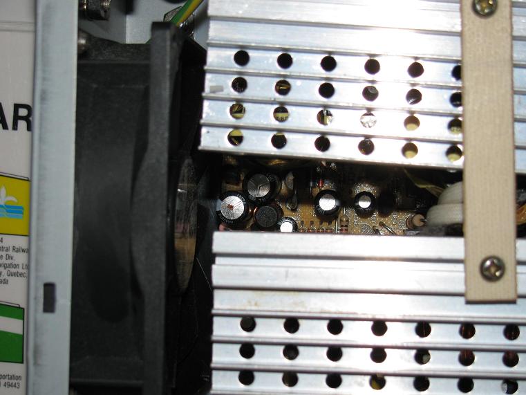

    OK, for anybody following this thread, I successfully recapped my brother's Antec SP-500 power supply.
    Here are the before pictures:

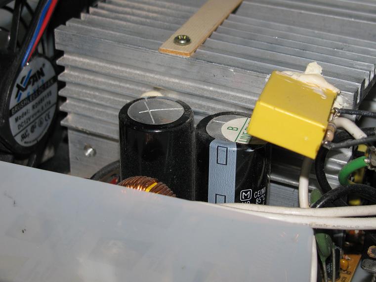

    Input caps - the one on the left is bulging
    +5vsb caps - one leaking and the other bulging

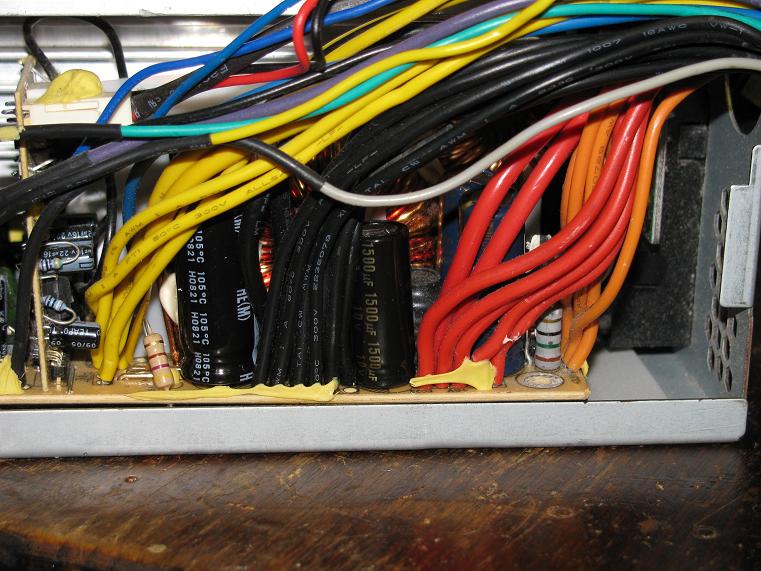

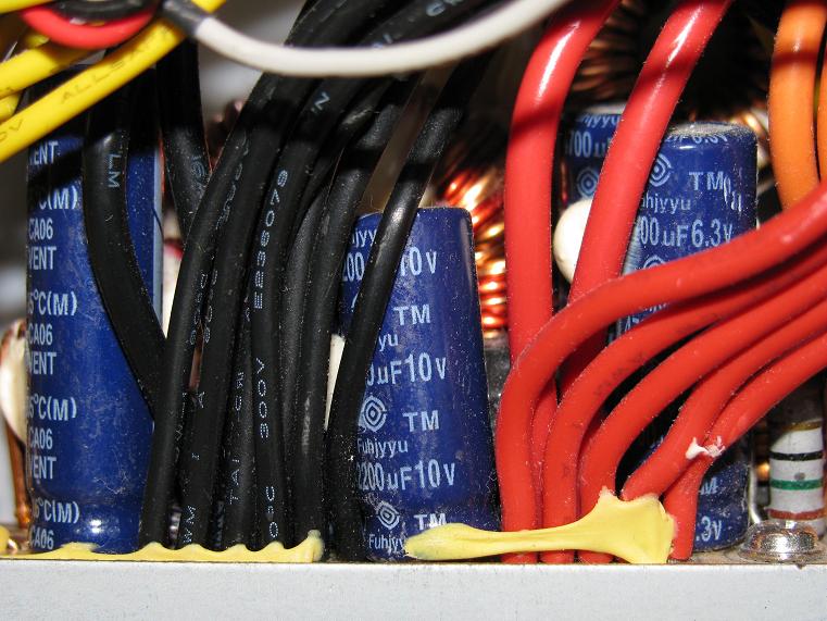

    The best pictures I could get through all the awful wires of the output side, all Fuhjyyu!

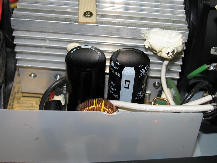

    input caps:
    2x 1200uF @ 200v Panasonic UQ 85C -> 2x 1000uF @ 200v Panasonic HC 105C
    output caps:
    +5vsb
    2x 1000uF @ 10v Fuhjyyu TN -> 2x 1000uF @ 10v Panasonic FM
    +3.3v
    2x 4700uF @ 6.3v Fuhjyyu TM -> 2x 2700uF @ 6.3v Panasonic FC
    +5v
    1x 1000uF @ 10v Fuhjyyu TM and 1x 2200uF @ 10v Fuhjyyu TM -> 2x 1500uF @ 10v Panasonic FM
    +12v
    1x 3300uF @ 16v Fuhjyyu TM -> 1x 3900uF @ 16v Nichicon HE (12.5mm diameter stuffed into a spot for a 10mm...it is absolutely ENORMOUS in there)

    For the input caps, there was one I could get that was 1200uF, but it was only rated for 85C. So I decided to go down a size in capacitance for the extra endurance, because silly antec doesn't run one of the fans unless it gets way hot, and it must have gotten way hot in there before to bulge the panasonic that was already there.

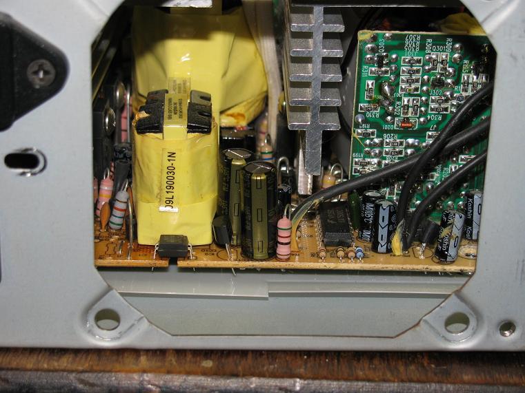

    Here are the after pictures:
    Input side:
    +5vsb caps (looking through the fan hole instead of from above):
    and the output side, sorry the picture is so bad, but those wires will not cooperate. you can see the giant nichicon HE, the (relatively) small FMs, and then the blue FCs behind the red wires:

          replace the bleeder resistors across those input caps too.

              ok well it turns out there are 3 bleeder resistors - a 560K 1/2 watt across the yellow X cap, you can see it in the first picture. this one looks fine to me. the other two are tiny little SMD resistors that I have neither the skill nor replacement parts to fix. How important is it to replace these?
