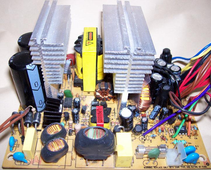

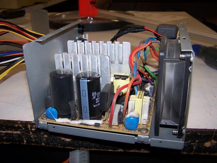

            The first one is a really old powmax, the second one is a newer one, they buy used parts from recyclers, thats how they good decent parts in some of their units.
                    For the older Powmax power supply that isn't a gutless wonder, replacing the dreaded four diodes on the primary side with an actual bridge rectifier and replacing all of the Rulycon/JEE junk on the secondary would make it a very good power supply.

                      Well 370forlife, you beat me to it. The one in the first picture you posted - that's the one I have. It was originally posted by larrymoencurly here:
                      https://www.badcaps.net/forum/showpo...0&postcount=30
                      Some components are slightly different on mine, but it's the same thing more or less. It's a 300 watt design with a bit of headroom for probably another 50 watts, but PowMax also labels some as 400 watts. Mine is labeled "CompUSA 500 watt Power Supply" - quite overrated.
                      Of course in 2001, there were hardly any systems that would eat that much power anyways, hence there wasn't a chance to overload it that much.
                      Overall, PowMax was a-ok for back then. Now they're just unacceptable.
                                    the first still had 4 diodes and a lack of transformers. better but no good

                                        I have finished the modifications on my L&C power supply!
                                        Most importantly I replaced the two FR302 3A diodes on the secondary side with an STTH2002CT 20A TO-220 power rectifier.
                                        I also replaced the Panasonic FC series 1000uf 16V cap I had on the 12V rail (C27 on the PCB) with a Panasonic FM series 2700uf 16V 12.5mm capacitor to increase the capacitance on that rail. The Nichicon HE series 1000uf 6.3V 8mm capacitors I had on the 5V and 3.3V rails (C22, C23, C25, and C28 on the PCB) were replaced by Panasonic FM series 1500uf 10V 10mm capacitors. On the primary side, the two CapXon 330uf 200V capacitors I had in it were replaced by two Nichicon PW series 470uf 200V capacitors. I even replaced all of the tiny 2.2uf 50V and 47uf 50V capacitors with Panasonic FC series capacitors of the same values. Now my power supply has all Japanese-brand capacitors!
                                        Last but not least, I replaced the 80x80x25mm fan I had in it with a new Sunon EE80251S3-0000-999 12VDC 33CFM sleeve bearing fan. It's pretty quiet.
                                        Pictures:
                                        The top view of my L&C power supply's internals.
                                        A view of the new Nichicon PW series input capacitors.
                                        A view of the new secondary side capacitors.
                                        No more two FR302 3A diodes! Now there's a nice STTH2002CT 20A TO-220 power rectifier in their place.
                                        A view of the new fan.
