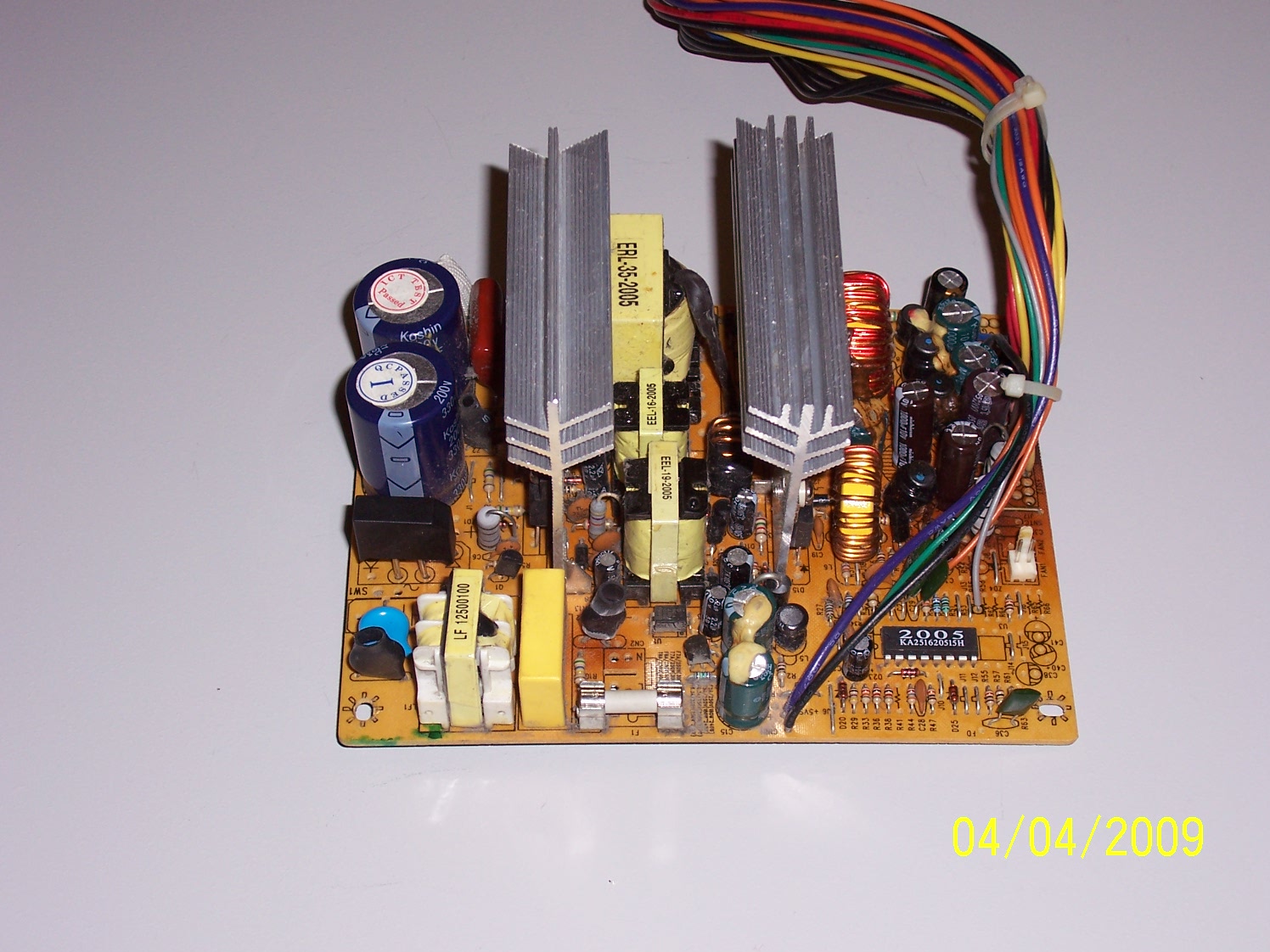

          I would like to express an opinion - that I am quite proud of you for the work you have done on this power supply to make it better and safer. For many years I used the "gut and toss" plan, that is, if power supply gives problems, remove it from computer, toss it, and replace it with a new one. It has been only in the past six months or so that I have actually opened and studied what is inside the power supply box. So what you have gained from this is more than a better power supply, but a better understanding of how power supplies work, and how to make one work better. No power supply is perfect. Something can be learned from any power supply, even the Bestec and Powmax. I commend you because you have opened the box and made something better, something most people just won't do.
          I have just recently acquired another mother board to work on - AZZI KT3-AV. I am sure someone will jump in and say it is just a POS, just gut and toss. I think the real POS is the vocabulary being used. This website has an international audience. The vocabulary we use represents the character of our country. Wouldn't it be nice if we could all improve our vocabulary as much as you have improved your L&C power supply.
          ps - here is a picture of my L&C power supply
          Old proverb say.........If you shoot at nothing, you will hit nothing (George Henry 10-14-11)

            Thank you everell for your wonderful essay.
            Yes, I am learning some more on how the power supply functions, thanks to my L&C power supply project.
            I think people here should respect the fact of us trying to improve components such as power supplies and even motherboards that are normally considered low quality junk.
            I am sure my L&C power supply will reliably power my Celeron 2.2GHz computer for a long time after all my modifications are complete on it. I think the people at Deer/L&C over in China should be looking at this thread to see why it's important to not skimp on so many vital components in their computer power supplies for reliability, even if it means spending a few cents more on every power supply made.
            everell, did you add the components for the input filtering section on the primary side of your L&C power supply or did it come like that?

              About 6 months ago, I decided to "open the box" and find out why so many power supplies are failing. I had a couple of discards at work to look at, and I found a computer shop which sells me "broke" power supplies for a buck apiece. So I now have about 40 or so laying around the house. The AT supplies I gut for parts - and save lots of money on repairs. The ATX supplies are the ones I attempt to fix. I have managed to fix nearly all of them - including the L&C in my last post. It had four seperate diodes in the input, one of which was shorted. I replaced all four with the bridge you see in the picture. I also found one bad capacitor on the output side. I have not tried to make any improvements to this particular power supply because the main switching transformer is so small compared to other power supplies. The first psu I began experimenting with was a Bestec ATX-250 12E simply because I couldn't get the 5vsb to work right. That is when I developed the modification circuit using the DM311 chip which works quite well. I also experimented with a 200 watt SeaSonic which was very similar to the Bestec - with a 5vsb circuit putting out about 12 volts. I changed it to the DM311 circuit also. Problem solved. The DM311 pwm chip circuit is so much superior to the 2 transistor circuit I was fighting.
              The size of the main switching transformer will determine how much power you can get out of the power supply. Also, the size of the switching transformer in the 5vsb circuit will determine how much power you can get out of the 5vsb line. So for experimenting, I simply went with power supplies having the larger transformers.
              That does not mean that your power supply is inherently bad, just not capable of putting out as much power. Again, I am pleased at what you have accomplished, and hope I have contributed a little something that has been helpful.

                  the l&c unit is a great practice unit.
                  it is not good to use in anything you care about.
                  so keep on learning.the practice may prevent a foulup on a unit that is worth saving.
                  i too rebuild stuff to use for myself.i select units worthy of my time and parts.
                  i also have applied lipstick to a pig just to see what could be done.
                  you still have a pig but you learned something.
