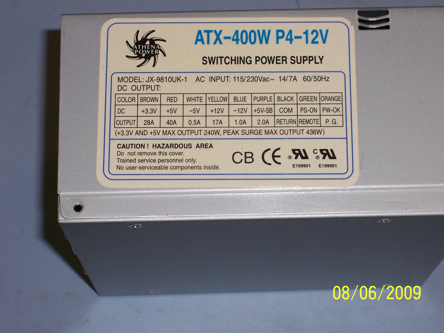

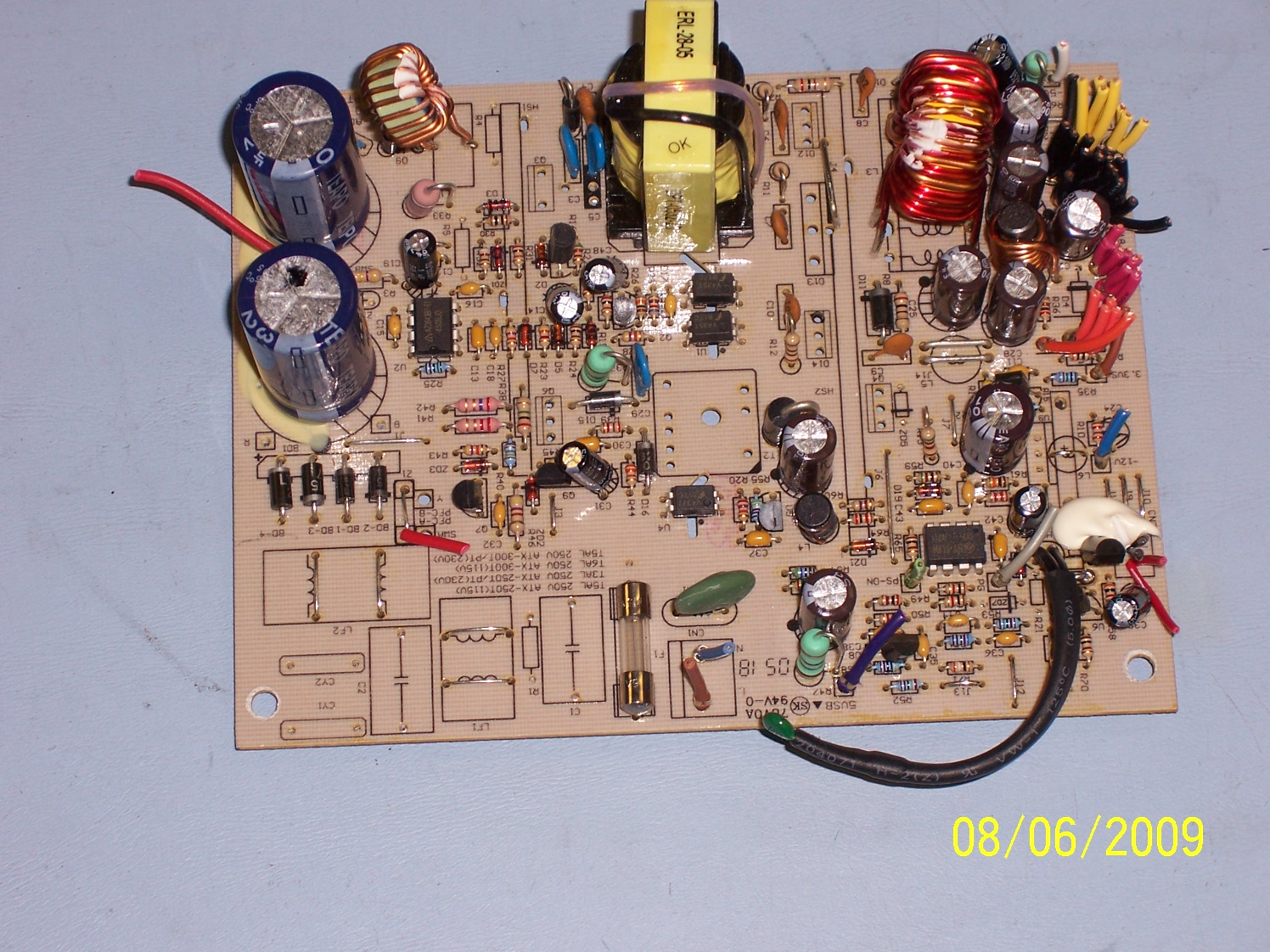

                                Before leaving the subject of questionable power supplies.....................
                                I was gutting an Athena 400 watt power supply - removed the 5vsb transformer and heat sinks with transistors and diodes. What is left tells an interesting story. For a power supply rated for 400 watts - no x and y filter components on the input side, just jumper wires. Input capacitors are 330 Mfd. And on the output side - look how small the capacitors are. Most interesting is the four separate diodes in the bridge circuit. Two of the diodes are LT5315 2A07 (could not find a datasheet for these) and the other two are LT5216 1N4007. The 1N4007 diode is rated for only one amp. So the most you are going to get thru the bridge is one amp. Multiply that by 110 volts and the max input power is 110 watts. If 80% efficient, that means this power supply is good only for 88 watts!
                                Old proverb say.........If you shoot at nothing, you will hit nothing (George Henry 10-14-11)

                                  And the award for tiniest diodes goes too....
                                  not a good thing at all.

                                    Re: Is an L&C power supply suitable for a Celeron 2.2GHz PC?
                                    Assume 70% efficiency (most generic power supplies are probably around that efficiency) and that Athena power supply is only good for 77 watts!
                                    It would probably provide just enough power for an old low-end Pentium MMX or Pentium II computer, but nothing else. I think that's why the only 400W Athena Power power supply I could find on Newegg.com was for old AT systems: http://www.newegg.com/Product/Produc...82E16817338025

                                      HAHAHAHA I had that exact one that kc8adu was talking about actually!
                                      I still have the remnants of it, I'll take a few pictures and post them here.
                                      Well as said, here is a pictures of the remnants of my old "PRO POWER" 250W power supply:

                                        Newbie2: did your Pro Power come with CapXon caps and 18 gauge wire?
                                        Everell: Other than the undersized components, the PCB looks pretty clean actually. The design of that "400w" Athena doesn't look bad. Perhaps it has short circuit and maybe other protections as well.
                                        Could make a nice basic power supply with better caps and diodes. Main transformer is size "28" though, so this power supply is limited to 200 watts.
                                          It did come with CapXon capacitors, but the capacitors you see in the picture are not its original capacitors as I used it as something to practice with when I first learned how to solder.
                                          I'm not sure on the wire gauge, but it is thin wire.
