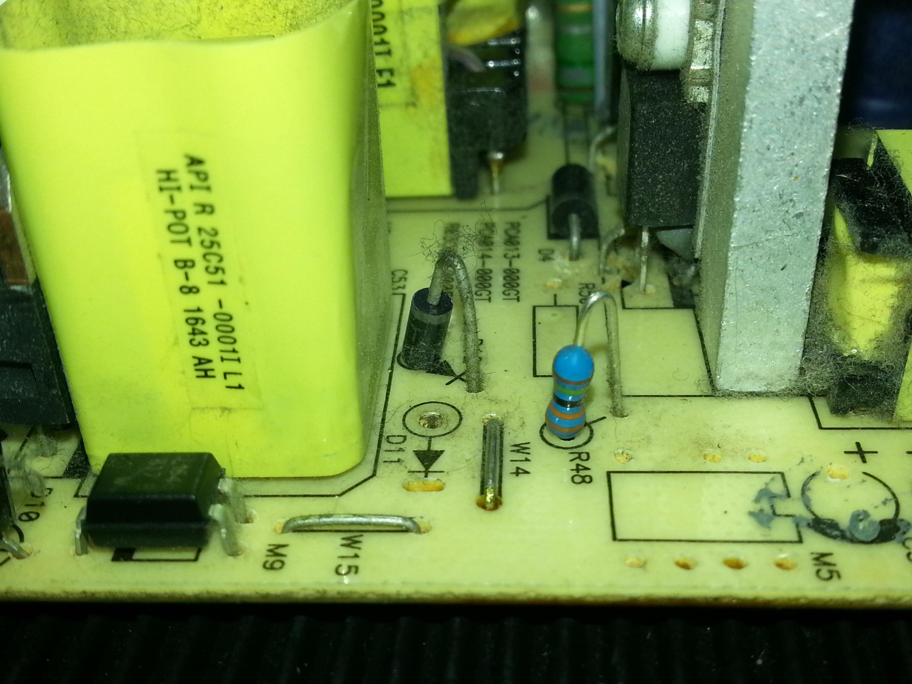

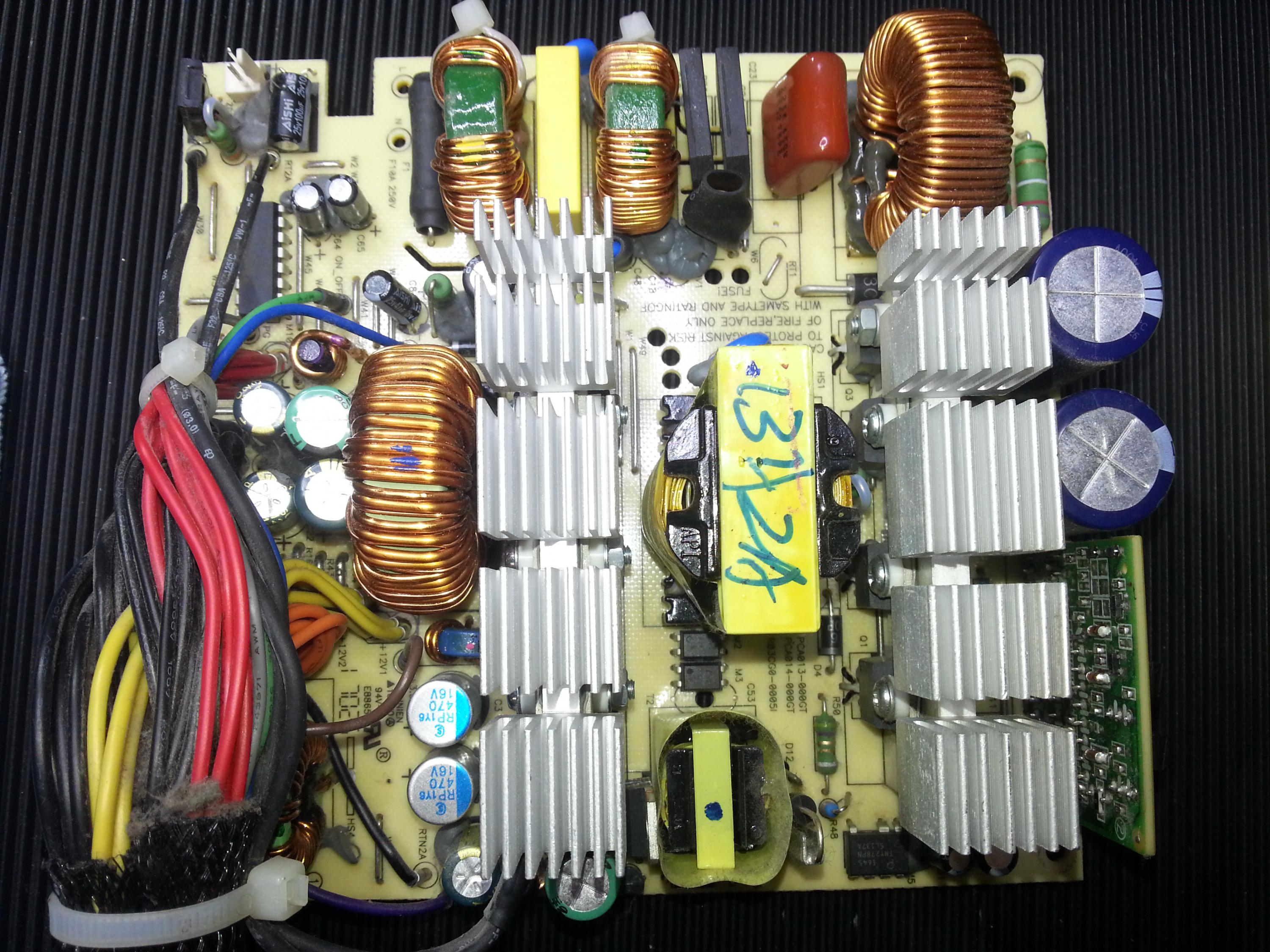

    Good day folks. A colleague of mine asked me to take a look at this ATX supply which he said is completely dead. I didn't plug it in myself, but instead started probing around to see if I can find anything with the board "cold".
    I started with the stand-by circuit which is driven by a TNY278PN IC which is not shorted. In that area however, I found THIS resistor which clearly had a hole in it and it reads completely open - no resistance at all. It goes between a leg of the small STBY transformer and the + leg of the main capacitors and for some reason it popped. The fuse is good, so it seems to me nothing exploded violently here, but the resistor still decided to give up....
    No problem, I said to myself, I'll just replace the resistor and see what happens....that was until I looked up the color code and this is where I got stuck: there's no value for a gold band in the second or third positions ! So we've got yellow (4), purple (7), gold (?), gold (?), white (10% tolerance ?). Normally a gold band signifies a 0.1 multiplier, but not in the second or third position like that, so what is this resistor ? I thought maybe it's an inductor, but not only is the board marked R50, but it also doesn't quite make sense from an electronic point of view to have an inductor in series with the HV line feeding the standby transformer. It should be a fairly low value resistor in my opinion, something like 0.47 or 4.7 at most.....what do you guys think ? If we omit the last white band, that would indeed make sense as it would be 4.7ohm, since we have valid values for the gold bands in those positions. Let's start with this and I'll keep you posted on the repair as we go.

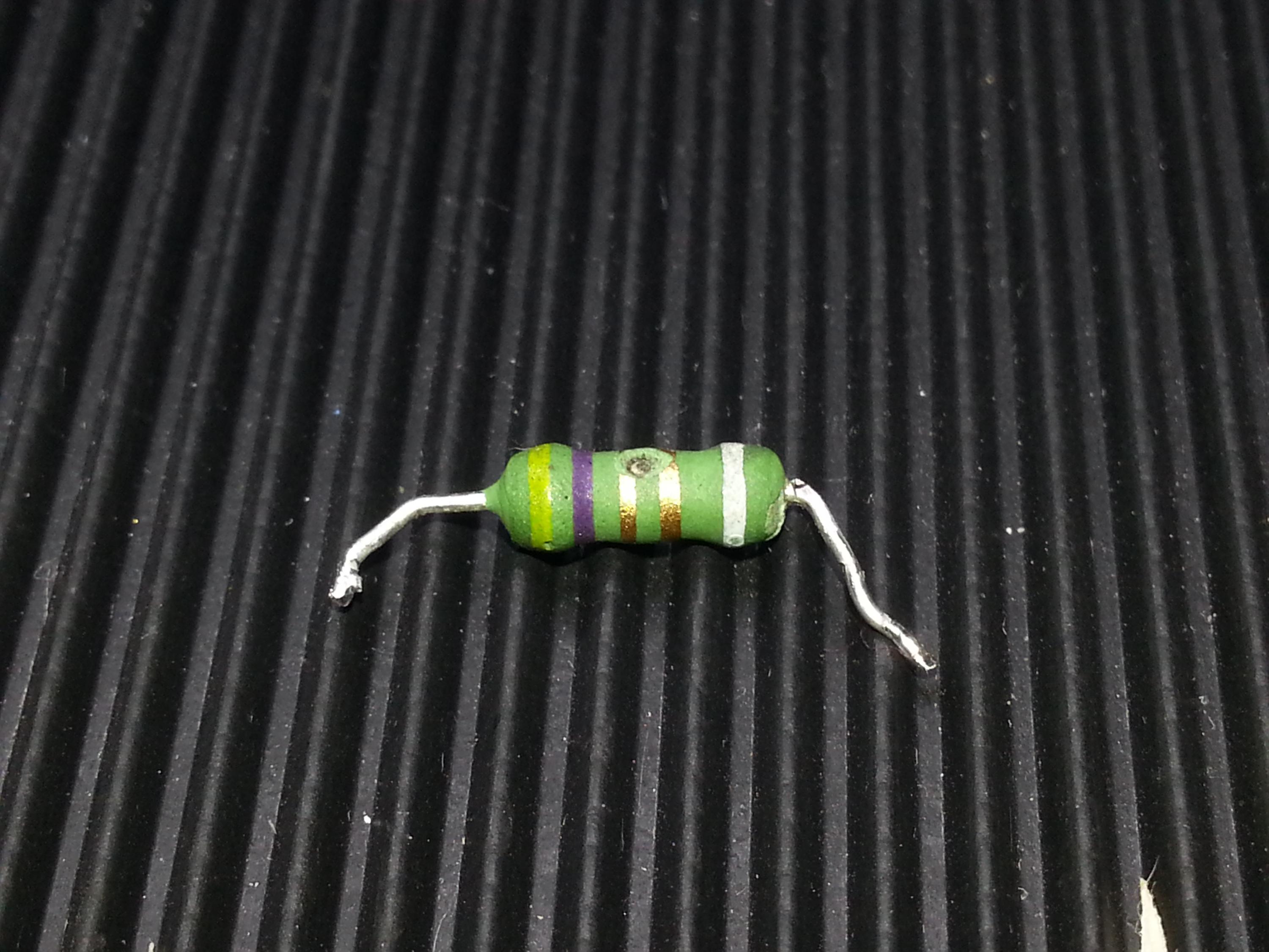

    looks like a typical 5% 4.7Ω resistor. Gold in band 3 divides the significant digits by 10. White is probably temp coefficient.
      Yes, now that you mention it, it is. What threw me off is the additional white band at the end. Makes perfect sense if you omit that, like I said in the last few lines of my post.

        Replacing the resistor will fix nothing... it was overloaded for a reason.

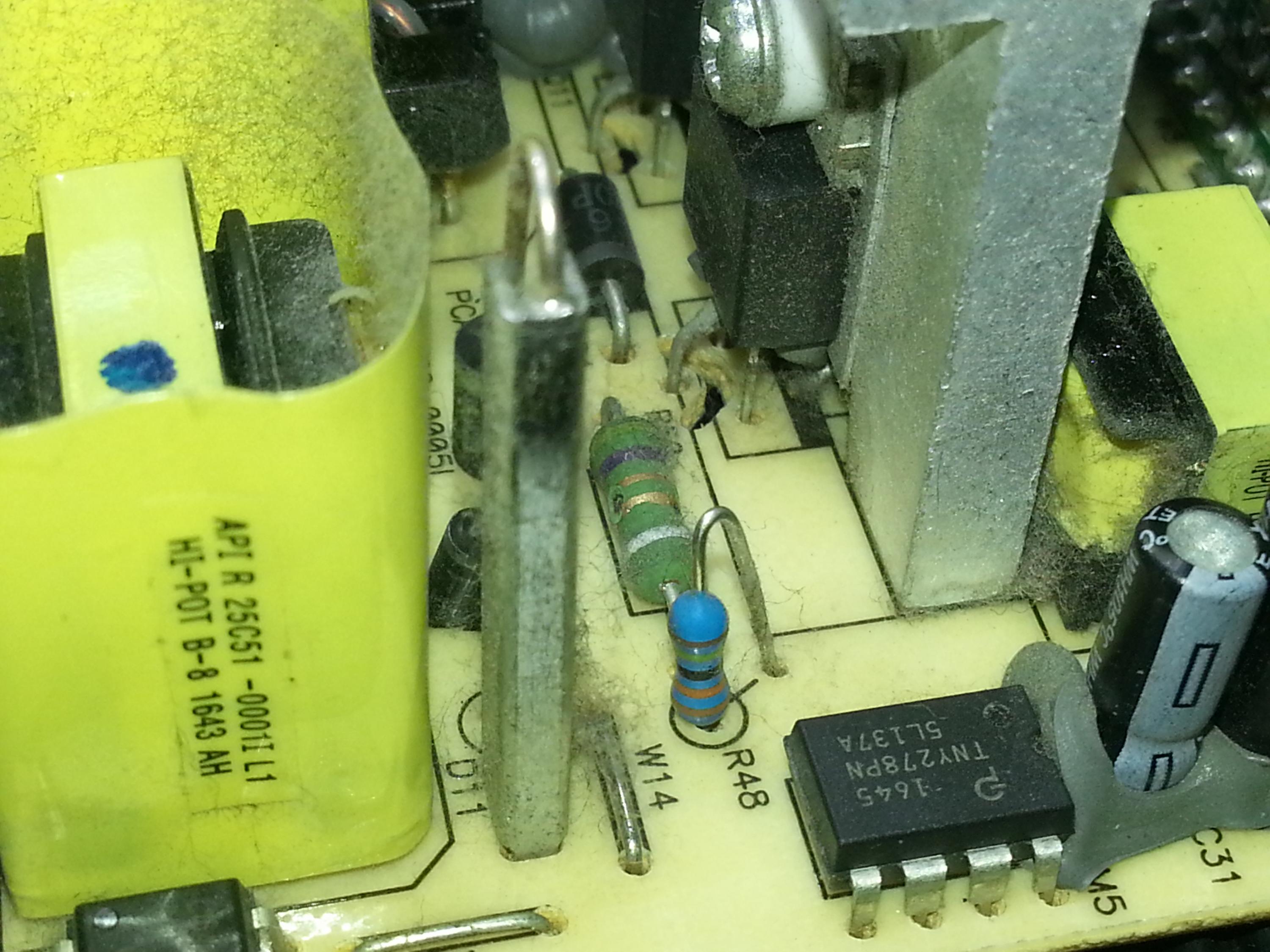

          Follow the line through the transformer and it likely connects to the tny278, which would be shorted.

            Scrape the gray crap to the right of the tny chip just in case it became somewhat conductive. You have high voltage on those pins.
            Check the ESR of that capacitor to the right of the tny chip - it has no vent release so no easy way of knowing if it's cooked or not.
            Check the to220 chip on the heatsink to the right of the resistor, it could be shorted mosfet or something.

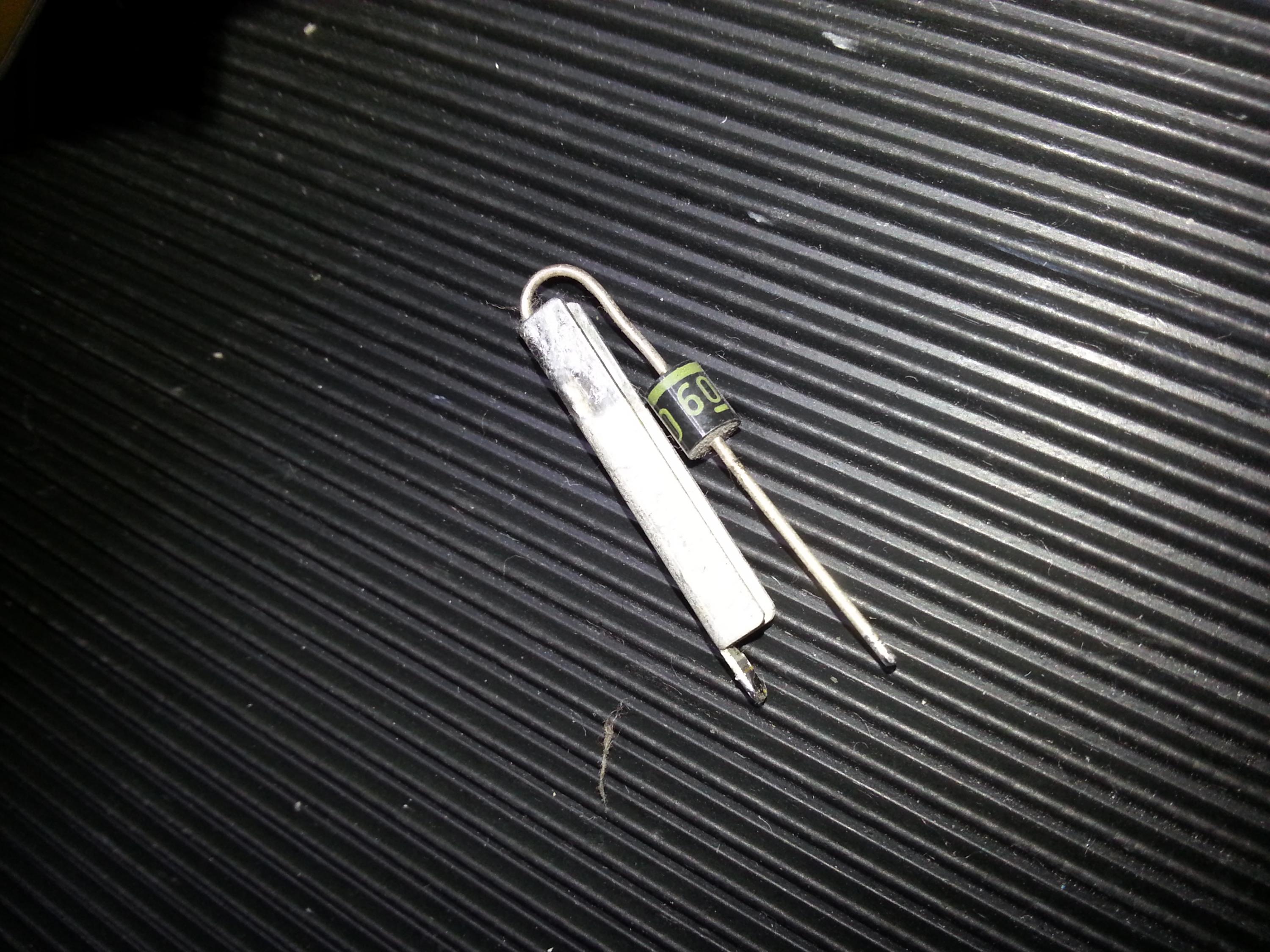

            What's with the diode to the left of the resistor in the third picture? Can't tell by the angle of the camera, is that diode going into the circuit board? Some reflection in the metal or what? Weird...

                Ok, some more info on this supply: true, I was about to make the most amateurish mistake ever: replace the "fuse" ! You never replace the fuse !
                The TNY chip is indeed shorted, so thanks for opening my eyes. Reads 9 ohms D-S and around 26 ohms D-BP/M (pin 2)....not OK. I got the same readings on my first round of troubleshooting but it was with the TNY still in circuit, so I thought it measured through the transformer which is normal to show very low values. I removed the chip and these are the values. I would say it's dead.
                Replaced the small 10uF cap next to the IC just in case.
                About the diode: yes, it's an optical illusion There's actually TWO diodes there. The one that appears to be going into the board is sitting behind the other one which has one of its legs soldered onto a fat piece of metal (foreground). It appears to be disappearing into the board because the black part of the diode overlaps with the black diode symbol on the board Here are some other pictures of the areas in question.
                Now, the diode with the metal strip goes between the D pin of the IC and the HV line on the main caps, reverse biased. It's a T2D60 - I could not find anything of the sorts.... It reads completely open in both directions. I don't know if that's normal or I should replace it as well...

                  That TS02D-60 snubber diode may be back top back diode so it will shows as open circuit, you will need need high Voltage supply with current limiter to find out what the clamping Voltage is, similar to the application circuit here:

                    I see you've edited the original reply. It was about that large diode which supposedly is a two in one sort of deal and it's pretty special. I was curious where you found that info, since I couldn't find anything...

                            it's a flameproof resistor,
                            if you can find a gray or green similar replacement and you decide to bodge in a regular part - put it in fiberglass sleeving.

                              Ok chaps, we have a winner I left that weird diode alone, replaced the TNY IC and the 4.7ohm resistor and with a bit of perspiration, I plugged the damn thing in. The series lightbulb I always use for this sort of thing did its thing, went bright then gradually went out, and sure enough I got standby on the purple wire. Removed the bulb, went straight on mains (because it's got APFC which always throws off me and the series bulb !) and with even sweatier hands shorted PS_ON to GND - because there's no way you could expect the joint to have a PSU tester *PSHAWW* - and I got a fan spin and stable voltages Thanks guys ! Cheers !
