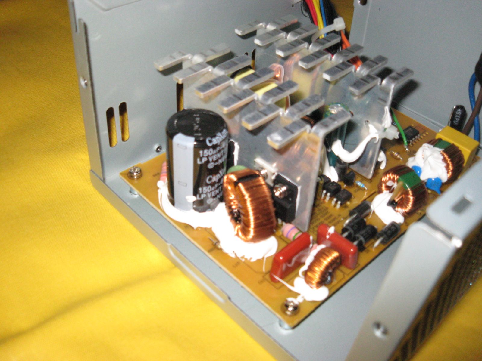

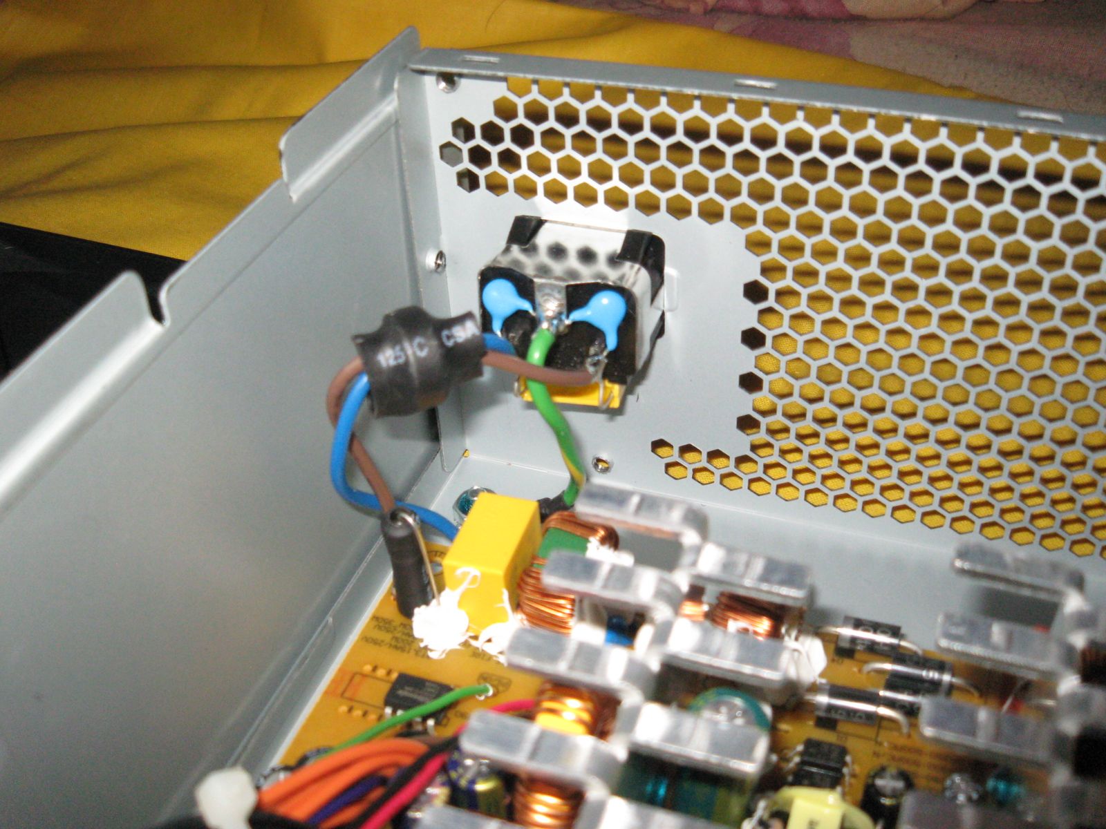

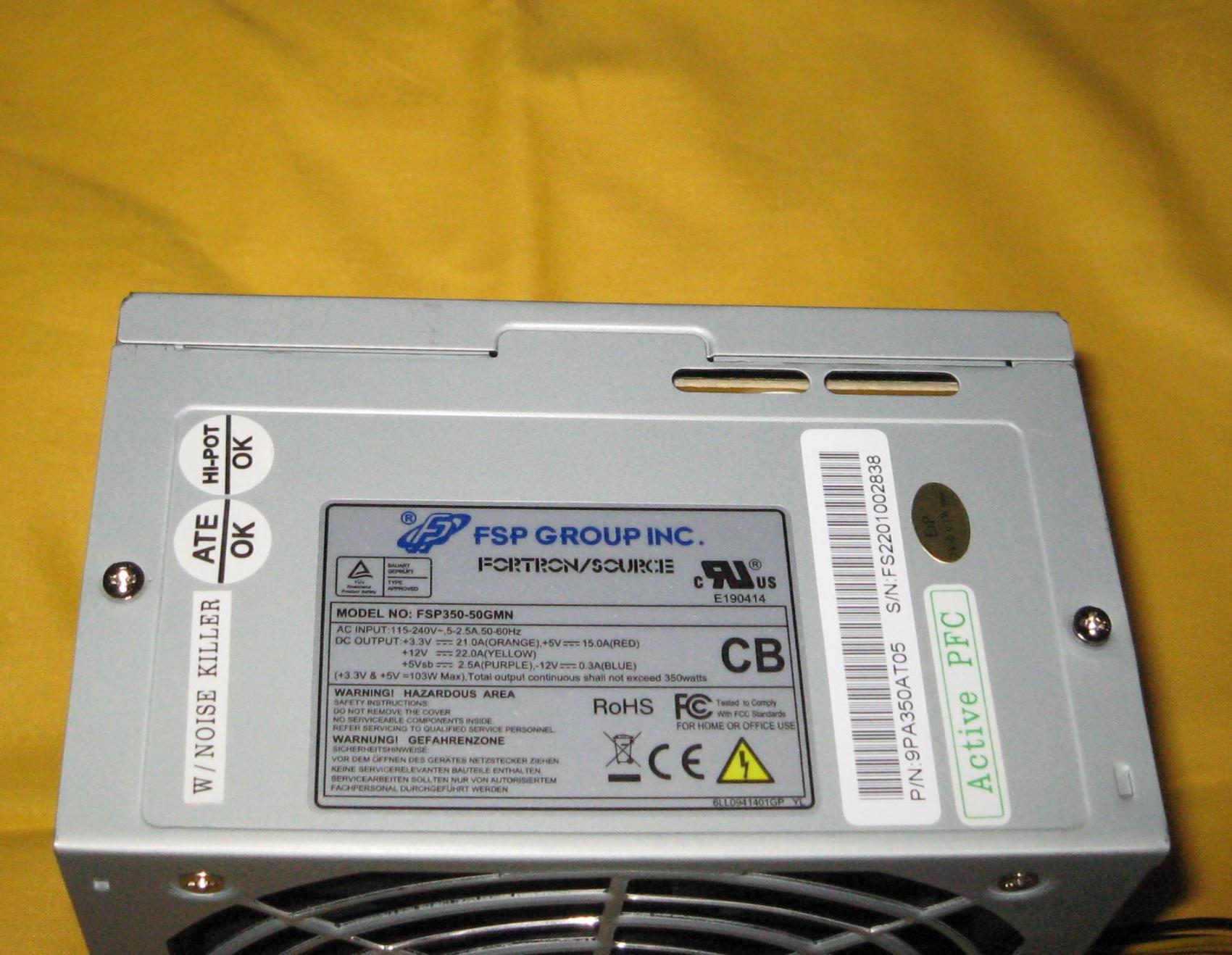

                              Brand new Fortron/Source FSP350-50GMN. I bought this to replace PSU in old P4 system. I didn't find any info on web about this particular model before purchasing. As I and couple my friends previously got good experience with FSP PSUs, I went for ir. There were no sticker on the case so I opened it and looked inside. To my surprise this units buid quality apared much cheaper than for example PNF series Fortrons.
                              One 150uF/400V 85C CapXon cap on primary.
                              In the middle 1 Taepo, 1 OST and 1 CapXon brand cap.
                              On secondary 5 CapXon caps and for 3 caps (violet ones) I could not figure out what brand they are.

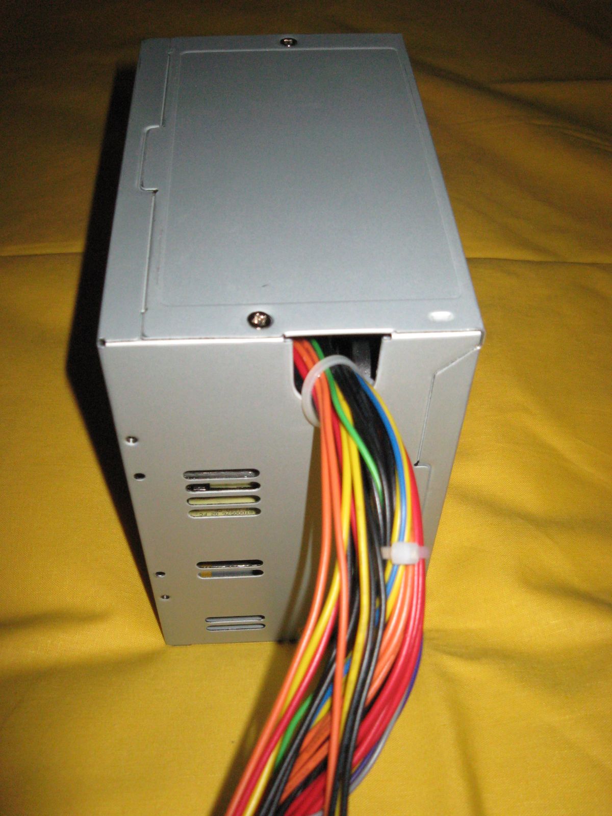

                              Cables are short. 30 cm each. And there is no that plastic thingy that holds them in place.

                                Disappointing for an FSP unit. That definitely looks underbuilt for a 350. Those violet caps are probably Yageo/Teapo. At least they used a decent fan. I would recap it. But it only looks good for 250W (Safely)

                                  Power output does not concern me much. That PC does not have dedicated video card. All I'm concerned is power noise (no way to measure that) and what this PSU will do to other components if it fails.
                                  I'm concidering preventive recap. Couple of questions. Cap on primary has quite small capacity. No problem if I put there 330uF or 470uF? Or there is no need for that. Then caps on secondary are with different capacitance (470uF-2200uF). Is it acceptable to replace all those just with one value caps? Let's say 2200uF/10 or 16 (largest caps there).
                                    #1077
                                    For PFC you typically need 75% or more capacitance to watt ratio so I'd say 270uF minimum, 330uF best.

                                      Brand new those CapXon's will keep the ripple in check but I would definitely replace them because it will only get worse over time with CapXon. FSP units are great with good caps. You can increase the capacitance and voltage on them (the filtering caps) but I usually leave or replace with the same value for the -12V cap, which is probably a 470uF 16V cap

                                          Holy cow! Whe-e-e-e-eres the beef?! 250W seems realistic. The caps you would use depend on what's available there in Riga. Speaking generally: Nichicon PW, PA and HE are good series; United Chemicon (Nippon Chemicon) LXZ, KY and KE series are good; Rubycon ZL series is good; Panasonic FC and FM are good (FJ and FK may be good, I just haven't had experience with them).
