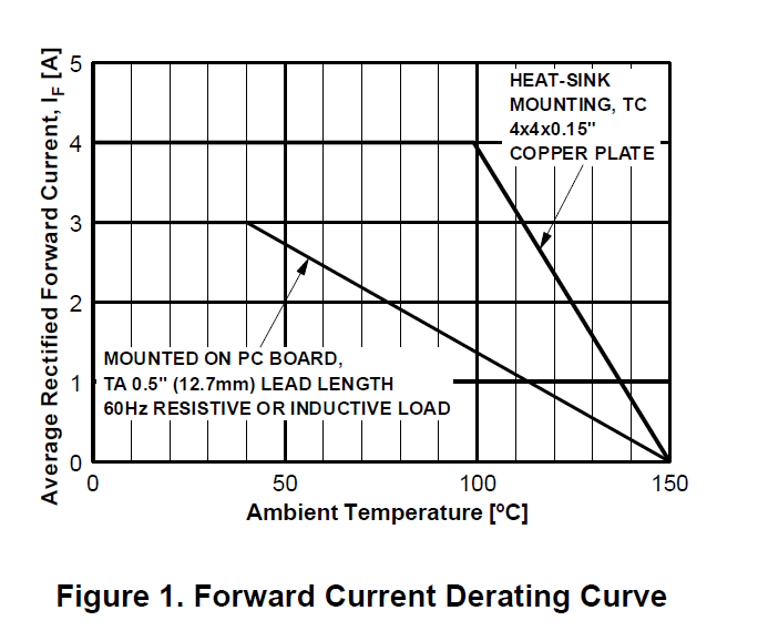

                              They look like 2-4A diodes. Two of those conduct at the same time, so they share the current.
                              At 100-200w average usage, that would be 200 / 110v = ~ 2A, so each diode has about 1-1.5a max on it. They'll be fine for the usage, especially since they're kept cool by the fan.
                              Bridge rectifiers are better, but without a heatsink they're not MUCH better, they get derated with heat (a 6A bridge rectifier for example is derated to 2A without heatsink) but depends from model to model.
                                Are they really derated that much? That seems pretty low, they seem to run fine in PSU's with a 300-350W load with a 6A bridge no heatsink, at below 80% efficiency. But they're usually close to the fan

                                  Have a look at this:
                                  http://uk.farnell.com/fairchild-semi...gbu/dp/1700185
                                  FAIRCHILD SEMICONDUCTOR - GBU4G - BRIDGE RECTIFIER, 4A, 400V, GBU
                                  Datasheet from that page:
                                  And you have the graphs on the second page:
                                  With heatsink, it will do 4A up to 100c body temperature.
                                  Without heatsink, dissipating only through package and leads to the pcb board, it can do 3A as long as it stays under 40c.
                                  It gradually drops down to 2A at about 75c and down to 1.5A at around 100c
                                  Note thought that this assumes no forced convection (air flow from a fan over the rectifier, just air naturally moving around). On a fan cooled power supply, the bridge rectifier probably stays at around 45-50c or less as the air from the fan cools the rectifier a bit.
                                  But it also depends on how much current goes through the rectifier, if there's little current it won't heat as much.

                                    #1337
                                    Oh wow, yeah it drops pretty quickly. Thanks for posting that info. Even in lower end PSU's i try to at least have a 6A bridge

                                      #1338
                                      The "without a heatsink" measurements in those datasheets are with no fans at all and at 25*C ambient... so that's totally convection cooling, as mariushm said... I wouldn't be surprised if the bridge rectifier was at 100*C at that point (since they can operate up to 125-150*C). Bridge rectifiers are likely not to get so hot being so close to the fan so I think they can do at least 75% of their rating even without a heatsink, so long as they receive decent airflow. Note that with a heatsink and fan within close proximity a bridge rectifier may be able to do slightly more than the rating. It does also depend on efficiency though, that might derate them further.
