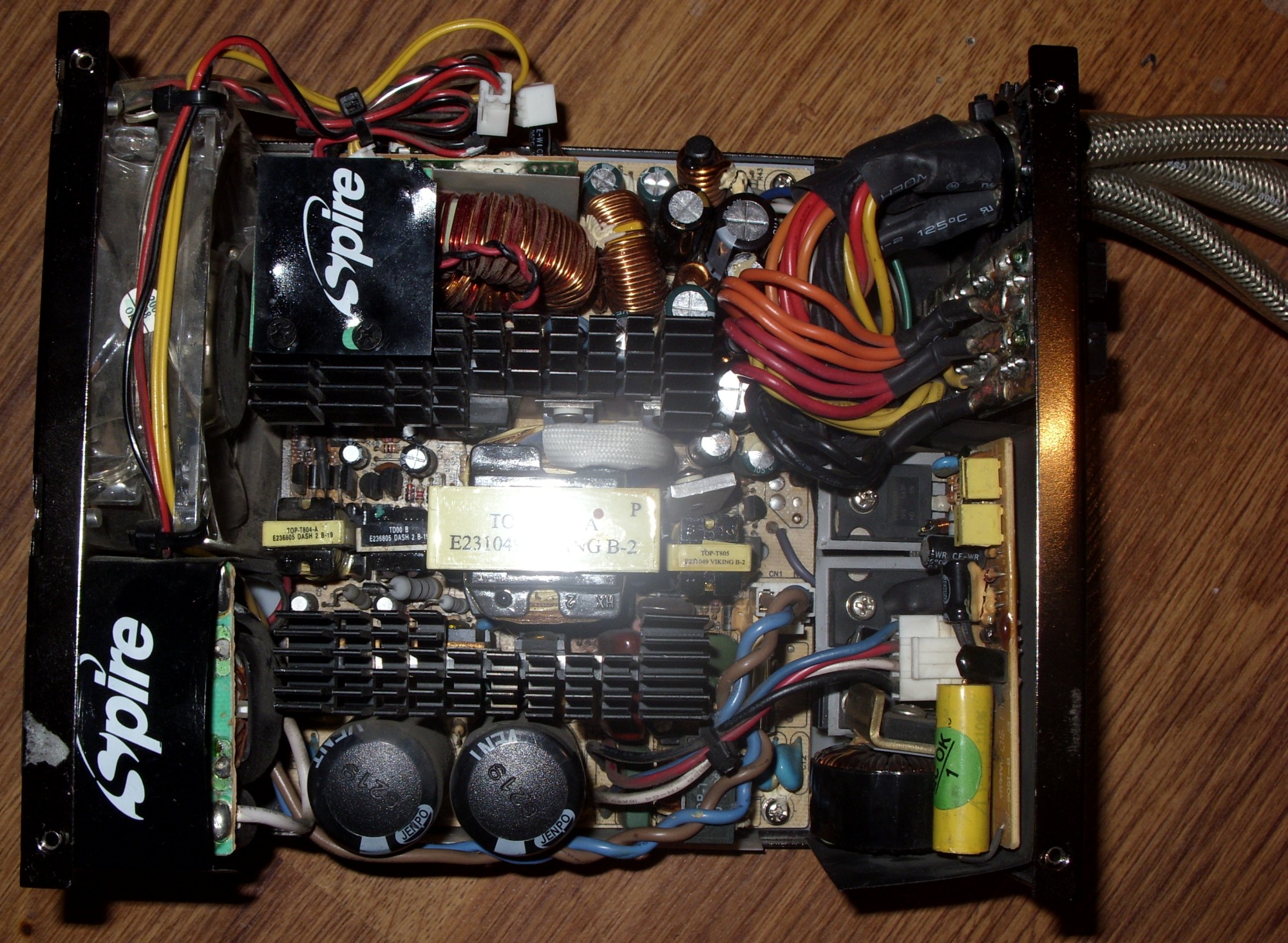

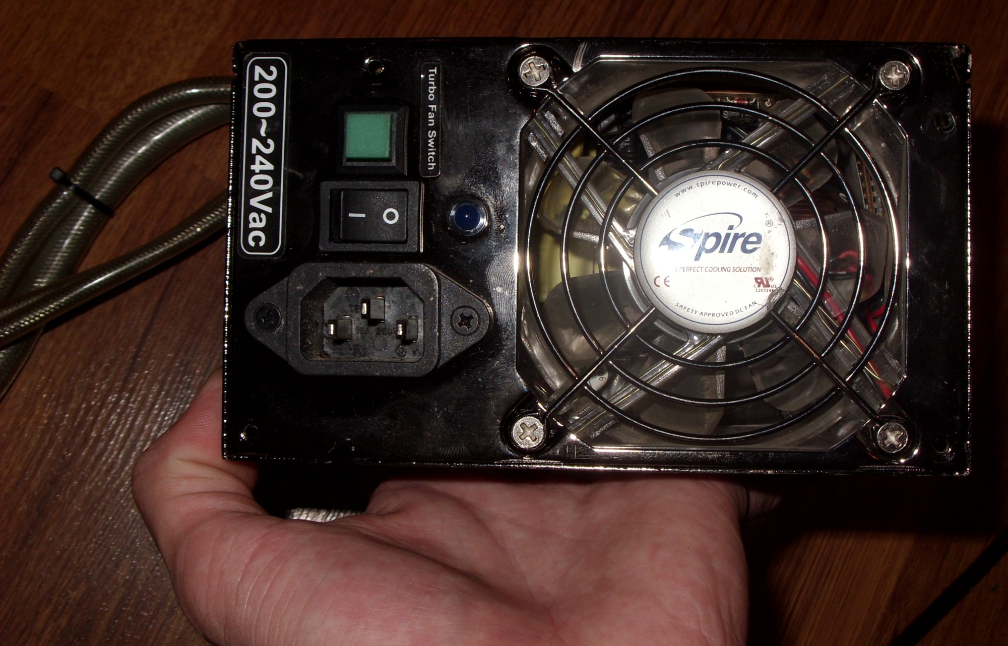

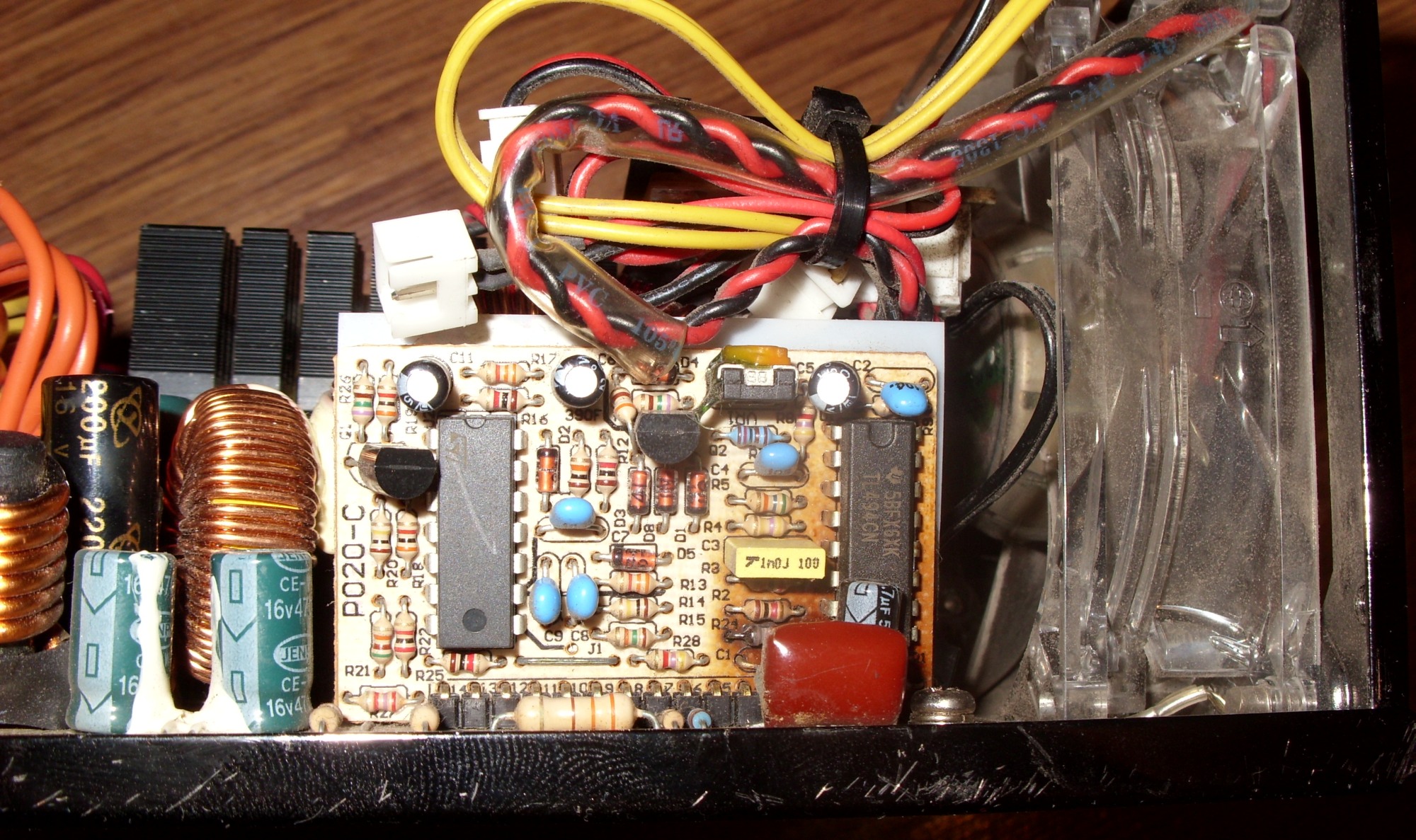

                        Spire SP-600W Rocketeer VI. OEM is Topower. Jenpo caps everywhere, the owner swapped some of them but still wouldn't power up. Turned out to be a bad 3842 on 5vsb, haven't tested the main PSU yet as i've removed both heatsinks. Original caps were Jenpo, most of them bloated including the primaries, some just dried out and the PSU is almost new... Spire blew all their budget on those fancy cables.
                        It's half bridge, but it looks beefy enough to do 600W. Primary switchers are a pair of 2SC3320. Two SBL3040PT for the 5v rail (60A total), two YA868C15 for 12v (60A total), one SB2040PT (20A) and one P80NE03L (80A) for 3.3v. Obviously, the limit is given by the diode. Also found on the secondary heatsink is *gasp* a 7905! This thing has a -5v rail, which shows just how old the design is. It does have active PFC however, with a L6562N and two IRFP460A.

                          Look: https://www.badcaps.net/forum/showthread.php?t=12484
                          They are similar. The Tagan had Panasonic primary caps, yet they failed dry. I think that this is due to the APFC add-on board or the heat (or both?)

                            ^ That TL494 and some of the resistors next to it seem to have gotten quite toasty. Not good! Otherwise the PSU looks nice.

                              Are the primaries really bulged under the plastic cover? It tends to seems so, but its just for safety, the actuall vent is under it.

                                  #936
                                  First thing i did was rip it out and check - yes, they are bulged.
                                  A working TV? How boring!

                                      #938
                                      I'm going to keep the PFC. As for the caps, going after them today.

                                          #940
                                          I will definitely dissect the primary caps as i can hear rattling inside. I'm sure they're smaller than the cans.
                                          Btw, all up and running now. All that was wrong with the main supply was the caps. Pics tomorrow.
