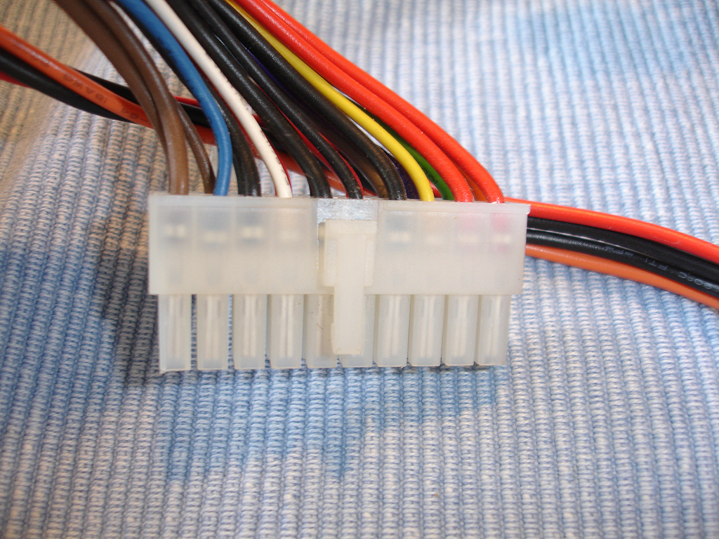

      Just wanted to share some pics of a Compaq 200w ATX PSU.
      Every caps is name brand. The primaries and small ones are Rubycons, the rest are Sanyo, with one UCC.
      The heatsink appears to have a temperature sensor.
      This is a Lite-On built unit.
      I don't understand the wiring colours. Is this a standard ATX supply, despite the non-standard wire colours?

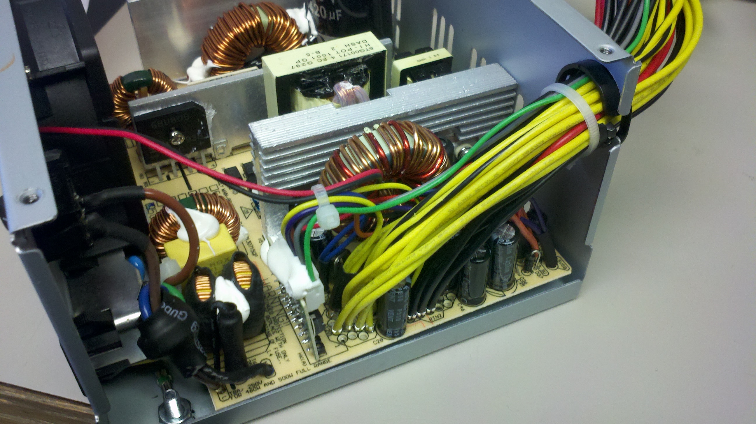

                Kinda disappointed with this Antec, mostly because of the cap choice. Looks like an FSP build. At least it has APFC. And I paid $10 for it brand new. Hooray for voiding the warranty straight out of the box.
                All output caps are CapXon there's 2 Teapo's. One on the 5VSB and that tiny one next to the MOSFET's. Bridge rectifier mounted to the heatsink is a GBU805. Going to recap the entire thing. Would you guys trust this for 500W with a recap? I was thinking more along the lines of 430W continuous. It is 80 plus at least. What do you guys think? Either way, great for $10

                  Those aren't 500W heatsinks, IMO... not even 400W. I know it's 80%+ efficient/Active PFC and I know it depends upon the rest of the components but I wouldn't consider it more than 350W, though maybe I'm being a bit harsh. The output capacitors do not look particularly overspec'd. I could be wrong, though - if the bridge rectifier is on a heatsink it could do 400W.

                    Dunno about 500W, as that platform is known for its high ripple, but 400-430W should be OK. It probably runs quite hot with those heat sinks too.

                      With some Japanese caps the ripple should improve a decent amount. Is Y.L Fan a good brand? I don't want to worry about that thing dying...

                                They can do it with enough airflow. That's the reason why all FSP supplies are much louder than similar competition products. If they decreased airflow, it would mostly not even survive warranty time.

                                  The Antec is ok.
                                  It is indeed an FSP. This model is nothing spectacular but it will do its job. The heatsinks are ok unless the psu is designed to be silent. You might want to check this.
                                  I don't like that this is supposed to be a 500W model (or 650W here) and the secondary caps are usually 2x2200 at 12V and 2x1000 at 5V or 3.3V. This is too low for 430W+.
                                  If I was going to recap that thing I would try to go higher in uF. And the Capxons are going to bulge in the end no matter how cool they are kept. Just look at my link above.

                                    ^ This may be an obvious question, but do the output capacitors determine how much power the secondary outputs can do or are they more there to lower ripple, noise, and guarantee stability on each voltage output (like with the coils - augmenting efficiency), with the rectifiers supplying the power? And I imagine Capxons would do better if kept very cool and if kept away from stress, but yes, they are prone to fail.

                                      The esr should be low enough to keep ripple in specs and the total uF per line filter transient voltages especially when the system draws a lot of watts.

                                        How come a few of the caps have heatshrinks on them? Cause I'm too lazy to replace them if they're important

                                          FSP does that, not sure why…maybe heat protection? Its usually between coils and such.
