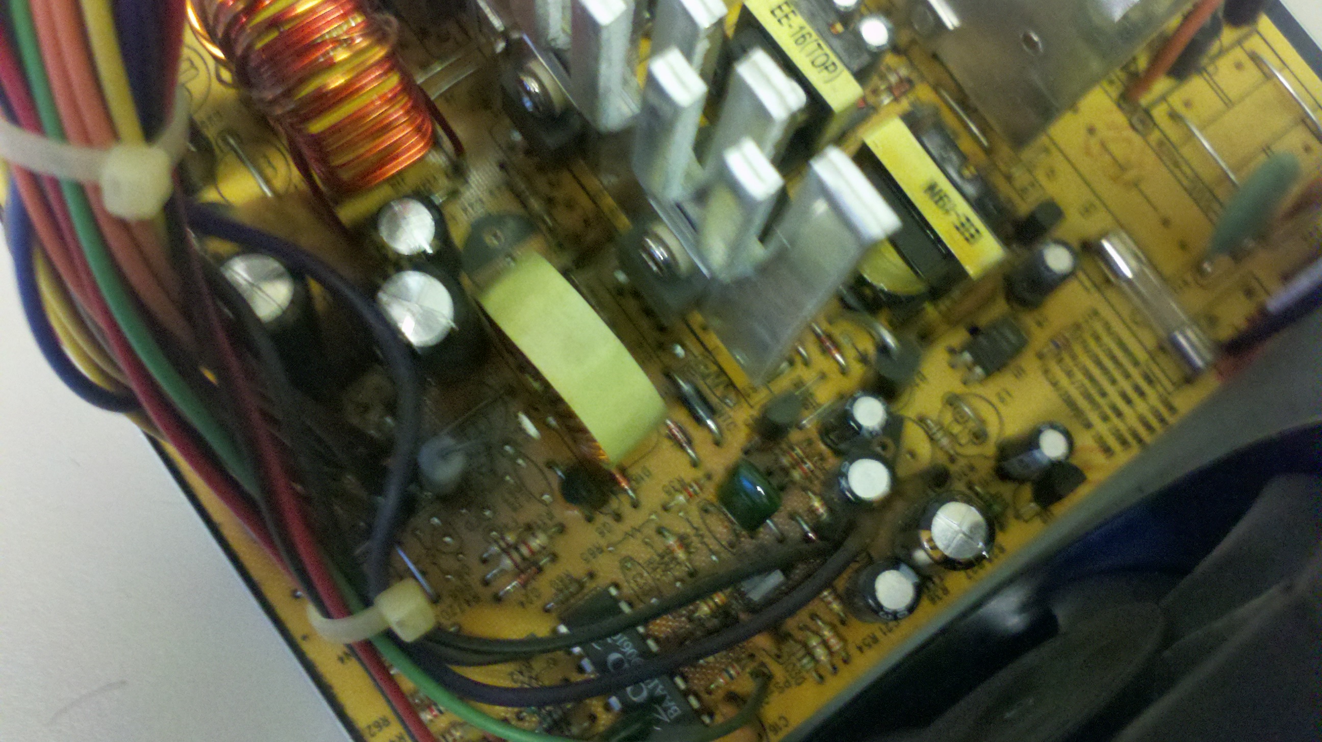

              Check out this absolute trash of a power supply. Pretty sure it's a Deer, all caps are YC and EVERY SINGLE cap on the secondary is bulging. Can you imagine the ripple coming out of this thing before it died? You can't see very well because I had to take a picture of this with my phone at work, but the PCB on the secondary is a very dark brown, a lot of things burned up. This thing took out the motherboard and the RAM when it died. The owner was insanely lucky that her hard drive didn't get killed cause she said she had 60,000 pictures on it and none of them were backed up....

                The small ones are not bulging?

                  #828
                  haha I'm sure they're dead though! They probably committed suicide after all their buddies died.

                        So, on this Max Power (anything but) I was checking the specs of the output rectifiers. I can only identify 2 out of the 3. For the 12V, it has a 10A fast recovery diode (says 18A on the label) and a 16A fast recovery diode for the 3.3V (says 28A on the label). For the 5V, it looks like an actual shottky, but I can't read anything on it. I cleaned it and it looks like nothing was ever printed on it. I was considering taking it cause it's probably a 30A package (label claimed 50A but I doubt it) is it worth desoldering it and seeing if the numbers are possibly on the other side?
                        Edit: Rubbed some water on it with a Qtip and then it showed up but once it dried, it instantly went very very faint again, but anyways, yes it's a 30A shottky.

                                  #836
                                  I see…well, not really, from the pictures it does not seem burned more than usual crap of this category. I would expect the board to be brown, or at least orange, but it is fair yellow, no sign of overheat anywhere…?

                                    #837
                                    It's definitely really burned, you just can't see very well because I took the pictures with my phone. The only burned parts are around the secondary caps and the little diodes, the secondary output doesn't look burned at all.

                                      #838
                                      Isn't it actually some kind of degraded fixing shit, or maybe electrolyte from the bulged cap? First can be mistaken for something burned, second can be aggresive and do whole bunch of things.

                                        #839
                                        If you mean the PCB, those cheaper phenolic boards discolour easily with heat

                                          #840
                                          Yeah, that area of the PCB. I also found out later that the fan completely seized up which killed it fast I'm sure cause the efficiency has to be terrible.
