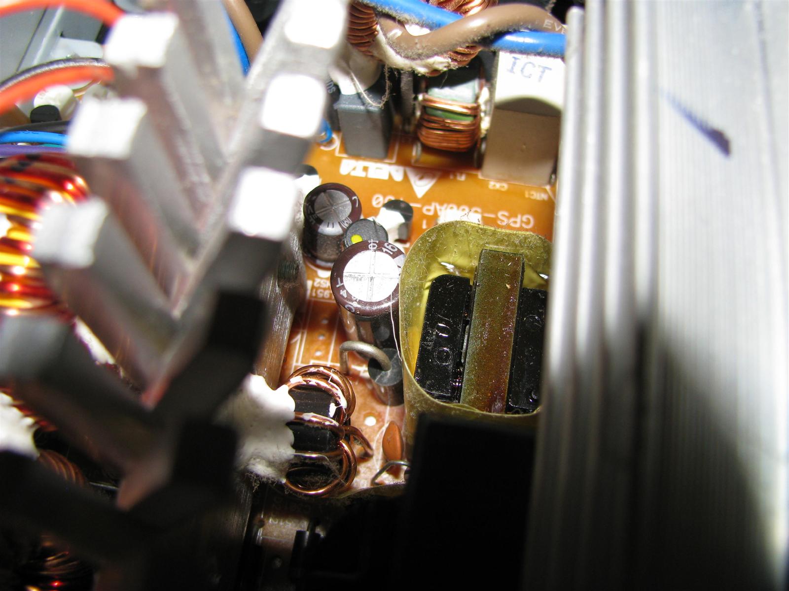

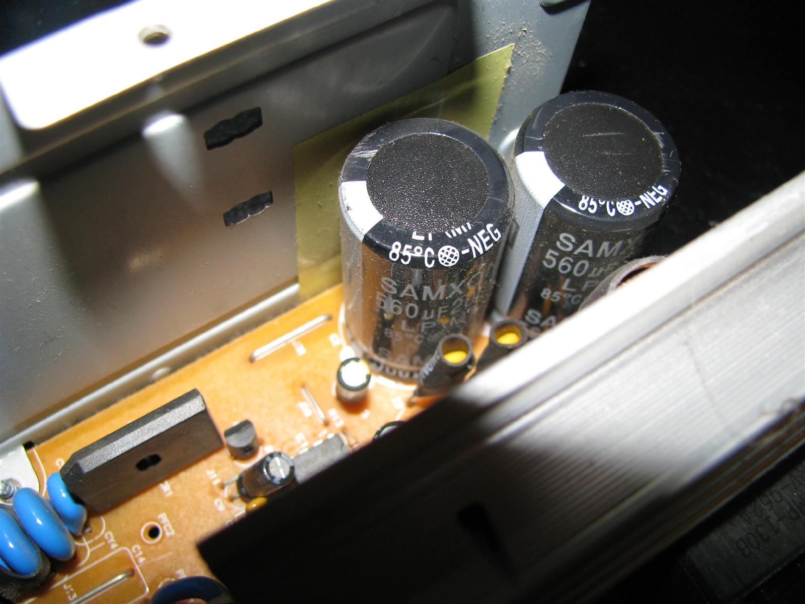

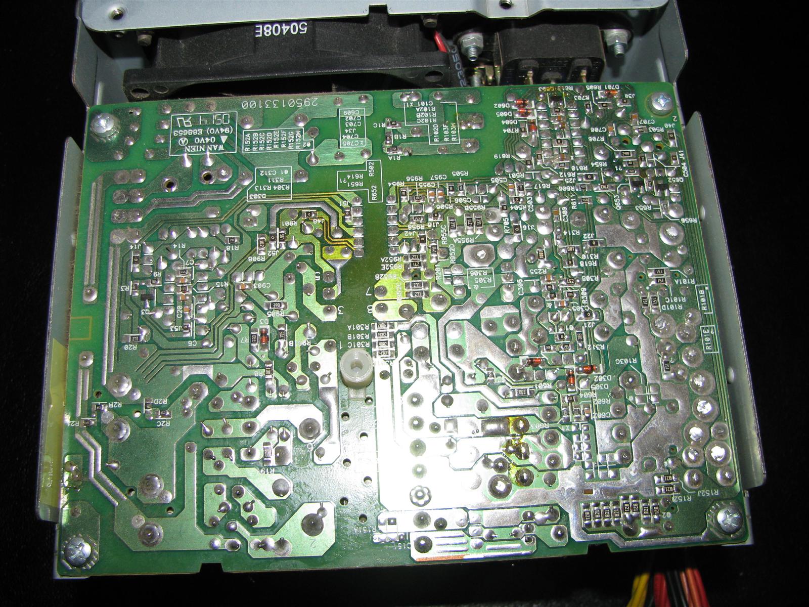

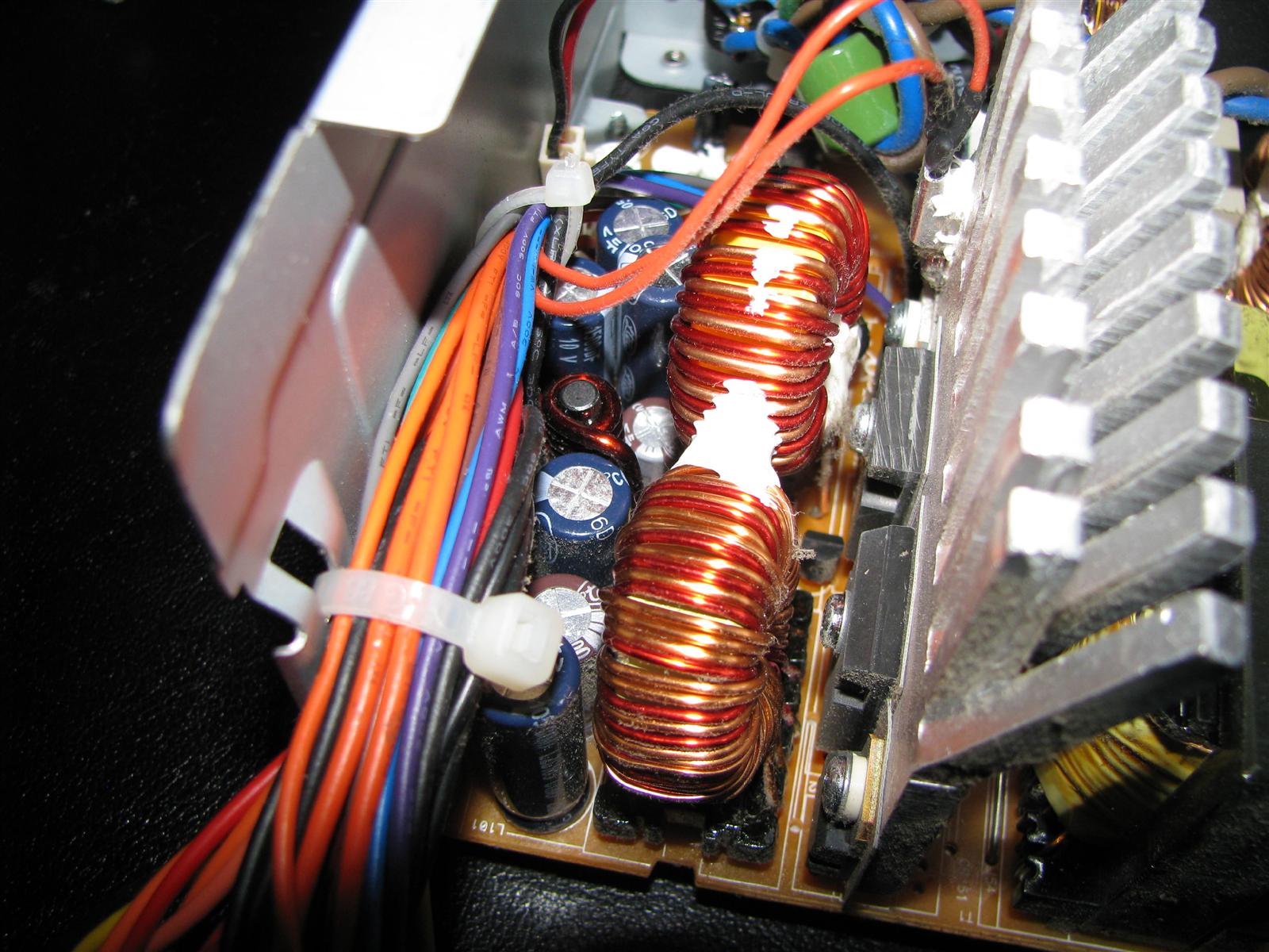

                    Enlight GPS-300AB-100 V
                    Looks like a typical 300W Delta design. Heat sinks are nice and thick.
                    Samxon 560uF Primaries. This is a single transistor forward design with a Fairchild FQA8N80 as the switching transistor.
                    Lousy Trash Electrolytic Capacitors are used throughout the secondary. Rectifiers are 30A on the 5v and 3.3v rails and 16A on the 12V. Obviously, it's an older design.

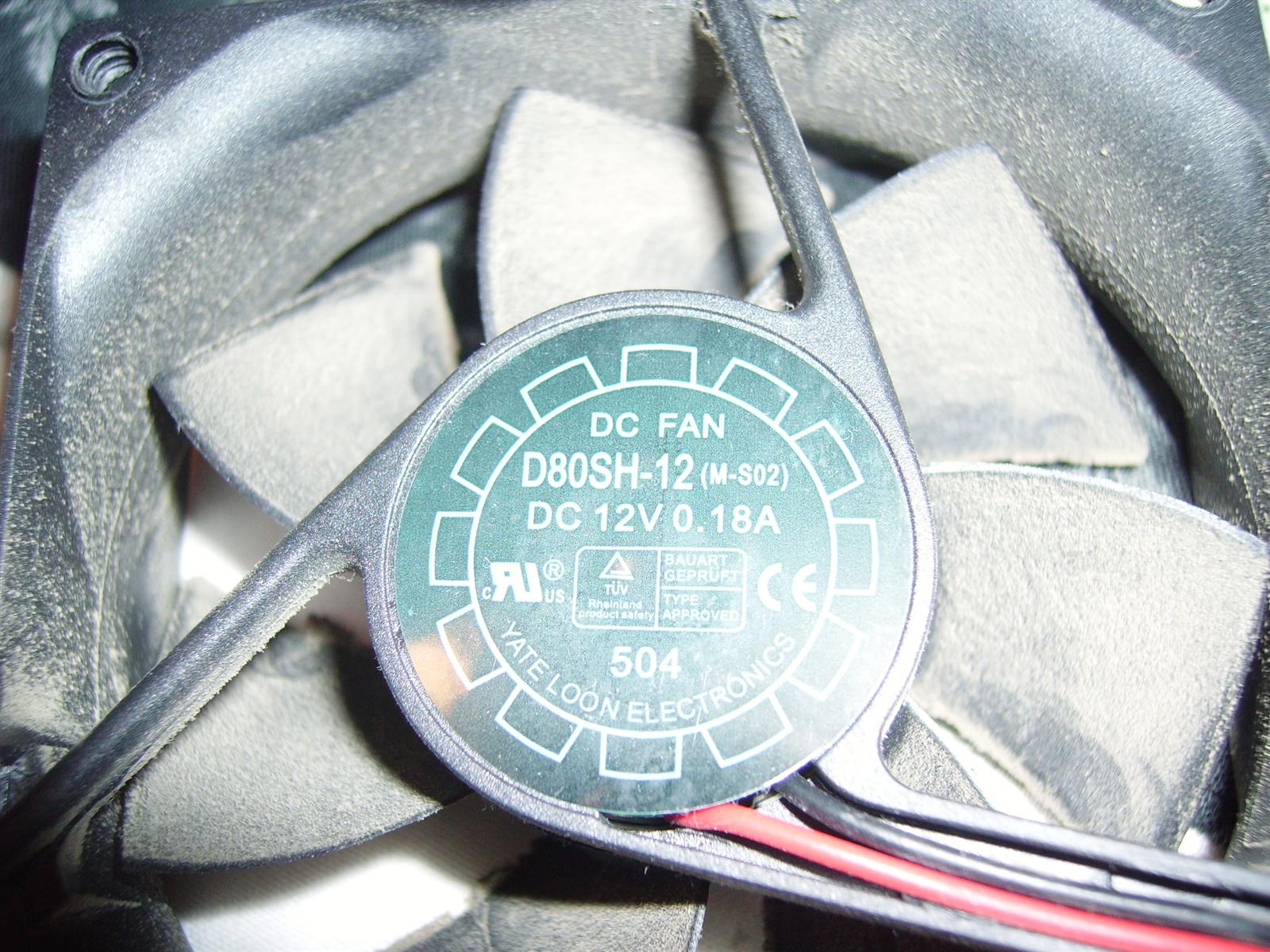

                    Fan is a Yate Loon sleeve bearing. Not too bad, but a Delta fan would have been nice.
                    As usual, Delta's soldering is great, but there's some heat discolouration near the 5vsb area. Most of it seems to be just before the transformer (on the primary side, near R902 and D951).
                    And yes, that diode is practically touching the cap. Considering that there is discolouration around the 5vsb input cap (which is the only capXon in this PSU), I'm surprised it's not cooked yet.
                    As for mods, I'll probably beef the 12V rail up to 30A or so, and replace the 5vsb diode with a TO-220 one and mount it on the secondary heatsink, so it doesn't cook the cap. I'll probably also recap it with pannies and Nichicons.
                      Disappointing to know that Delta doesn't hesitate to improperly place diodes and use conductive glue in their PSUs. Not sure when Delta and Bestec will learn.

                        #791
                        They know exactly what they're doing. It's an inbuilt failure mechanism to ensure the thing breaks sooner rather than later so you'll buy another one.
