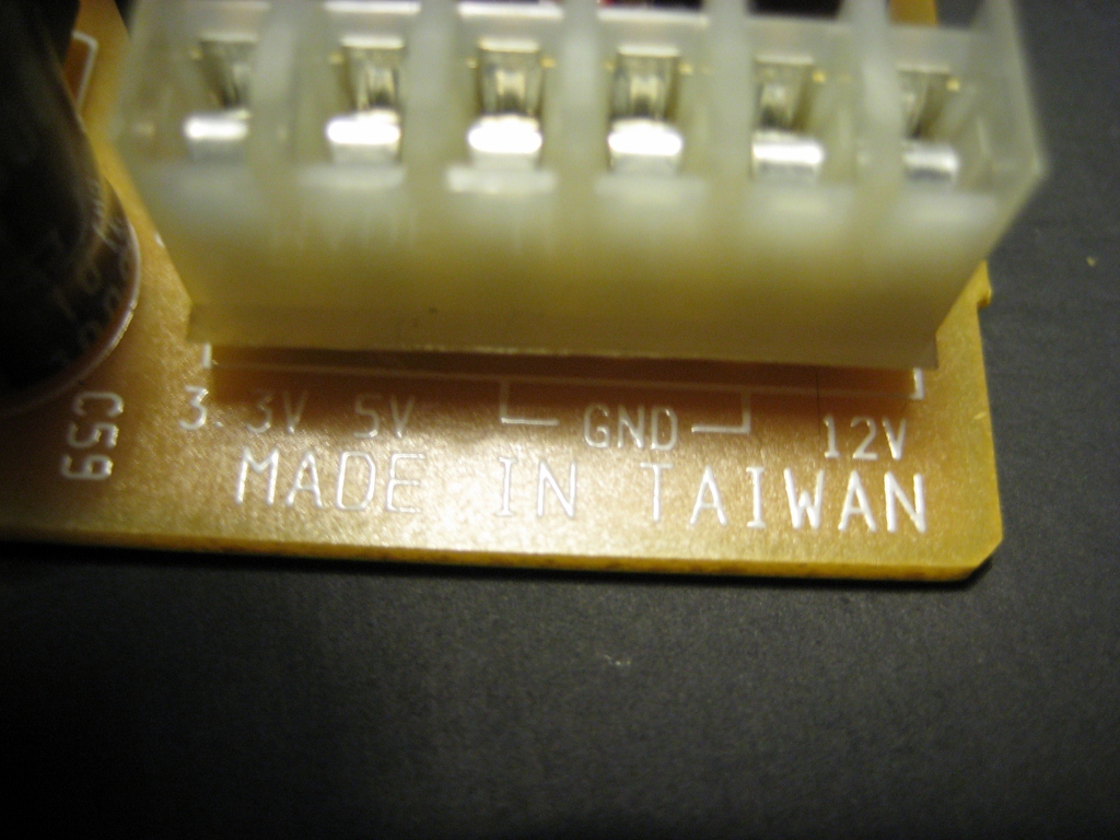

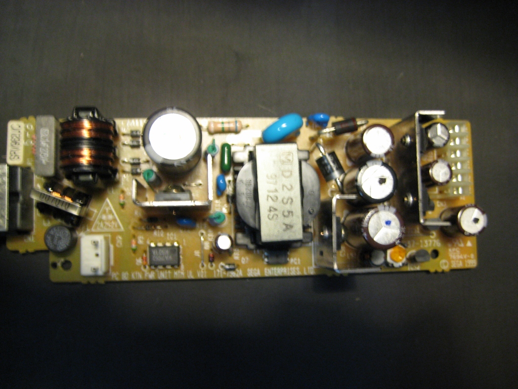

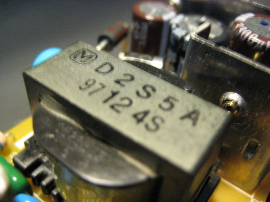

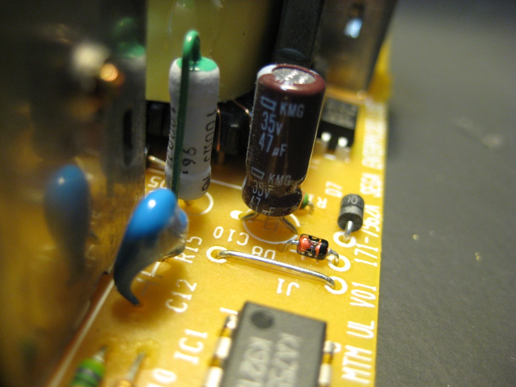

            Sega Dreamcast switching power supply:
            It uses primarily Nippon Chemi-con along with two Rubycons. Rubycon YXA on the bulk PFC filter. Matsushita (Panasonic) transformers/coils as well as a Matsushita X film cap on the AC filter.
            Output voltages are 3.3v, 5v, and 12v, just like a normal computer.
                because it basically is one. runs a modified Windows CE
                • TheLaw
                  • Jan 2011
                  • 477
                  #308
                  Haha...although I think there might be different reasons for the voltages...
                    No PFC on this power supply. Rectified mains go straight in that bulk primary capacitor. From there on it's just a plain old single-transistor forward configuration.

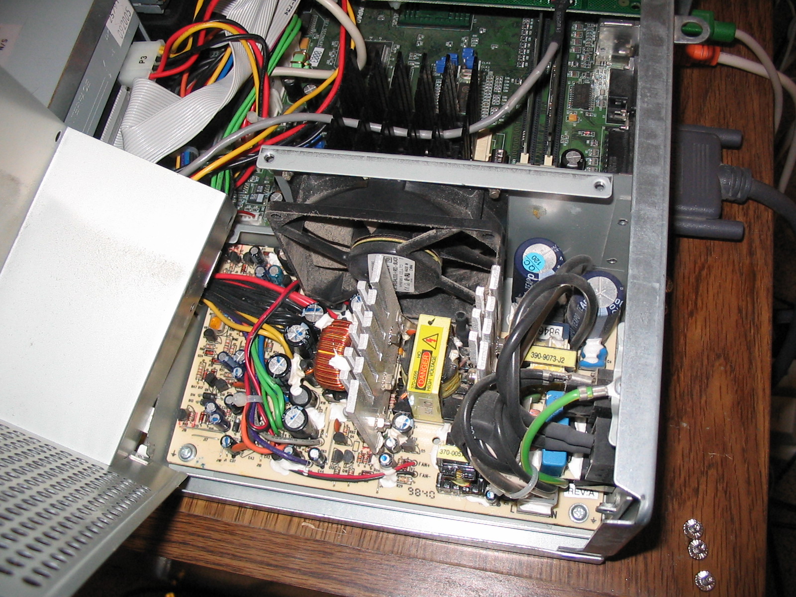

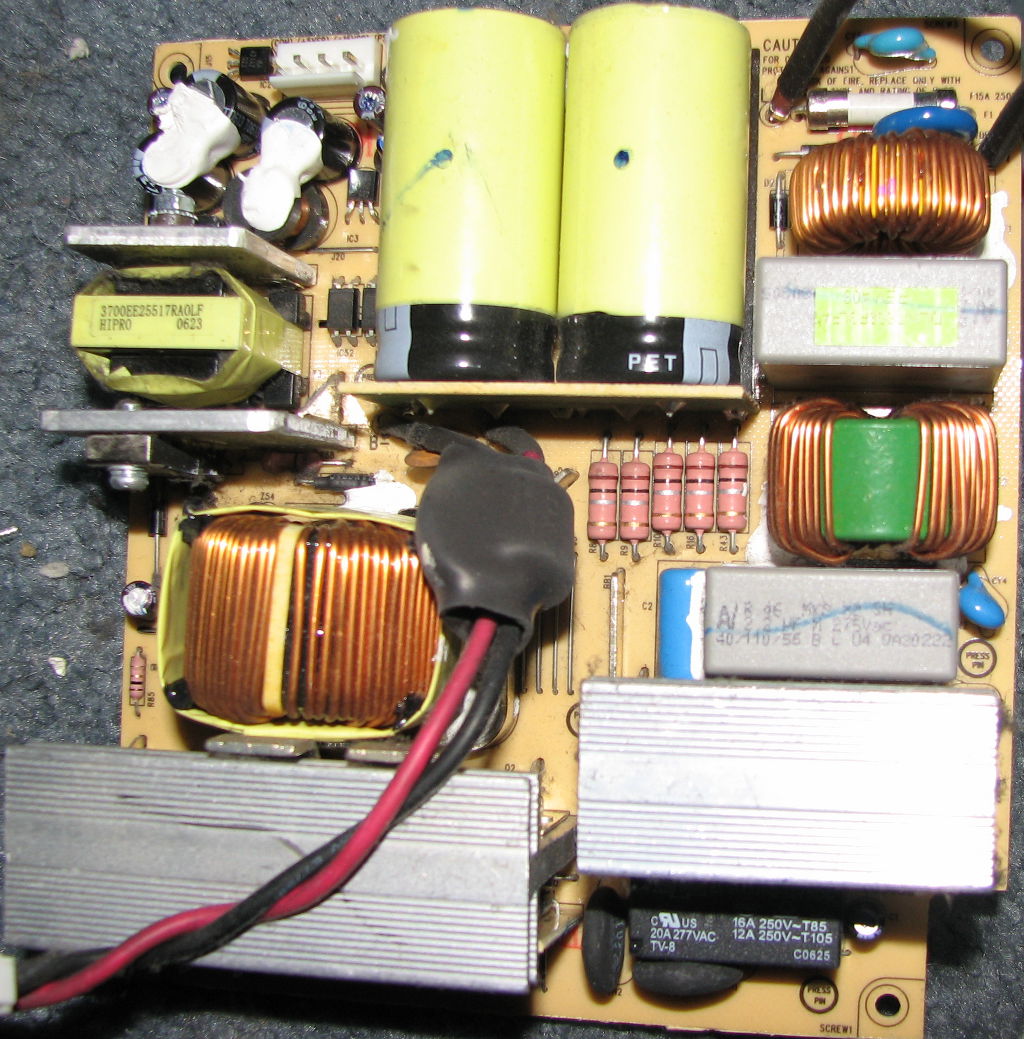

                      This is a Hipro HP-Q075YF5 from a Compaq Presario 2286. Yes, it's only 75 watts.
                      The caps are a mix of Teapo, G-Luxon, Su'scon, and a single Ark cap (the green one).
                      The fan is a Minebea 3110GL-B4W-B24. It is extremely loud and moves almost no air. It was this way from the factory.

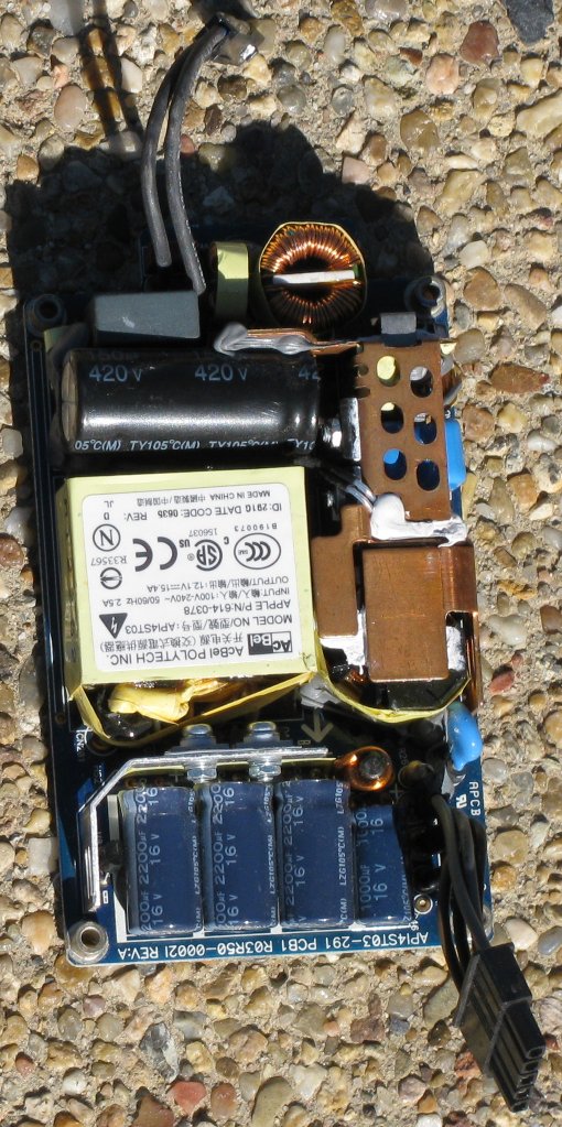

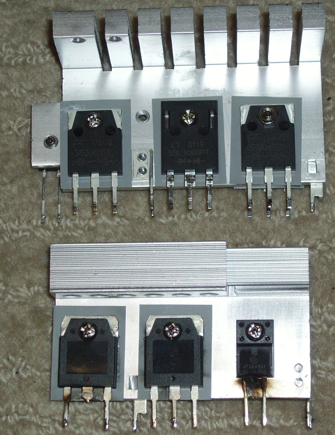

                              AcBel API4ST03
                              600V 1.5A bridge rectifier.
                              FQP20N60 PFC stage with UGF8JT rectifier.
                              SPA11N65 output stage.
                              PHP110NQ08T x2 synchronous rectifier.
                              150uF 420V Ltec TY Series primary unit.
                              2200uF 16V Ltec LZG before output inductor with 1000uF 16V LZG after it.
                              All other electrolytics are Ltec.

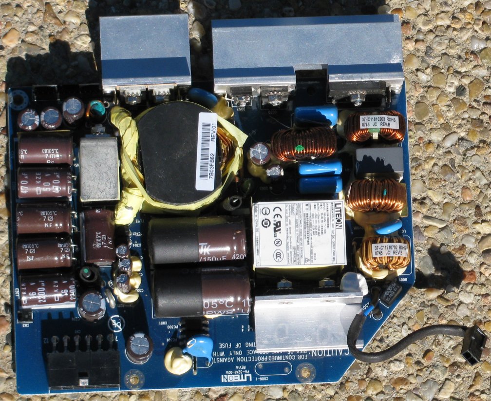

                              LiteOn PA-3241-02A
                              8A 800V bridge rectifier.
                              TK20A60U MOSFET with STTH8L06 rectifier in PFC stage.
                              IPP60R165CP output stage with GT5408 rectifier.
                              IPP08CN10L x2 synchronous rectifier for 12V rails.
                              V40120C rectifier for +24V and +12V rails.
                              150uF 420V TK UPWS x2 prinary units.
                              2200uF 16V Chemi-Con KZH x4 with 470uF 16V Nichicon PW after IPZB06N03LA switch on +12Vm (10.5A) rail.
                              470uF 16V Nichicon PW on +12Vs (5A) rail.
                              470uF 50V Chemi-Con KZE x2 on +24Vs rail with 100uF 35V Chemi-Con KY x2 and 220uF 35V KY after IPD06N03L switch.
                              Other Primary and secondary capacitors Chemi-Con KY Series with one 100uF 10V Taicon VT Series on the secondary.

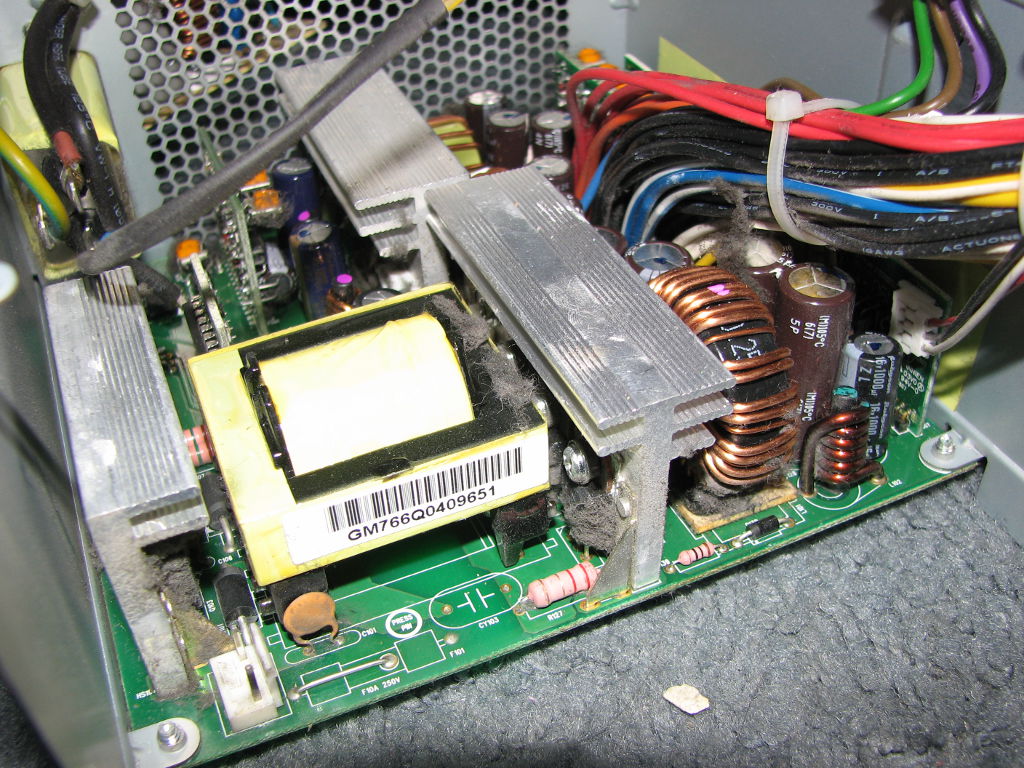

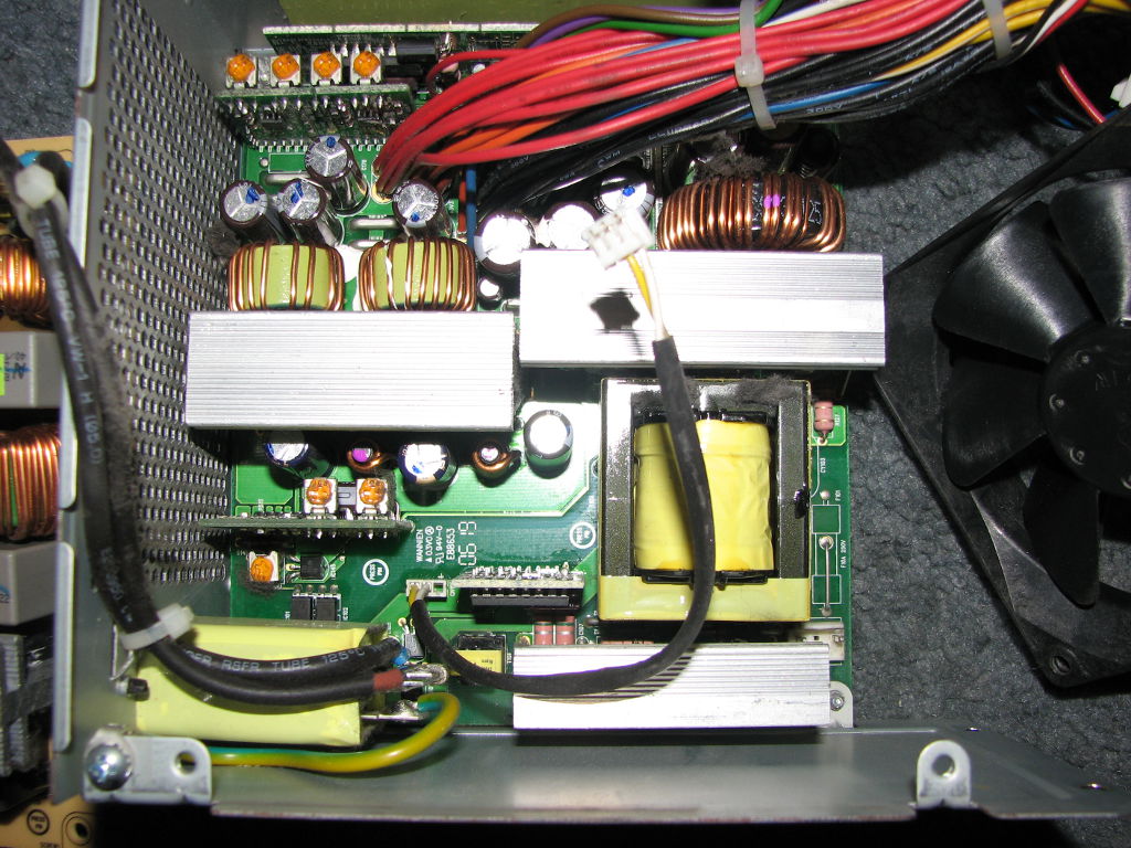

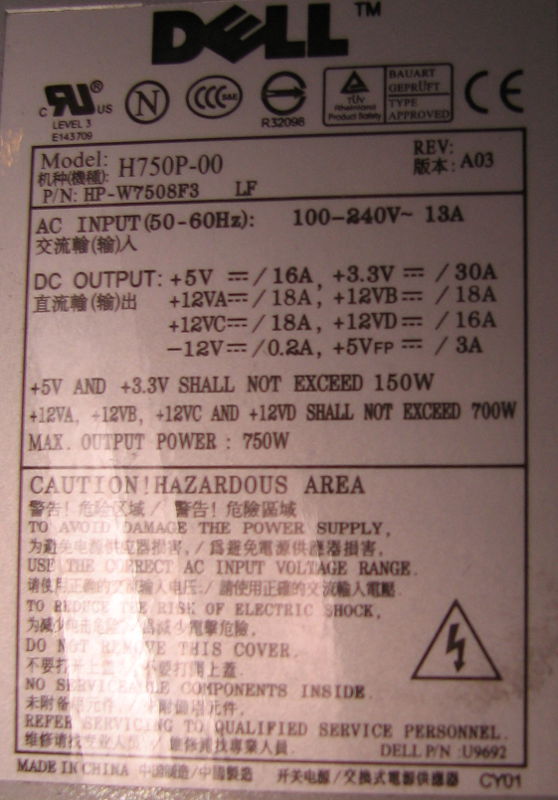

                                This is the power supply out of my Dell PowerEdge SC1430. Rated 750W.
                                I think the primary caps are Rubycon, just from the design of the negative stripe. Everything on this is Rubycon or UCC, even the small caps.
                                Also, it does not show up, but there are two bridge rectifiers in parallel on the first heat sink. I started trying to get part numbers, but some of the switchers have metal plates over the front. For additional cooling I guess. Either that, or some other part is right up against them. Its actually pretty roomy, just where there are components, they are backed up right into each other. So I gave up.

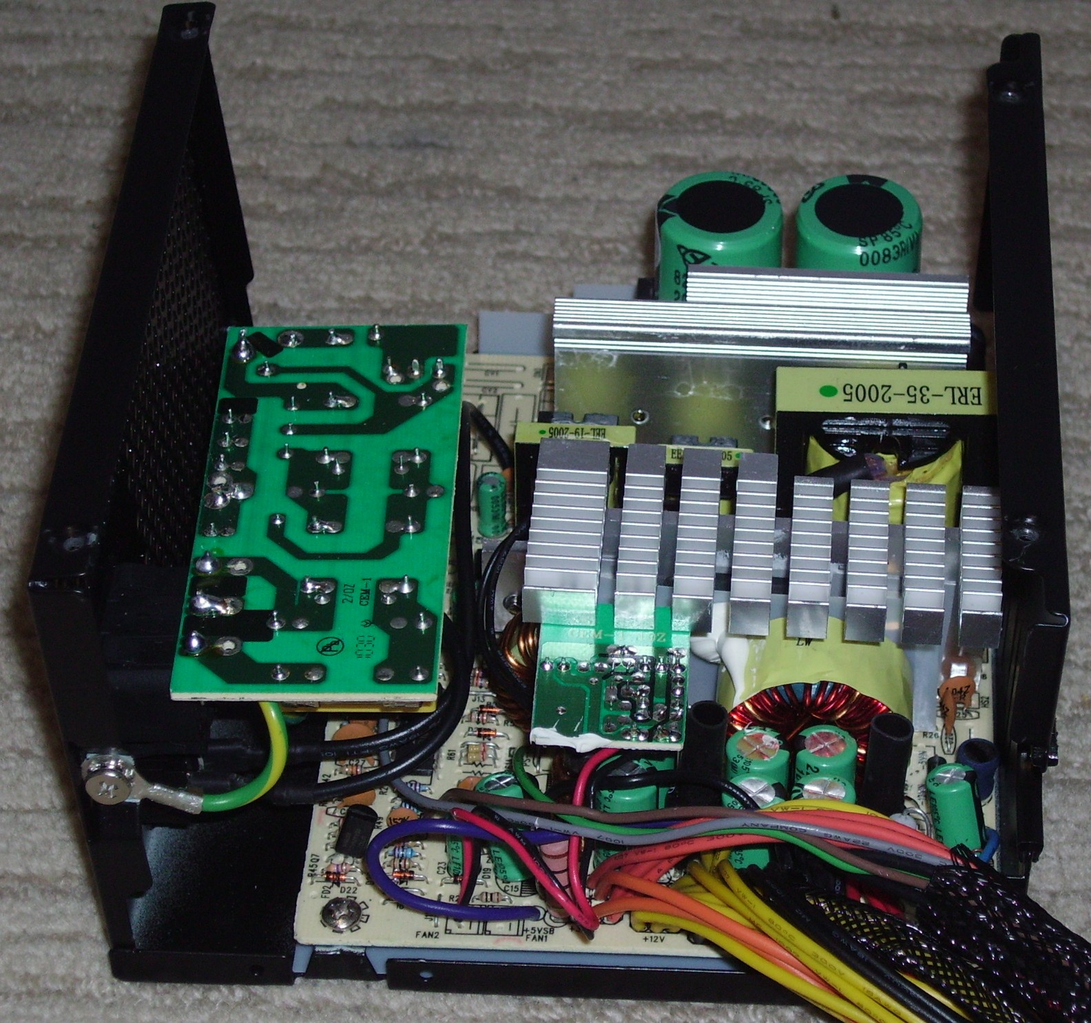

                                  Xigmatek No Rules power 500W NRP-503VC.
                                  It's a middle of the road solytech build and it certainly didn't follow the rules for testing. ripple was a bit high on the 3.3v rail when above 250W Load (around 60mV) and it exploded at 450W load. Caps are Yang Chun and the fan is solytech's favourite brand, (globe fan). Any idea why all three transistors includding the 5vsb one blew even though the 5vsb was only under 1A load from 200W onward? Perhaps the heat sink was hotter from the other two transistors?

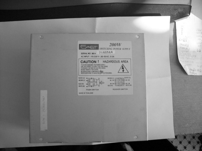

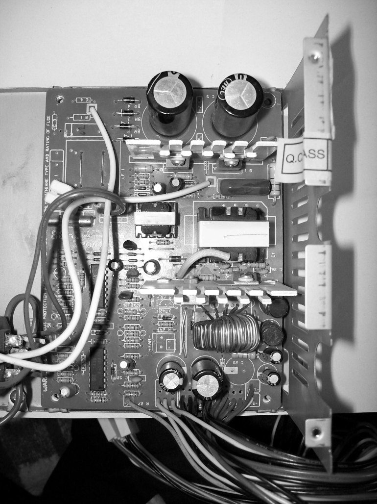

                                    AT power supply that was very "popular" here. The specs are a mystery but once someone opens it up... no ac filter at all. Diode for 5v is s15c40c and two pr3004 for 12volts. Capacitors are Jpcon.
                                    This one was working but I decided to the add the missing parts and replace the transformer and diodes just to see what happens. I haven't had the courage to power it up yet.

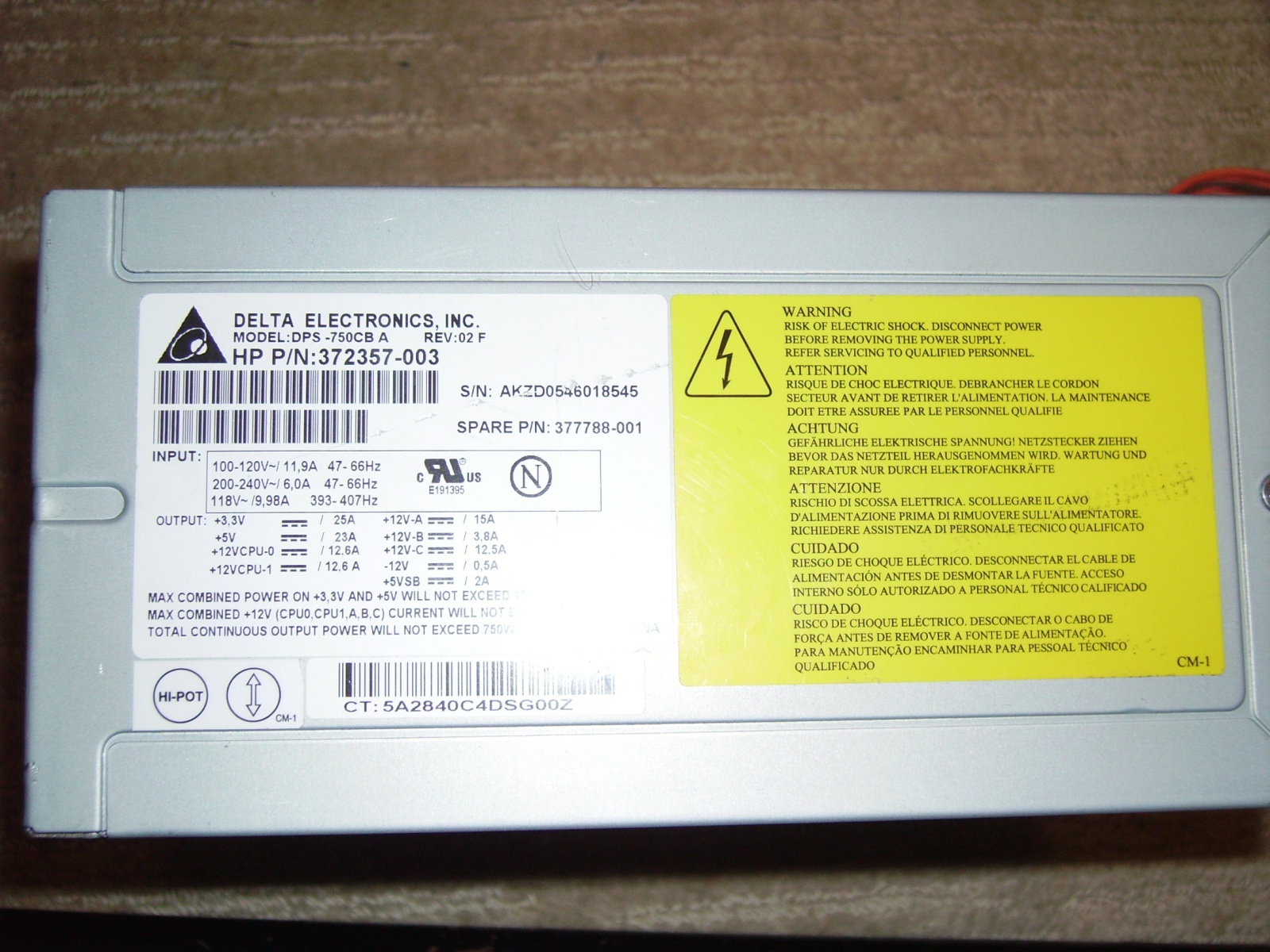

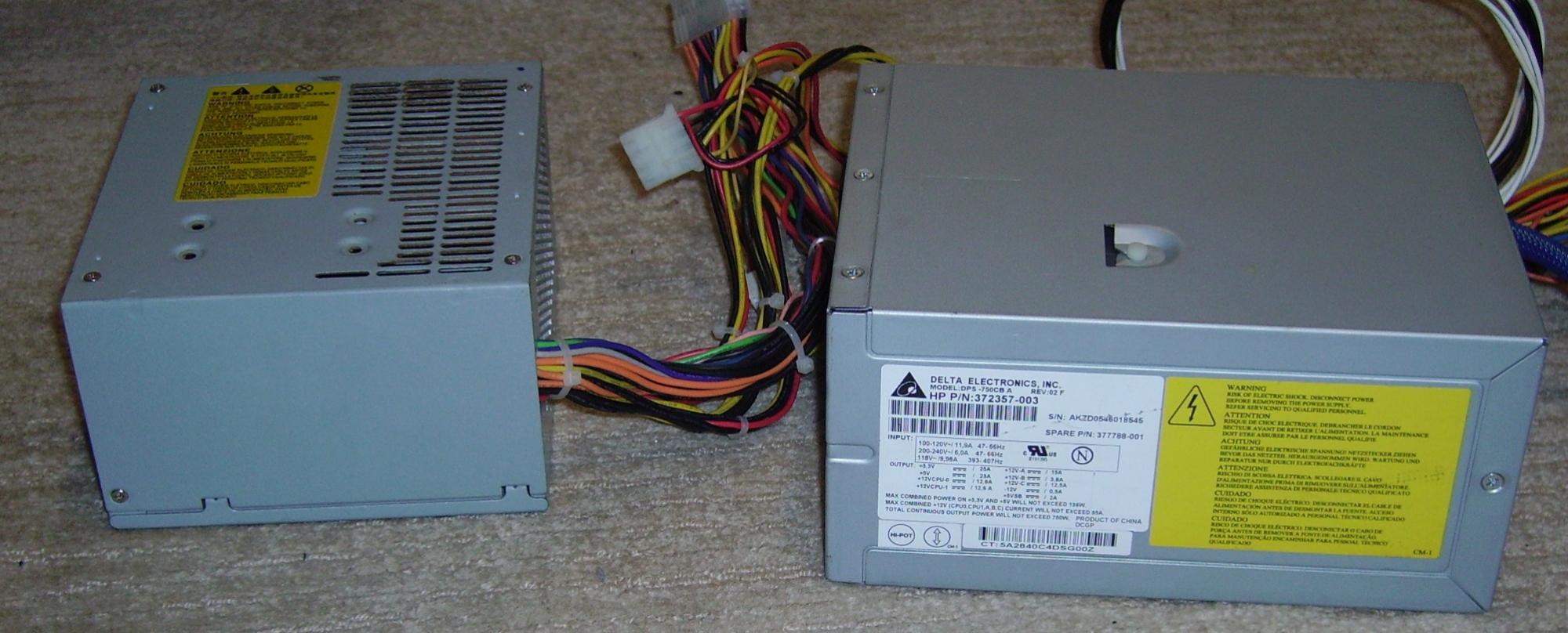

                                      Delta DPS-750CB. Originally from a HP workstation, but currently powering my main PC. In the first Pic, the PSU to the left is a Bestec ATX-300-12Z, just for a size comparison. The unit does actually have five 12V rails. 2 for the CPU, 1 for the graphics, 1 for the ATX connector and 1 for the peripheral and SATA connectors. The fan is a delta Ball Bearing 92mm, and the caps are entirely Japanese (Rubycon, Nichicon, and Chemi-con) with the exception of one tiny LTEC.

                                        which transistors are on the reverse side pa-3241-02a ?
