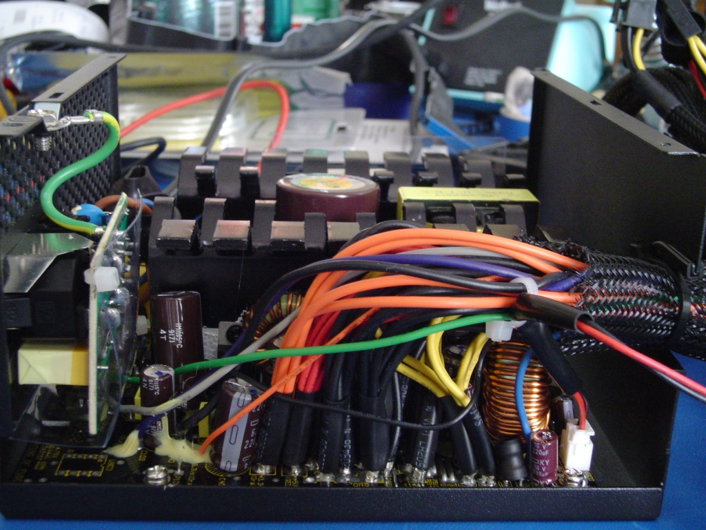

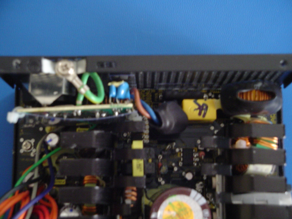

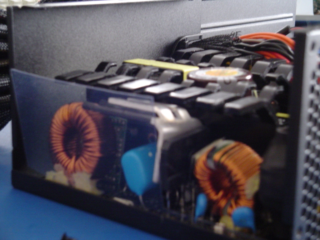

              After 5 years of faithful service, I've retired my Antec ToiletPaper II-550. Been having problems with TV tuner card crashing and shutting down. Caps were the usual F-you's but none were bulged or leaking.
              Replacement (not installed yet) is a Corsair CMPSU-650TX. $88USD at Compusa (or 80 after rebates at Newegg). I needed a new one and didn't want to wait for the Seasonic M-series 520 which was $20 more.
              According to the reviews I found, this unit is OEM'd by Seasonic. I'd like the senior members abd guru's to verify by my pics. Sorry about the blurry ones, old 3.2MP camera. All caps are UCC's except for one Rubycon (YXG) and all are 105C! This unit is not a 'golden sample' I went into Compusa and picked it off the shelf.
              My only complaint was the ground wire from the power inlet board was never terminated to the case. It wasn't worth the hassle to get it swapped for another one. A spare PC case screw took care of that and I took pics for you while I had it open.

                #287
                Yup, definitely a seasonic. Can't tell you what platform specifically, but it is definitely a seasonic.

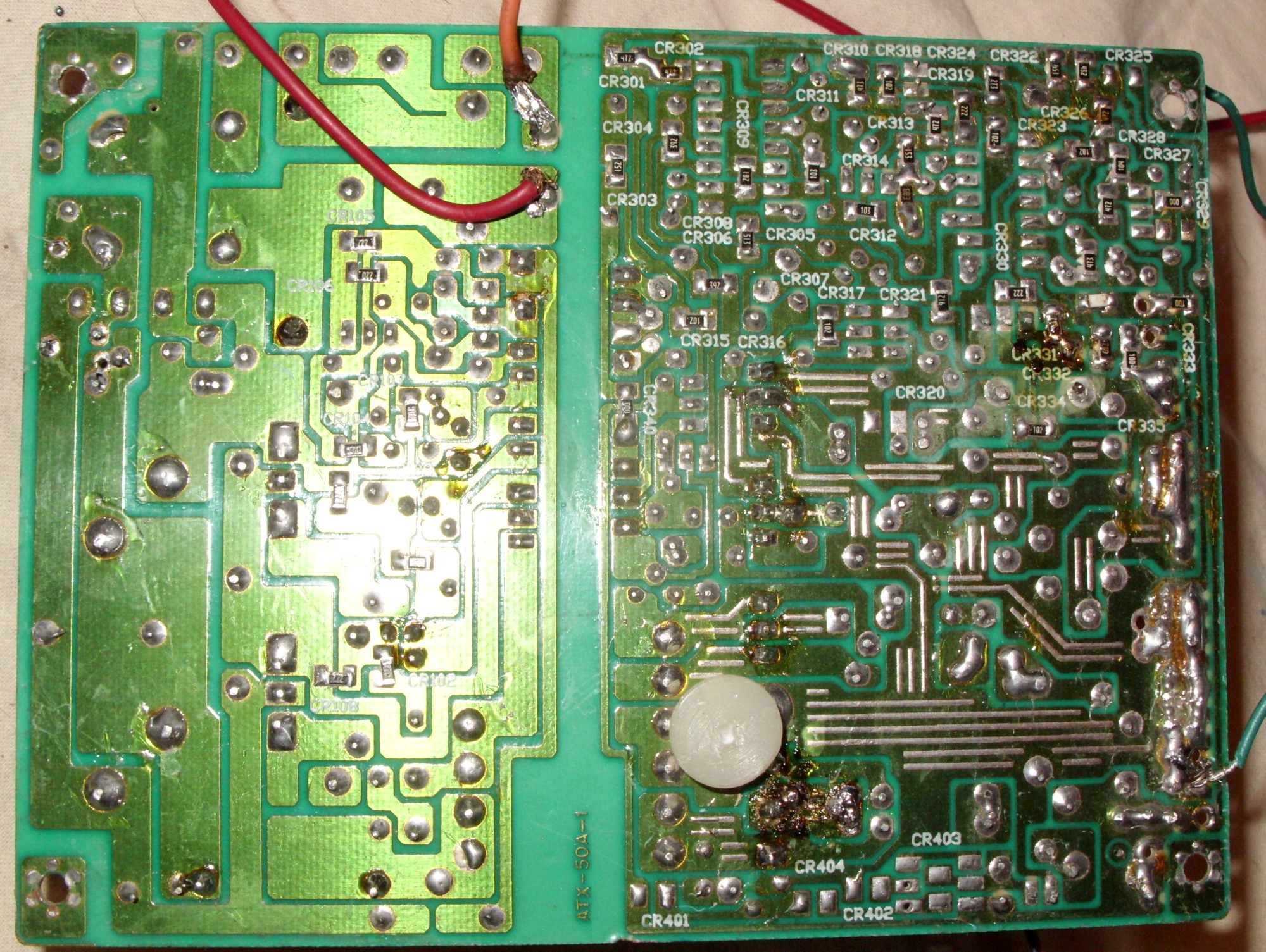

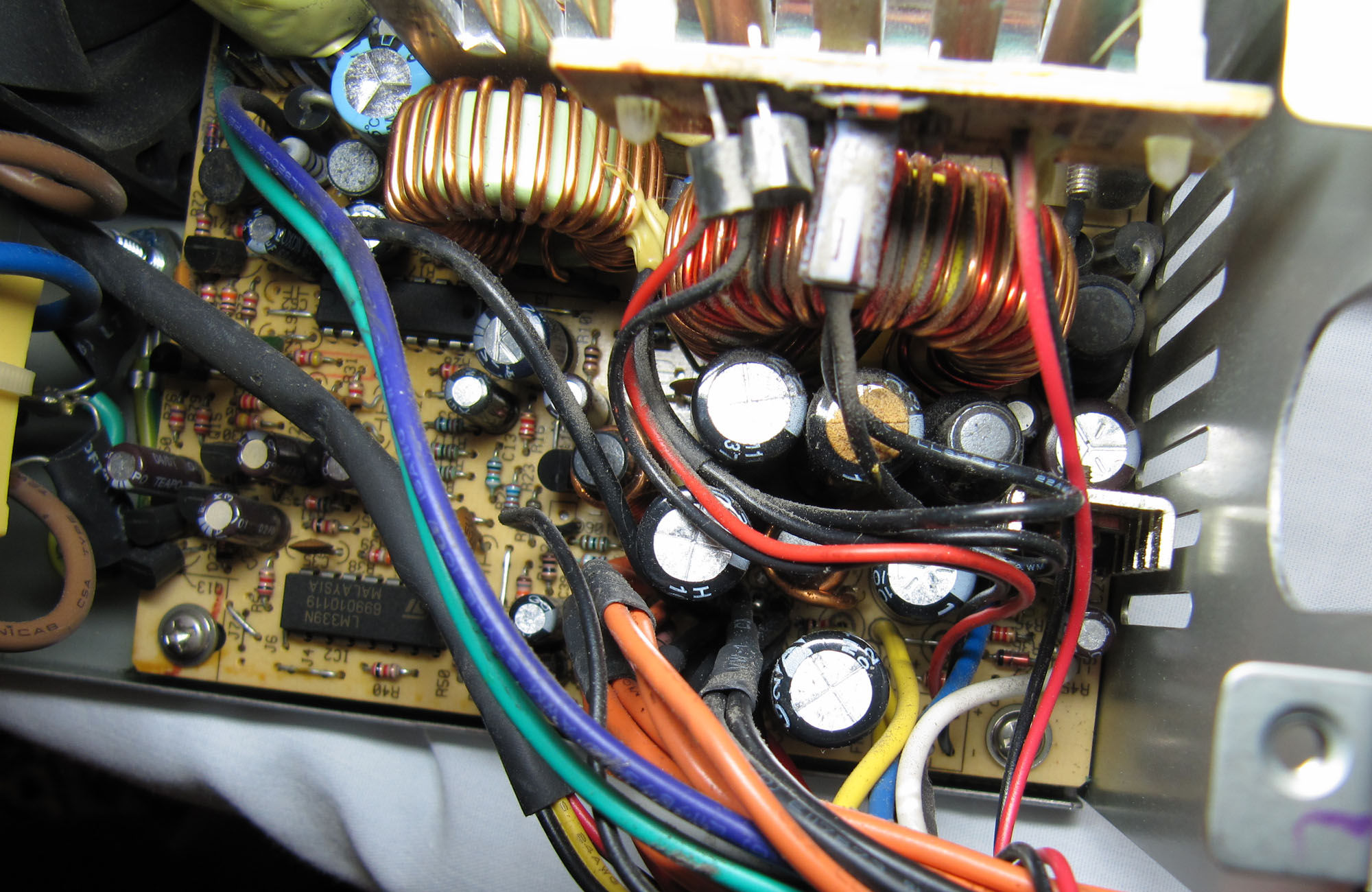

                        Another two. First, a Deer DR-240ATX. You've seen this one before, i'm sure. Viva primary caps, lame output rectifiers, Rulycon secondary caps... just the usual. This one still ran (no wonder, since there's a linear reg for the 5vsb) and output voltages were somewhat correct, but due to the failed Rulycons, we had a little ripple.
                        • 200mvpp on 5v
                        • 1.2vpp on 3.3v
                        • 1.5vpp on 12v
                        That is with just the fan connected. You can imagine what this would do to a computer. Can you say popped capacitors?
                        Second is a Young Year ATX-50A, from what i found it's 250W. Quite well built for a 250W if that's the case. I actually like the looks of this one, but it's filled with fukyoos in the secondary. Primaries are Teapo. It still runs, 3.3v and 5v are okay, but 12v is at 6.80v. There is about 100mVpp ripple on all rails and this 100mVpp is riding on top of 200mvpp 50Hz ripple. There are burn marks on the primary coupling capacitor, i think that's where the trouble is coming from. What's interesting is that the PS_ON and Power Good wires have reversed colors. Could be an OEM PSU.
                        The PCB is clean, with SMD resistors on the bottom. This one's worth fixing i guess.

                          #292
                          Wrong readings, excuse me. Ripple is <30mV on the Young Year, however 12v regulation... doesn't exist.

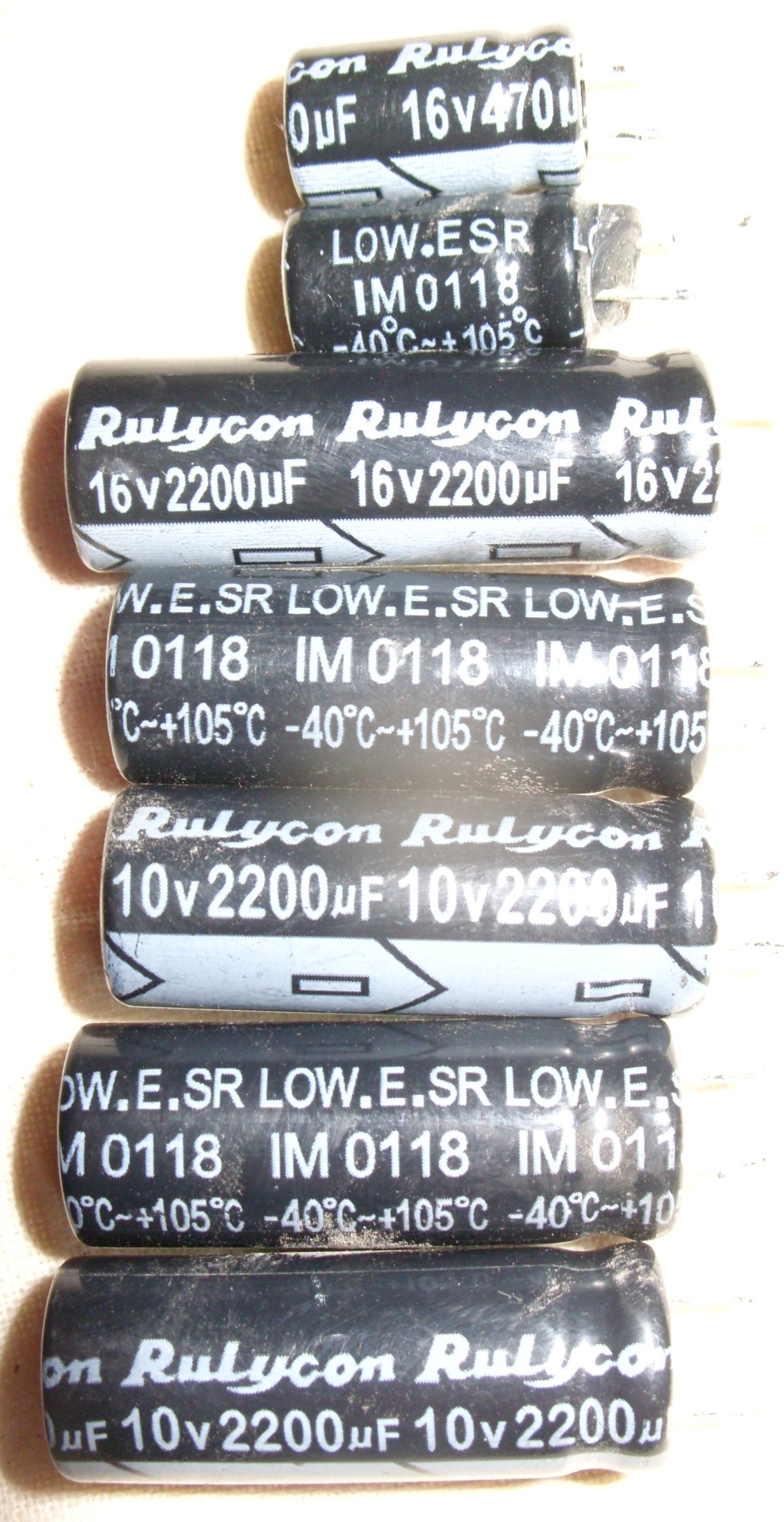

                            I have a CompUSA 250 watter which was full of bloated Rulycon capacitors. I removed all the Rulycon caps and replaced them with Fuhjyyu pull outs that measured good on the blue esr meter (as a joke). The power supply now works!!! Still a gutless wonder unknown OEM but at least it works.
                            Old proverb say.........If you shoot at nothing, you will hit nothing (George Henry 10-14-11)

                              #294
                              Not this particular one, but I have two older units (1 Deer and 1 L&C) that are very close to it. The Deer has identical primary side and identical cap/inductor configuration for the secondary and also quite a few Viva caps. But the logic circuit configuration looks more like the L&C (KA7500 PWM and ST LM339 quad op-amp).
                              The Deer was made in '99 and the L&C in 2001, so yours must be some intermediate model. The self-oscillating, no-feedback 5vsb circuit with linear regulator is the other thing that gives it away - only vintage Deer's and L&Cs had it.
                              ... but due to the failed Rulycons, we had a little ripple.
                              • 200mvpp on 5v
                              • 1.2vpp on 3.3v
                              • 1.5vpp on 12v
                              Little? More like huge torrents! I think you will end up with more than just bad caps on your motherboard.

                              It's not unknown. In fact, it's very well known (no the kind of fame you want, though). Ladies and gentlemen, I present you the one and only... POWMAX
