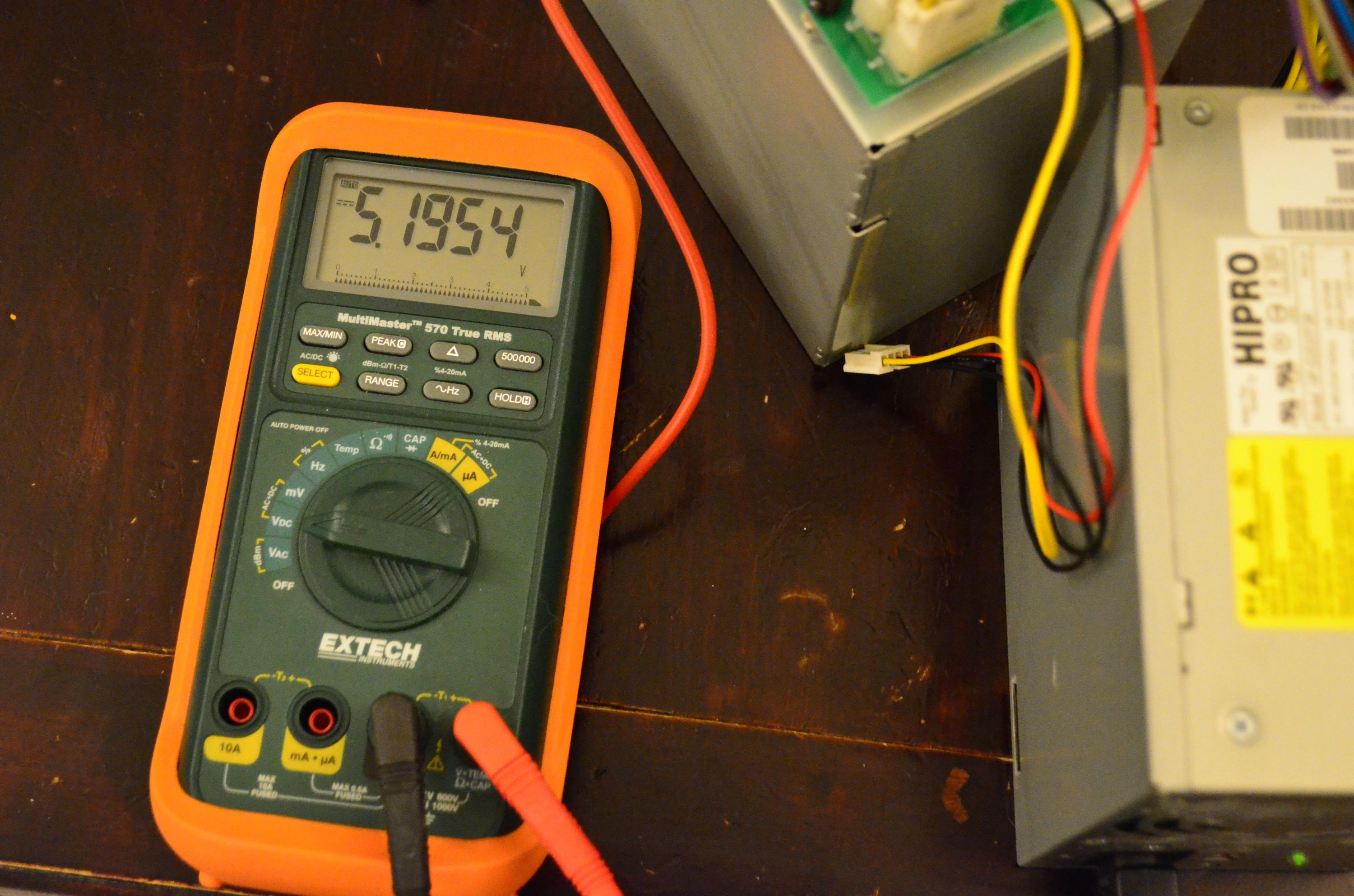

Load test 12V@13A, 5V@10A 3.3V@12A (246W total)
Voltages:
12V: 11.868V
5V: 5.1954V
3.3V: 3.3570V

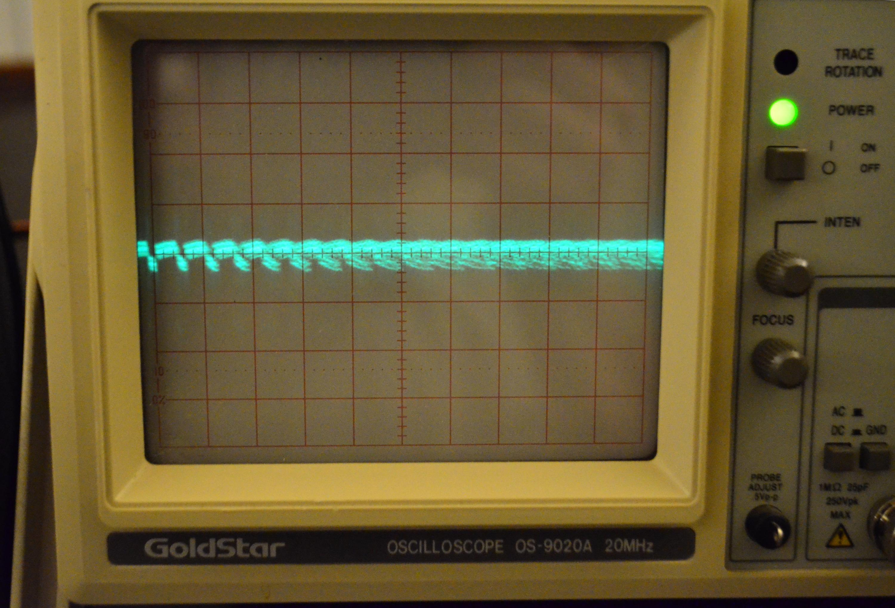

Oscilloscope shoots (scale set to 20mV per division, same load):
12V:
5V:
3.3V:

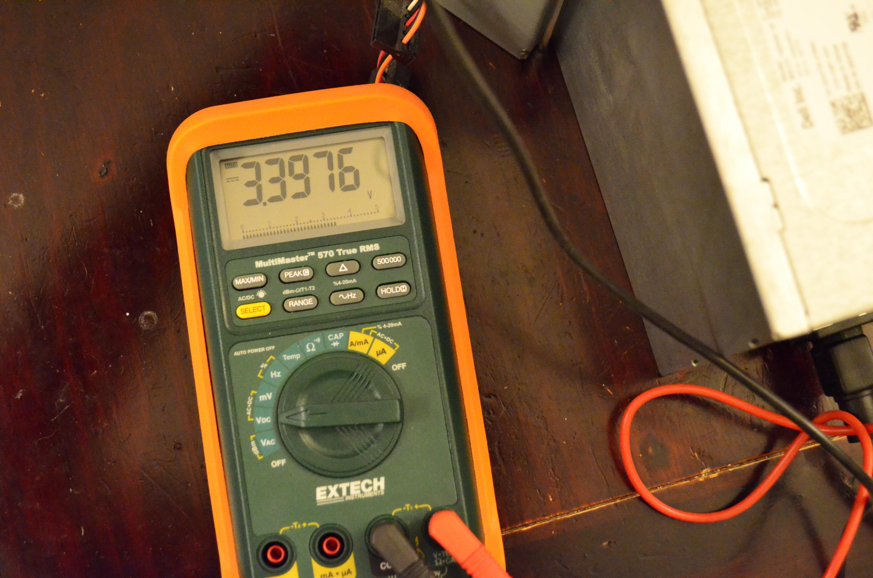

Voltages:
12V: 12.084V
5V: 4.9751V
3.3V: 3.3976V

Oh, I'll take the HP-D2537F3R no doubt. The newer HiPro (H265AM-00), has APFC with Teapo as the main filter... ugh, my hopes aren't too high for it. Also, if I remember correctly, that model (or a very similar one) even had problems with exploding snubber cap. If that's not enough to sway me, look at the scope shots: the HP-D2537F3R has much cleaner outputs, thanks to its over-sized output caps (not to mention it's a breeze to find replacement caps for an oldschool HiPro like that, which usually can easily accommodate 12.5 mm caps, even in spots meant for 10 mm diameter caps).Comment

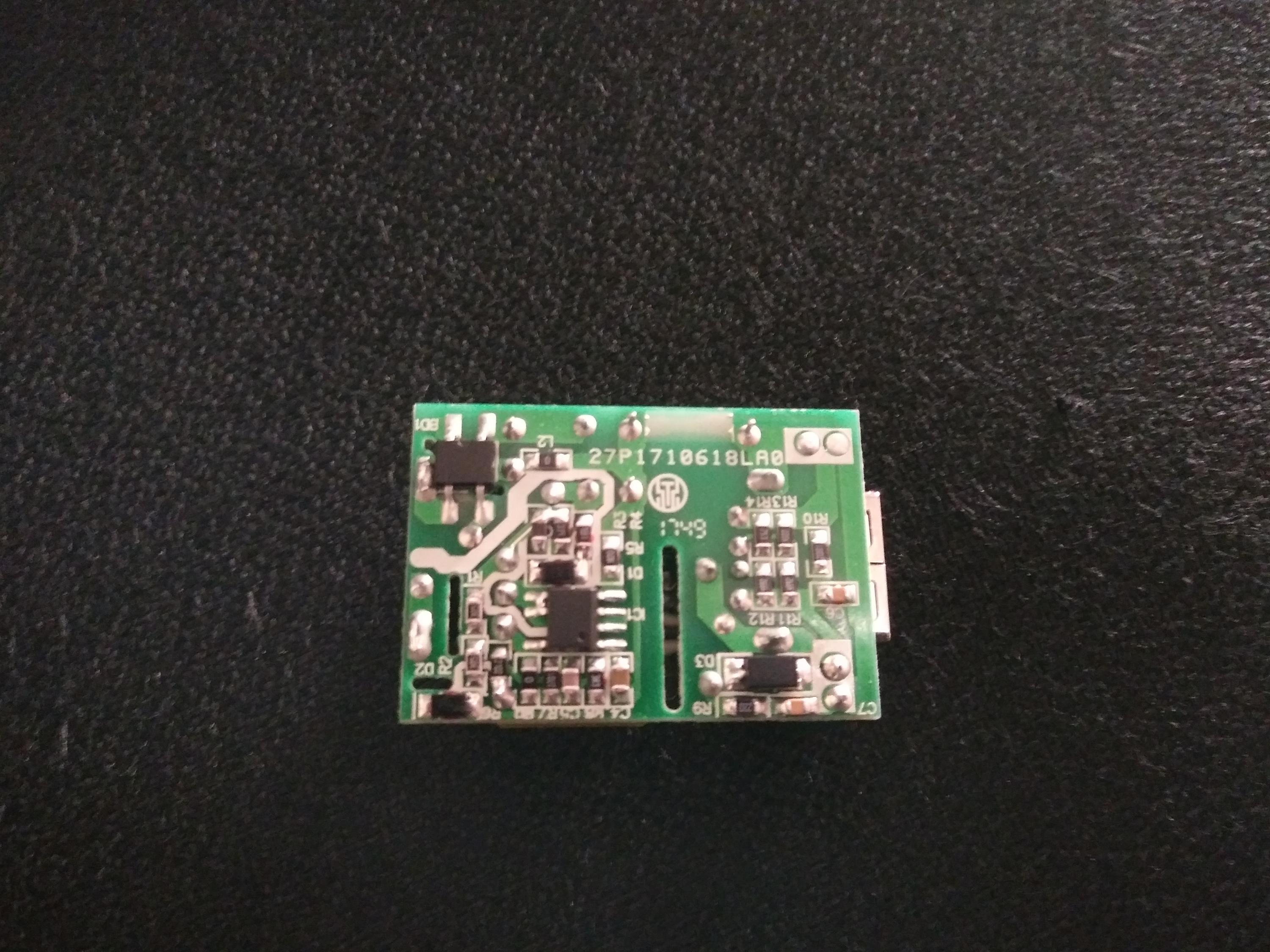

Bottomside.............................
https://www.badcaps.net/forum/attach...1&d=1524907593
Also looks ok.
