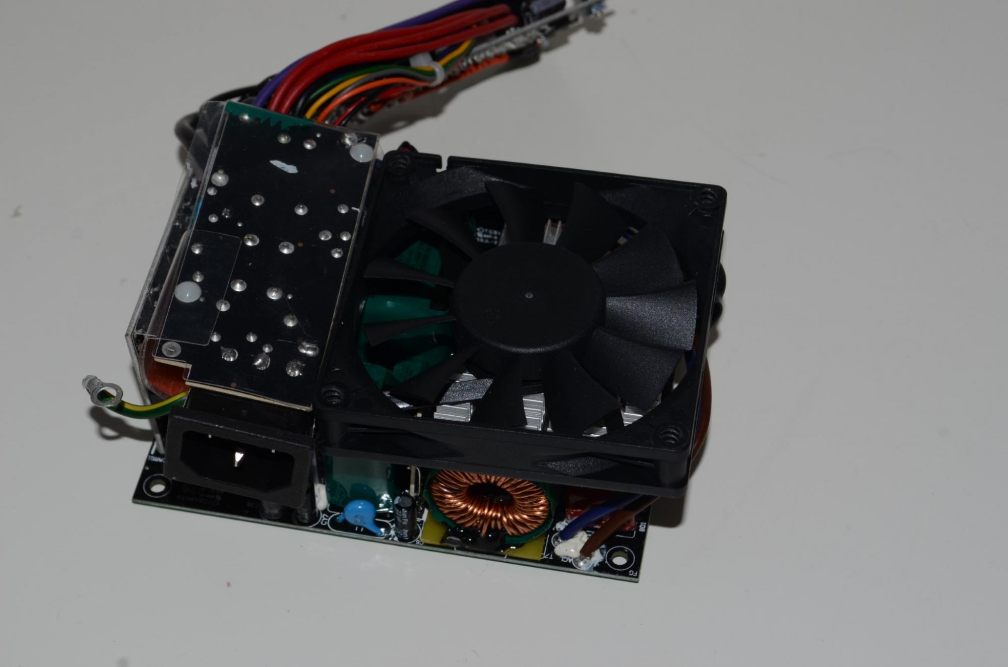

New unit, Caps are the usual parts box from CWT, though w/o AVL...
Fan is a Yate Loon D80SH-12B -> 12V, 0,7A
I kinda like the unit, not too loud under load (though only ~20°C Room Temperature right now).
BUT, there is one thing that I really do not like: Semi-Fanless without Hysteresis...
And of course the usual 8pin Protection Chip by Sitronix...

 All of the small “startup” caps on the primary tested bad too! Folks, this is why you don't ignore crap cap brands.
 The shunt does read 0.00 Ohms even on my component tester, though. So perhaps it's just there for extra current support (as the trace thins a bit in that location).
 and the crap-caps that could be a credible 305W PSU. It's over 12 years old, though, so whatever it was used in, it gave very decent life (assuming it wasn't sitting in somebody's basement or attic for 10 years). The 3843, MOSFET switch, and -52 material output inductors suggest a switch frequency north of 50KHz.
 And it probably doesn't get much airflow/ventilation from the fan.
