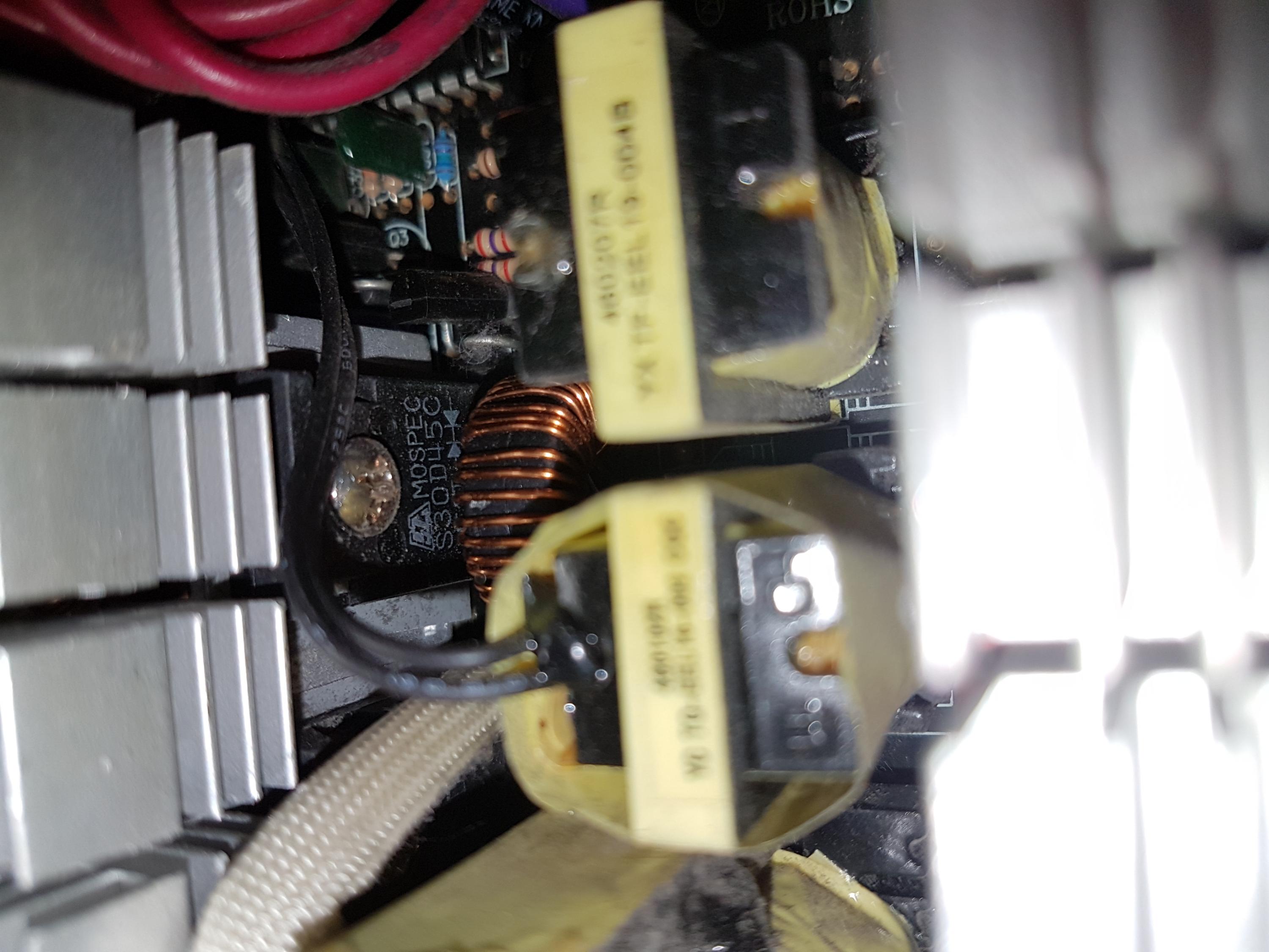

Here's a surprising one. Modem PSU, 10v, one and a half amps. Its a bodge-job replacement for a real POS. https://www.badcaps.net/forum/showpo...postcount=1326
Case shot.
Not inspiring....
Board topside.
This is promising! Good insulation, no Brown Gorilla Snot, plenty of filtering. Looks like the board has provisions for another rail. Actual safety rated caps.
Topside-BottomWise!
No bad solder. Plenty of isolation. Not bad.
And the Money-Shot!
Decent Chemi-Con caps.
Secondary Filter: 1000uF, 16v.
BootStrap: 47uF, 50v.
Primary Filter: ? It was wrapped in yellow tape... Very large though.
Goontrons rating: B for beautiful. Needs more heat sink, and the primary cap is resting on some large resistors. More than satisfactory for its intended use. Looks Delta OEM.
