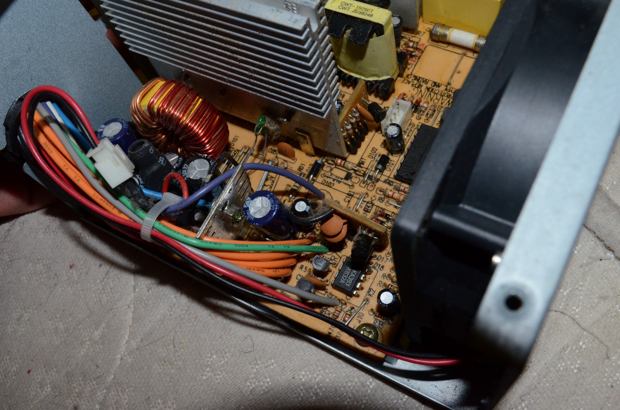

 And needless to say, it took me less than 3 seconds of viewing the second shot before I figured who made it. Also, the output Fuhjyyu caps were another big giveaway. But I won't spoil the fun here and let other folks try to figure out who made it.
) . It is interesting to note here that while Q102 and Q106 are in parallel, they each have their own gate driver circuits - hence why I labeled them on the schematic above as "A1" and "A2". Perhaps that's why Q106 didn't die.
 : Channel Well Technology (CWT), as obviously written on all of the transformers.
 Hopefully this might clue you in on the build quality, though.

 You can tell this PSU was made at a time when lower-ESR PSU-grade caps like Chemicon KY, Nichicon HE, and Rubycon ZL weren’t available or popular just yet, because most of those Nichicon PM’s have a much greater voltage rating than needed – a move probably done to decrease the ESR of the caps while maintaining a certain capacity.
