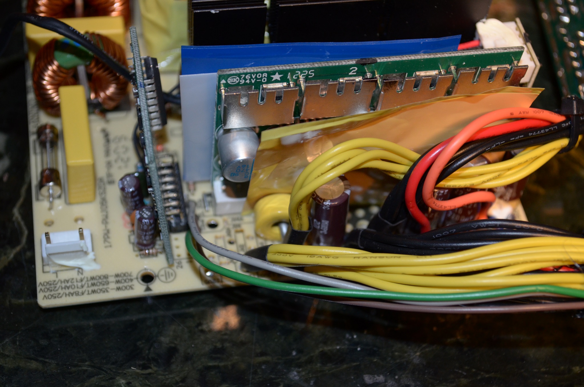

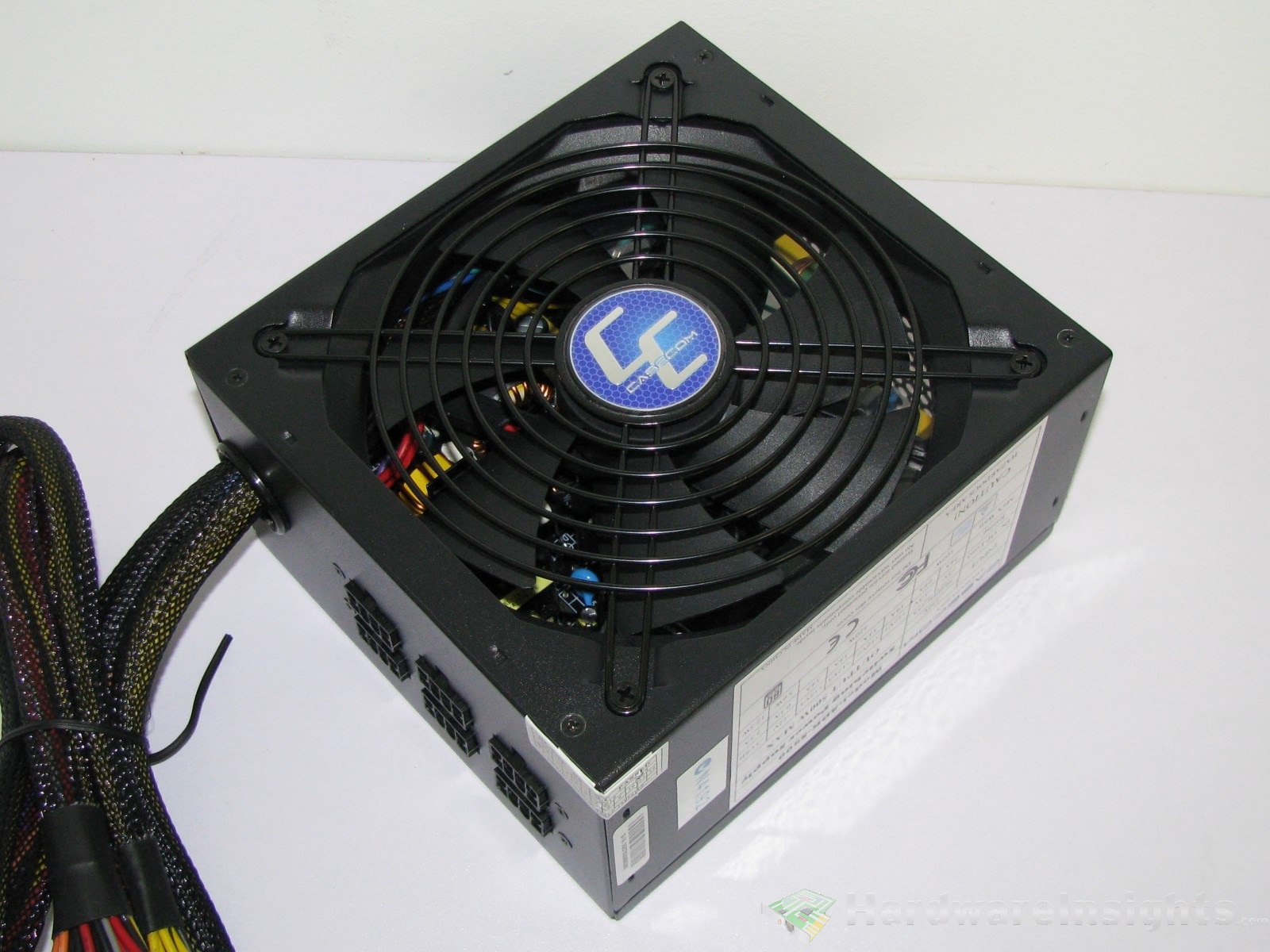

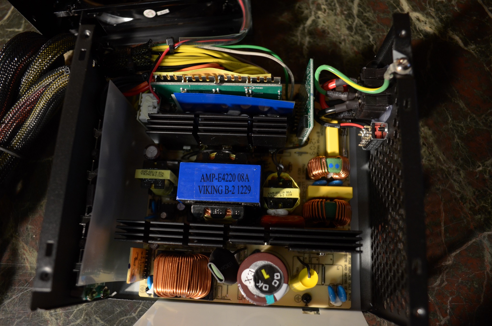

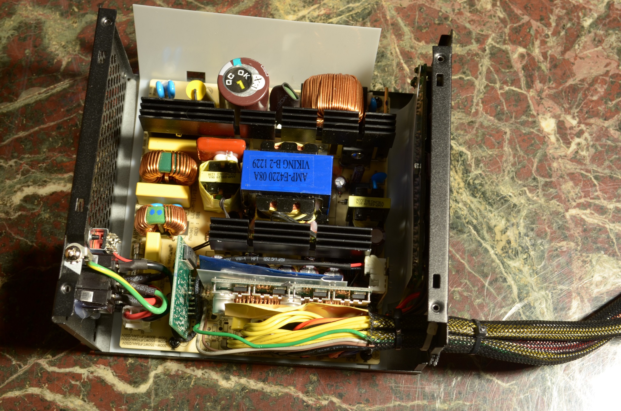

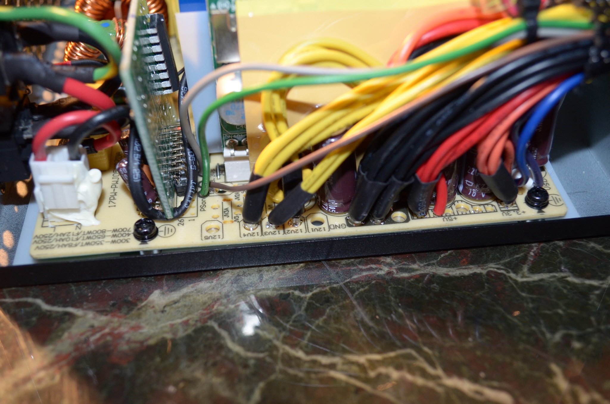

                  Casecom ADK-S500 (ie, )
                  I purchased this one with the intention of reviewing it. However, I think that this one might be a bit of an instrument fooler. I just don't believe some of the results, and elected not to publish them. However, I will show off its internals.
                  https://www.badcaps.net/forum/attach...1&d=1426237826
                  It sure looks OK. It's even modular
                  It is supposedly a quad-rail, but in reality, it's a single rail, as there is no OCP implemented
                  It looks pretty decent if you ask me, little wonder it did the full 500W in spec. I can't figure out who the OEM is, though.

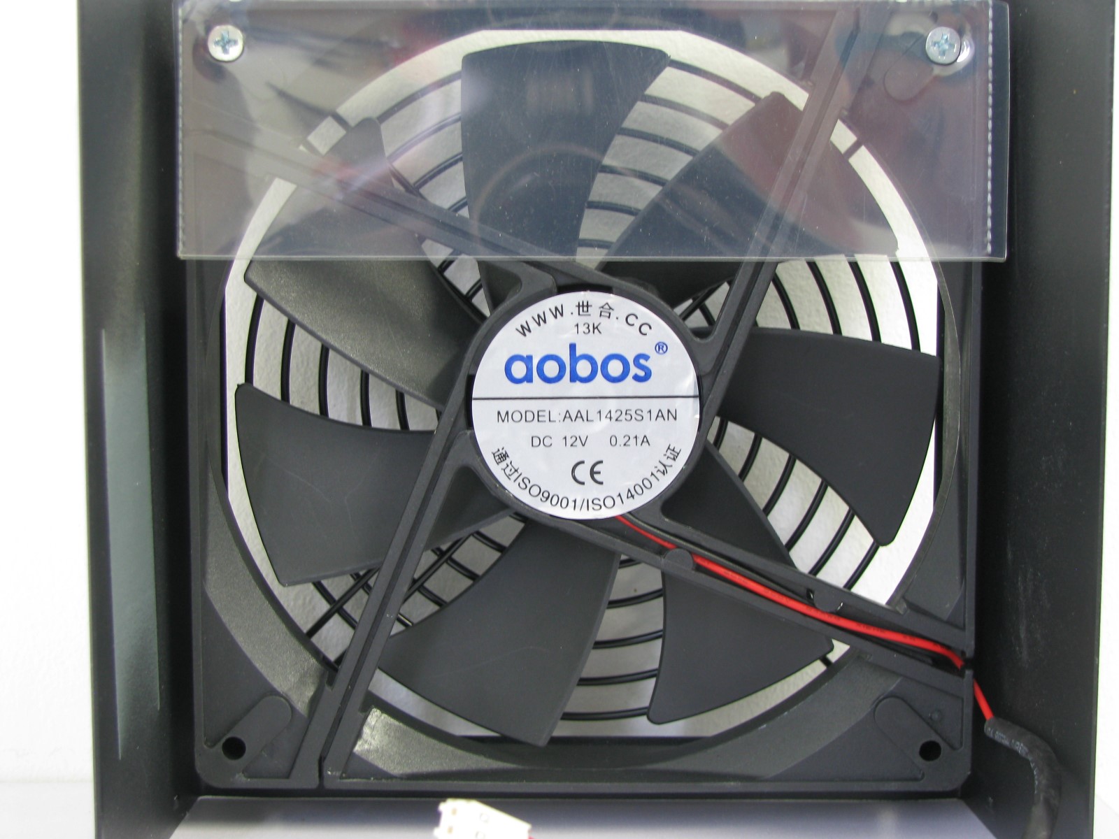

                  The fan is an AOBOS 140mm sleeve bearing (with only a tiny amount of thick grease). It get's noticeable above 300W load, but it's not all that loud.
                  The switchers and PFC FETs are all MagnaChip MDF18N50s. It seems that they are up to the job.
                  The secondary side. No DC-DC, but it is individually regulated.
                  The 12V rail uses Synchronous rectification with CET CEP6056 FETs
                  ChengX. Yuck! I'll be fixing that before I put it back together.

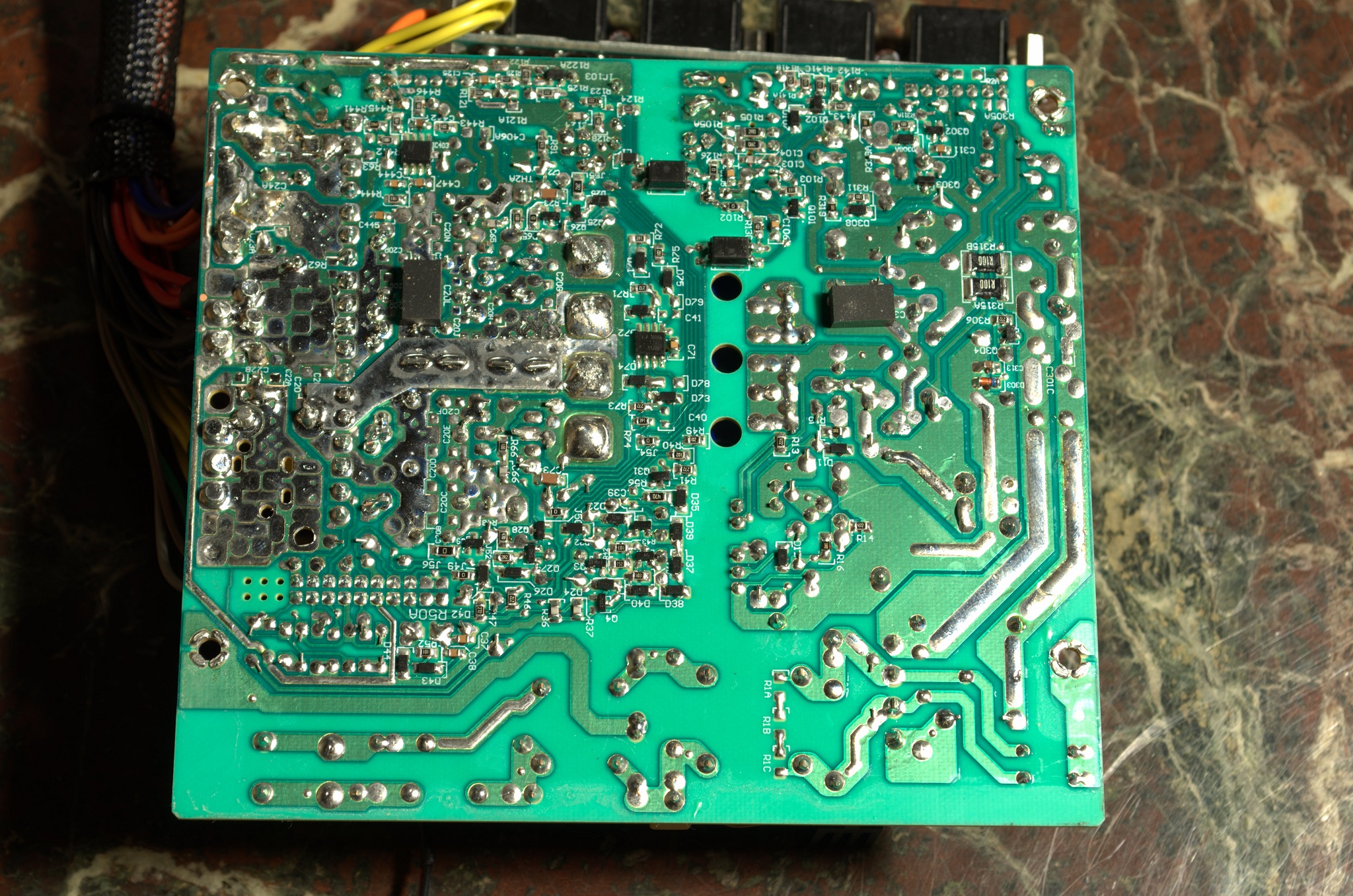

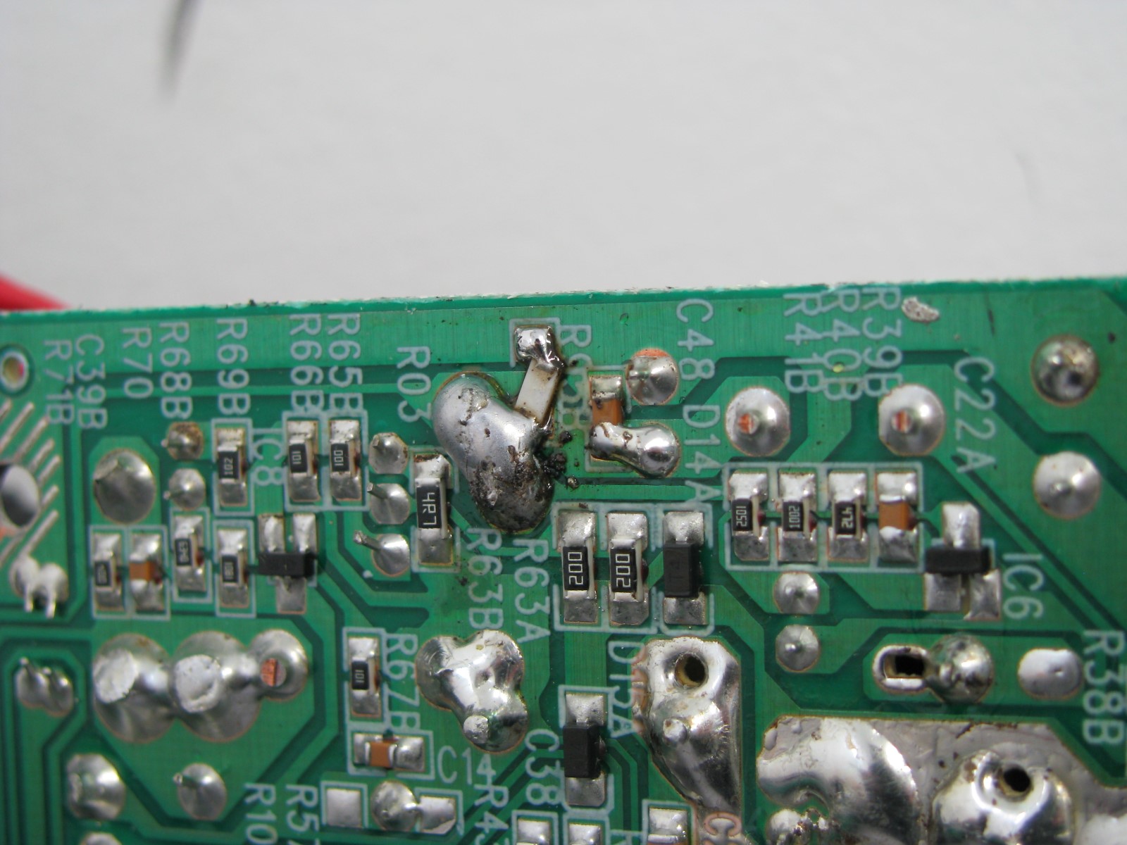

                  The soldering is generally OK, except for...
                  ...this. Whoever the OEM is, they need to do some work on their soldering skills.
                  It did 550W in spec, and, at least according to my DMM, the voltages never budged. 12.21V on the 12V, 5.03V on the 5V and 3.36V on the 3.3V was where the voltages all stayed, regardless of how heavily loaded the PSU was, and even when overloaded and crossloaded either 5V/3.3V heavy or 12V heavy. However, I just don't see how that's really possible. I might believe it if it was form a high end $400 Delta server PSU with DC-DC on the 5V and 3.3V, but not from an $80 fleabay unit.
                    • 31288
                    #2249
                    that's weird.
                    that hand soldering if you follow the tracks means the upside-down resistor isnt even doing anything - it's bypassed by the tracks & soldering!
                      Not at all. +5 and +3.3 are independently regulated with magamps. +12 appears to be synchronously rectified- the two small clear/white and black leads from the transformer seem to be bias supplies to turn the MOSFETs on at the correct time. You have four MOSFETs for +12. -12 probably just has small diodes.
                      The readings don't lie. That's an audiophool's myth anyway, to not "believe" your readings.
                      +12 is obtained directly from the TX; (mostly?) dedicated feedback to the PWM keeps it stable. -12 should be decent also, it's output inductor is common-wound with the one for +12, on the same toroid.
                      +5/+3.3 each have magamps feeding their rectifiers. So each is regulated.
                      The three output inductors (+/-12, +5, +3.3) give it away.

                      • ben7
                        Capaholic
                        • Jan 2011
                        • 4059
                        #2251
                        Originally posted by stj
                        that's weird.
                        Maybe it's a 0 ohm shunt "resistor"?
                        Could have been to help get rid of a ground loop or something like that.
                              Dafuk? It is minimum load resistor between +5 V SB and ground. Cannot be shunted, check again.
                                that's weird.
                                Nope, not bypassed. Check those tracks again.
