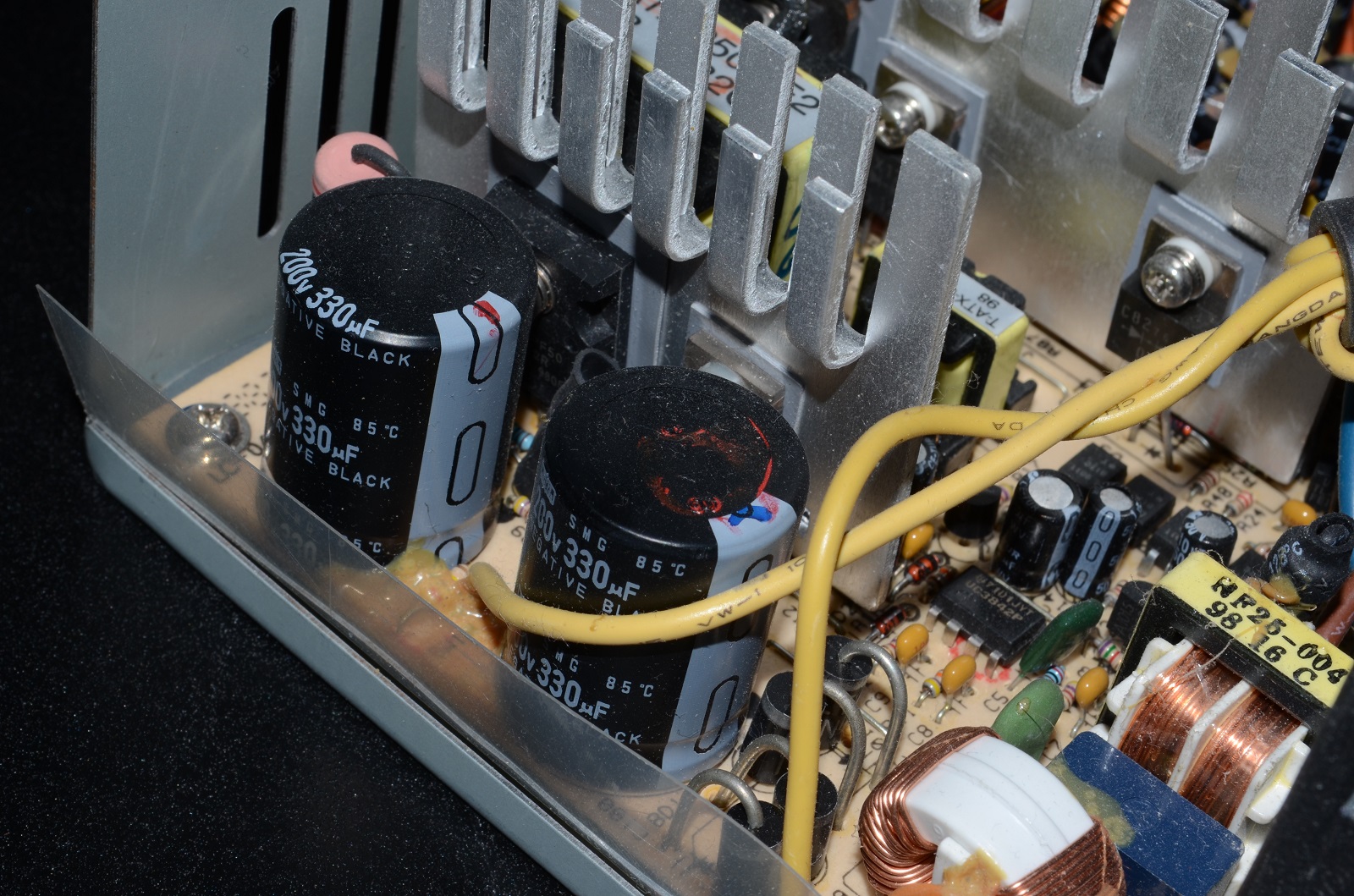

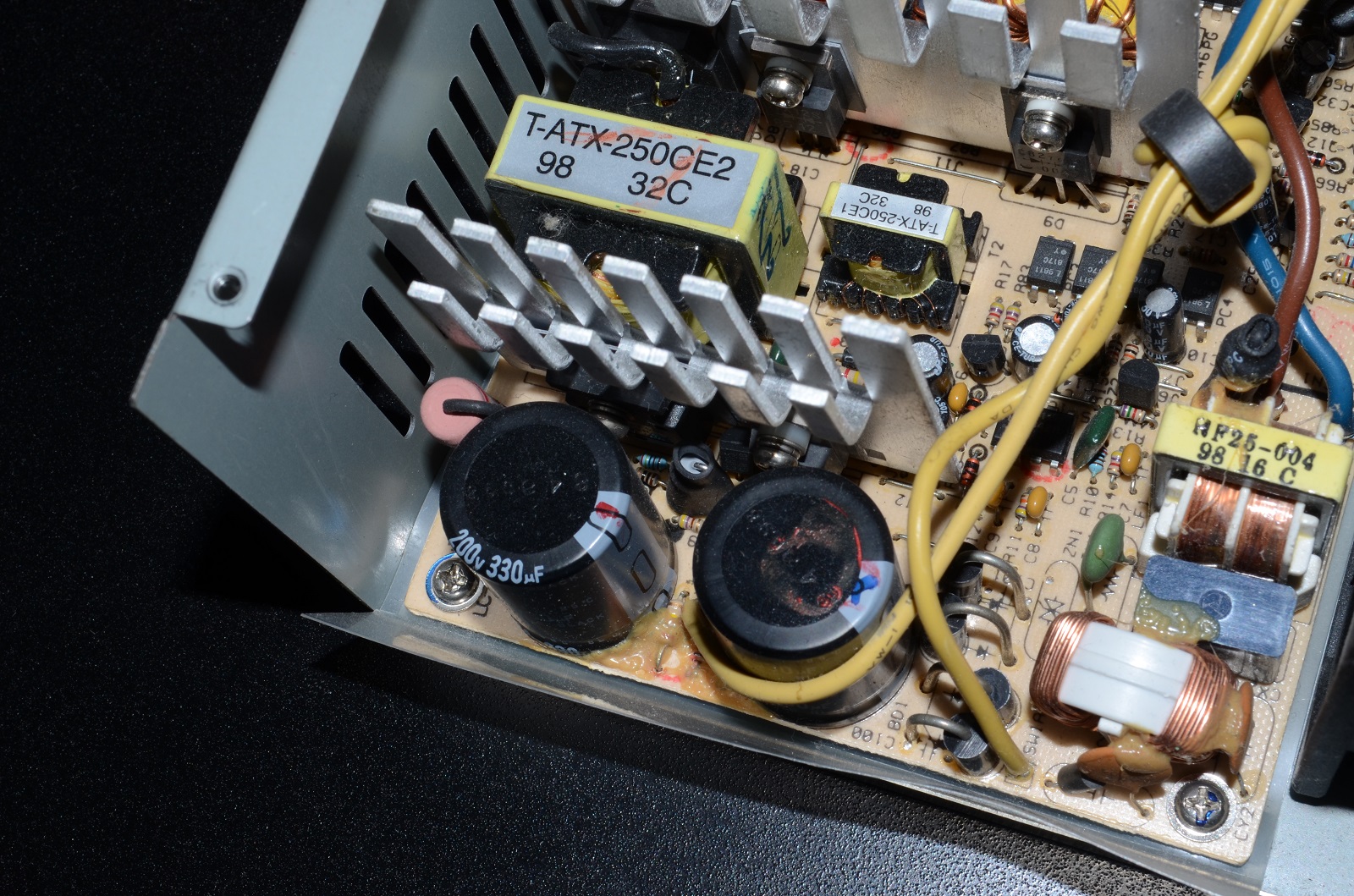

                                    Something different. The OEM was more or less easy to find -> used their UL File Number on the label.
                                    This is a 250W PSU. Guess who did it ;-)

                                      #2398
                                      Hmmm. Looks like an old Bestec
                                      • Stefan Payne
                                        • 1267
                                        #2399
                                        That's because it is
                                        Got those two with another FSP one, all rather old (pre Y2K ones, it seems).
                                        • Pentium4
                                          CapXon Be Gone
                                          • Sep 2011
                                          • 3741
                                          • Power supplies are my primary interest
                                          #2400
                                          Yeah, looks like 1998. I think it looks good for 250W. They were a little ahead of their time for a low end unit, not using half bridge in 1998. Funny how their cap choice was better 17 years ago. CEC>CapXon
