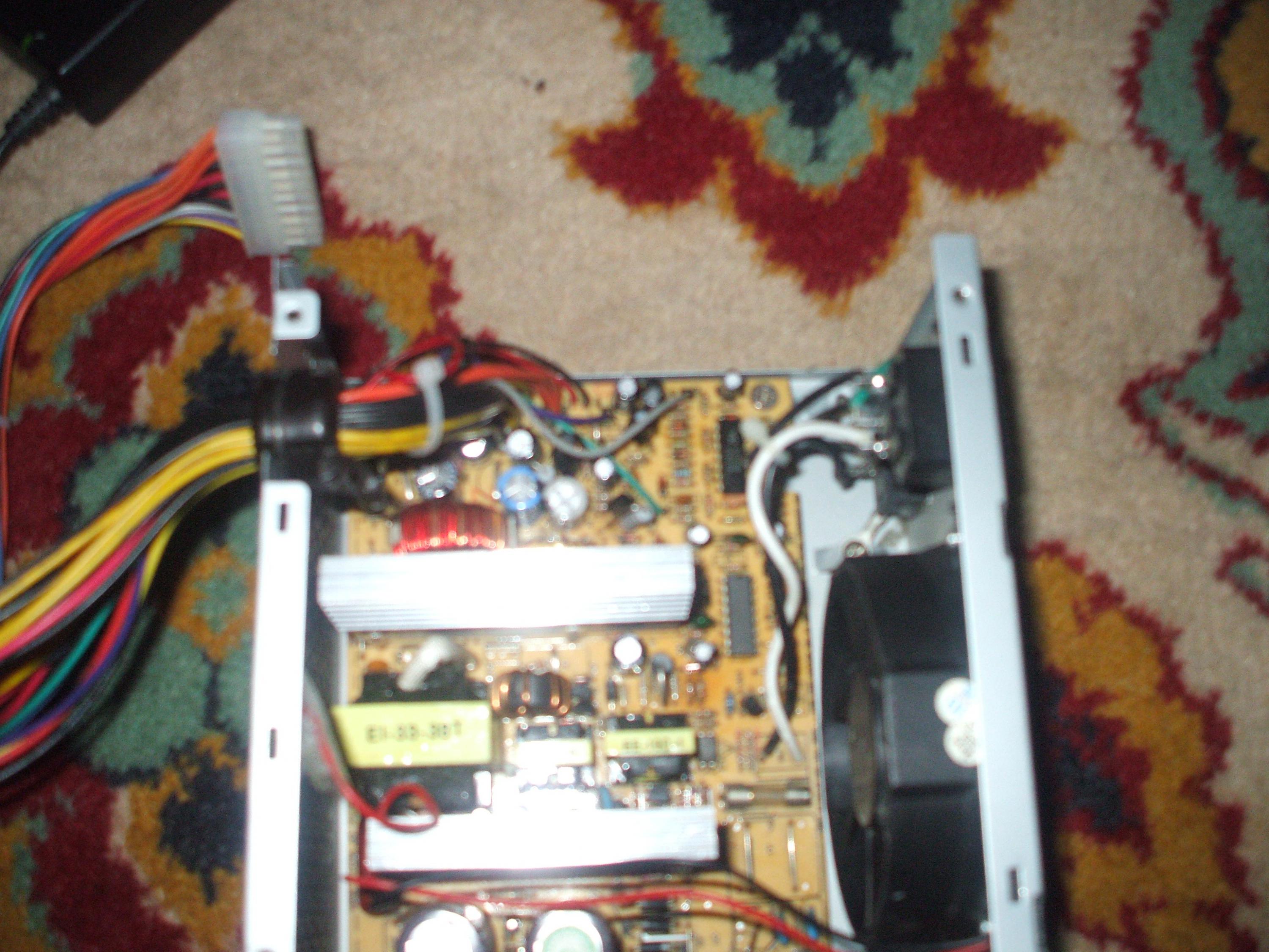

            2 more PSUs and yet again my camera decides to be a complete idiot and turn off before even taking a pic.
            First one is a 400W Delux - BH primaries (I don't care about them as long as they work),and a whole forest of 'em on the secondary with one bulger. Small heatsinks and EI-33 transformer. Turns on but I think it's quite weak for a Skt478 P4,HD3450 AGP and a HDD,either that or it's because of the secondary caps.
            Second one - 220W Rexpower PX-400 - this one looks quite good,and the heatsinks are a bit bigger than the Delux. Noname primaries (again,as long as they don't pop it's fine) and Yang Chun (Saturn shaped YC logo) secondaries. It doesn't work due to a 470uf bulger.
            I will try charging the camera and try providing you some pictures after recap.

                    Good news and (quite)bad news for you:
                    Good - I got the camera to work.
                    Bad - I can't get to the KME PSU until tomorrow. However,here are 2 shots of the Delux PSU. Sorry for the second one being blurry but my LCD is cracked so I can't know if it's focused or not.
                    Anyways,here are they. (BTW the grey cap in the second picture is a Yang Chun cap that I used to replace the bulging cap in it.)
                    Transformer in both PSUs are EI-33.
                    And yes, it has a -5v rail
                    EDIT:Not my pic but here's a shot of another Rexpower PSU that is close to mine (sans the black case,mine's white). Take a closer look and you'll spot the Yang Chun cap.(HINT - it's the third cap next to the big torroid)

                      Those really belong in the Hall of Shame. Complete junk.
                      btw, I'm pretty sure that those caps are actually 12KuangJin (the ones with the CS logo), not Yang Chun. Only Solytech uses Yang Chun caps.
                          Actually,I've seen Sun Pro use them as well. At least my old Sun Pro unit had a forest of them,along with 2 Fuhhjyyu. And I actually trust those unless they're in a Deer.
                          Regarding the Rexpower,I found out it's CS. Right now I replaced two of 'em,one with a 1500uf 16v KY and the other with a 1000uf 16v Panny FJ,but that's as far as I went,as it's a royal pain to replace them,because they're crowded each other next to the ATX wires,and because I don't have suitable replacements.

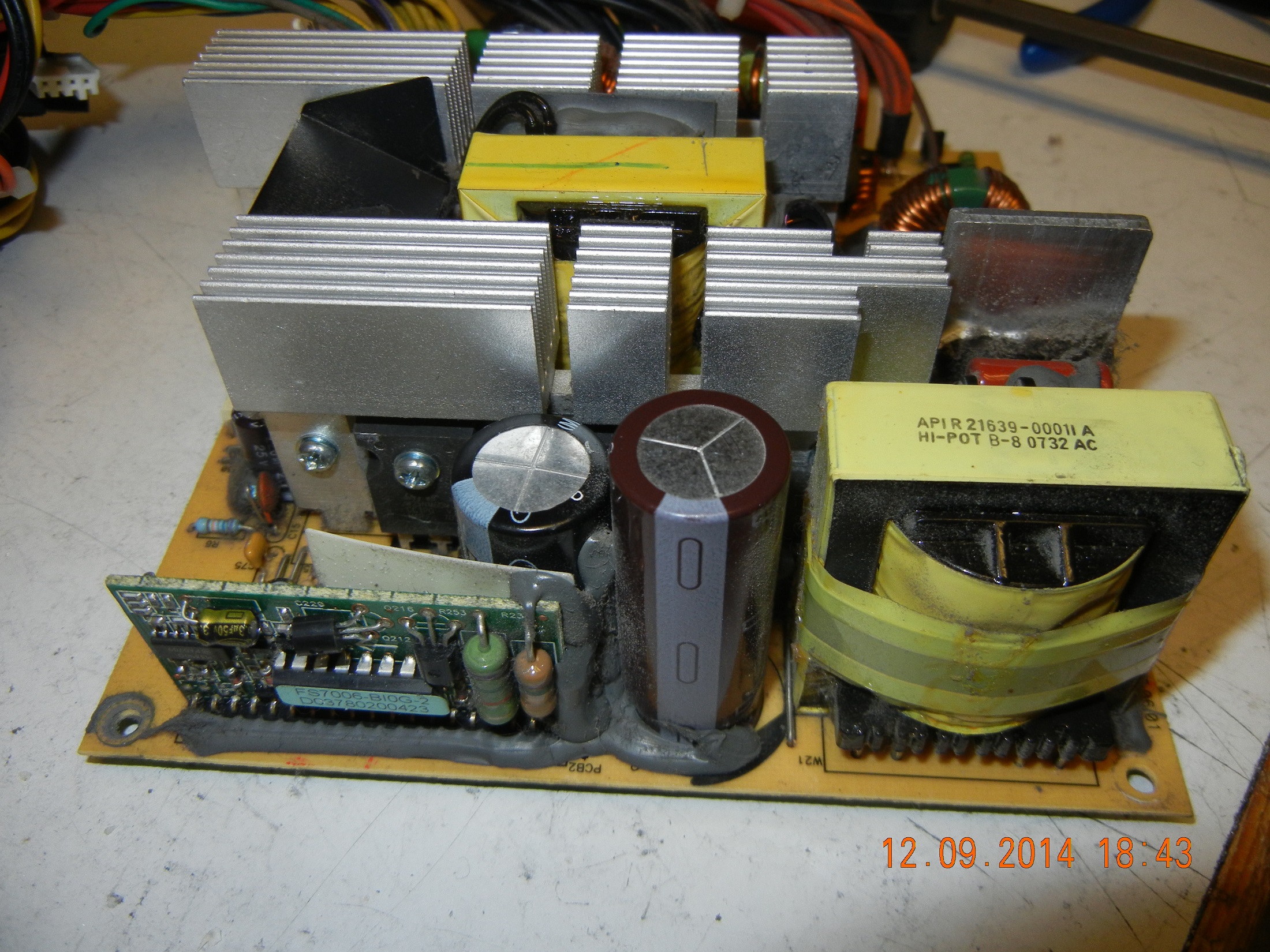

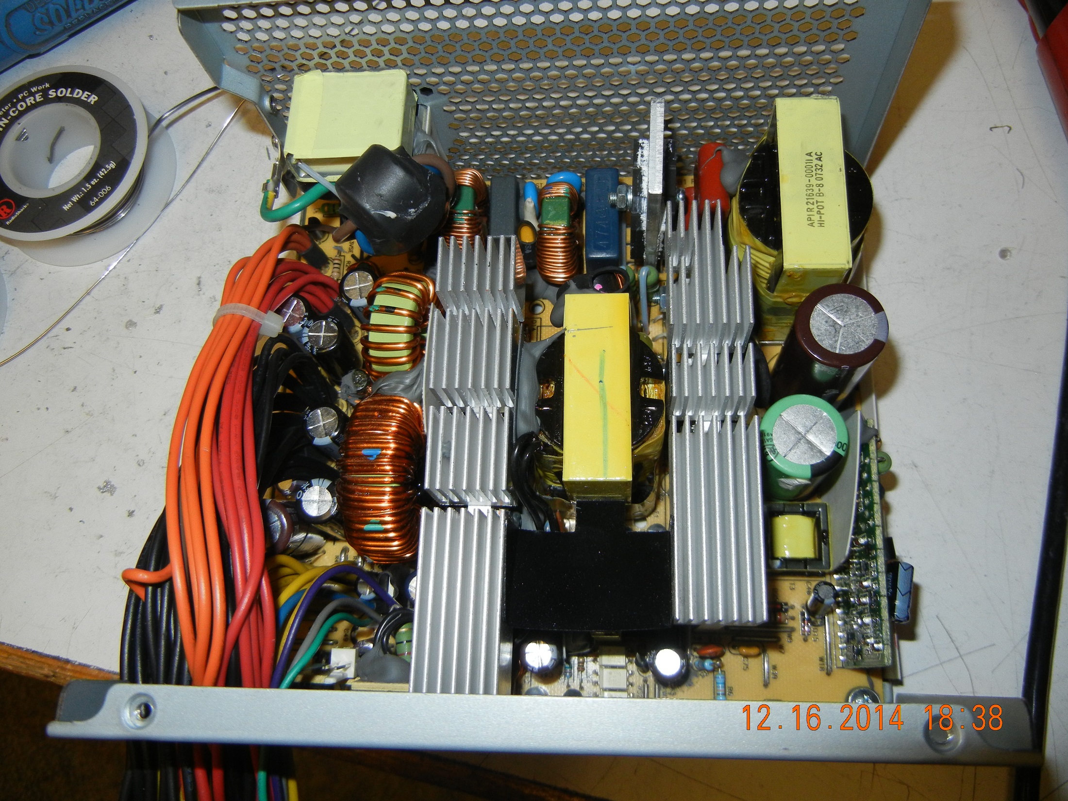

                            I found several "DTK PTP-4017P" PSUs in my basement last week that were left over when assembling some desktop systems a couple of years ago. They are rated 400W have passive PFC and have never been used.
                            Why not give them a chance today and use them in some low power consuming systems?
                            So I opened one up and the build quality didn´t seem too bad.
                            Only Problem: All capacitors are Fuhiyyus
                            So I did a recap using only Panasonic FR, Rubycon ZLJ and Nichicons.
                            I wonder who made These PSUs for DTK...
                            • Stefan Payne
                              • 1267
                              #2194
                              is that a casing macron unit?
                              But from the looks of the heatsinks it reminds one of older Enermax or even Super Flower units...

                                It definitely looks like a Casing Macron.

                                  The "MP" text on the transformers gives it away - it's a Casing Macron indeed. Also, the layout looks exactly like my MPT-301, so I'm pretty sure it is a Macron.
                                  Good save! I assure you these will be able to handle even something more than a "low end" system. Just make sure the 12V rail rectifier is good enough. Also, the 200V Fuhjyyu caps on the primary are probably fine. I know Fuhjyyu is not a good brand, but their high voltage caps are okay. I haven't seen any problems with them, at least. The ones in my MPT-301 are still in spec.
