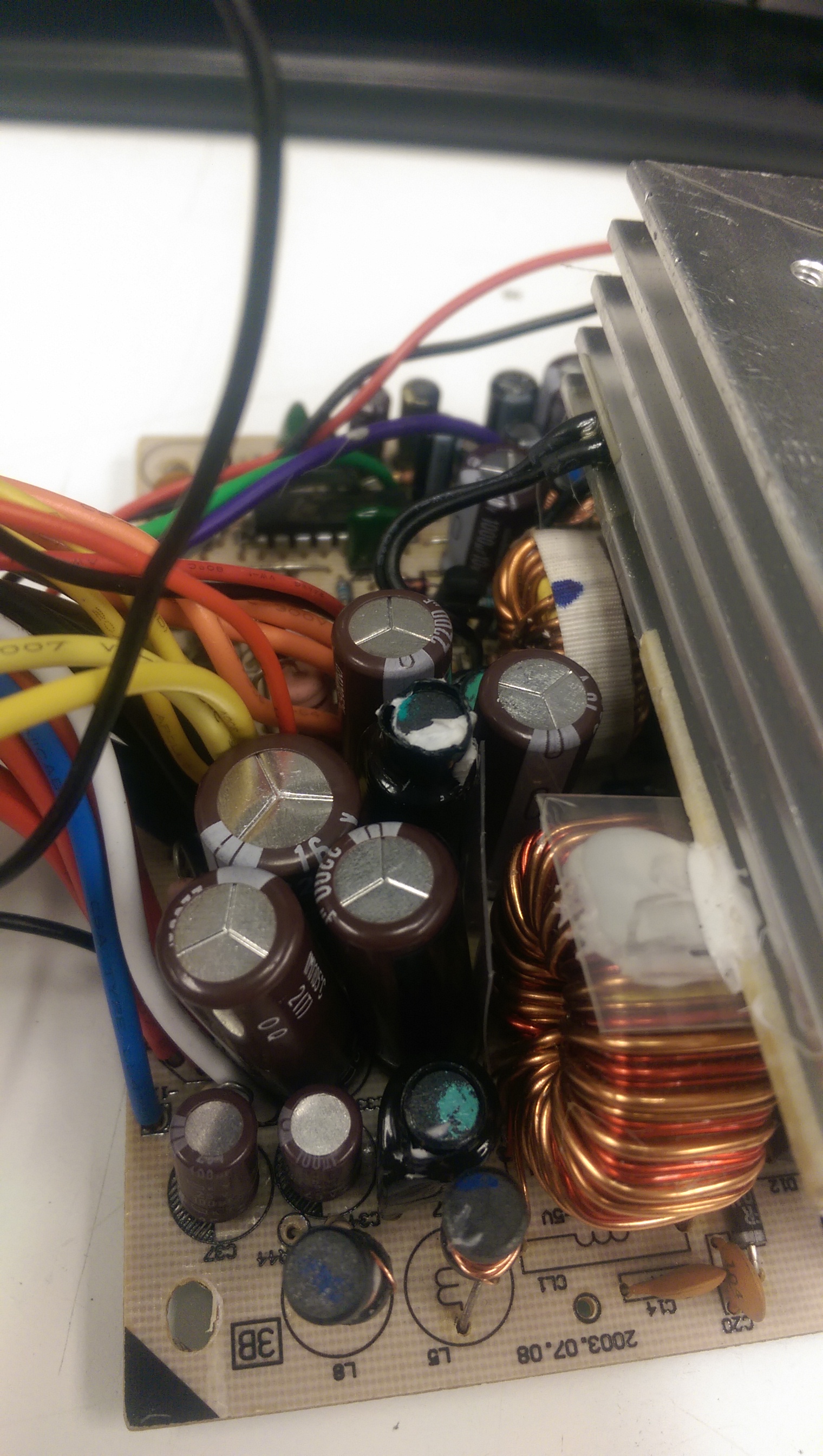

Yeah those switchers are only 10A, so 350W would be pushing it. The Jun Fu primaries are 470uF, and they read 474uF and 476uF. I think I'm going to recap it, I'll throw in some lame 560uF Teapo I have, and replace the minimum load resistor on the 3.3V with the 215Ω resistor and leave the 12V with no dummy resistor.Comment

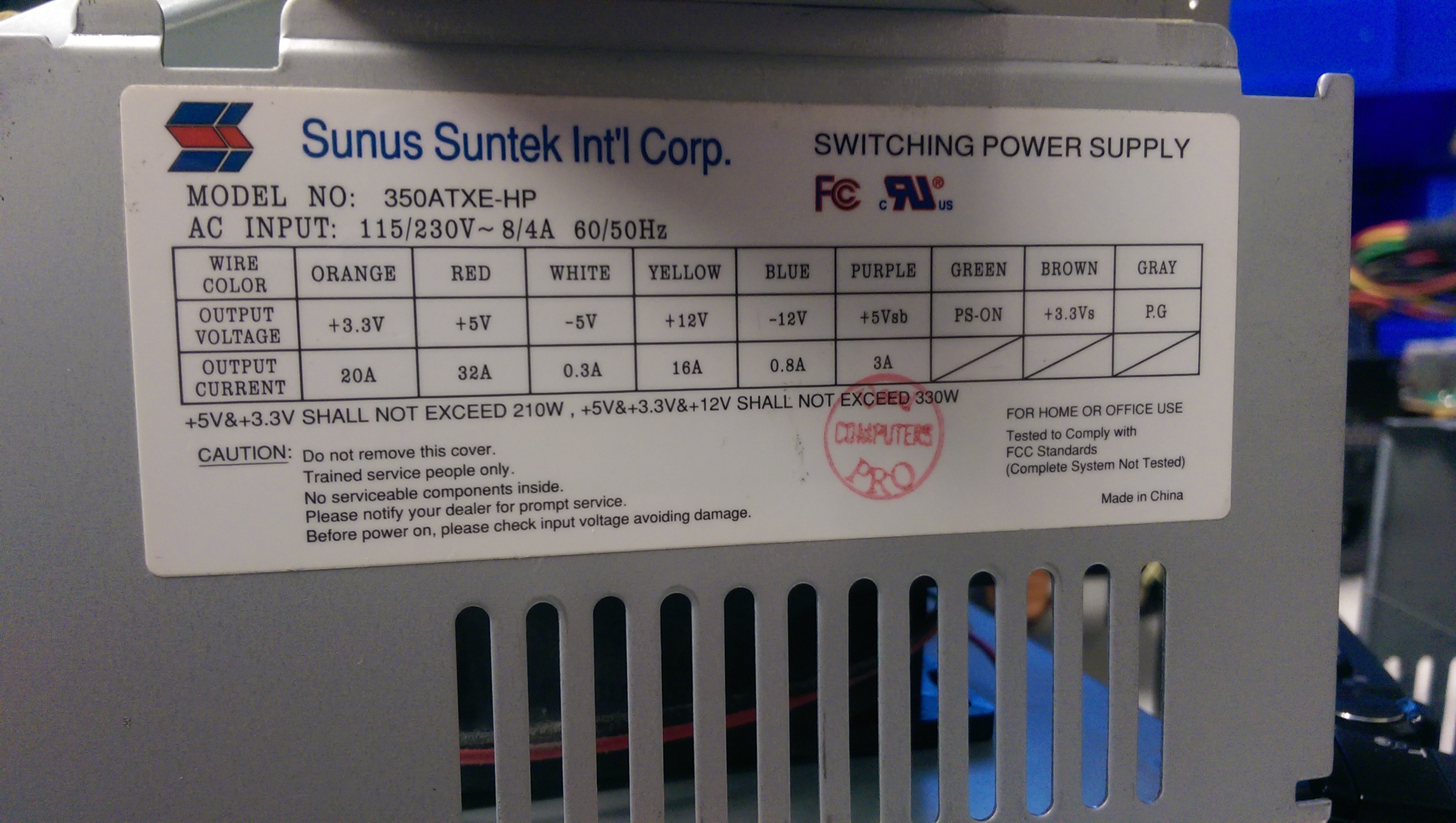

Sunus Suntek 350ATXE-HP
Sunus Suntek hiding a Hipro inside
This one looks similar to some of the recent Hipro's posted but it's definitely different. First of all, it has a rocker switch. Never personally seen one on a Hipro before. It's double forward, using two Toshiba 2SK2749 10A FETs. Nice input filter with MOV's. 8A bridge. Not sure what the primary controllers are. So, if I'm incorrect on in any of this, correct me because I definitely could be wrong. It looks like the 5V is rectified by four 30A schottky rectifiers (STPS3045CW). The 12V uses two 20A schottky rectifiers, and according to the datasheet, they can do 20A @ 125C! They're Fairchild FYP2010DN. As far as I'm aware, the 3.3V is generated from the 12V rail via DC-DC conversion and is output using synchronous rectification. The two FETs there are an STP40NF03L and an SSM40N03P. The 3300uF 10V Teapo SC before the coil on the 3.3V rail has failed. The soldering looks good, but definitely not Hipro's best. At least it's lead. The death ADDA was about as dry as a desert in Arizona, but it was still spinning freely, probably because the rubber seal was on there very, very tight. Also, the second lead on the fan temperature thermistor was never soldered to the board:

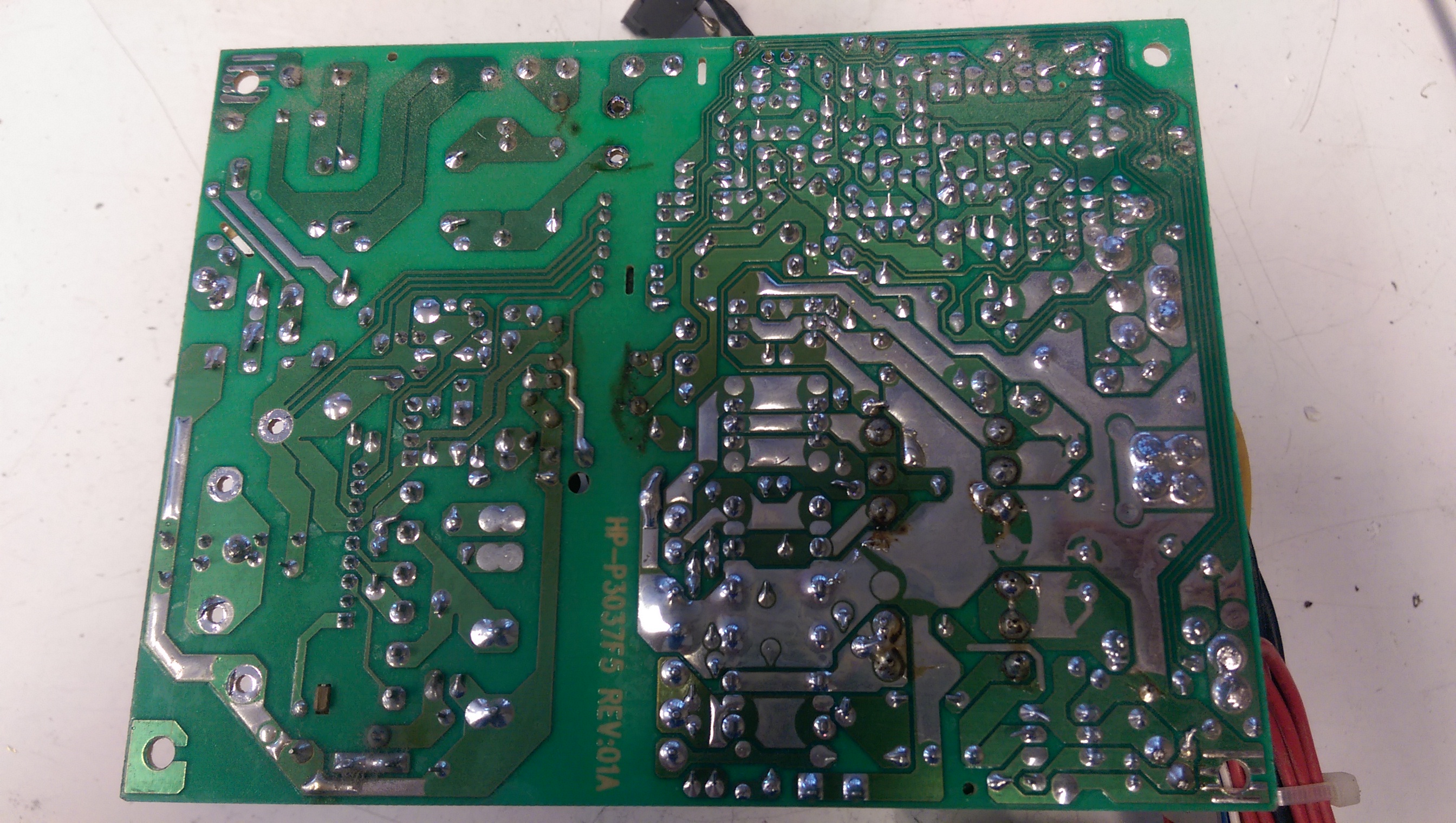

That my friend is the HP-P4017F5/RS-380-PMSR, a 350W rated Hipro, a 350W version of the 300W Hipro you posted earlier this year. +5V has two STPS3045CWs and the +3.3V rail another two. The +3.3V rail is generated through its own transformer tap and own rectifier, and hence its own winding in the toroid from which it's finally regulated down to +3.3V, hence the fact that it has its own set of filtering capacitors before and after the regulators, which are driven by the +12V rectifiers. How many power on hours were on this unit? 20,000 ~ 30,000? I take it the bulk storage is 560uF. Also looks like that unit has conductive glue. Can't help but notice that the underside of the PCB is silkscreened for a 250W version of this unit. I think the Teapo failed because it's right next to the heatsink and the heatsink probably gets warm if not hot with a heavy load on it. And that's not double forward, that's single switch forward with two switchers in parallel.Last edited by Wester547; 09-16-2014, 07:16 PM.Comment
The soldering quality is horrible. There are lots of bad solder joints and long component leads that are almost touching other leads.

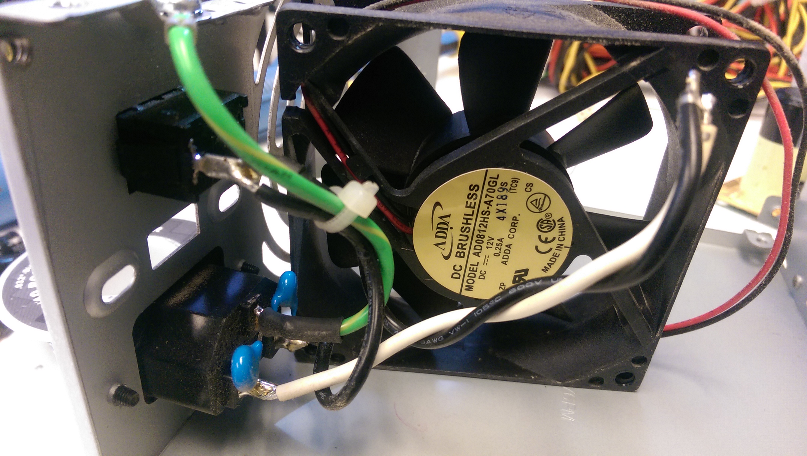

Hipro always screws up the fan controller in some way. Both of the Hipro PSUs I've opened didn't have the thermistor touching the heatsink. There were some Corsair PSUs (which I think were made by Chicony/Hipro) that would shut off because the fan wasn't running fast enough, and none of the components were actually bolted to the heatsinks. They just pushed the components against the heatsinks and hoped the thermal pads would hold them in place.Comment
Cool, thanks for clarifying but I'm still confused. Why does it need two FETs on the secondary? Unfortunately I'm not sure how many power on hours this thing had. Yeah the bulk caps are 560μF. They read 510μF and 514μF. I think the Teapo failed because they're Teapo and they're oldThat my friend is the HP-P4017F5/RS-380-PMSR, a 350W rated Hipro, a 350W version of the 300W Hipro you posted earlier this year. +5V has two STPS3045CWs and the +3.3V rail another two. The +3.3V rail is generated through its own transformer tap and own rectifier, and hence its own winding in the toroid from which it's finally regulated down to +3.3V, hence the fact that it has its own set of filtering capacitors before and after the regulators, which are driven by the +12V rectifiers. How many power on hours were on this unit? 20,000 ~ 30,000? I take it the bulk storage is 560uF. Also looks like that unit has conductive glue. Can't help but notice that the underside of the PCB is silkscreened for a 250W version of this unit. I think the Teapo failed because it's right next to the heatsink and the heatsink probably gets warm if not hot with a heavy load on it.

I wouldn't say that the soldering is horrible but it's pretty disappointing for Hipro. The joints on the toroid and 5VSB transformer definitely need to be cleaned and redone. I'm surprised to hear such poor build quality from Hipro, in my experience they've been very good.The soldering quality is horrible. There are lots of bad solder joints and long component leads that are almost touching other leads.
I'd just be interested in how long they lasted. It doesn't need two FETs on the secondary but using two FETs in parallel (or one on the high side and one on the low side) to linear regulate that rail is certainly more efficient than only using one.Cool, thanks for clarifying but I'm still confused. Why does it need two FETs on the secondary? Unfortunately I'm not sure how many power on hours this thing had. Yeah the bulk caps are 560μF. They read 510μF and 514μF. I think the Teapo failed because they're Teapo and they're old

Makes sense. It must work differently than with schottky diode packs, since the specs on the two FETs are different.It doesn't need two FETs on the secondary but using two FETs in parallel (or one on the high side and one on the low side) to linear regulate that rail is certainly more efficient than only using one.Comment
I love that secondary heatsink!
Just like it's not bad enough that 99% of the time the fan controllers are configured to run the psu too hot and quiet, now they even forget to solder the thermistor!!Comment
