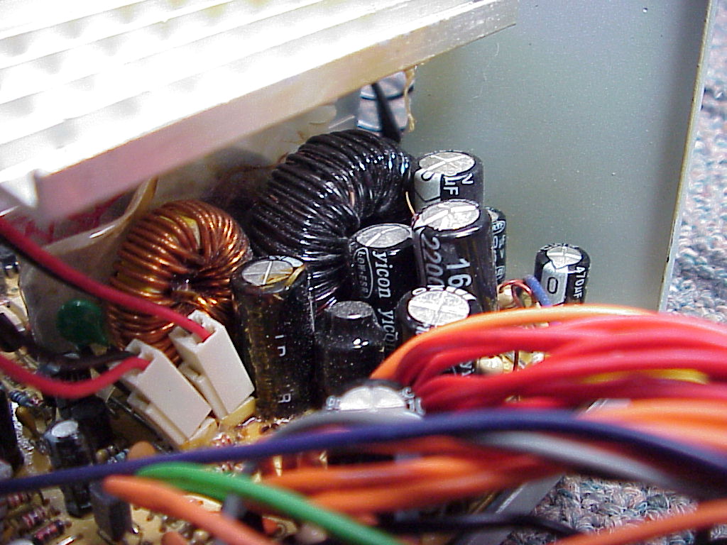

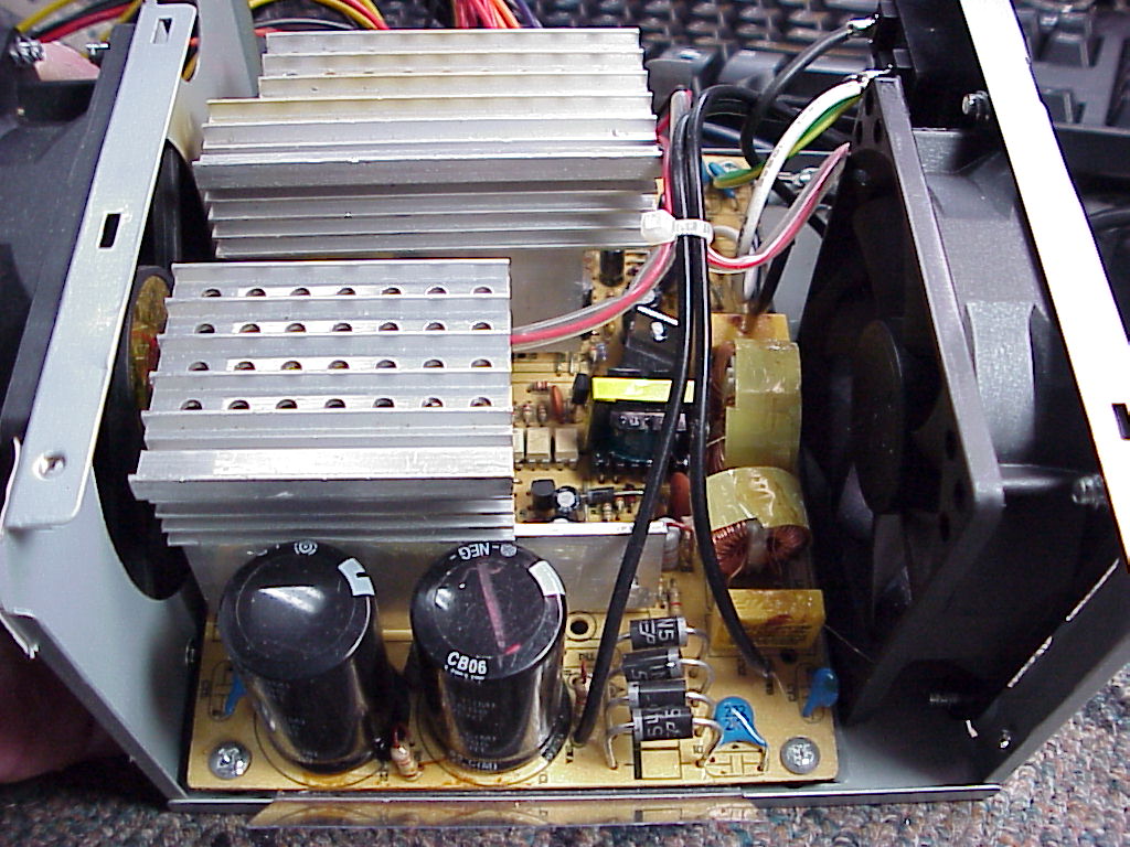

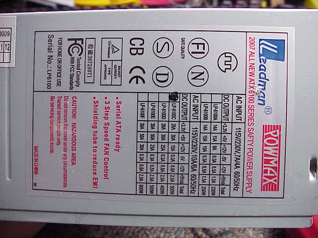

        "safty", "no servicing components inside", "safe quality", "tested comply with FCC standards"
        Engrish anyone?

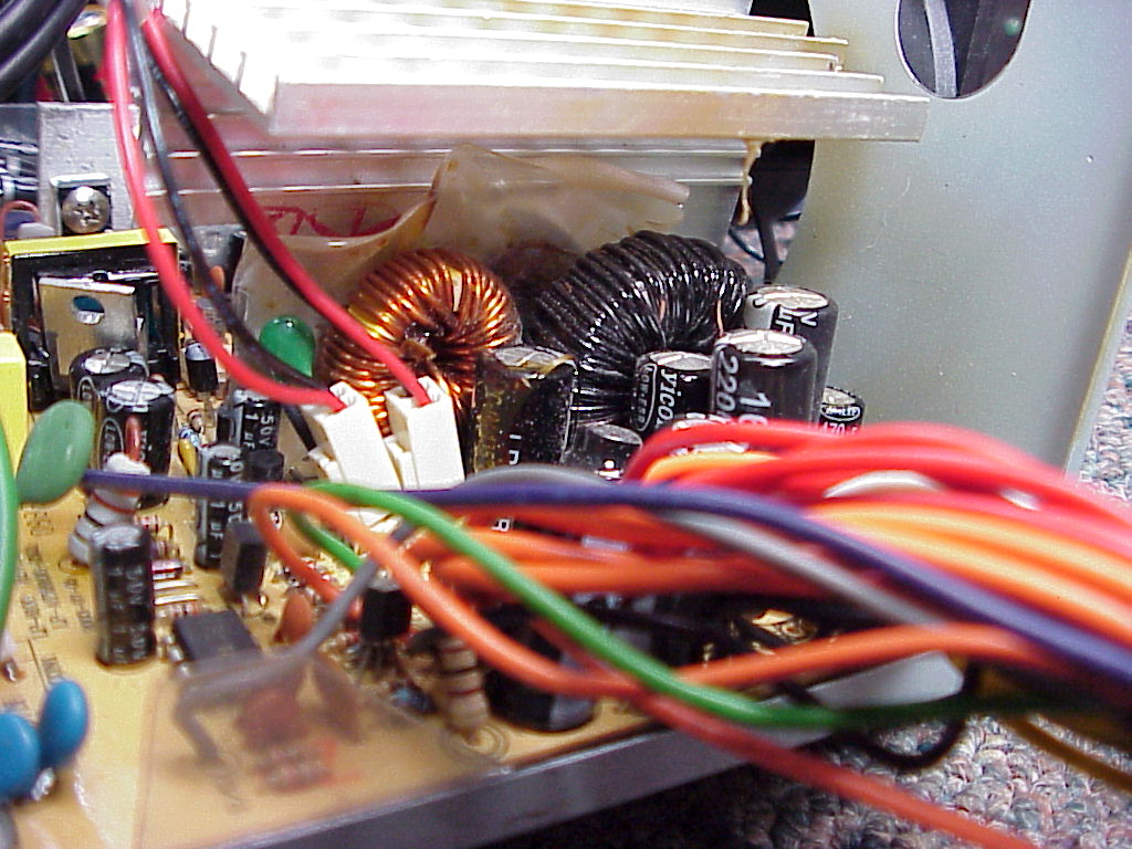

        Lovely capacitor choices too. And look at the 5vsb transistor on the second picture - it's tiny!
        But at least you have 2 fans for an odd project on a rainy day. The input coils and input capacitors don't look too bad either. Fans seem to be temperature controlled as well (green thermistor on 2nd and 3rd pictures). This PSU might actually be okay for a PII/P3-class PC (only if it had good capacitors though, and if the main transformer is not of the smaller type).

                                Unless it's hiding,,, I don't see a fuse in there.....
                                Mann-Made Global Warming.
                                - Dr Seuss
                                  master hoarder
                                  • May 2008
                                  • 12164
                                  • Bulgaria
                                  Re: leadman powmax 2007 all new atx series safty power supply!
                                  Fuse should be under the white wire in the last picture.
                                  I know because I have a LP6100-D, though mine was built much better. Surprisingly it lasted for 5 years before the secondary-side caps died, then it just became unstable.
                                  In terms of Powmax quality, I think this is one of their better designed PSUs. It's for heavy 5v use however, and a modern 12v-based system will burn it up quickly.
