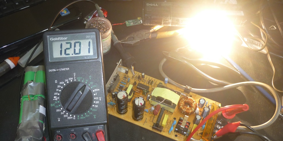

    I have a power source for CCTV system.
    The plate indicates model: FDPS-100N-R5
    They delivered it to me without igniting, I checked the fuse and it was well, visibly two condensers in the exit bulky.
    It has an area near the integrated TL494 obscured on the PCB.
    Initially look for components in short circuit or open and I did not find them (Photo with green marks these components are verified)
    I connected power through the 100W series and the bulb did not turn on. The dead source, check if there is voltage to the IC and it does not.

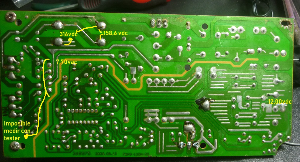

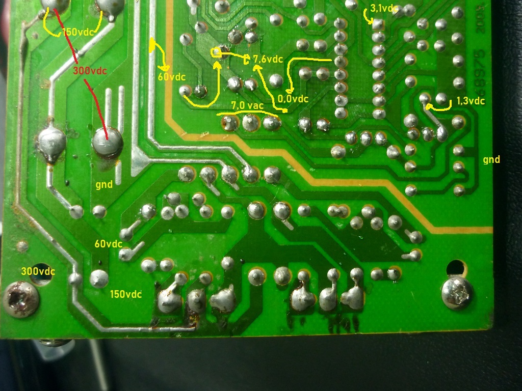

    I check the high voltage part and I have 155vdc at the output of capacitors C5 and C6.
    But at the exit of T2, I have nothing, I dismantle it to verify continuity in the coils and they are fine, the transistors Q1 and Q2 are heated.

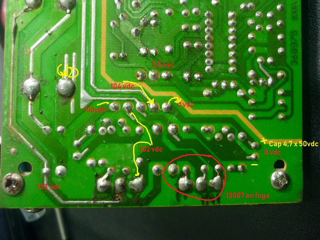

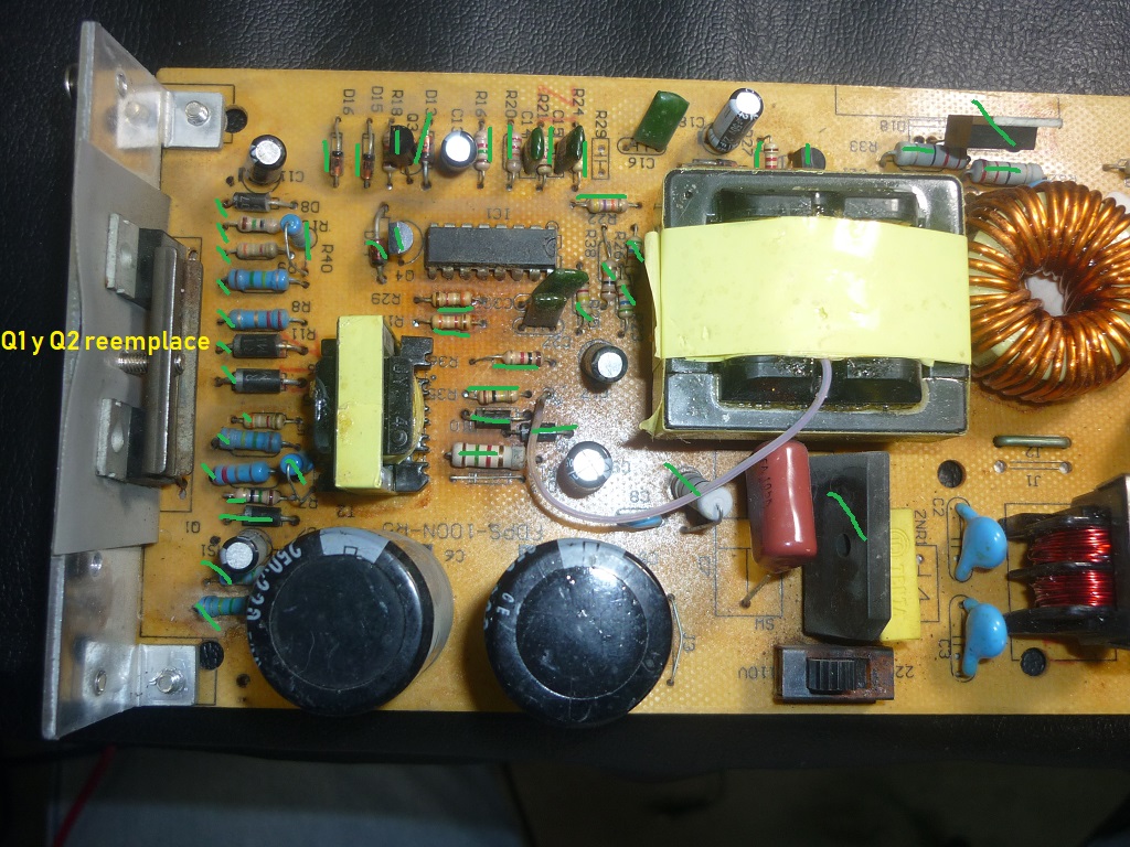

    I remove the PCB Q1 and Q2, I measure them and I find one of them in flight. replace the two.
    I connect the source and it starts but the transformer T1 starts zoning as if it had a relet inside (RRRRRrrrrrRRRRrrrrRRR)

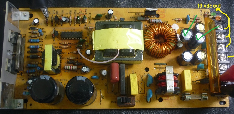

    At the output of the source I have 10vdc, but in the pins 12 vcc and 7 GND of IC1 I have no voltage, in all that sector there are 0.40 to 0.63vdc.
    Please can you give me some ideas of what else to review or if someone has an outline of this source.
    Annex photos with the mediated obtained from voltages

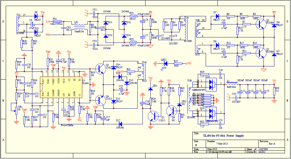

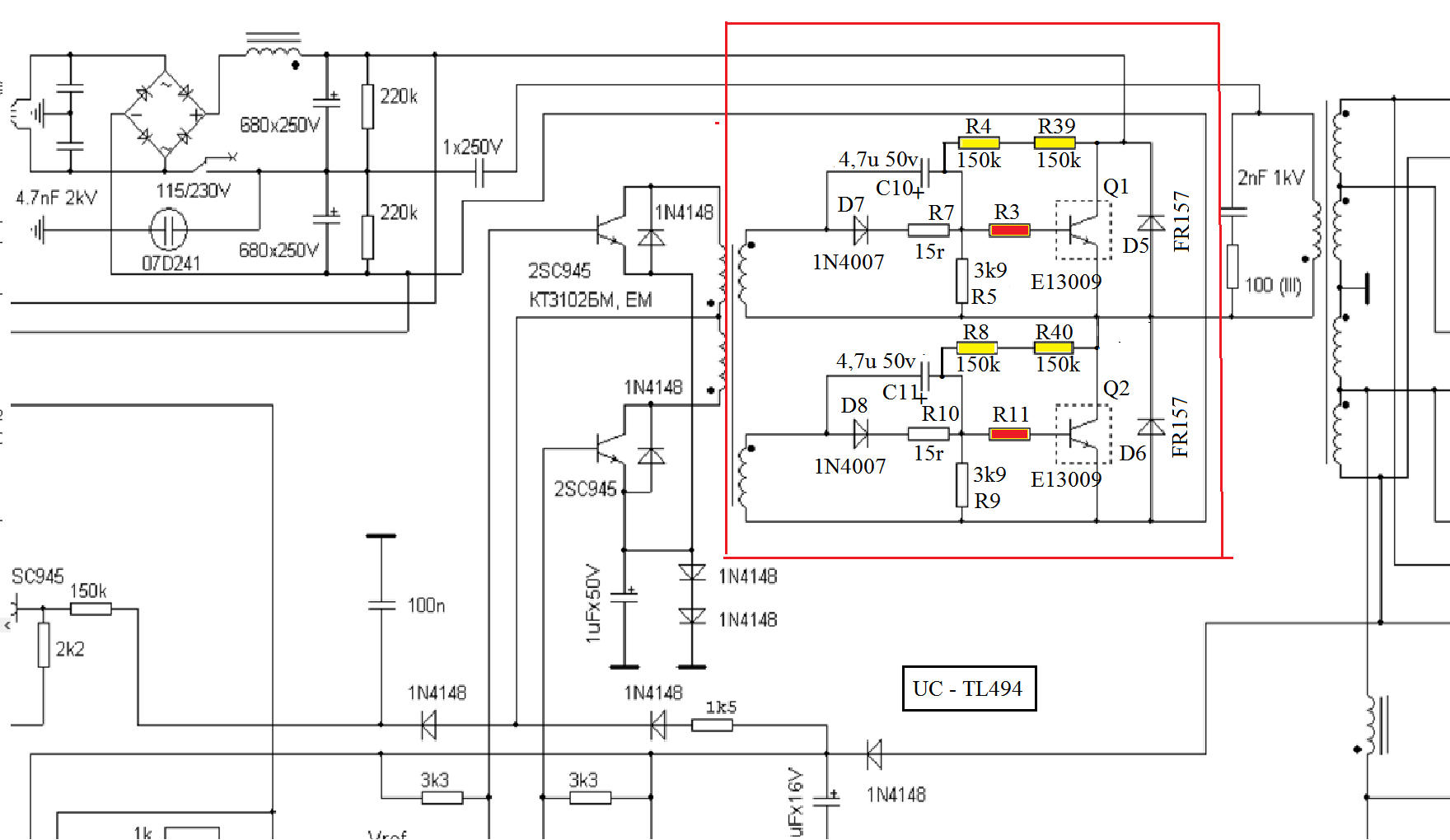

    If you are getting 10vdc I would replace the small electrolytic capacitors in the primary like C9, C17, C13 etc.
    The power supply is working but is not regulating properly
    I found these diagrams that might help.

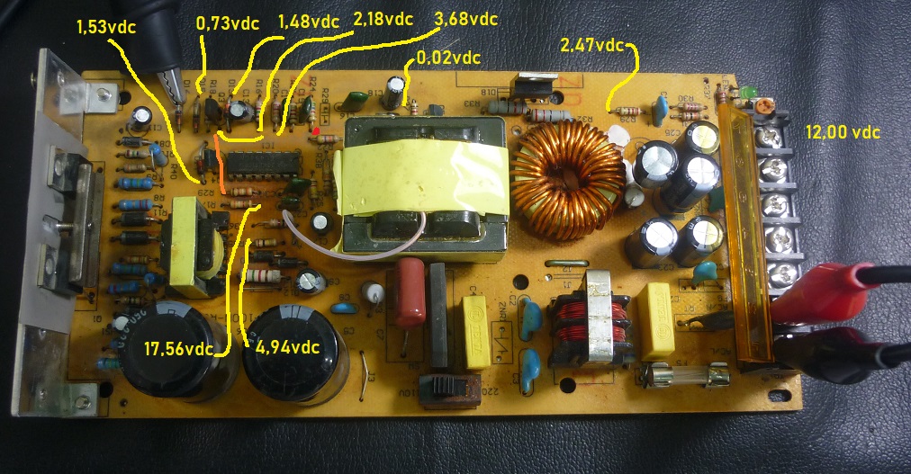

                Make the change of small capacitors, C11 and C10 did nothing. regarding the sound or voltage failure in the secondary of T2.
                C13 and C17, C18, did nothing either.

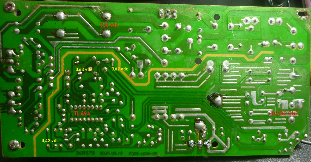

                When I changed C9, I already got a voltage of 16 vdc first, then low and stabilized at 7.6vdc.
                Replace C22, ceramic condenser, since I saw it darkened.
                However, on pin 12 of IC1 I have no tension.
                I attach images of the tensions that I am already getting. and the video with the sound generated by the PSU before the change of capacitors.
                The output of T2 I already have 7vdc.
                Replace C5 and C6, original 220uf x 250v, replacement 330uf x 200vdc. (line voltage 110vac).
                Probe C6 with the tester (Diode function) and did not load.
                The noise became faster and sharper. but it was not removed.
                The output voltage at the source went up to 14 vdc

                          Re: Power source with loud noise and does not work well (FDPS-100N-R5) Case Closed
                          Hi all.
                          Finally, I managed to find the problem of noise at the source (RrRRRRrrrrr) and the poor voltage output on the secondary.
                          I removed the IC TL494 and replaced it with another that I extracted as a test of an ATX PSU. Immediately the source stopped ringing and the voltage on the PIN 12 stabilized at 17.55vdc and on pins 13 and 14 I got the reference voltage of 4.94 vdc. (5vdc nominal)
                          So this was the whole problem, the failure of the IC affects the operation of both the primary and the secondary.
                          Now it's time to locate the new replacement components, since it uses pieces extracted from other equipment as a test.
                          Attached for future reference, image with the voltages measured when the source is operating correctly.
                          It was impossible for me to measure the voltage on the primary pins of T2, the multimeter goes crazy.
