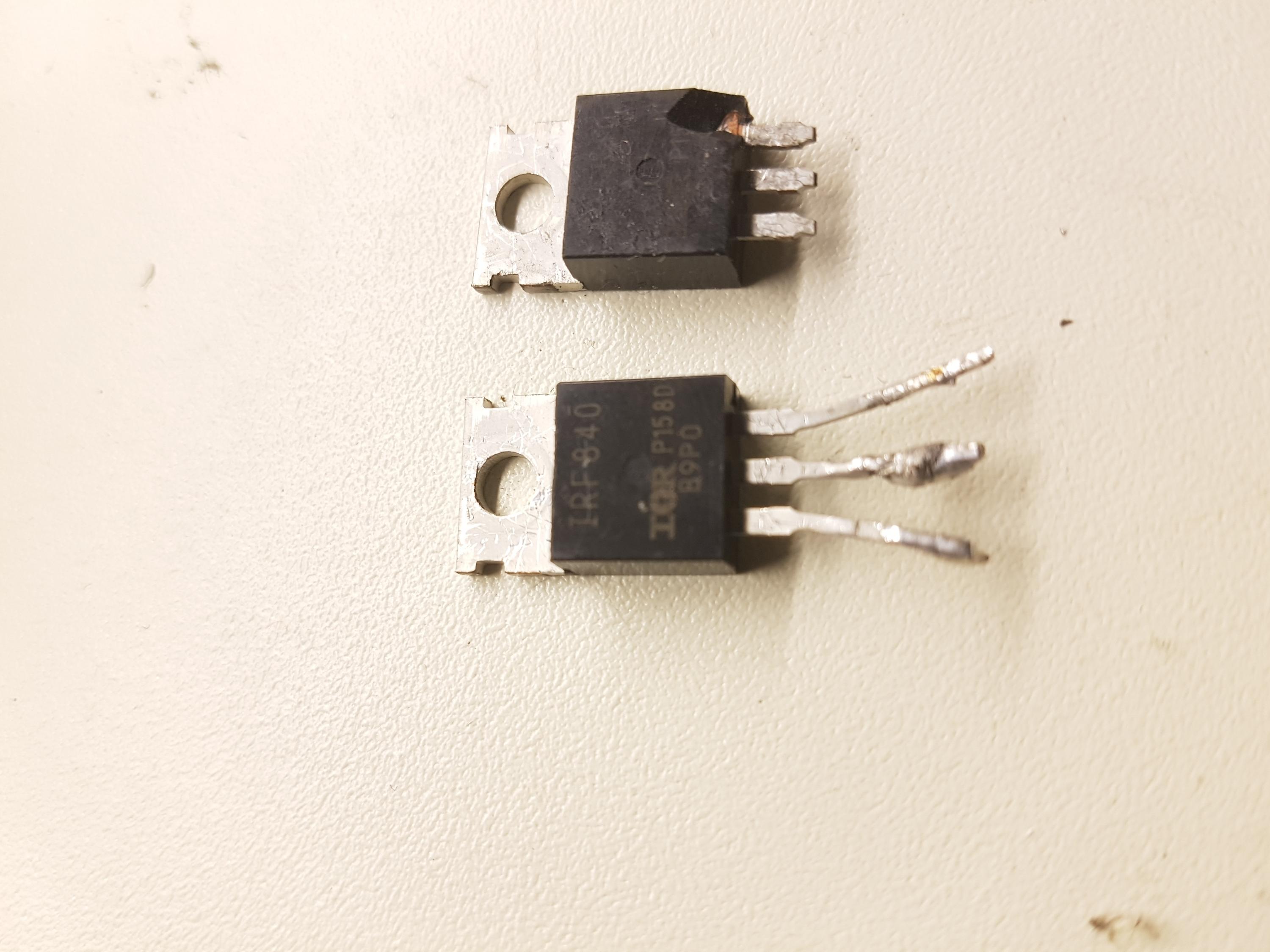

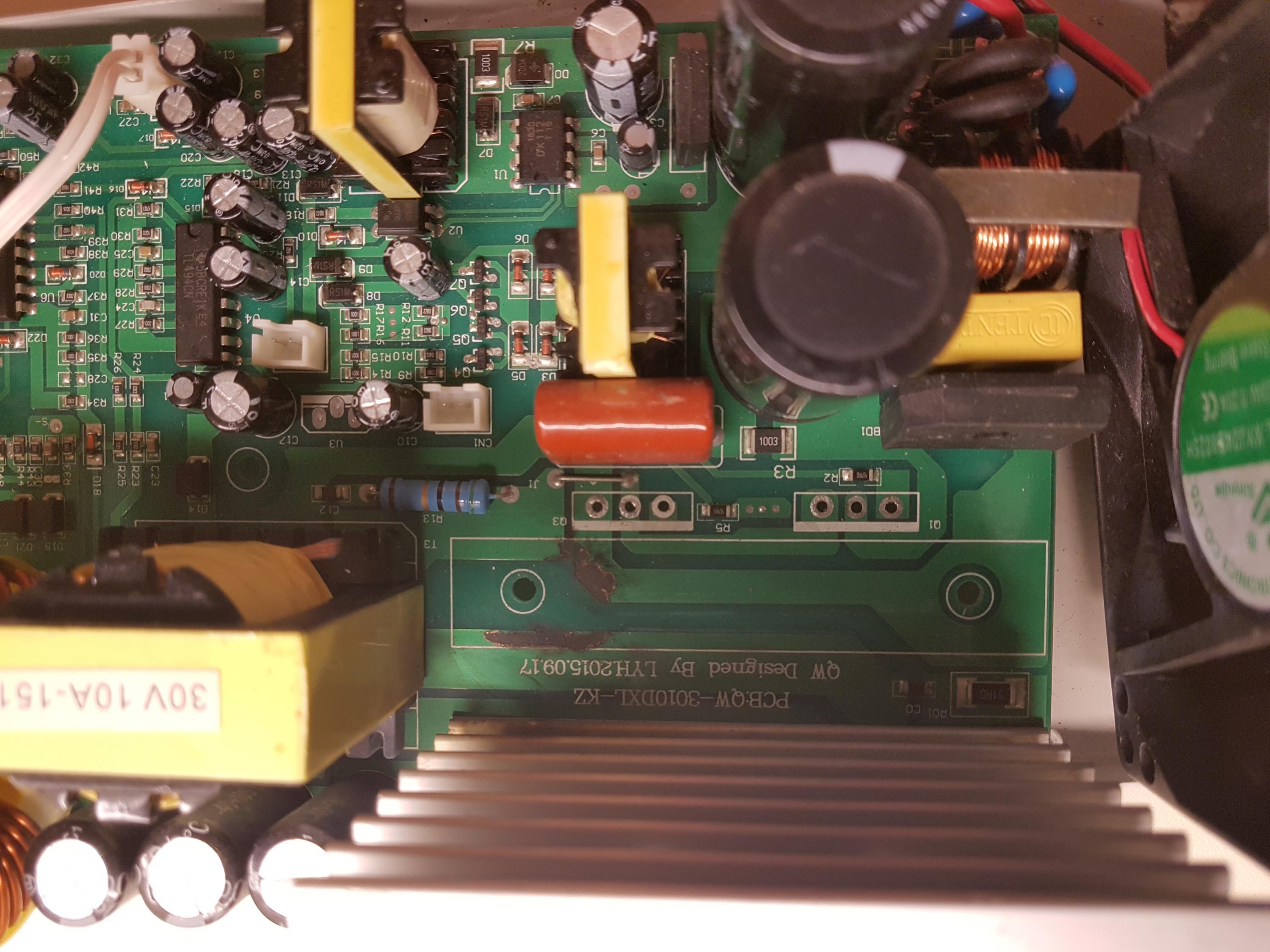

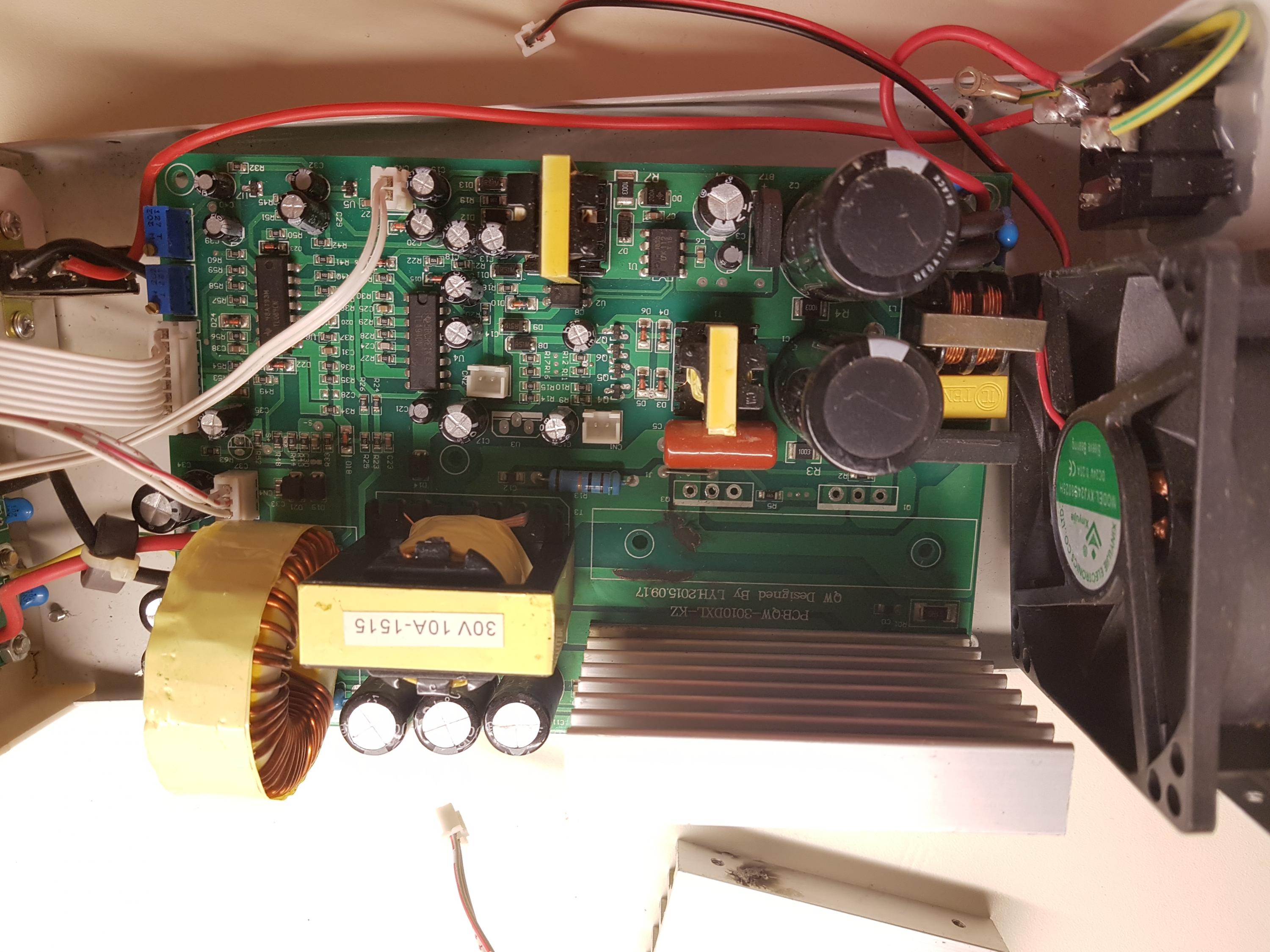

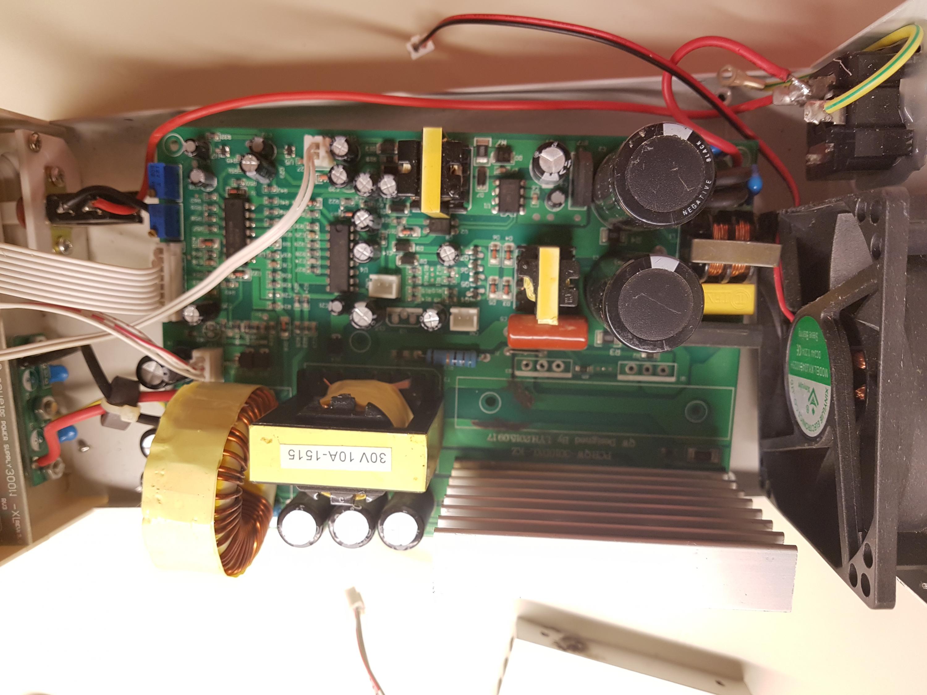

    Hello guys.
    I have this power supply one week..
    Yesterday when i short the leads to change the amps i hear a weird noise like something is going to crack.
    And today when i press the power button i see smoke and thunders from inside this power supply.
    I open it and i see a blown IRF 840 Mosfet, but it damage the board also.

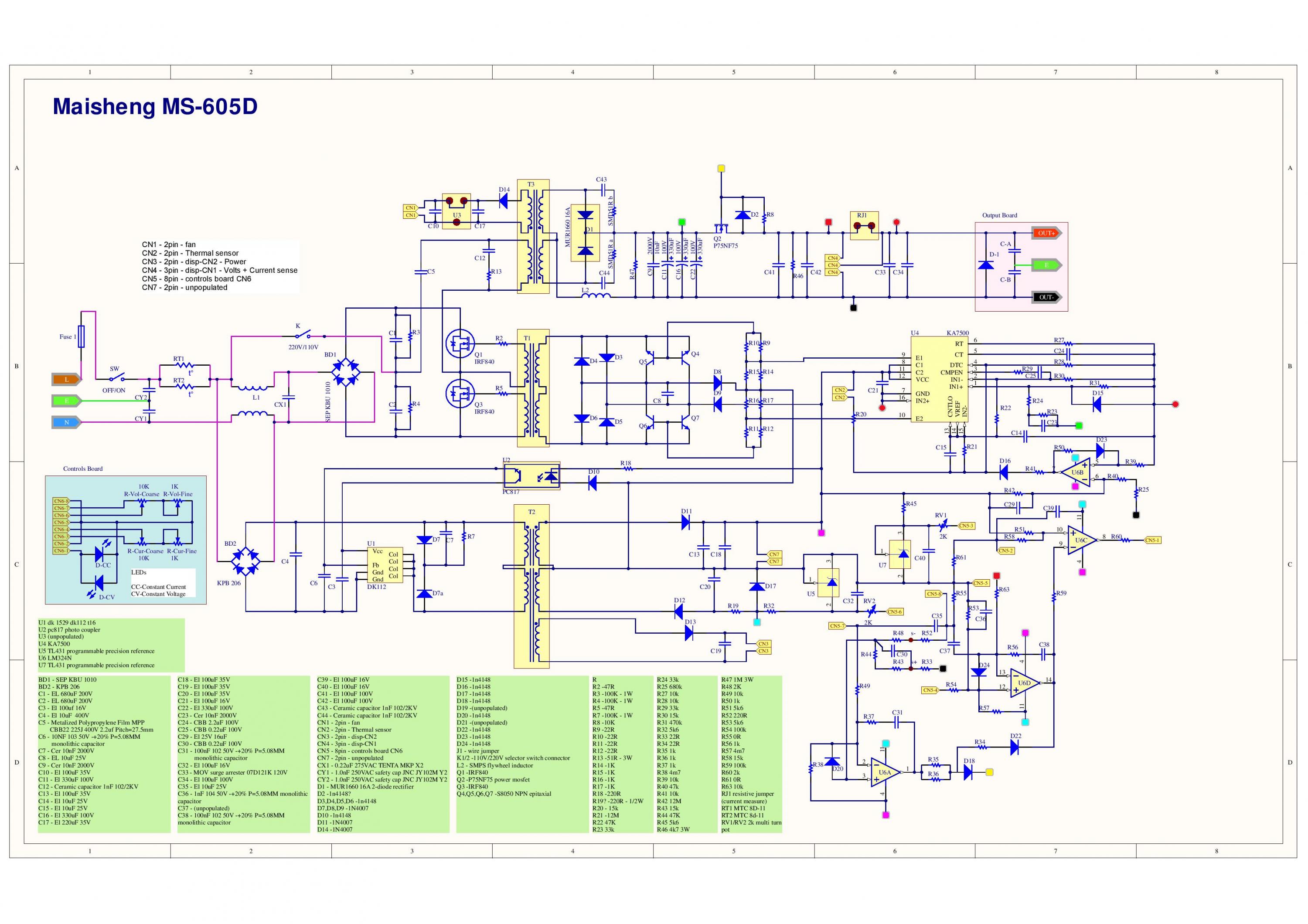

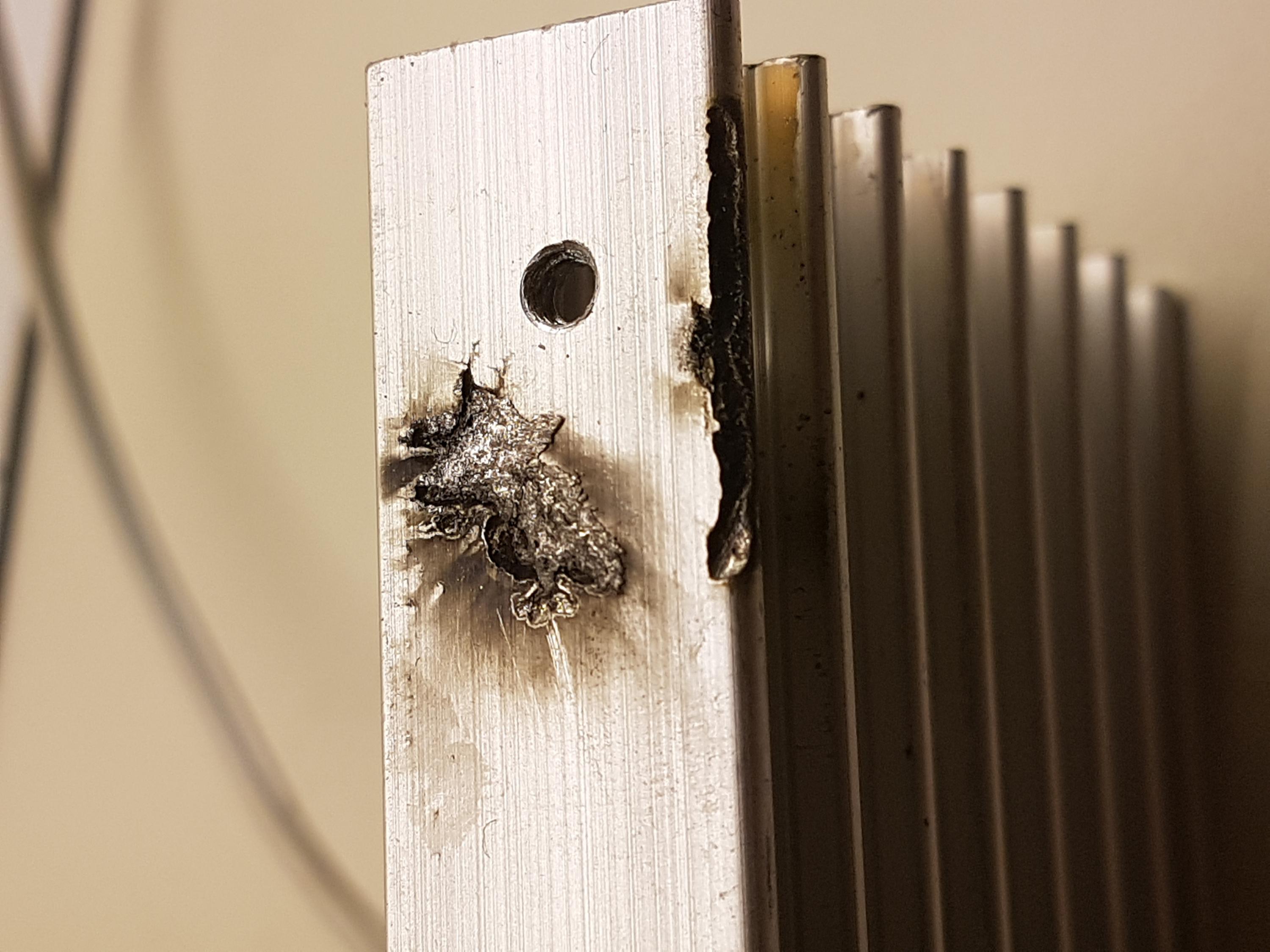

                Re: Dc power supply blow up! (QW-MS3010D)
                It looks to me like the heatsink shorted out the circuit traces? I found this for a MS-605D but I think it is close.
                • petehall347
                  • Jan 2015
                  • 4434
                  • United Kingdom
                  poor insulation technique
                  • Oroshi
                    • Mar 2015
                    • 14
                    • Athens

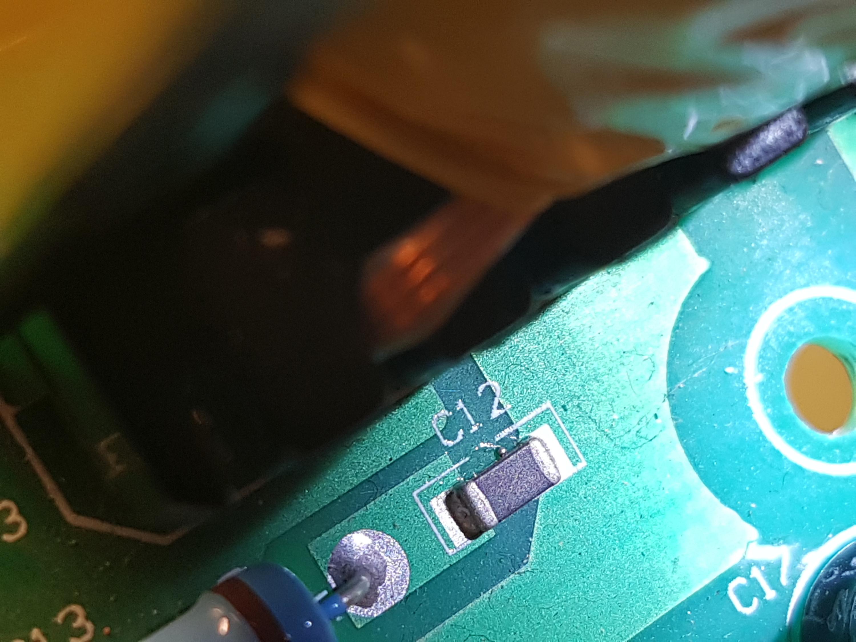

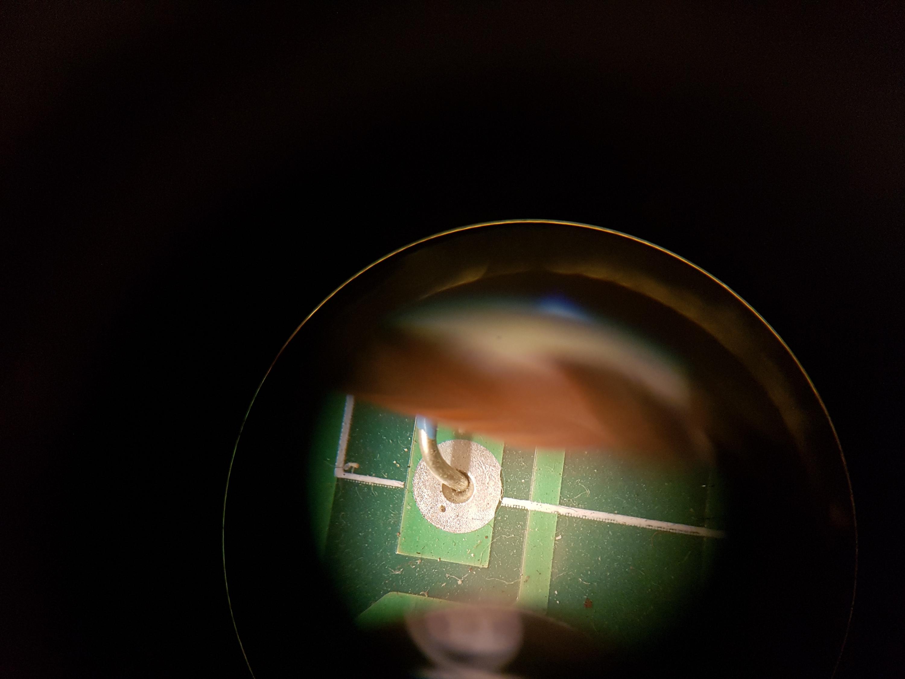

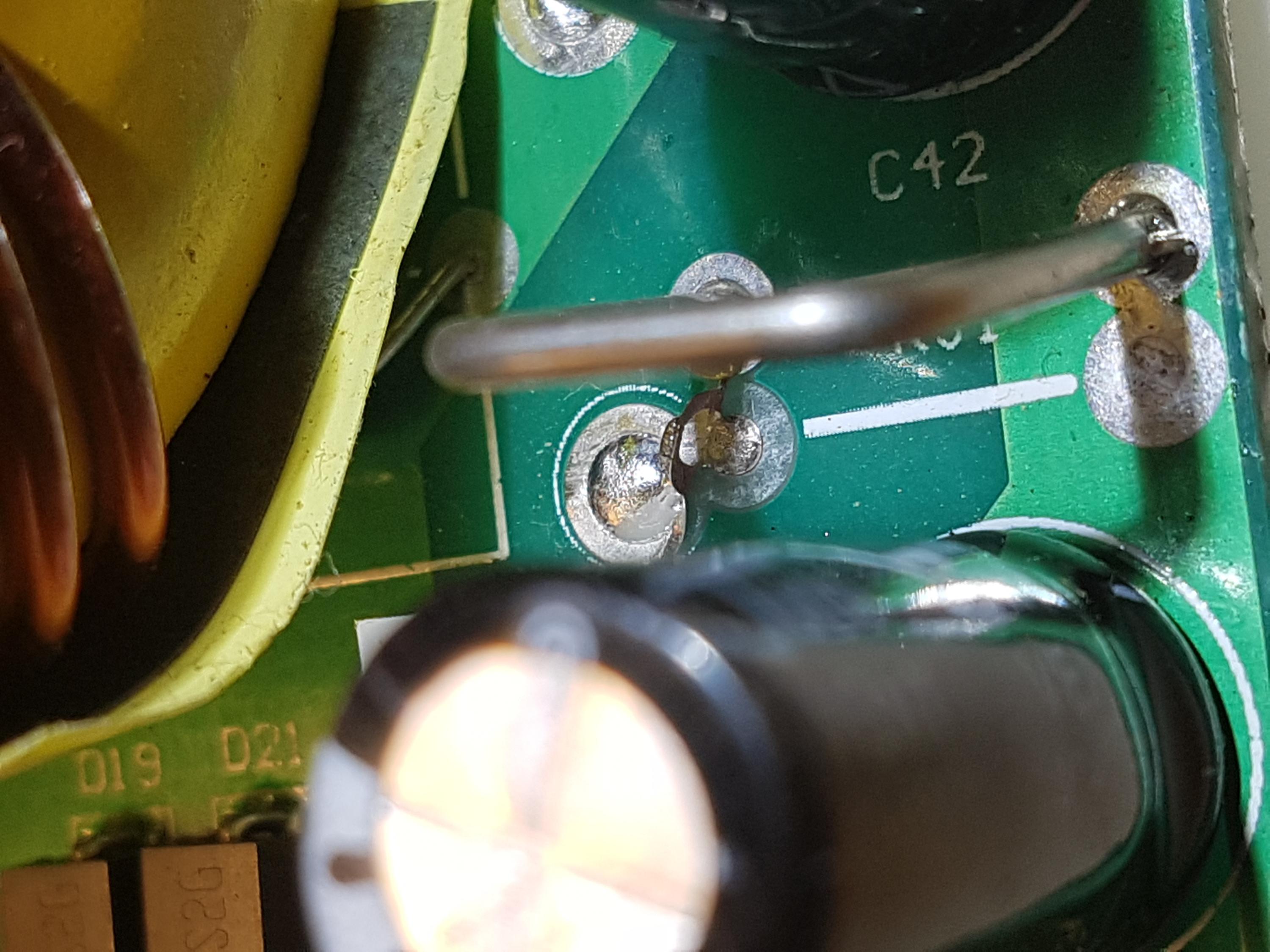

                    Just terrible. R_J I think the same. Also I found more like lifted pads and poor soldering work.
                        That was my thought as well. The pitting on the bottom of the heatsink lines up with the trace that is partly missing. I don't see any insulator to prevent arcing. The other heatsink seems to have traces running under it, too. So I'd be nervous about that heatsink as well.
                          Nice... it was using soldermask to insulate the heatsink from the trace?!!? wow!!!
