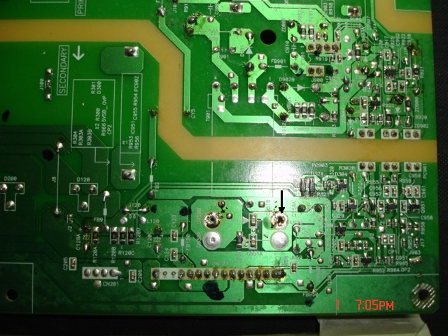

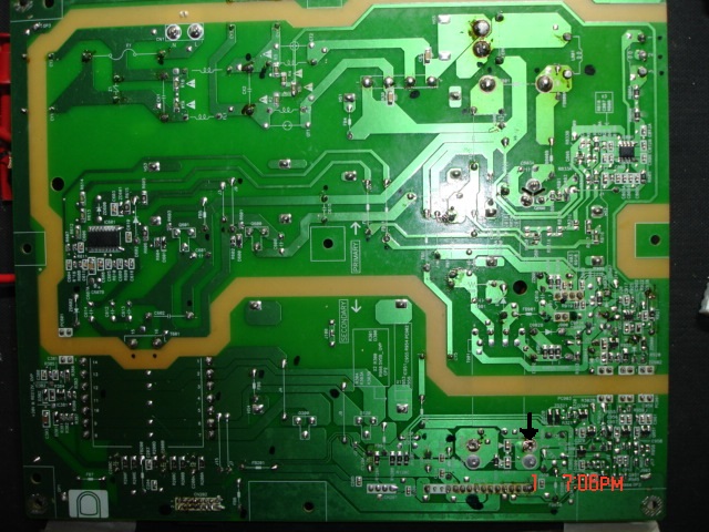

    Hello. I just want some thoughts on a power supply I'm repairing.
    I searched the forum and didn't find much on this power supply.
    The IC failed. It looked like it exploded kind of. I got 5 off eBay and replaced it (with that terrible rosin solder..)
    The IC gets like 9 volts on every pin except for the two separate drain pins that fluctuate between like 10 and 12 volts every half second or so.
    The secondary side has no standby voltage (5vSB) and the diode is short and I haven't replaced it yet. Any thoughts on what else I should test? I didn't notice any shorts on any mosfets.
    For reference for anyone with future repairs: https://www.datasheets360.com/pdf/732173695424627367
    The IC is: LD7913JGM6
    The TV is: M492i-B2
    Manufacturer: Vizio
    (also search does not work on this site? odd)

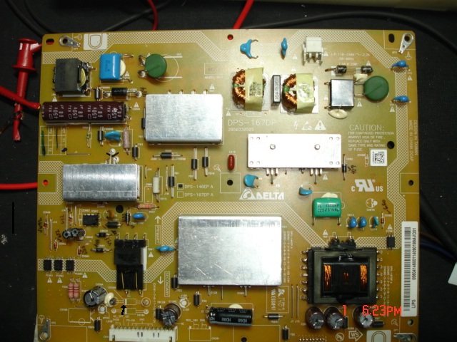

    Re: Standard Vizio Power Supply DPS-167DP
    Lets start with what did you use for GND ref for your meter when you get those Voltage readings?
        OK, you use wrong GND ref. that is why your readings are all wrong, you are working on the hot side of the circuit so you have to use the negative leg of the main filter cap for the circuit GND ref for the hot side.
        Did you also check the resistors R907A, 907B connected to the S pin of the IC and the hot side circuit GND to make sure they are still OK?
        You also need to check the fusible resistor R915 to make sure it is also OK.
            See my updated post #4.
            Main filter cap is C800A.
            Look at the spec sheet of the IC, it shows which pin is the S pin.
            You are working in the hot deadly side of the circuit so you need to at least plug the TV into the GFCI (Ground Fault Circuit Interrupter) and do not touch anything on the board with yours hands or body.

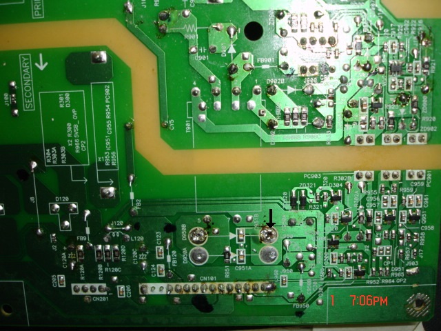

                    there is a reason for that white checkerboard marking on the board, it tells you what components are on the HOT side and which are on the COLD side. ALL voltages on the HOT side are measured with reference to the HOT GROUND (Main Filter or bridge rectifier (-)).
                    All voltages on the COLD side are measured to Chassis ground (like 5 volt standby)
                    What do you mean by THAT DIODE???? they have board locations.

                      Update: I just soldered on a new diode from a VCR that was "40" instead of "30" and works great.
                      Thanks for pointing me in the right direction. I realized the TV was tripping after I measured power from the mains cap on both sides in voltage mode and hitting the power button. The Meter would go out of range about 10 times, then TV would be in standby mode.

                        The one marked in red on the photo. Sorry man, it was kind of hard to see. it's working anyway

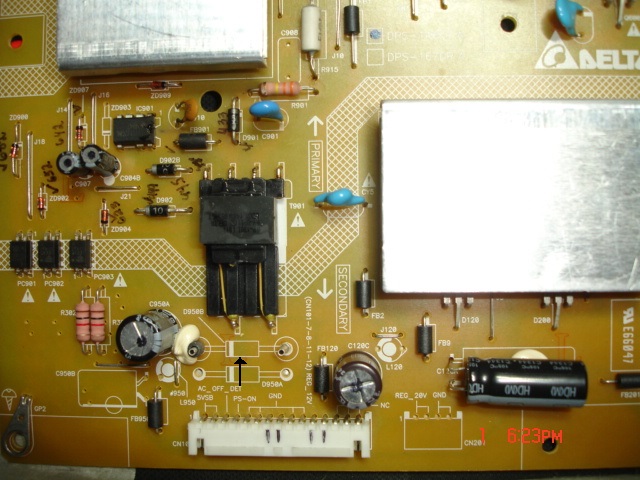

                            That 4.7 Ohms fusible have gone bad due to shorted out SMPS IC901. P/N of IC901?
                            That D950B is just rectifier for the 5VSTBY of that section, it is just schottky diode, 100V 3A rating should be fine, so if have another SMPS 5V power supply board with about the same rating then you should be fine.
                            "Only found 2 bad diodes. zd909 which is a nz4v7d replaced with a nz6v8b " I would out in the same value, they put 4.7V Zener for reason. Is it tested bad off the board? It is connected in parallel wirh R907A/B so it will show conduction in both directions when tested in circuit. See post #4.
                            https://www.shopjimmy.com/vizio-056-...ed-driver.htm#

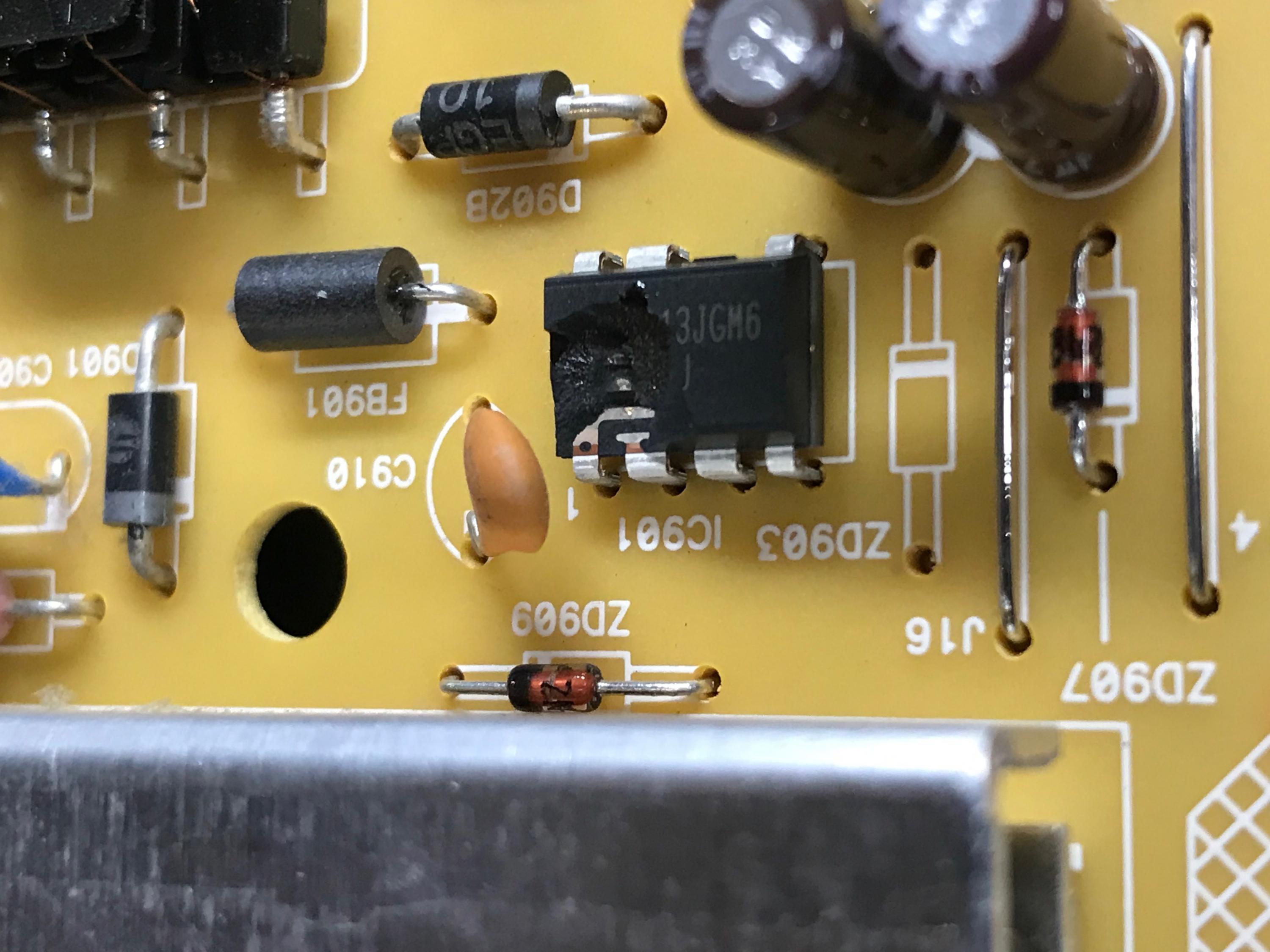

                                  I am having the same issue with a VIZIO E480i-B2 power supply board 056.04146.000 also marked DPS-167DP. The IC901 is chipped So I plan on ordering a new one. I also checked D950b and it read 00.5 ohms?
                                  What else should I check and how before ordering the IC901 = part #LD7913JGM6?

                                      Hello budm,
                                      Thank you for replying.
                                      I did not do any testing on the IC901 legs due to the part being blown.
                                      I did read post #4, I checked R915 with my meter set to ohms and got back a reading of 4.7 Ohms, I did this test without the power cord connected and all the boards in place and connected.
                                      I did find R907A & B on the back side of the board, they both read 00.5 Ohms.
                                      Where do I go from here?
