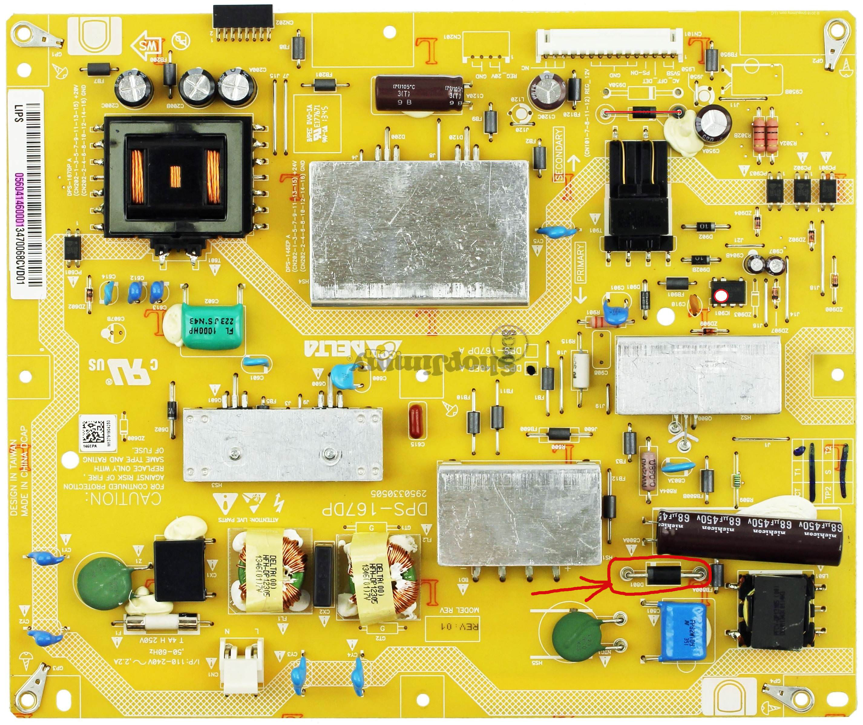

      I'm trying to repair the 056.04167.0001 board as well. I took some electronics courses ~20 years ago in my HVAC repair through the military, so I'm pretty rusty when it comes to this stuff... but in my testing I have zero continuity on the D801 diode, it does not have any reading at all so I believe it is bad, but help me out here. First off, I think I should at least be getting SOME reading on this diode. Second, What replacement do I order for this? It has LT3 MU written on it, but I haven't found ant information about this. I'm attaching a picture with this diode circled in red from an image I found elsewhere on this thread.
          Thank you
          Yes the diode should test ok on a meter.
          I don't know if schematics are available but it looks to be on the primary side so maybe a bog standard 3A diode would work...
            Thank you
            Are you using DIODE TEST on you meter to check it or just a resistance scale? as it is unlikely to be open. What is wrong with the power supply? What voltage do you measure across C800a?
