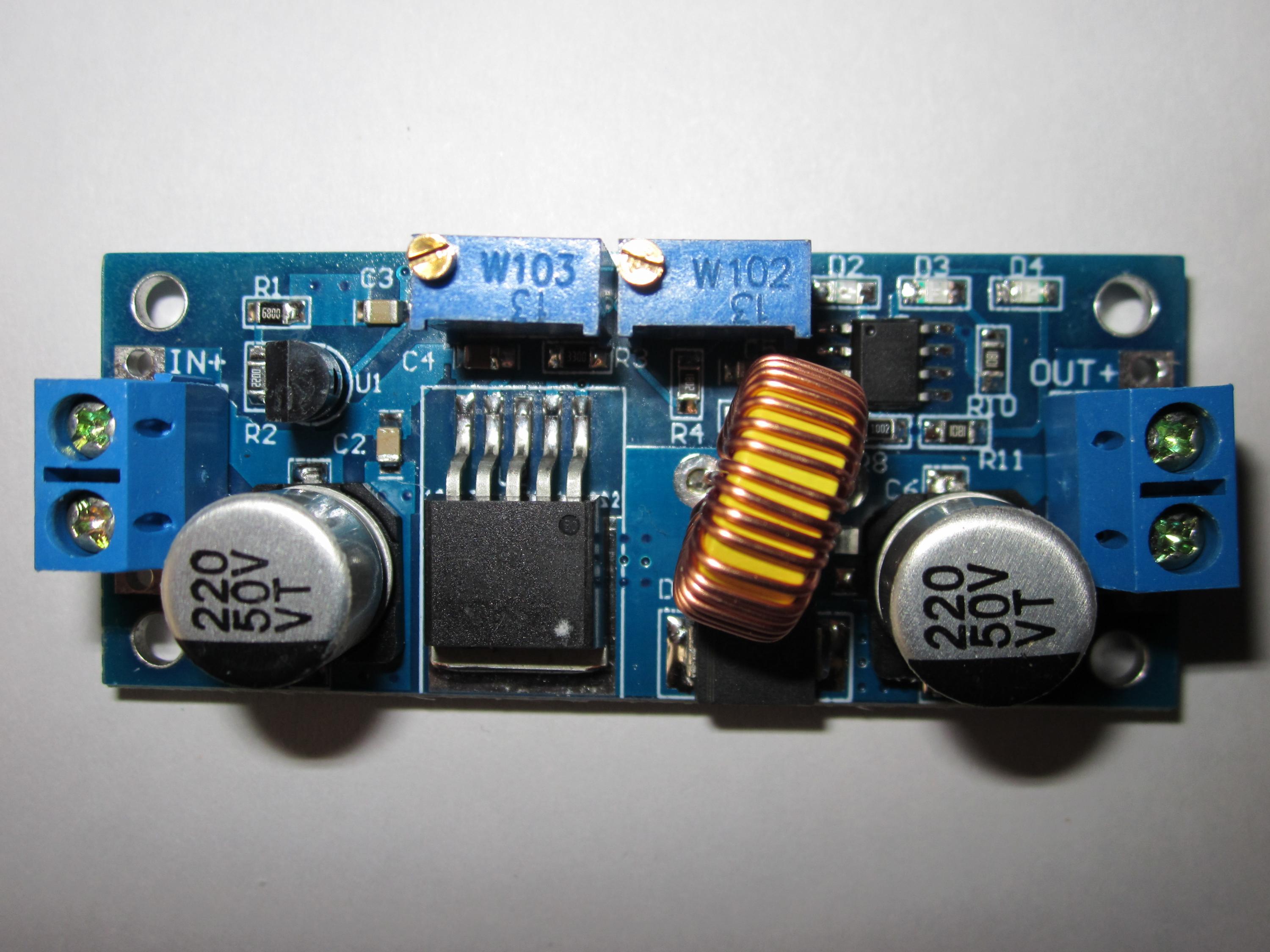

    Hi i have one of these modules
    https://www.aliexpress.com/item/5A-L...72e6cd557ef8dc
    youtube video of it
    https://www.youtube.com/watch?v=sGYP...t=83s&index=19

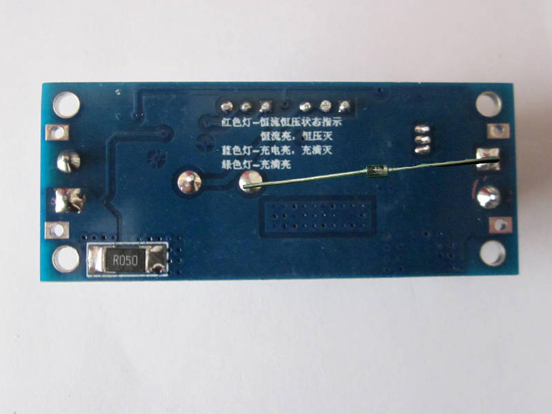

    my question is i need too add a protection diode as if you turn off the power too the module before disconnecting the battery on charge it blows the unit up as mentioned in the video comments, what diode do you guys recommend i add to stop this from happening thanks

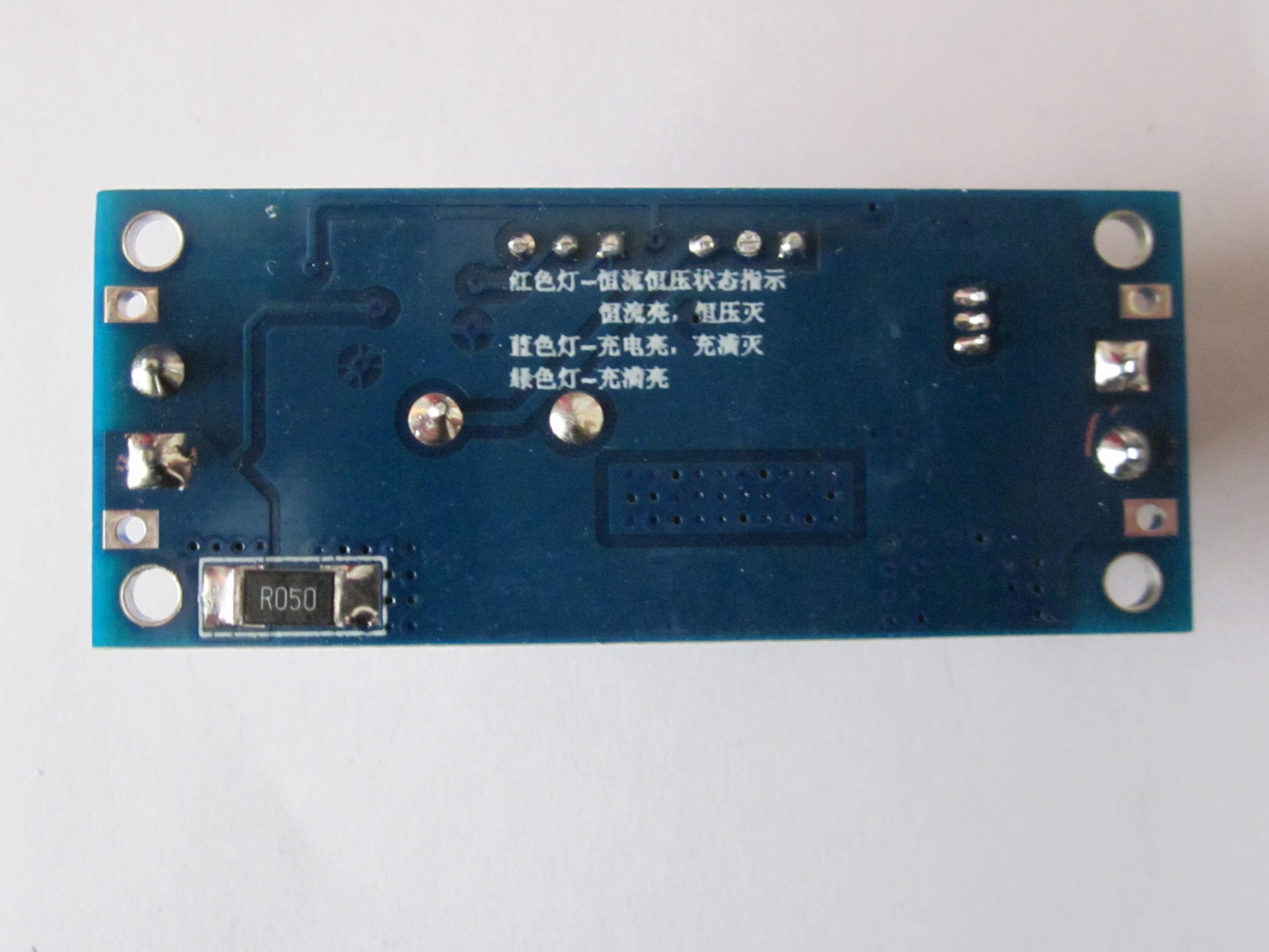

                          i will take some good clear pictures of the unit and maybe you can help me modify it if you dont mind
                            Re: 5a lithium charger modules
                            Can you read the P/N of the IC?
                            Once you find the spec sheet of the IC, it will probably has the application circuits that is more likely to be used by these boards manufacturer. It may also have some caution about the circuit protection.

                              Those modules use XL4015 buck-converter (step down) IC, rated 5A but those are chinese amps... so derate by 1/2 for actual use Some of these modules have tiny diodes, others have large heatsinks.
                              Charging a battery, you get backfeed into the IC if input power is removed.
                              It has a P-ch MOSFET inside so it should have a built-in substrate diode and not blow up if connected to a battery.
                              There is a current spike when you connect only a battery at the output of the buck converter (with no input power).
                              The input capacitors get charged, and maybe this is what damages the IC.
                              You can add a series Schottky blocking diode at the output. Like SS54, SB540, or junkbox parts from a PC power supply.
                              That diode will also make heat, several watts worth (5A*0.4V=2W) and best to have some heatsink if you are going for 5A.
                              The diode will make the exact charging voltage mushy due to its voltage drop, so the IC feedback trimpot might be moved to monitor battery voltage after the new diode.
                              TI Design Trade-offs for Switch-Mode Battery Chargers fig. 17-19 show the situation.

                                  pictures the ics used are
                                  XLSEMI
                                  XL4015E1
                                  72441
                                  LM358
                                  8AK
                                  SSM 158

                                    Now I'm a bit confused what the proper diode is, but I think despite it being more sensitive than what a 1N4001 can handle, it should be just fine.
                                    I think all you need is:

                                      would a IN4007 be ok i have some UF4007 too if not will look on part boards

                                        I was wondering if some schottky diode was needed here or not versus a higher voltage 1n4007, but this should do instead of the 1n4001.
