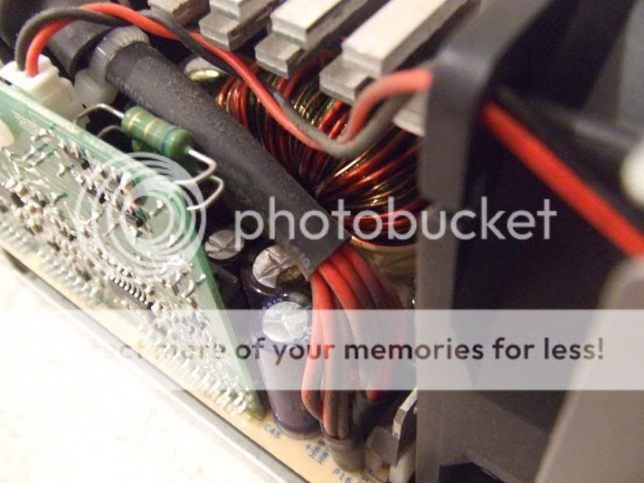

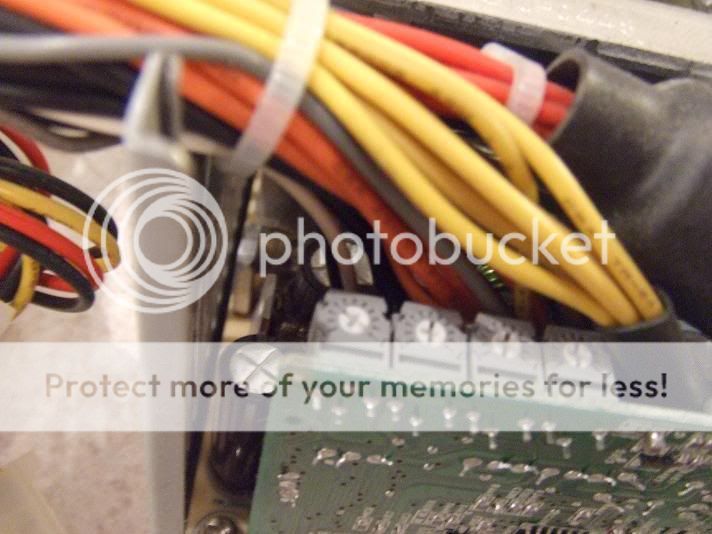

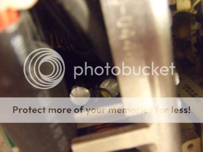

    I picked this up on ebay for $10.00, it looked nice, had good experiences with astec in the past, so i bought it.
    Good thing I did, this thing is pretty nice. Feels heavy. Heres some pics
    An overall picture of it undressed
    The power ratings
    Primary side, big o'l Rubycon right in the middle
    Some of the secondary capacitors, the purple one I don't know what is, but the others are nichicon and rubycon
    More of the secondaries, rubycons
    Last of the secondaries, Nichicon and UCC
    Overall, it is very nice. I like it, it feels much heavier and looks much more well built than the rosewill 500W it is replacing.

    That 3.3V and 5V is not combined! Only the two on aux lines are. Means GOOD design.
