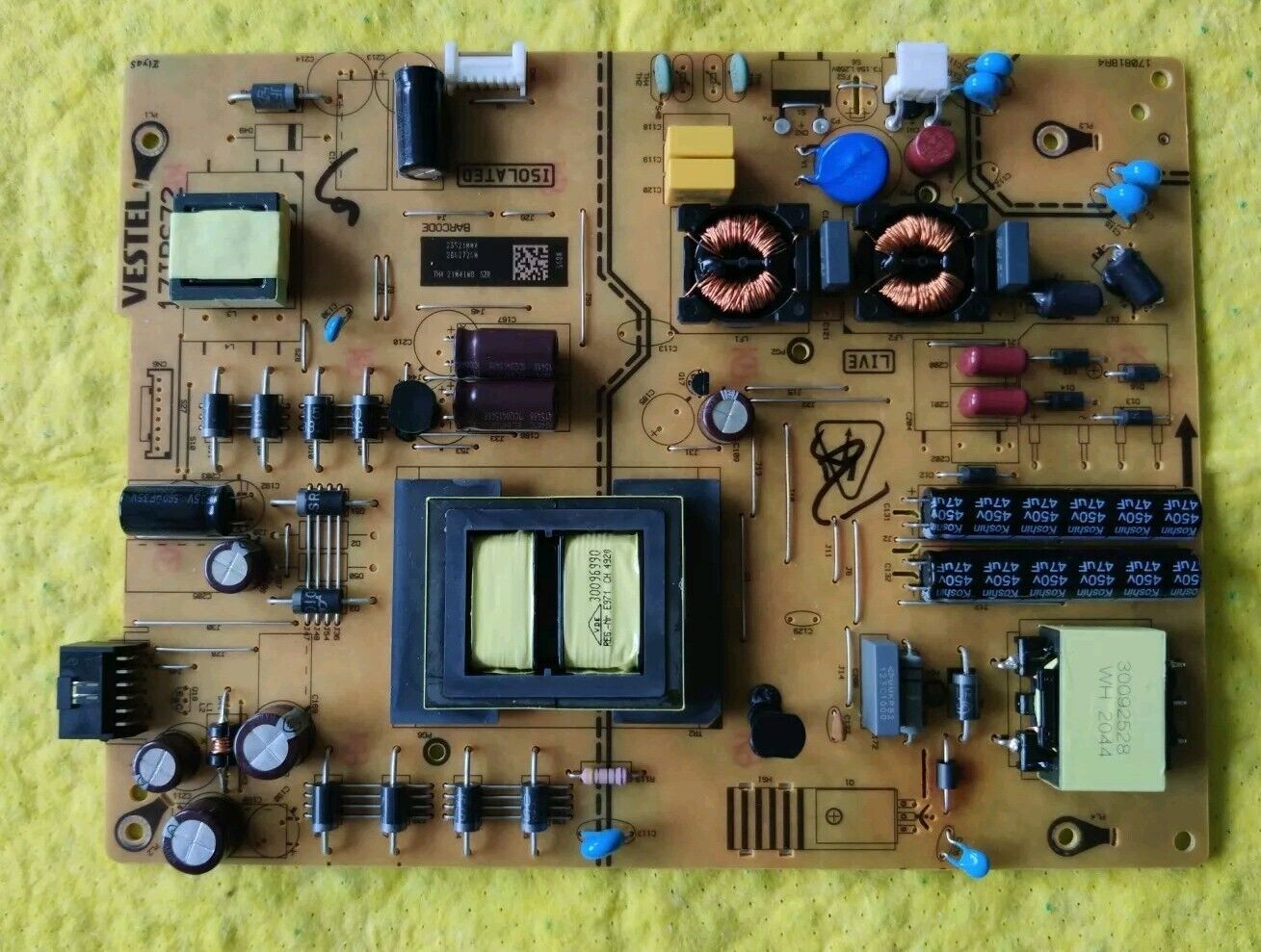

    Haven't pulled it apart yet but attached a pic of what should be the PSU board which I found online. 17IPS62 23521004
    E: Just took a look through the vents, it looks like the board is actually a 17IPS72.

        • Davi.p
          Hobbist Tech
          • Sep 2009
          • 4419
          • Italy - Milan
          Which is the AV board?
