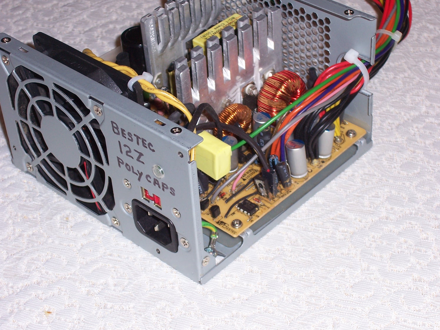

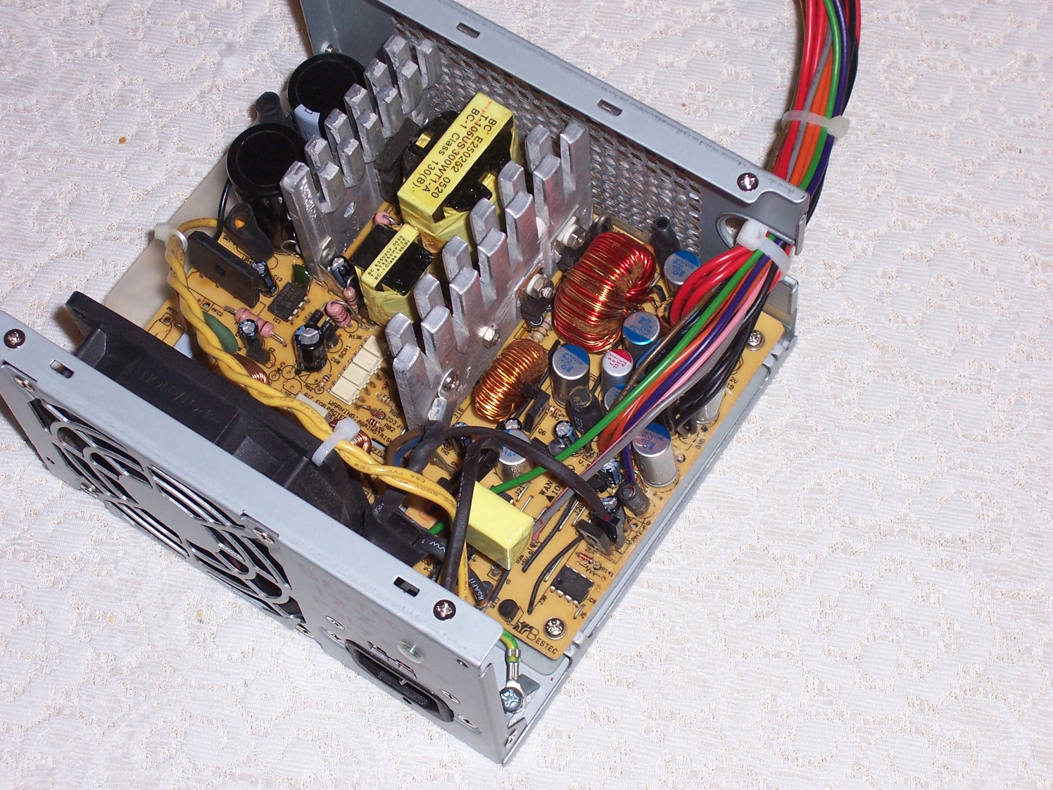

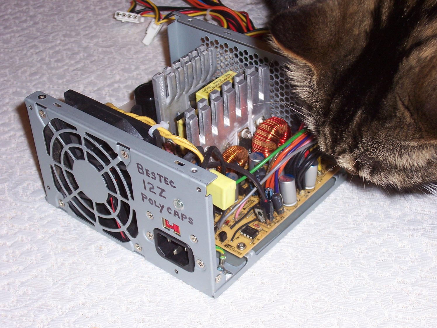

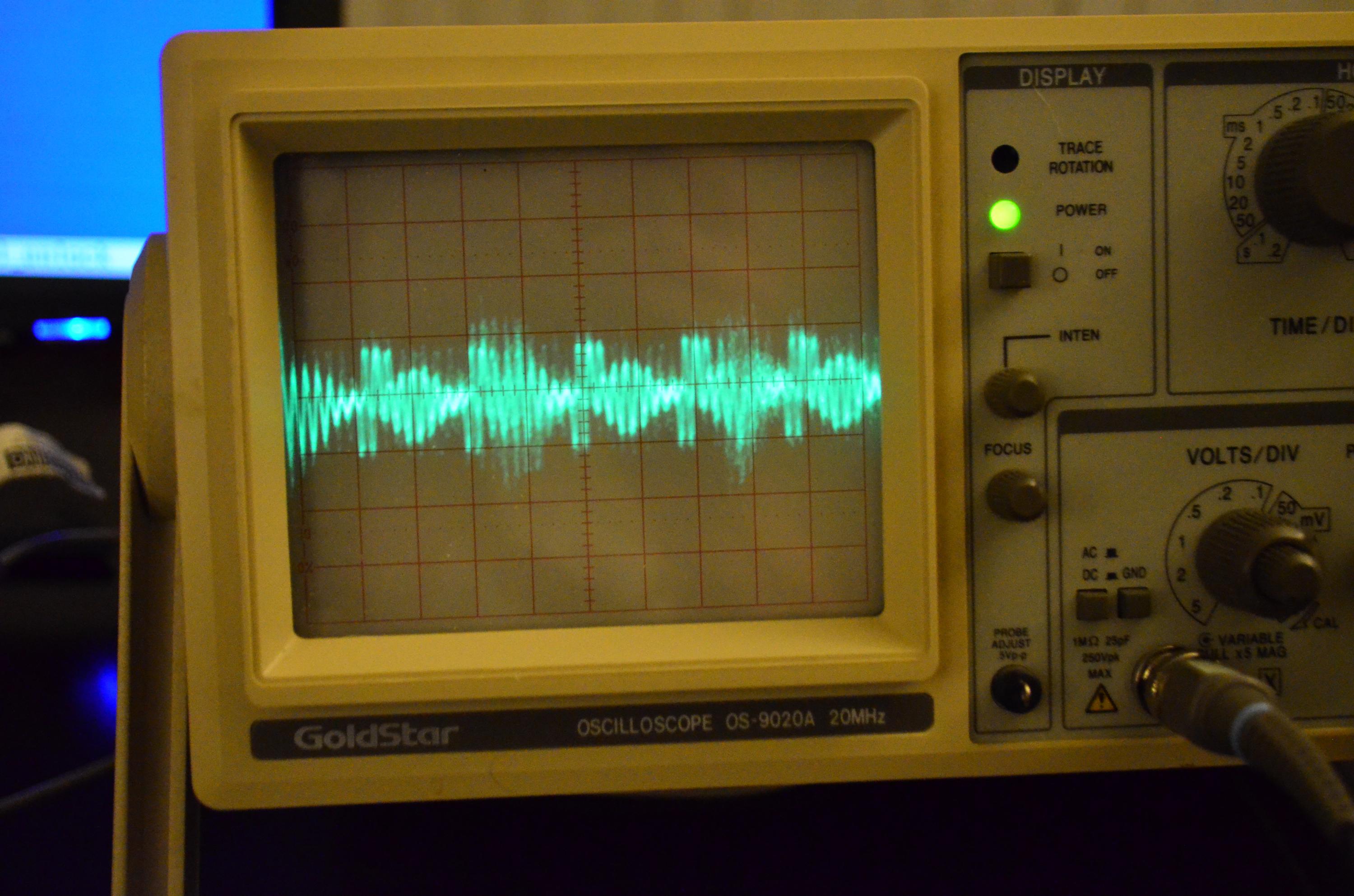

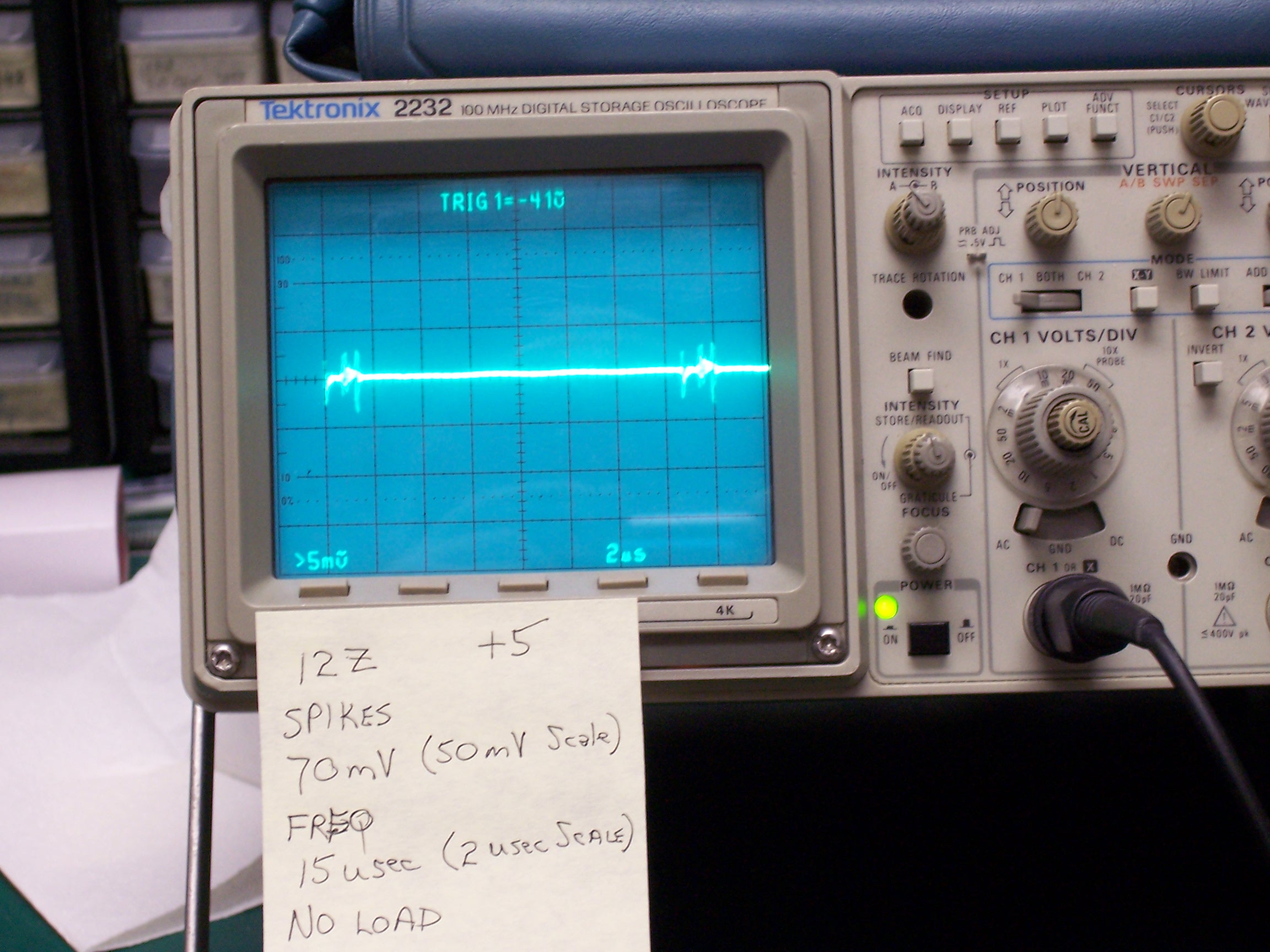

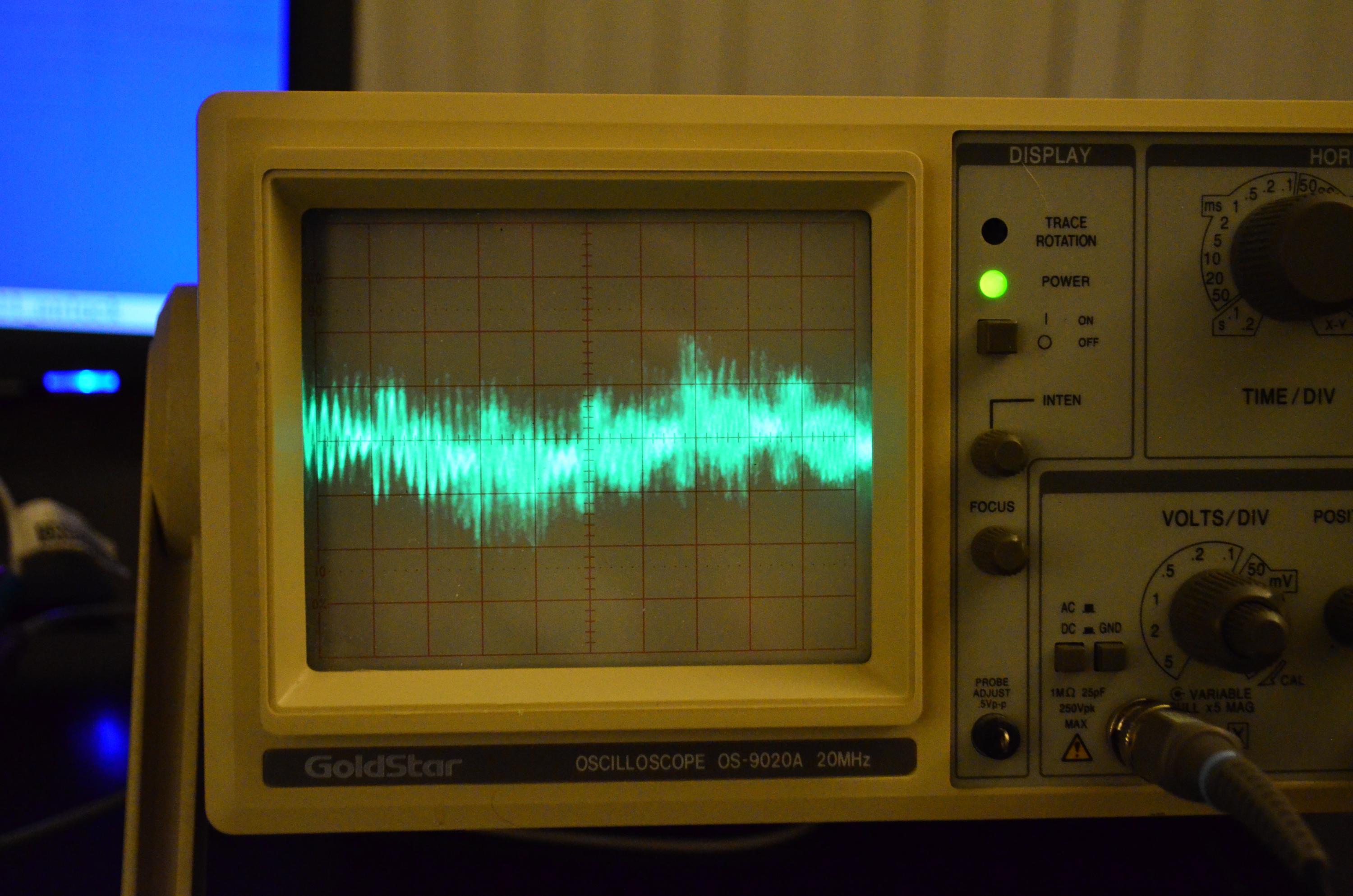

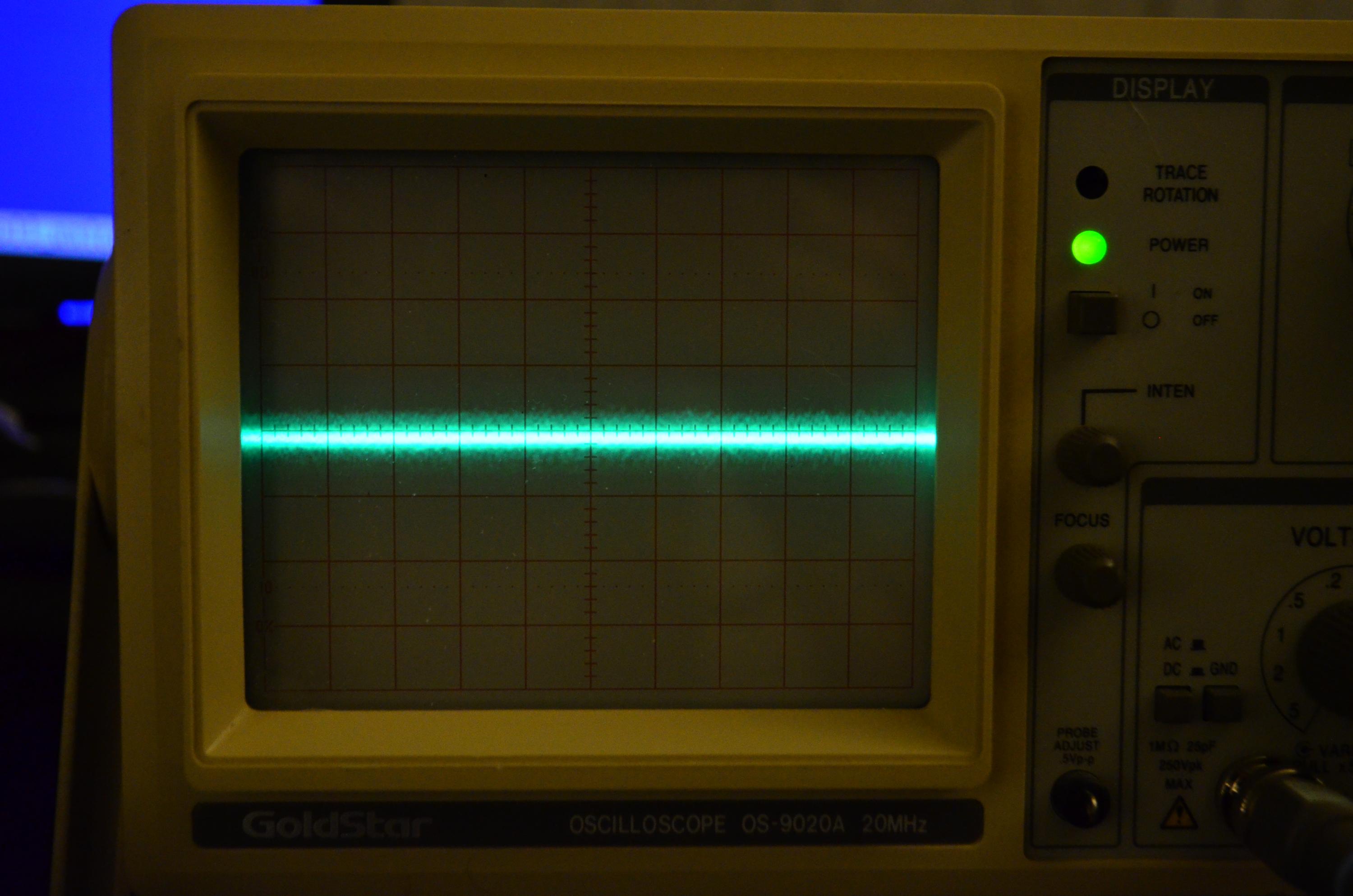

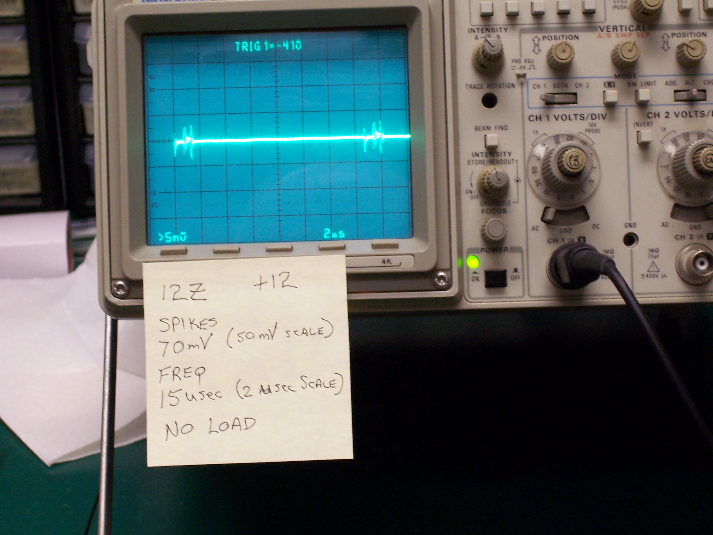

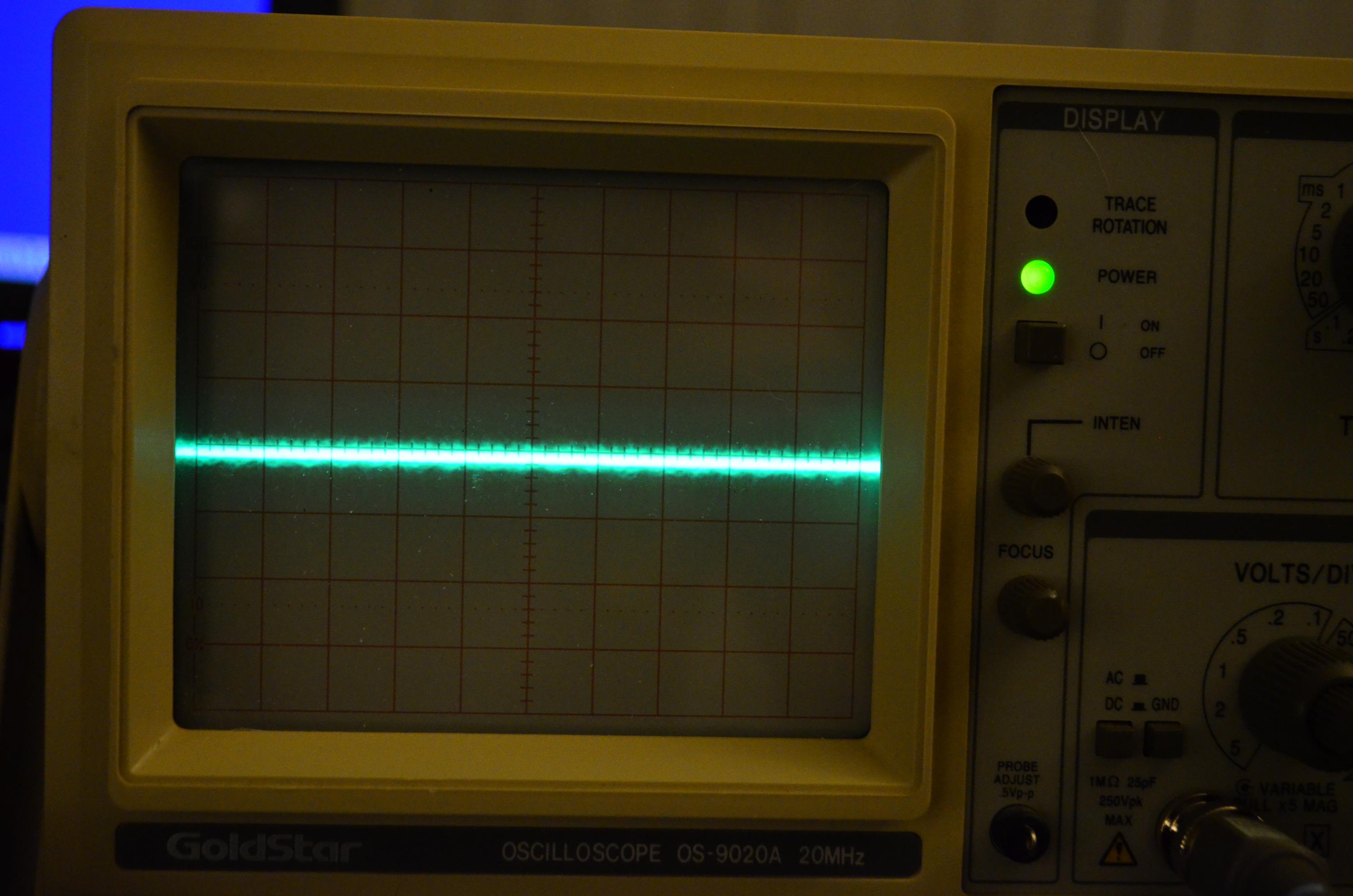

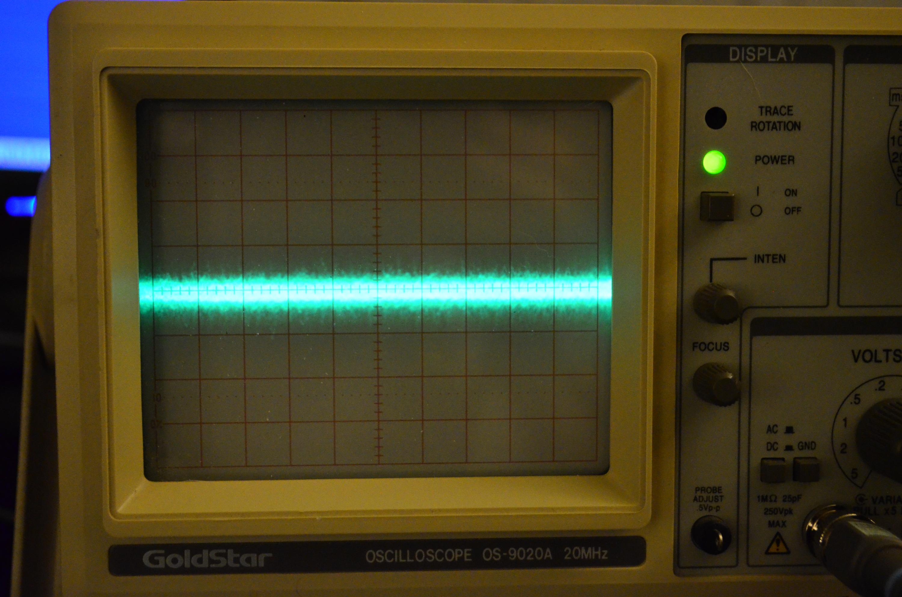

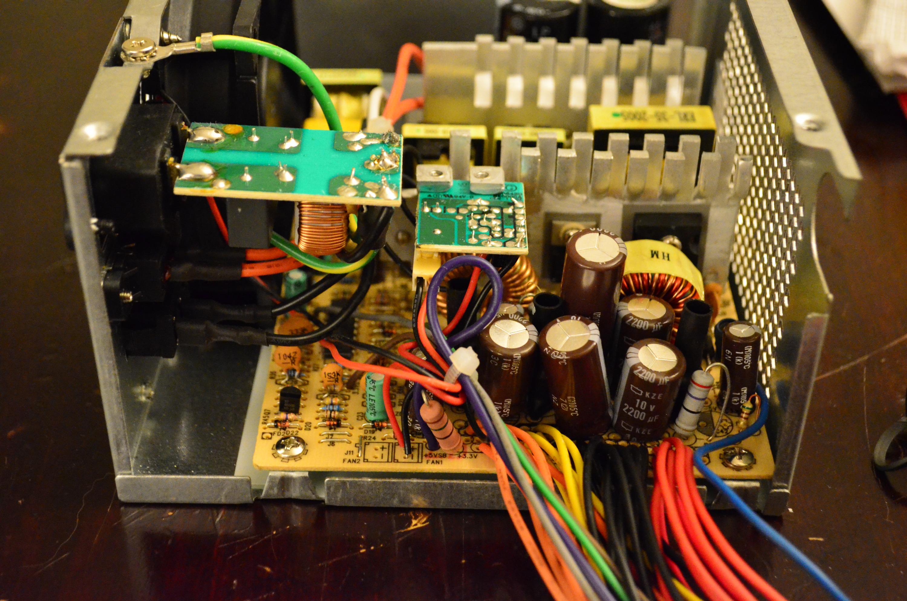

This is a Bestec ATX-250 12Z. Lots of them out there. I fixed this one some time ago. I decided to modify it using polycaps in the pi output filters on the 12, 5, 3.3, and 5vsb outputs. I used United Chem-Con PSG series 2200 uF/16 volt polycaps. After the modification, all is working well.....so far.
