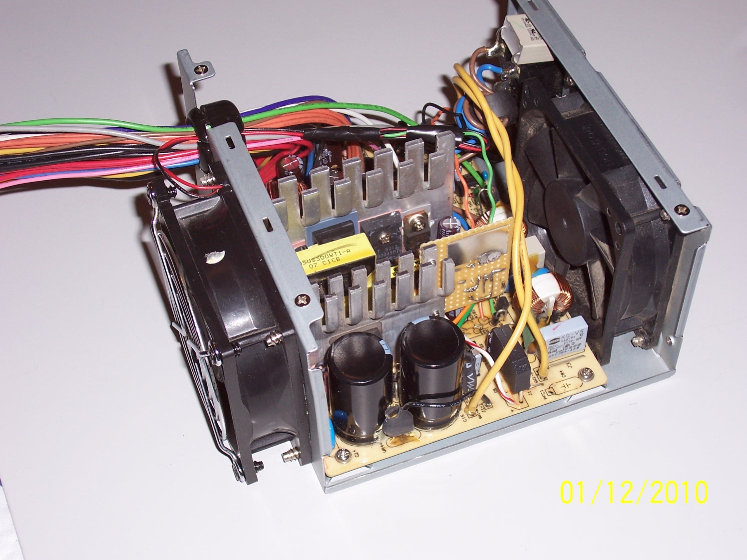

            Stupid jokes aside, only the Bestec ATX-250 12E (and only that model) has the 2-transistor "mobo killer" 5vsb circuit. I think Everell and Severach did a pretty extensive research on that one.

              The Bestec ATX-250 12E is a GREAT power supply. I am still using one in one of my computers. The original 5vsb circuit has some design problems, but adding a small pc board with DM311 pwm chip takes care of that problem. Any glue that has turned brown or black must be removed (because it becomes conductive). And of course, the cheapo capacitors should be replaced. Best of all, you can install a fan on the back side of the power supply case, remove resistor R102, then install fan wires where R102 was. (If fan is too noisy just add a little series resistance in one of the fan leads) When computer is off but plugged into the wall outlet, the added fan will keep everything cool. When you power up the computer, the added fan shuts down and the original fan comes on and continues cooling the power supply. So don't say too many bad words about this really neat power supply!

                very impressive! i love it when someone takes a compromised design and turns it into something decent keep up the good work!

                  Nice job! Did you cut out where the fan is? I suggest you do becuase if the fan has the shove the air thorugjt the little vent slits in the psu casing there will be more noise and lower airflow

                    I used a nibbler tool to cut out a big hole before mounting the fan. Lots of air flow!
