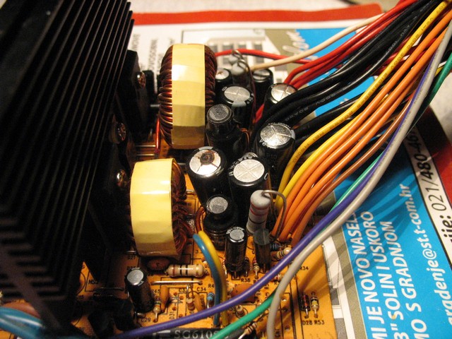

          JPCE are certainly not the worse out there, but they are bad.
          I have seen some newer psu's with them vented in them, and I have seen some p3 era enlight psu's with them still running just fine.
          • i4004
            • Oct 2006
            • 2029

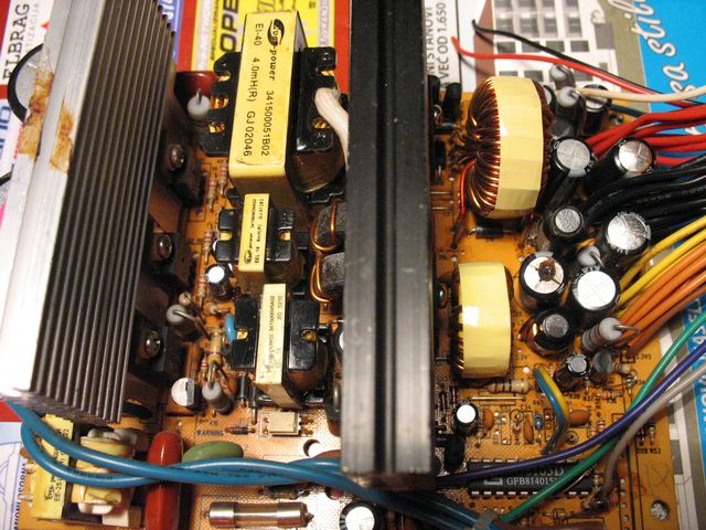

            Re: Bestec ATX250-12E up and running!
            >My opinion [which is consistent with the most experienced people here] is that CEC [JPCE-xxx] is:
            A crap brand marginally better than Fughyyu.
            Absolutely not up to Samxon quality.
            Not quite on a par with Teapo in PSU's, more like OST.
            i did well in persuading pcbonez there are more than 2 grades of quality.
            <wink>
            he mentions no less than 4 grades above....yiiihhhhaaaaa!
            >I interpret these readings as reasonably good. Therefore the heart of the problem with this PSU was the bad 5VSB circuit, including the one bad bulging capacitor which was trashed many days ago.
            yes, it's the 5vstby circuit: badcaps on the output can't blow the mobo.
            as linuxguru condensed it nicely:
            Actually, the two transistor +5Vsb circuits (either BJT or MOS switch) are reliable - but one electrolytic (usually 22uF/50v or 47uF/50v) used on the primary side of the flyback is critical. It eventually dries out, causing an auxiliary secondary-side over-voltage on both the controller power rail, as well as +5Vsb. If it doesn't take out the mobo first, it will take out the PWM controller circuitry and then the mobo.
            the silliest thing is this: i've found 5vstby circuit (in cheap chinese crap psu) that doesn't have any lytics in primary of 5vstby circuit.
            so they could of build better circuit with less components(cheaper) if they knew what they were doing.
            see attachments.
            notice bulging caps everywhere, even on 5vstby secondary...this psu is still working.
            "brand" of this one is "maxpower".

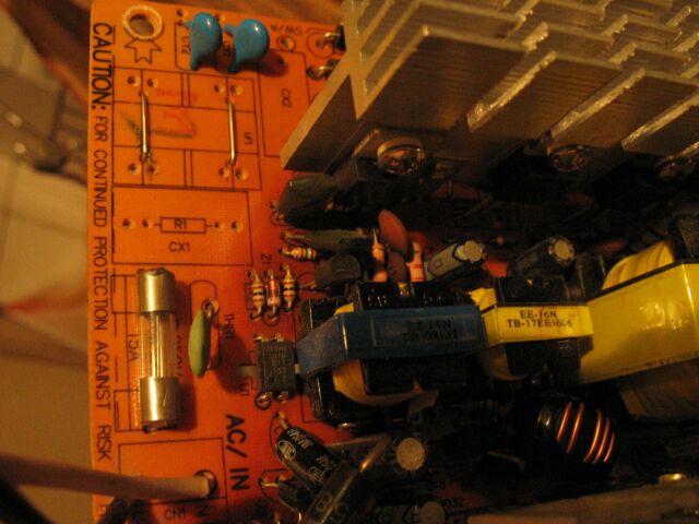

                    First, and most important - SAFETY. Personal safety. All of these power supplies have dangerous voltages when operating. That's why they are in a metal box. For those trained in working electrical equipment and electronics, they are great to experiment with. Carefully, and with the greatest respect for the dangers of electricity.
                    Secondly, Bestec ATX250-12E has a known design flaw in the 5vsb circuit - well documented in this forum. Replacing the critical capacitors, C1 and C50, and replacing the output 5vsb capacitors, C36 and C37, will in most cases get this psu operational again. This too has been documented by several members. But even with these repairs, C1 can again fail with more aging, and blow up, taking the mother board with it. Also documented on this forum. Therefore, this model psu - without modification - is like a time bomb. In my opinion, it should NOT be used even after replacing C1.
                    And third - for those of us who like to experiment - it can be modified and made into a very dependable power supply. But - if you don't have electronics training and background, or if you don't feel comfortable working with the high voltages in a computer power supply - then don't attempt modifications. Just put it in the dumpster OR sell it on Ebay!

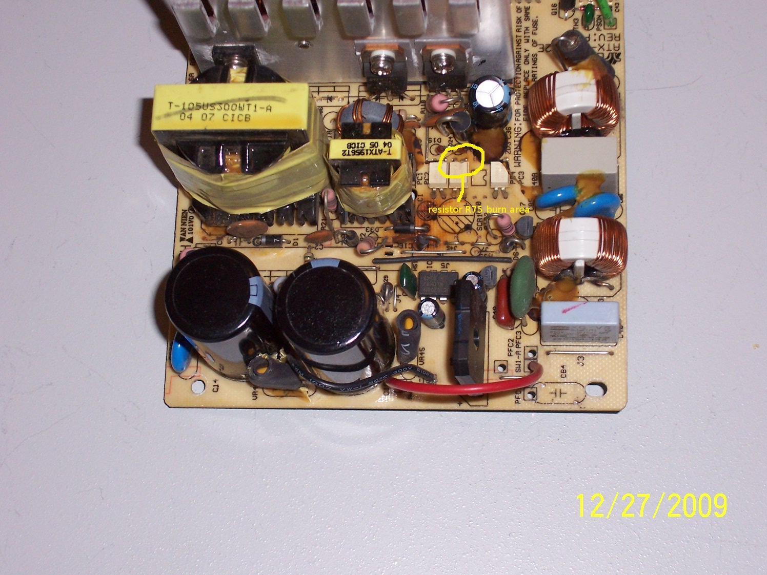

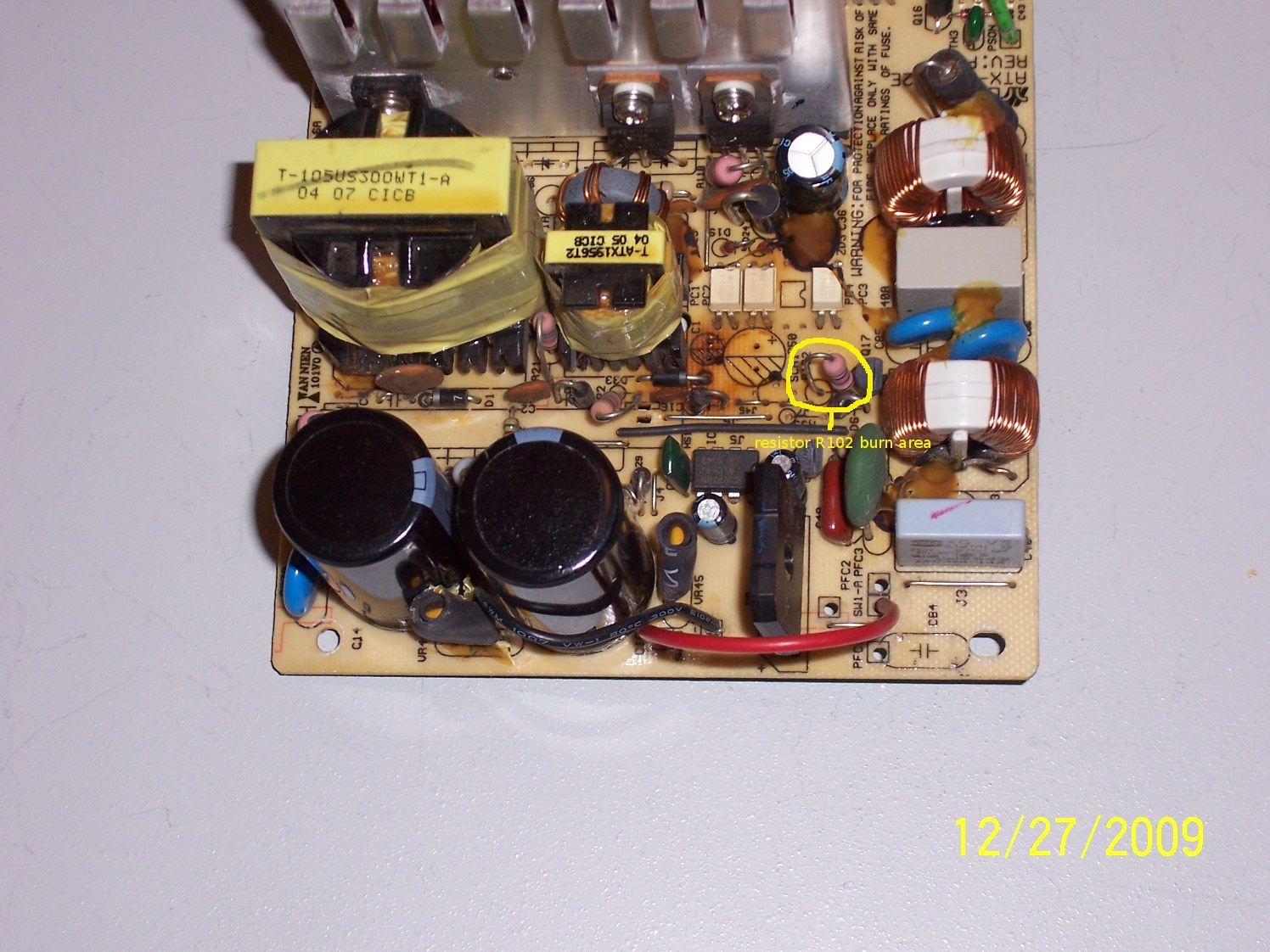

                              The poly capacitor would probably work OK and last longer. Good idea from that standpoint. But if you are unfortunate enough to have a repaired Bestec take out your motherboard, its enough to make a grown man cry!

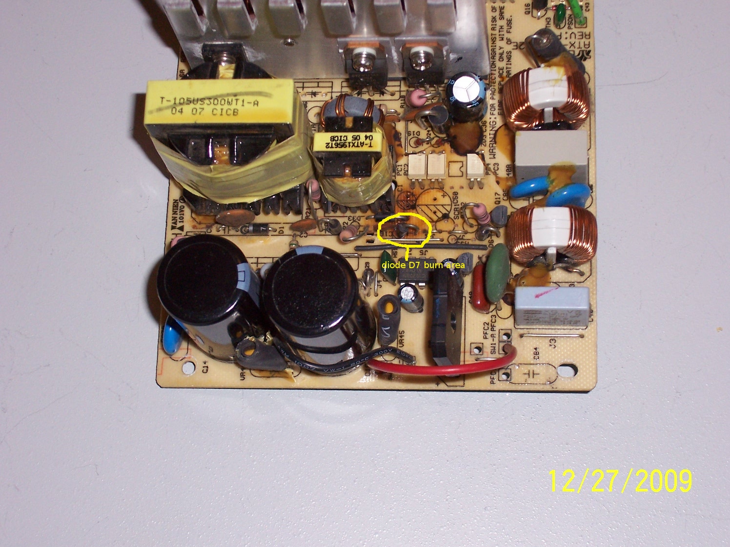

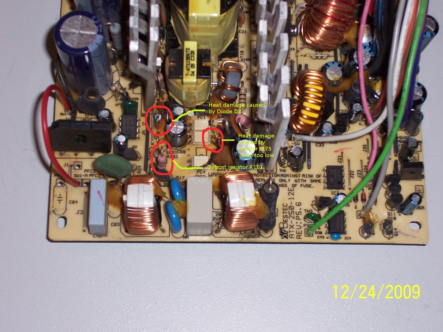

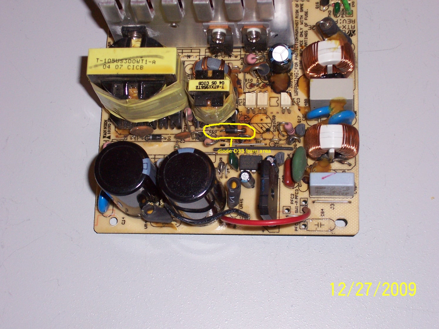

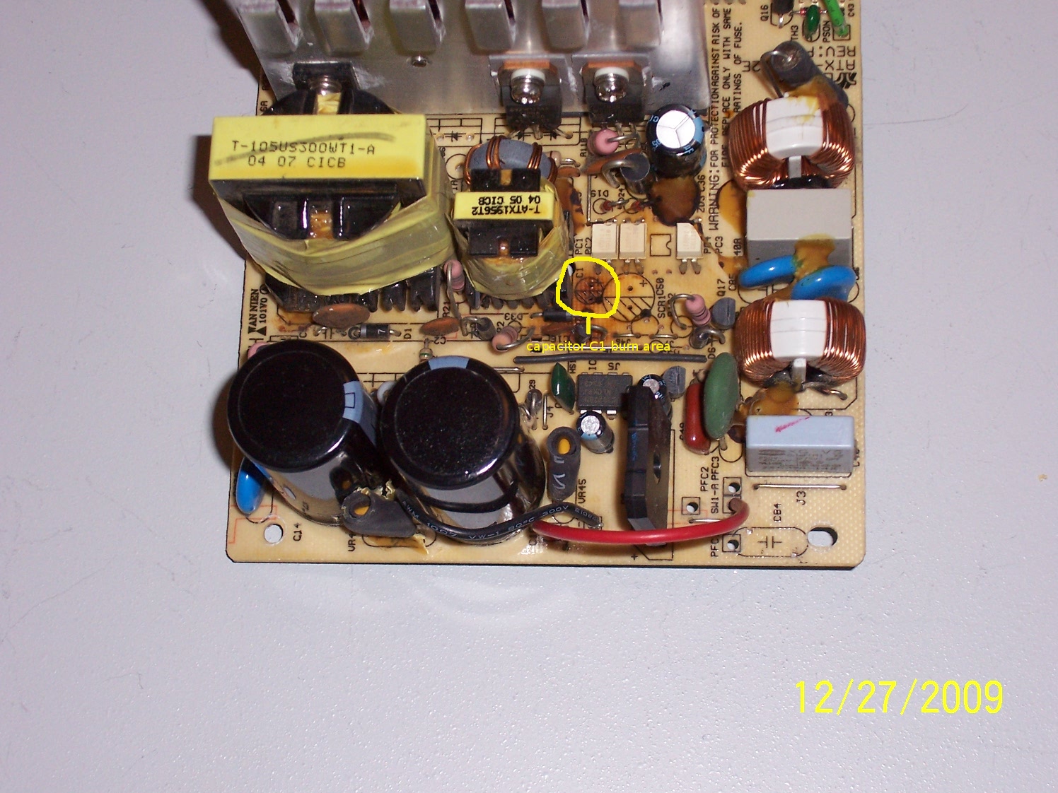

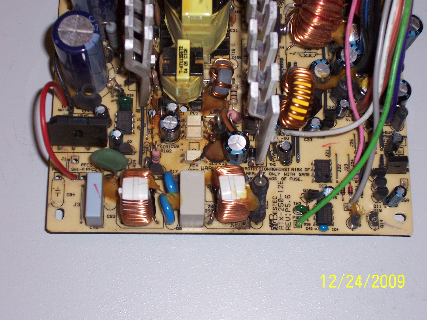

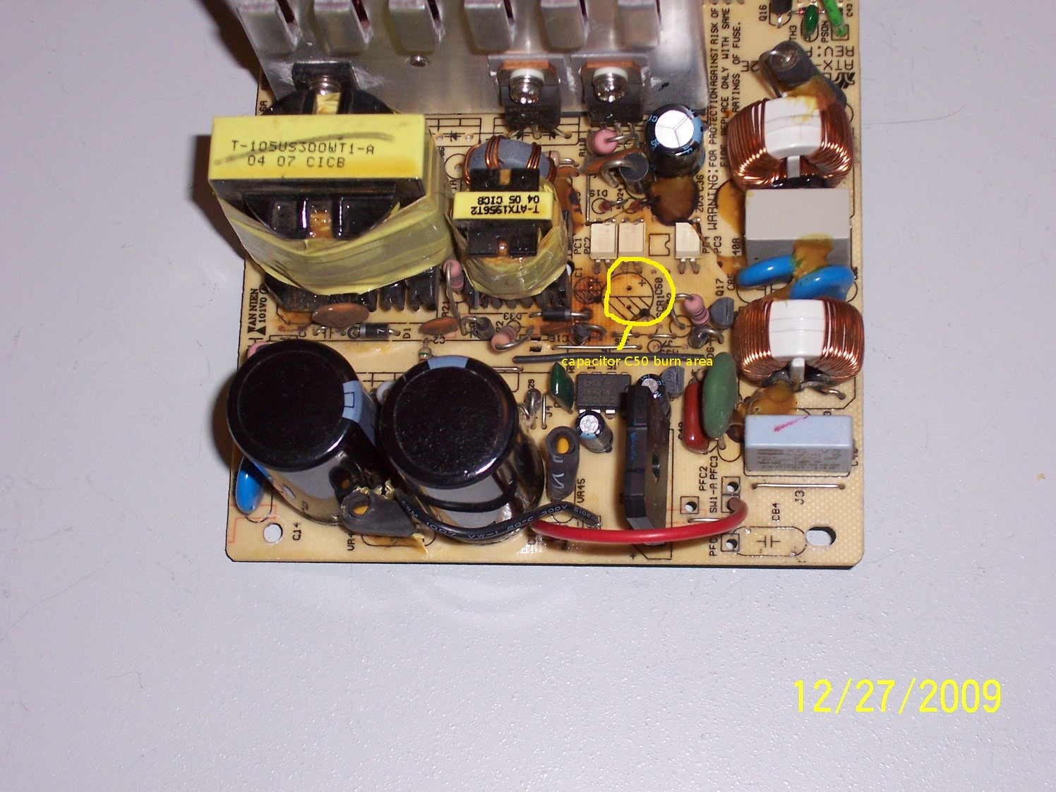

                              I now have a second Bestec ATX250-12E Its 5vsb was still functioning OK. Took some photos of it to show beginning of heat damage - but not as bad as when they actually fail.
                              Old proverb say.........If you shoot at nothing, you will hit nothing (George Henry 10-14-11)

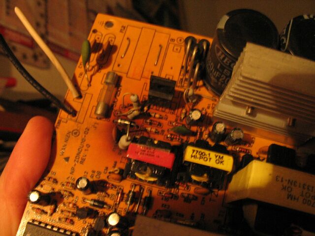

                                  I worked on a Fortron FSP200-60ATV which had two transistor 5vsb circuit and zener across the 5vsb output. I don't know the sequence of events of the failure, but it most likely went overvoltage. The zener began conducting current until it exceeded its max limit and shorted. The two transistor 5vsb circuit continued pouring out more energy which went thru the 5vsb diode rectifier, thru the shorted zener, and to ground, This caused the burn damage circled in the photo. The burn area went all the way thru the pc board making it useless for repair. This problem continued until it blew the fuse.
                                  The solution is to use pwm type chip which detects overvoltage and overcurrent problems and shuts down.

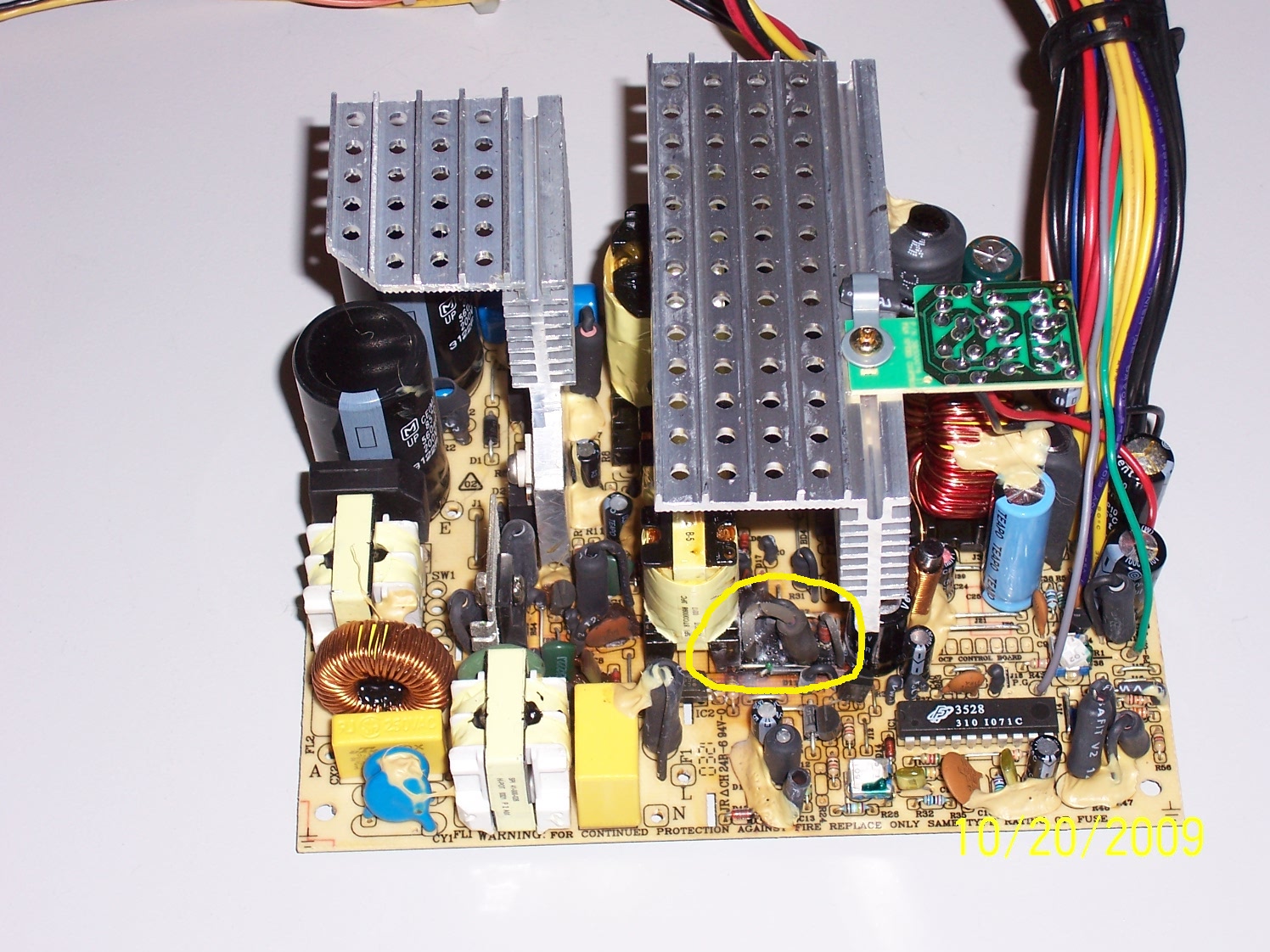

                                    just found this gem: one (power) transistor and no feedback circuit at all.
                                    luckilly it didn't cause mobo damage.

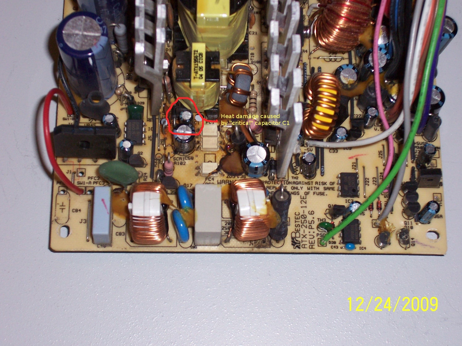

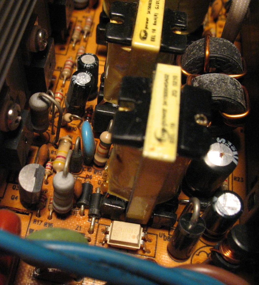

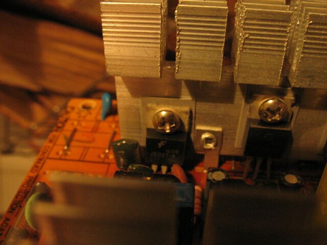

                                        Back to the Bestec ATX250-12E
                                        I removed the heat sink with the two switching transistors and capacitors C1 and C50.
                                        C1 = Jamicon 10 uF/50 volts esr > 99
                                        C50 = CapXon 220 uf/25 volts esr = .92
                                        This 5vsb circuit was well on the way to failure, but had not yet blown up, or gone very far overvoltage. Here are photos showing the burn damage from each of the six components that results from C1 failing.
