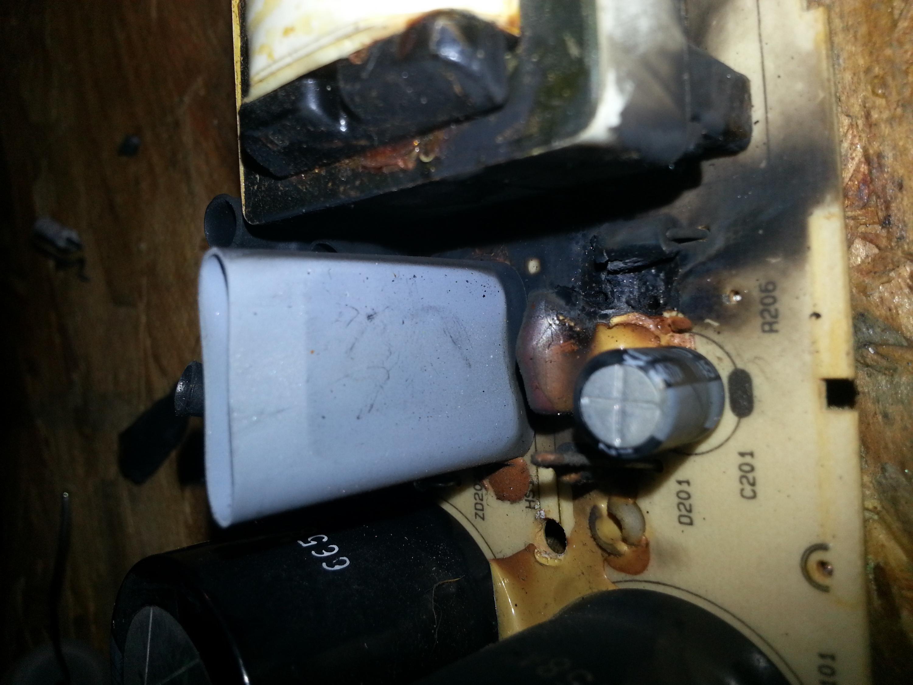

    So I haven't powered this machine up for some years, but when it powered it off last, there were no problems. Before powering it up, I opened up the machine and blew it out with compressed air. Everything was clean. So I plugged it in on turned it on. BZZZZZZZZ! Turned it off. Opened the machine, pulled the power supply, hooked up the PS to AC with no load. FIRE! Turned it off.
    It looks like a diode shorted and burned.
    Luckily I have another identical PS that I can identify the parts. So, get new parts and turn it back on? Should I also replace the same part on the non-burned power supply? Do diodes age? I haven't plugged in the other PS just in case.
    Burned section:

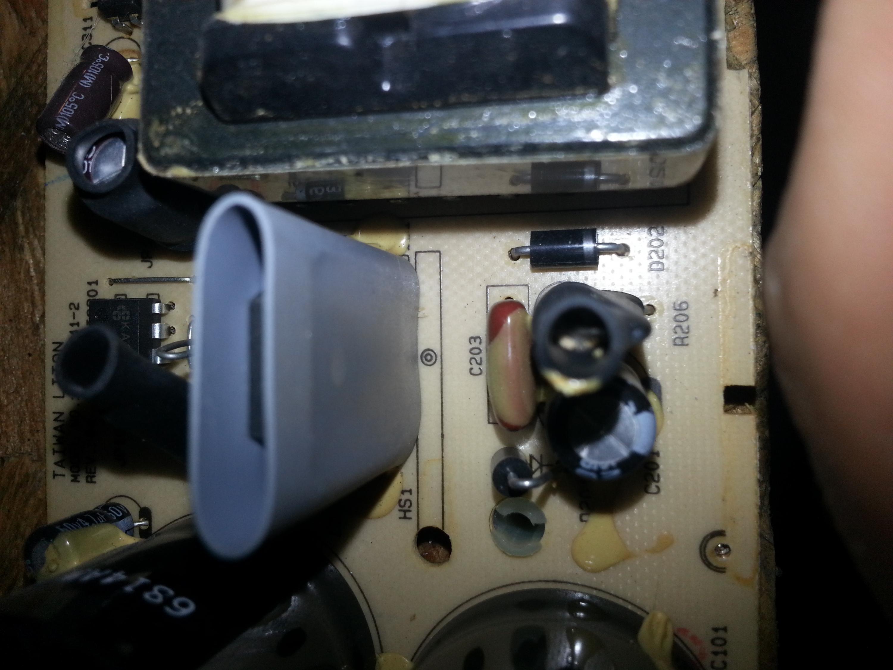

    Same section on a different power supply (same model)

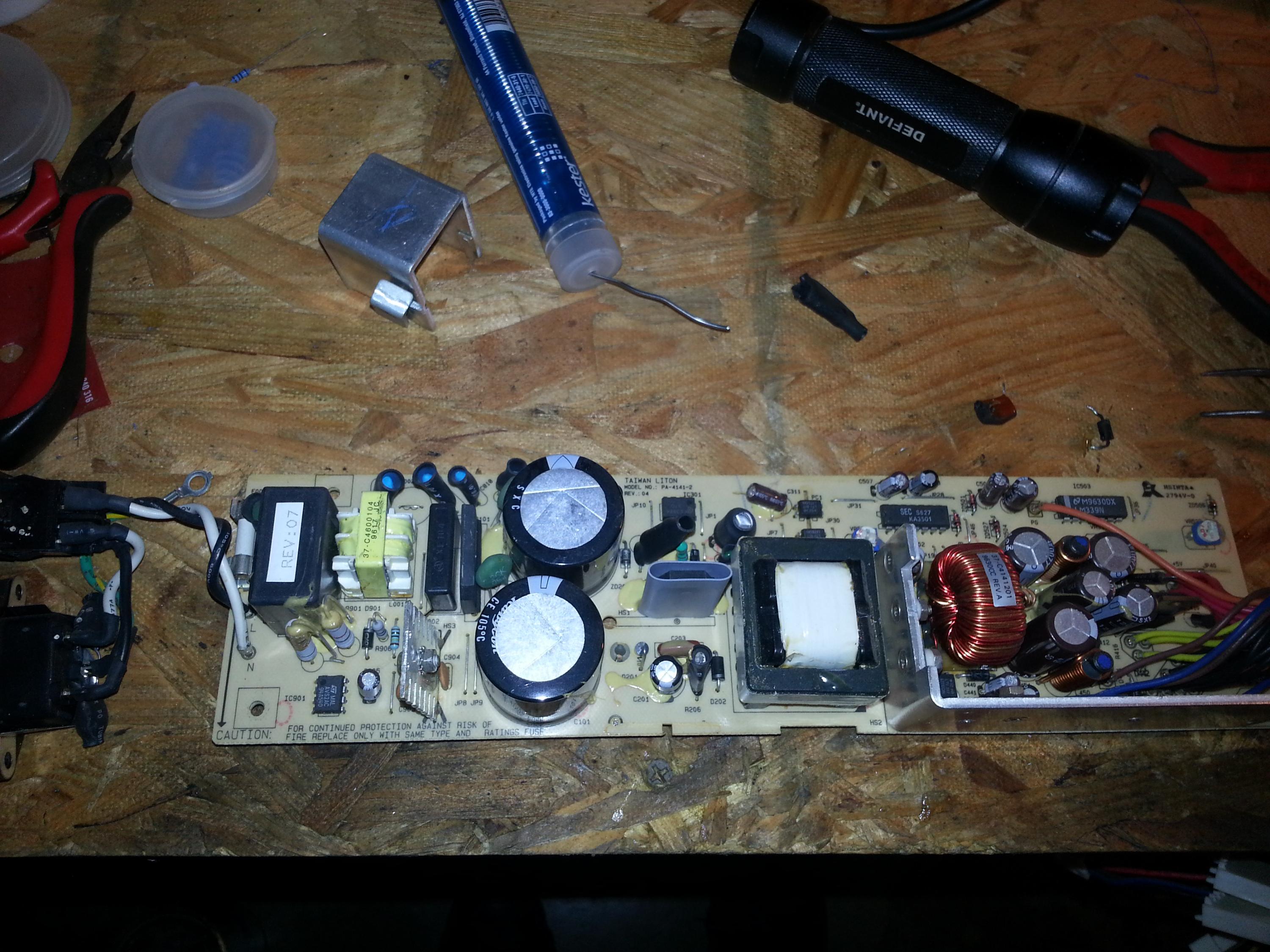

    Bird's eye view of power supply and my messy bench.

    Re: LiteOn lit on fire in HP Scanjet 5
    clean up the mess and replace the diode - maybe it was that fucking conductive glue that caused it!
    btw, when i saw the word "fire" in the title i thought "damn - now everybody will want one".
    i must be watching too many video's from Big Clive and Diode Gone Wild.
      That diode looks to be part of RCD snubber circuit, check to see if that cap next to it has leakage resistance or not.
        Looks to me like the resistor R206 burnt up, and you removed it, where is it in the circut?
          Could be, the other one didn't have glue near the diode though.
          Budm: I'll be sure to replace the cap too.
          R_J: It definitely wasn't the resistor, the resistor was covered in heat shrink tubing. Once I removed the heat shrink, the resistor was unscathed. I removed it to get a better access to the other components. Even the ceramic cap was relatively unscathed, but the diode was burned to a crisp.
          Budm thinks it's part of RCD snubber circuit, and I'll have to defer to his expertise. I'm really weak on reparing power supplies. If this wasn't a very specific form factor, I'd probably just buy a new one.
            It could have been a poor solder connection, I have seen them start arcing and burn up the pc board or maybe the diode just desided it was time to go.
            As the resistor was remove I could not see what condition it was in.
                  Ok, I sacrificed my other PS in the name of science. The diode is marked "1NU 6.G".
                  The capacitor is marked "MPE103K 630V C". From my searches, this appears to be a Metallized Polyester Film Capacitor with a 0.01uf capacitance and 630v rating.
                  Would a panasonic ECQ-E6103KF be a good substitute for this? Is there something better to use here?
                  https://www.mouser.com/productdetail...V8RxLUrW1ls%3D
                  I'm coming up empty on the "1NU 6.G" diode. Anyone have any ideas about how to substitute these?
                    replace resistor, cap (higher voltage rated than 630V since it is a snubber cap and the diode. Probably 1 = 1Amp, NU= something ultrafast and the 6 something like 60V?
                      I checked a schematic for a pa4131-2 and it has a similar circuit with a BYV26E in that position, 1 Amp, 1000 volt
                      Does it look like these 1NU41 diodes... https://ru.aliexpress.com/item/1NU41...517629040.html
                            Yes, the diode in the PS looks exactly like the aliexpress link (same font and everything) , but instead of the "6.G" there is an "0.K"
                            The BYV26E sounds like an upgrade. I think I'll go with that. Thanks for your help!!

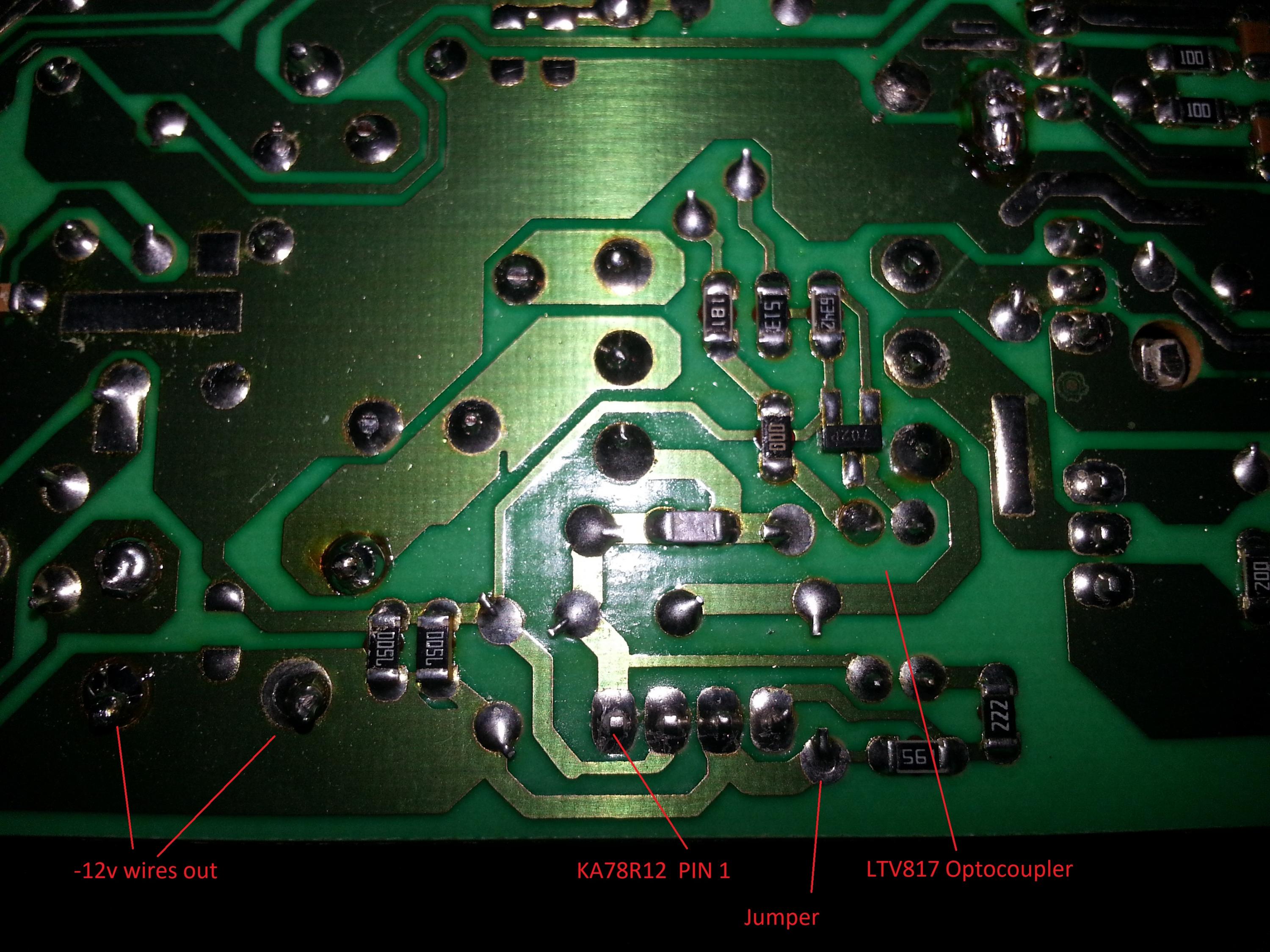

                                  I got snowed in today, or what passes for it in Texas. So I spent my day in front of the fireplace reading about switched mode power supplies and watching tutorials on youtube. I think I might have acquired an eastern european accent.
                                  Armed with my newfound knowledge, I went over the backside of the ps with a magnifying glass and found a few suspect joints, one was nearly dry. I fixed the bad joints. I also rigged up a dummy load with a 12v auto bulb.
                                  Now I'm getting good power on the 5v, 12v and 24v lines. I'm getting about -0.1v on the -12v line and nothing on the "power good" line.
                                  So, I think that this now narrows the problem down to the -12v output rectifier and filtering section. Is this true?
                                    If you have the other voltages, tracing the -12 volts should be easy
                                    It looks like there is a 4 pin regulator ic located on that heatsink, gussing by that cap polarity around it. get its number, check if you have input, if you have input and no output it may use a control pin to turn it on and off?
                                    If might also need a small load on the -12 volt line.
                                      If you can see what I think you see, that's pretty amazing!
                                      I'm looking out the -12v output regulator. It's getting 15v solid on pin 1 when the ps is on. Pin 3 (ground) is what is hooked up to the blue -12v wires. Pin 4 is control and voltage is low on this pin. Control pin on the regulator appears to be driven by an LTV817 optocoupler, which has 5v across the led pins (1 &2).
                                      So, is there anything else that could be driving the voltage down, or are we looking at a bad optocoupler here? I have some spare PC123 optocouplers on hand and they seem to be pin-compatible.
                                        Pin 4 needs a min. of 2 volts to turn on the regulator, if the opto has 5 volts across the led, the output pins 3&4 should be low connecting pin 1 to pin 4 via the 2.2k resistor.
                                        you could short pins 3&4 of the opto and see if the -12 is at the output of the reg.
