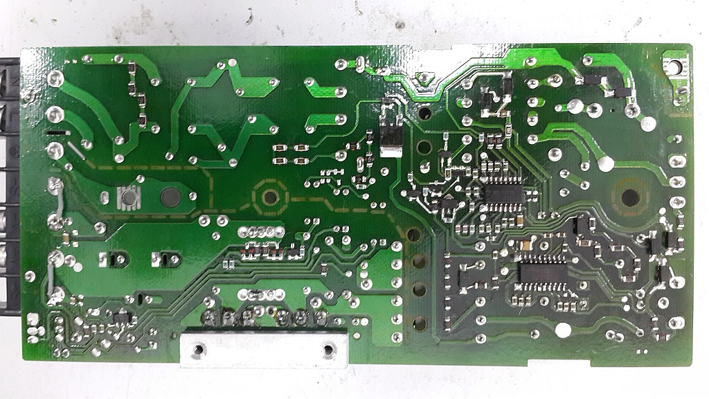

    Hi guys,
    Is there any easy way to test newer design SMPS IC that has all kind of over voltage, over current limit ? e.g. : M51995AFP.
    I have a power supply using this IC with no output. Fuse is good, secondary diode are good, switchers are good. Supply will trip ELCB if powered on with full AC input (>100VAC), ramping input up shows that the PSU suddenly draw high current at about 80VAC (about 2-3A) from mains, and there is trkk trkkk sound for half a second or less and after that it does not pull current anymore. Increasing VAC beyond 100V is fine this way and will not trip ELCB as there is no large current pull after this. Main Electrolytic charge up to about 385V (there is PFC IC in this supply)
    All I can think now is the main M51995AFP IC not working correctly. There is no pulse output driving the switcher from this IC. I don't have a new parts for this, and replacing this IC from a salvaged board does not solve the problem (it could also be that the salvaged board has problem with the IC).
    Will update with pictures and model number once I get back to lab...

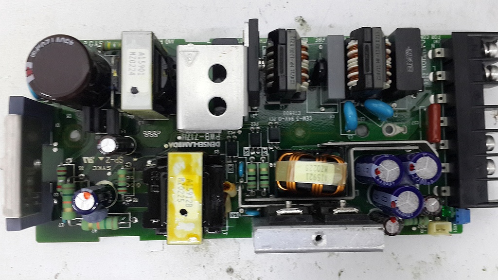

      Attached front and back picture of the PSU. It's a Densei-Lamda JWS100-3/RA. 3.3V 20A power supply. The grey wire is just connecting the V+ to Sense+ and V- to Sense-.
      Main switcher IC : M51995AFP (Mitsubishi/Renesas)
      PFC IC : 5331M (Fuji Electric)
      BTW confirmed that the switcher IC is dead, no pulse output. Testing method : Connect VC (Output collector) to Vcc and VCC to + Supply , GND to gnd. Based on test of the working unit, if you monitor the Vout, it should start pulsing once the VCC hits slightly more than 16V, and it should still pulsing when VCC is reduced down below 10V (as stated in the datasheet). Same testing method can be used for the PFC IC, all testing done with chip mounted in the PCB so I assume the OVP/OCP/and all other shutdown signal is properly pulled to ground or VCC.
      Still can't figure out why the elcb trips... the current surge I notice when it hits 80VAC using variac is due to the PFIC turns on and pumping the main cap to 385V.

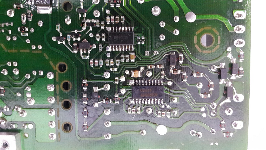

                  Re: Help to diagnose SMPS issue
                  Hello ultrasmurf,
                  Please see your modified picture below:
                  The component to the right inside the box looks like its been damaged. Or is it flux or some other type of contamination on it?
                  The component to the left/bottom also seems to look a bit unhealthy as well.
                  Please check another modified picture below:
                  Can you please tell me what component/s are sitting underneath the heat-sink shown by the red box?
                  Also, you need to check the fusible (safety) resistors as pointed out by the green arrows. You may have to lift one leg to get a more accurate reading.
                  I have to admit I'm a tad skeptical that the M51995 IC is at fault.
                  Did you check to see if there was any voltage on Pin 16 at all?
                  Make sure you measure between Pin 16 and Pin 13.
                  If there is no voltage and the main filter cap has 350+ volts on it, then the problem lies elsewhere.

                    Have a little bit more time to do more troubleshooting
                    Component circled red is good... its a diode, just got coated with heavy browning flux..
                    Fusable resistor are all good..
                    Under the heatsink is NTC. 2x 5Ohm for a total 10Ohm NTC. Seems a bit low for my liking to limit inrush current...
                    So.. testing the M51995AFP again off board shows they are good with pulse out from the Vout pin. Placed on board and it goes quiet. I have a similar lambda power supply (24V instead of 3.3V output) laying around on the table and upon closer inspection there is a jumper that seems to be missing (although there are a bunch of other things that are different, but this jumper was connected to the on off pin and will short it to ground).
                    Thanks to sam reminder, eventhough all 3 optocoupler tested good, it makes me wonder why need to have 3 optocoupler. The application note only have the third opto for the on off switch (one for feedback and one other for OVP protection). After hunting around a little bit, and re reading the datasheet I realize one stupid mistake. On/Off pin supposed to be low to turn on the IC(typically should be below 2.4V, or at worst condition below 1.9V). And mine measured 3.7V. Somehow my brain is wired with high voltage to turn on and low voltage to turn off. After a little bit more investigation, more stupidity resurface... This is a remote controlled PSU, there is supposed to be a 5V input at remote pin to turn on PSU (that third optocoupler is really an on off switch... just like the application note says.. ).
                    So the missing jumper is the one that determine whether this PSU is a remote controlled turn on or immediate turn on type. The connector for remote turn on is the white connector at the bottom right corner (top side board where you have your main cap) picture. Putting a jumper in (shorting the on off pin of 51995 to ground) will now make 51995 produce pulse output on board.
                    So what I have all along is a working PSU.. no issue at all.
                    As for tripping ELCB, my take is that based on the NTC rating will draw 24A of inrush current from my 240V outlet that only have a 10A ELCB...
                    Moral of the story : RTFM... properly.. could have avoided troubleshooting a fully working SMPS if I had known that there is a switch to turn this thing on and off...

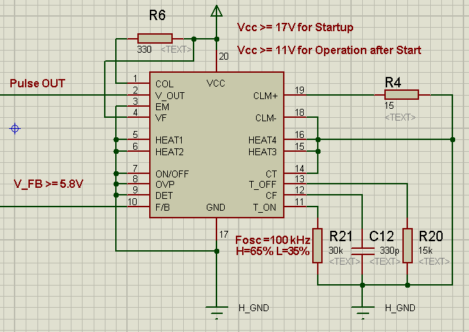

                      Here is Test circuit for this IC
                      When i wrote to Renesas to give me test circuit - they
                      answer : we can send to you datasheet....
                      Datasheet is very bad explained everiting is too
                      difficult to be done simple tasks as calculating of frequency
                      NO OTHER IC WITH MORE STUPID DATASHEET
                      User not worry how IC works...
                      He wants to use IC with several simple steps
                      to be explained adjustment of modes and frequency...
                      In my case SMPS wont to start stable because optocoupler
                      in F/B is bad. Transistor leaks current from FB pin to GND.
                      This is without signal on LED.
