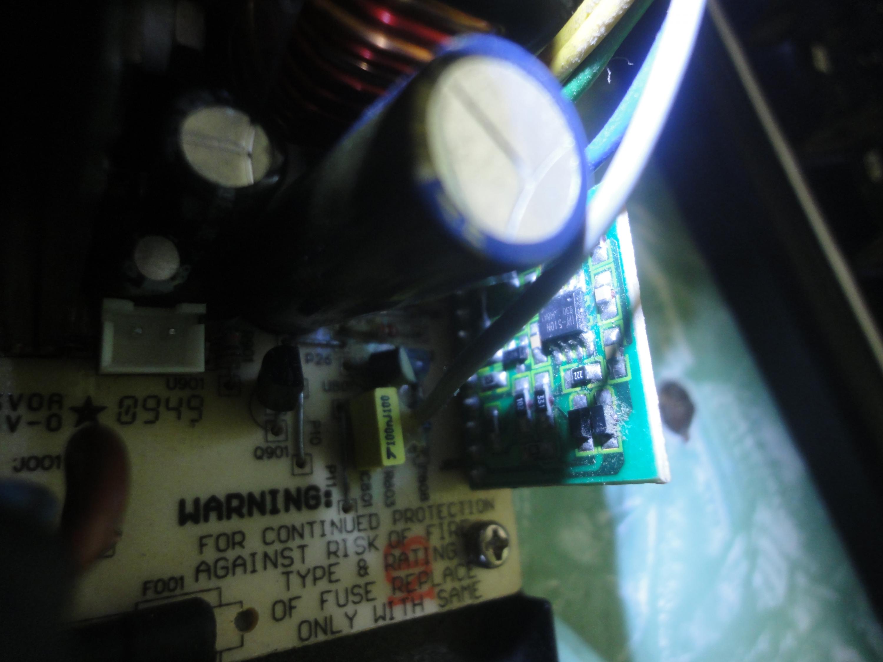

              Yes. I can confirm mine uses the HY-510N also.
              I can also confirm that the new NTC thermistor has also blown (don't know when that happened)
              I'm starting to think there is something pretty strange going on with this PSU. I also noticed that the PC it was in, had been doing a DMI /ESCD data update on almost every POST. With a different PSU in, it's not doing that any more.

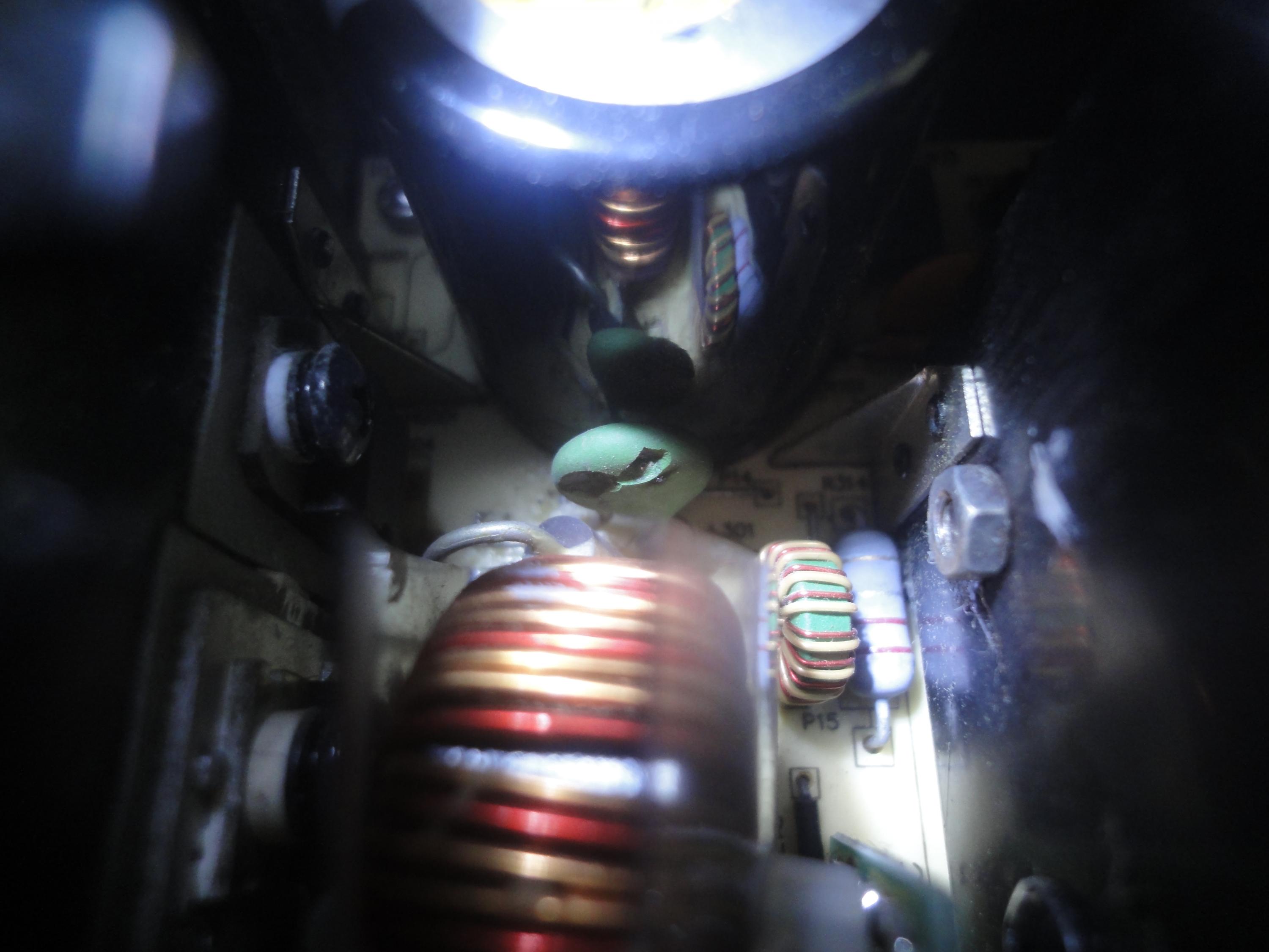

                  I had a look at this again yesterday, after being annoyed by it and leaving it in a corner.
                  The design is such that the primary filter capacitor is initially charged via a diode direct from the bridge rectifier, and the NTC. The APFC circuitry is effectively in parallel with that diode, between the bridge and the NTC, and so there is no way a fault in the APFC could blow the NTC.
                  The only logical conclusions then are that for the NTC to blow, there must be either 1) a serious fault in the SMPS primary side, or 2) shorted mains filter capacitor. Since neither of these seem remotely true, I suspect that the NTC failed from old age.
                  This would fit with how my replacement NTC also blew, considering it was a used pull from a dead and much older PSU board.
                  I have now fitted a brand new EPCOS B57235S509M as the NTC. Time will tell what happens...

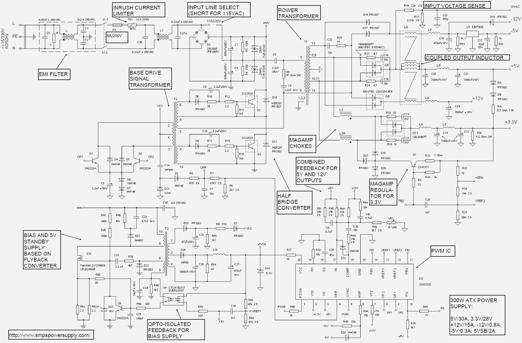

                    Is there a relay or triac across this thermistor? In some PSUs the thermistor gets shorted out after some brief time interval. This allows use of a higher value of thermistor, to achieve a lower value of inrush, but whose hot resistance is so high that it would fry were it not shorted by the relay or triac. If there is such a relay or triac that failed, that might account for the frying of the thermistor.
                    PeteS in CA
                      #30
                      Re: Replacing unknown NTC Thermistor in Corsair CX400
                      If the APFC MOSFET shorted out it will blow the main fuse, or the NTC, and may take out the bridge rectifier with it also.
                      • R_J
                        • Jun 2012
                        • 9633
                        #31
                        I found this atx schematic and it uses a SCK-2R58 ntc, this is a 300watt supply
                          I doubt you would find a circuit that "exotic" in a budget 400 Watt unit.
