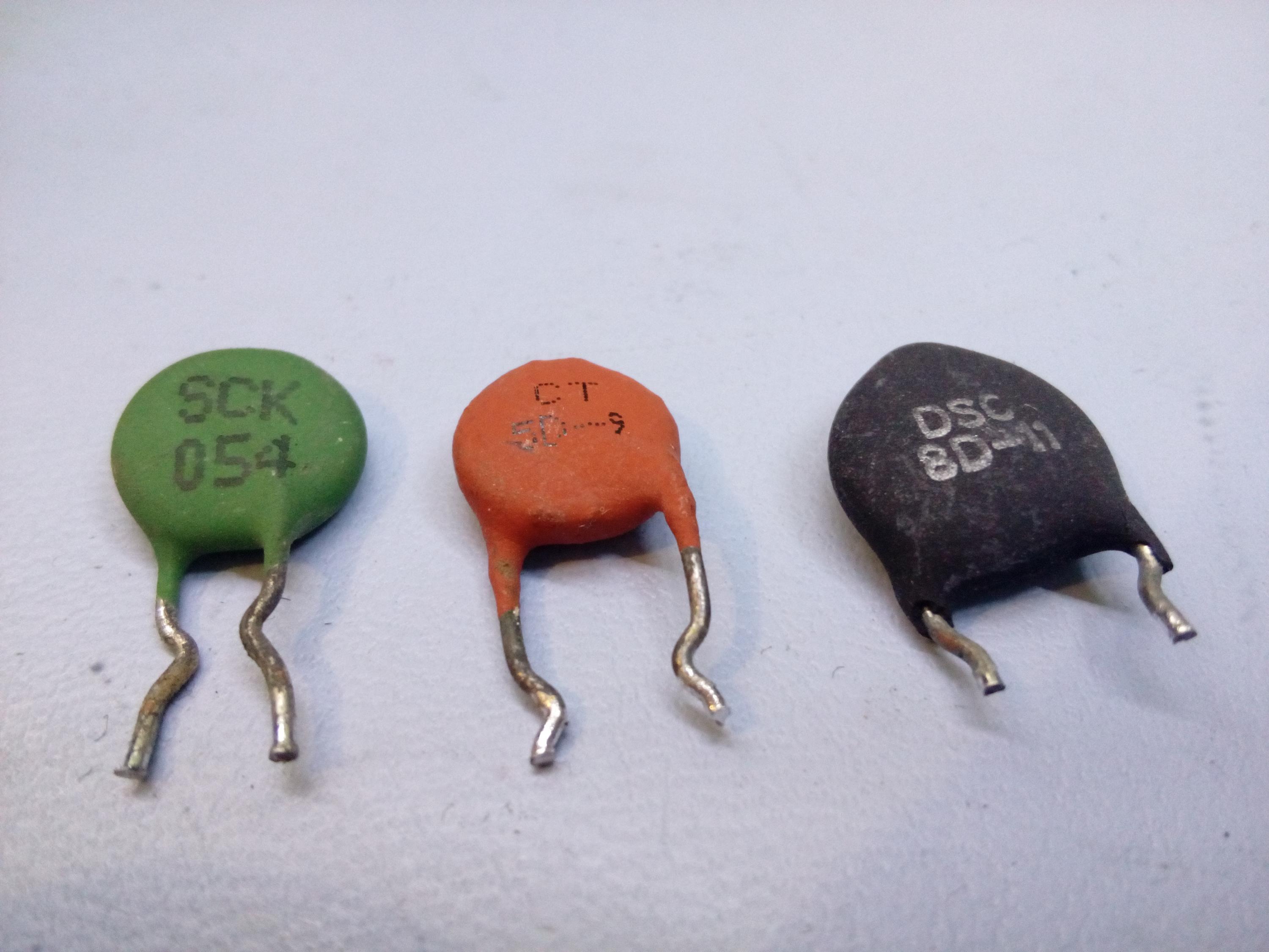

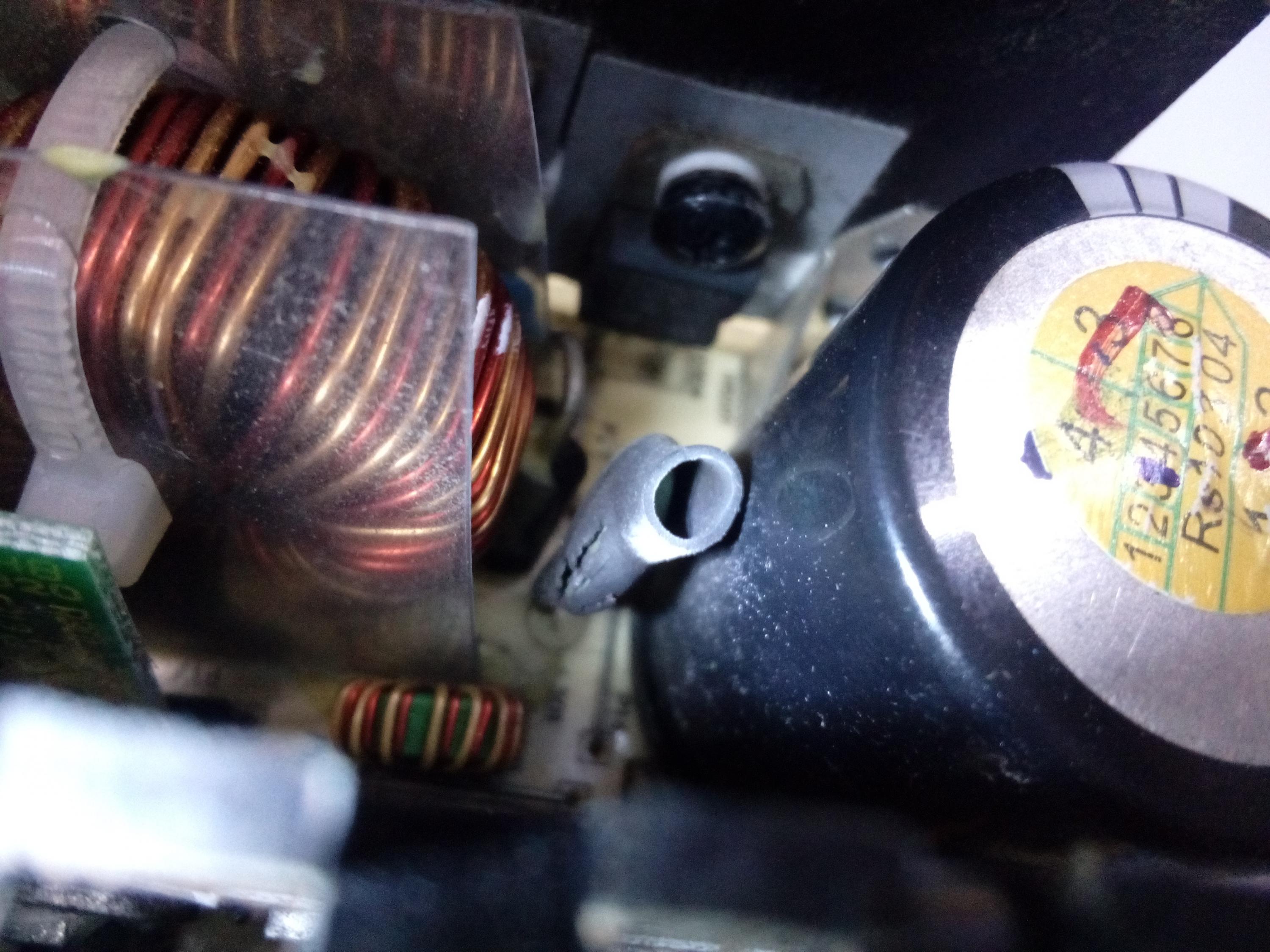

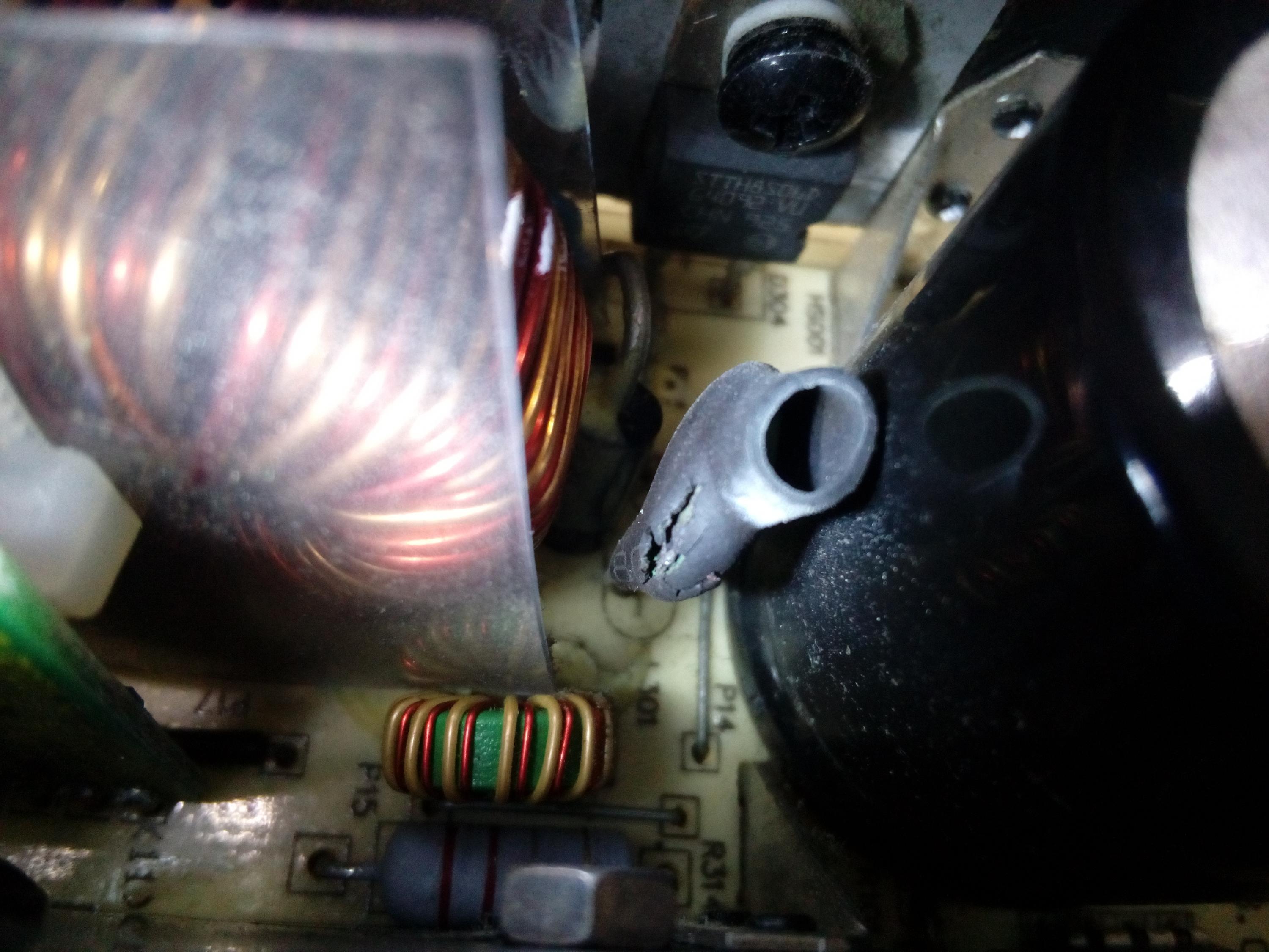

    A few days ago, something in my lounge started making a loud "phut" noise when plugged into the wall, and sometimes a smell like a hot glue gun was present in the room momentarily.

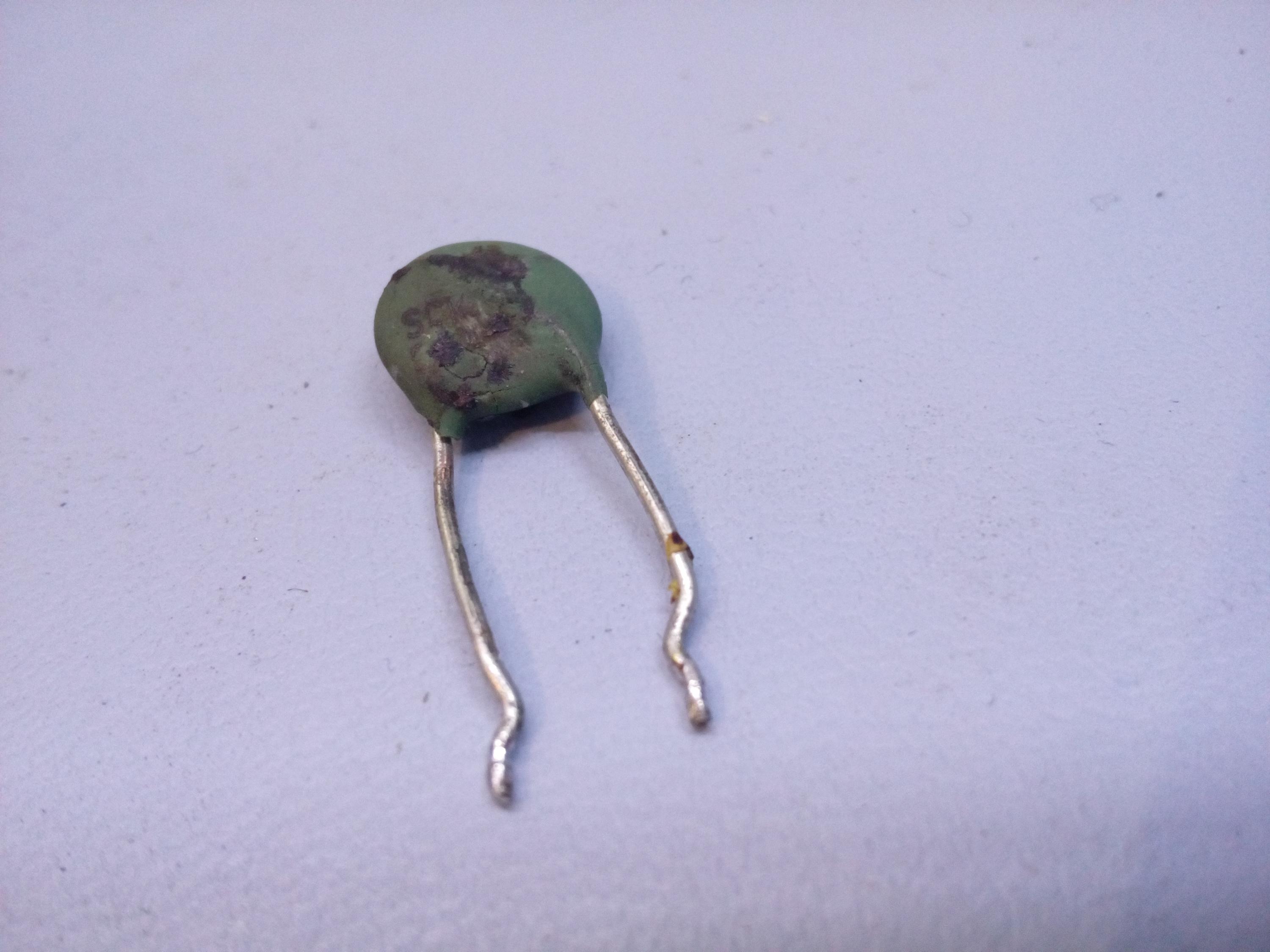

    I tracked it down to the NTC thermistor in my Corsair CX400. It has cracked and burnt. It measures 50kOhm+ cold... strangely, the PSU still seemed to work fine the whole time (?), so shorted MOSFETs or such seem unlikely!
    The problem is that the damage to the thermistor has resulted in the part number becoming unreadable, save the "SCK" on top.
    Does anyone know the value of the thermistor used in the CX400, or can advise on how to pick a suitable replacement? I did find a thread on the Corsair forums: http://forum.corsair.com/v3/showthread.php?t=112161 but nobody answered.
    How similar does a replacement have to be? I do have some pulled thermistors from scrapped PSUs. An SCK 054, a CT 5D-11, and a DSC 8D-11.

    What is the diameter of that NTC? 10mm?
    SCK 054 looks to be about right.
    You can put that 054 in and run at full load and check the temperature and Vdrops on that 054 to see what you get.

      Yes it's a 10mm NTC.
      Interestingly, a similarly rated Enermax Liberty 400W uses an SCK 053.
      I've put the spare SCK 054 in, and it seems to be working OK so far.
      Hard to check full load though as I don't have a load tester to be sure of the load.

            Note OP's power supply had heat shrink around it, this I believe is done to keep the NTC hot despite airflow from the PSU fan. If the NTC is a bit cool, larger voltage drop during run.
                Wouldn't the higher Vdrop just cause more heating and balance out the cooling from the fan anyway?
                My guess was that the heatshrink was a safety idea in case of failure, as happened here. Like how they use glass fuses with heatshrink around them, instead of getting ceramic ones.

                  I think you're right, the heatshrink sleeve is probably about safety; heating the NTC more would lower losses but who cares about a watt or two lost here.
                  The cheese-cloth (fire) test means spitting sparks out the vents is not OK, so I notice you don't always see a heatshrink cover on inrush limiter, MOV in Channel Well Technology (CWT) PSU's. Mostly silicone glue if it is a spacings issue.
                  Regulatory agencies don't permit heatshrink over MOV's/inrush limiters because of melting, flammability and dielectric rating - but not a worry here because of this metal enclosure. As long as the flames stay inside.

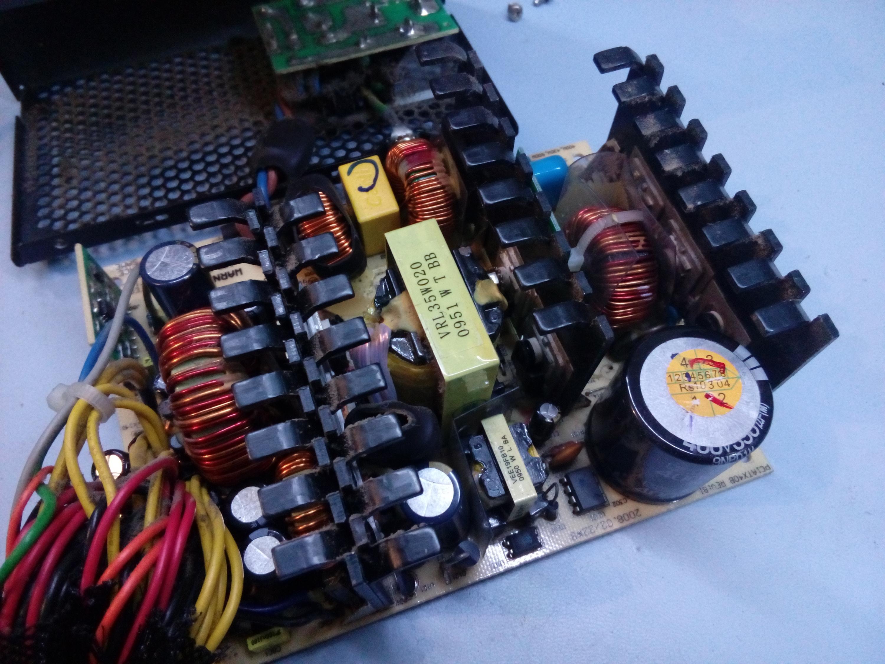

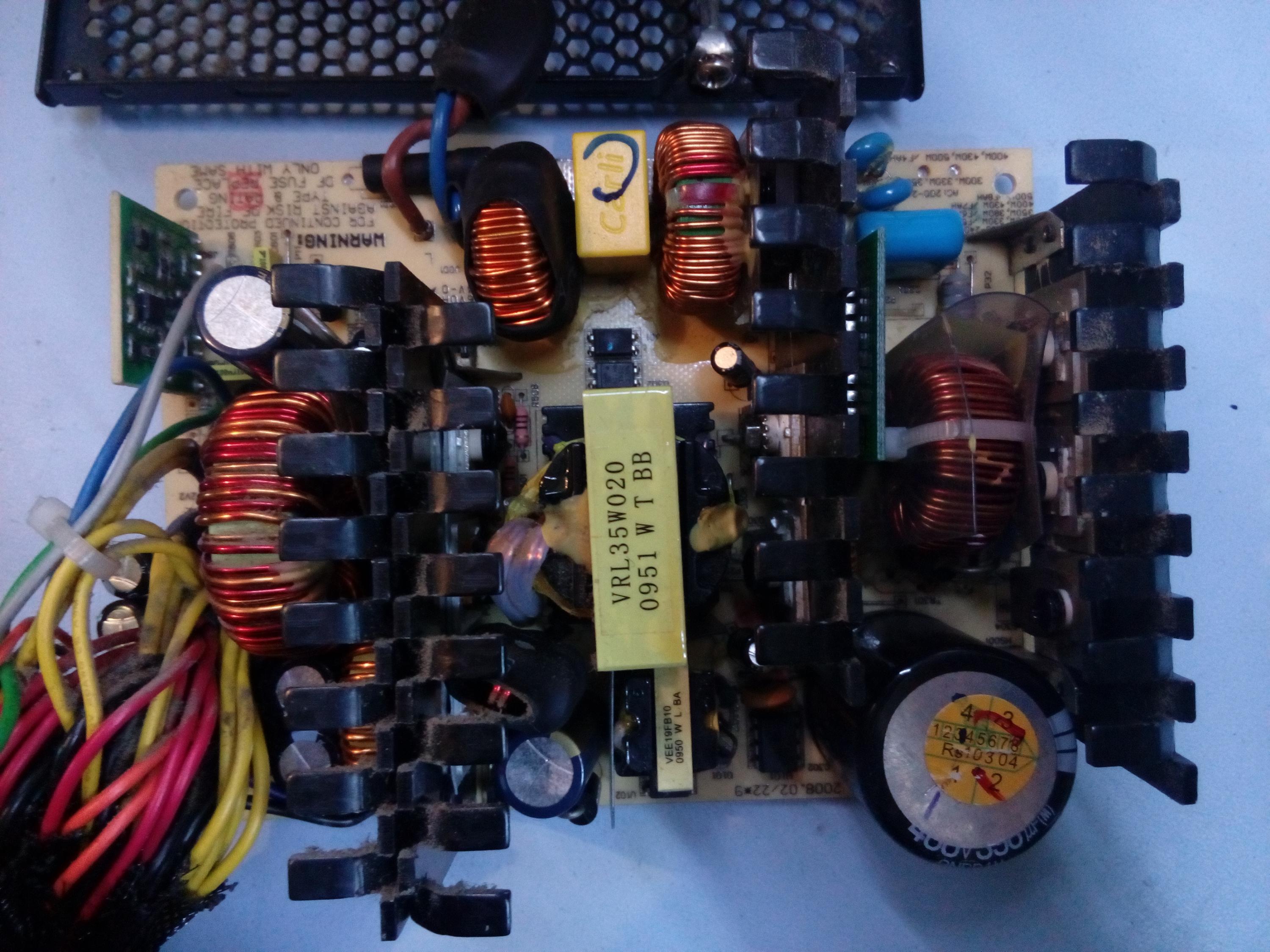

                            Well, looks like you found your solution more or less.
                            Nonetheless, I can't help but note that your CX400 looks very much like the Season S12II platform. In fact, the layout looks almost like an exact copy of my Antec Earthwatts EA-430 and EA-500 PSUs. So if you ever need any parts numbers off of those, let me know.
                                Because it is.
                                Corsair had to take some shit when they broght the CX430 based on some CWT plattform instead, because people think the CWT plattform is inferior to the Seasonic one...

                                PS: Please look for the protection chip.
                                Is it a HY-510N?? Seasonic seems to like this garbage protection IC...
                                Even in the 8pin world there are way better ones that support OCP on minor rails and/or UVP on +12V...
