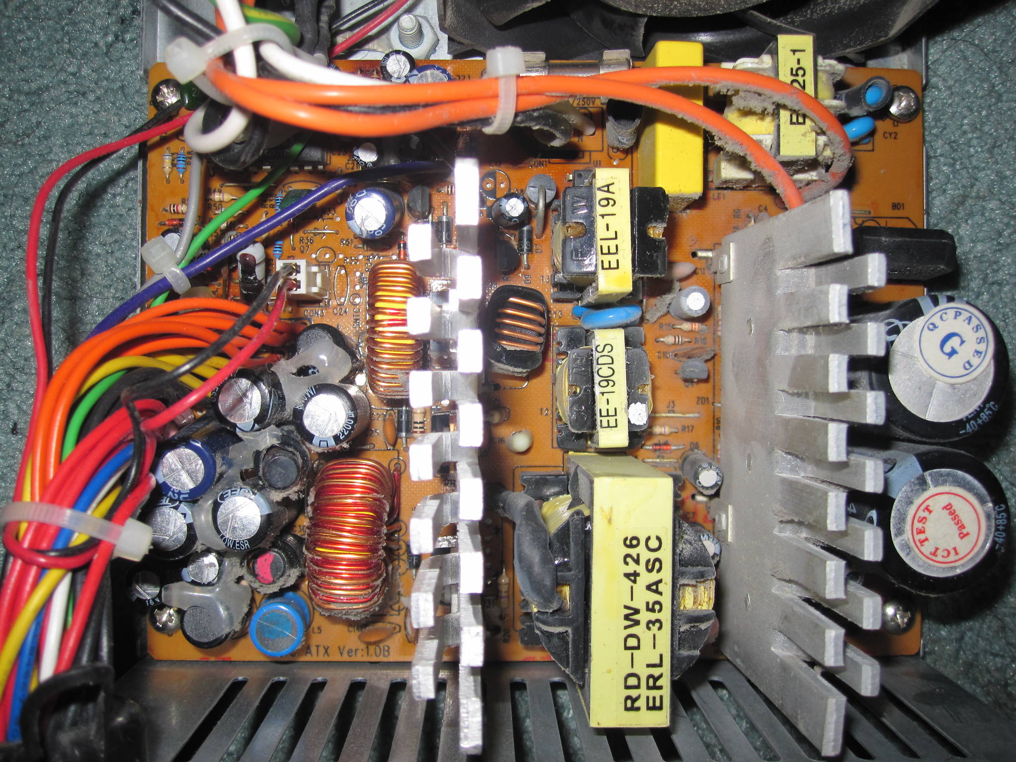

    I found one of my machines had died and it had an Allied 250W PSU in it...another Deer it looks.
    5VSB is dead. Figures.
    Anyway as I was searching around for that DR-0183 switch controller chip (DR=Deer? Did they get their own chips?) I found someone had a 400W supply with the same chip. Well, that's not that surprising, TL494/KA7500's are used everywhere.
    As I looked closer at the guy's pictures...his 400W PSU looked very uncanny...it was an exact copy of my 250W-rated supply! Same 470uFx2 input caps, placement is identical... Well, almost. Mine has input filters, his has a (possibly fake) PPFC choke. And then looking at it even closer, it seems his just has a bigger TO-247 diode packs instead of the TO-220's in mine.
    And his was working apparently, but wanted to mod it for a higher output voltage. I suspect his PSU would probably soon end up like mine soon anyway... dead.
    Alas most likely another worthless repair coming right up! Once I figure out why the 2-transistor oscillator is dead...
    TBC...

      Yep, the heatsinks are the exact same, a flat piece of aluminum with a comb cut and fanned out of the top. The absolute cheapest heatsink - not even an extruded heatsink with holes. All in all, I agree, this should do 200-250W just fine, but have my doubts of that 400W. However I'm grateful the placement/schematic are the same.
      A cursory check with the ESR meter indeed indicates a boatload of bad caps, not only of the 5VSB but also including the primary outputs. Now the question is whether it's worth to repair or diagnose further, I'm hoping the DR0183 isn't fried as collateral damage as I have no spares. Studying the schematic a bit, this circuit is funny, it looks like it was designed so that the same board could take both BJT and MOSFET primary switching transistors which makes it more difficult for me to bypass the 5VSB to see if the rest of the circuit works.

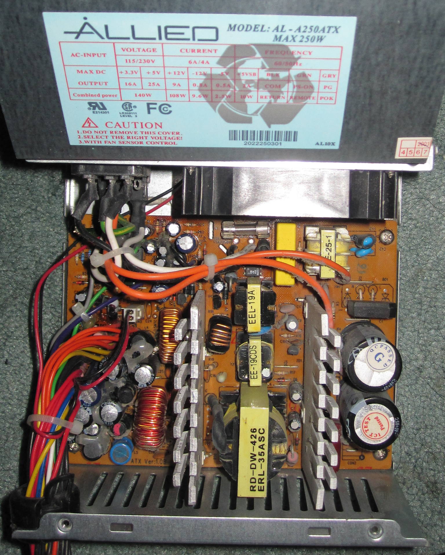

        BTW: the doppelganger is at http://www.webx.dk/oz2cpu/radios/psu-pc400.htm
        Attached is my PSU.
        Looks like the 5VSB caps are in the upper/center just to the left of the fuse, and the small cap between EEL-19A transformer and the low voltage heatsink is dry. It's not alone, lots of high ESR caps in there...

          Re: Story of another dead deer and a doppleganger.
          With those heatsinks I'd be nervous about greater than 200W continuous. Some of those output caps look preggers.

            Yeah, a bunch of caps are bulging. Need to be replaced as well.
            I wonder how many watts I can (safely) pump through this if I *just* replaced the heatsinks with some larger ones that I saved from other dead PSUs, and swapped the output rectifier diodes with larger ones...

                                I guess it's gone long enough, and dang you momaka, you took my JEE joke for the solution to this puzzle
                                OK. At first due to those 1K'ers frying, I did think either the 5VSB output caps (1000uF C18/C19) and the critical 22uF C9 caps were bad. They were indeed bad but I had a bad feeling that it wouldn't fix the problem. Since their ESRs were awful, I swapped them anyway.
                                I powered up...
                                Still dead. Bummer.
                                So I went through finding other parts that were bad, testing a few out. After pulling a lead of R3, a FREAKING 1Mohm resistor, I found that this resistor was OPEN.
                                This would totally explain why 5VSB was dead. So I replaced it, and 5VSB came right up. So the solution to the puzzle was the replacement of R3 (or R5, since the two are in series) was open.
                                So I went ahead and shorted GREEN to GND with a load... a pulse of life...and dead again. Waited a few seconds and tried again, same. => Yes this thing is shutting down due to OVP or UVP or something.
                                For the heck of it I scoped the outputs and sure enough, the 3V3 line was going way overboard.
                                Now the joke that was taken away from me: JEE, I wonder why. 1 ohm of ESR.
                                And that was the end of the story.

                                    Yeah I was dumbfounded when I found that dead resistor, how could it be? 1M has no way of dissipating much power with the voltages we're dealing with here, even with 340VDC. Plus no burn marks. I have to chalk it down to perhaps bad resistor manufacturing.
                                    So the bad units were JEE IM 2200uF/10V, Jun Fu HK 1000uF/10V, CapXon KM 10uF/50V (ESR was bad compared other 10uF caps I had but I think this one was in a "don't care too much about ESR position", and Fuhjyyu TM 22uF/50V.
