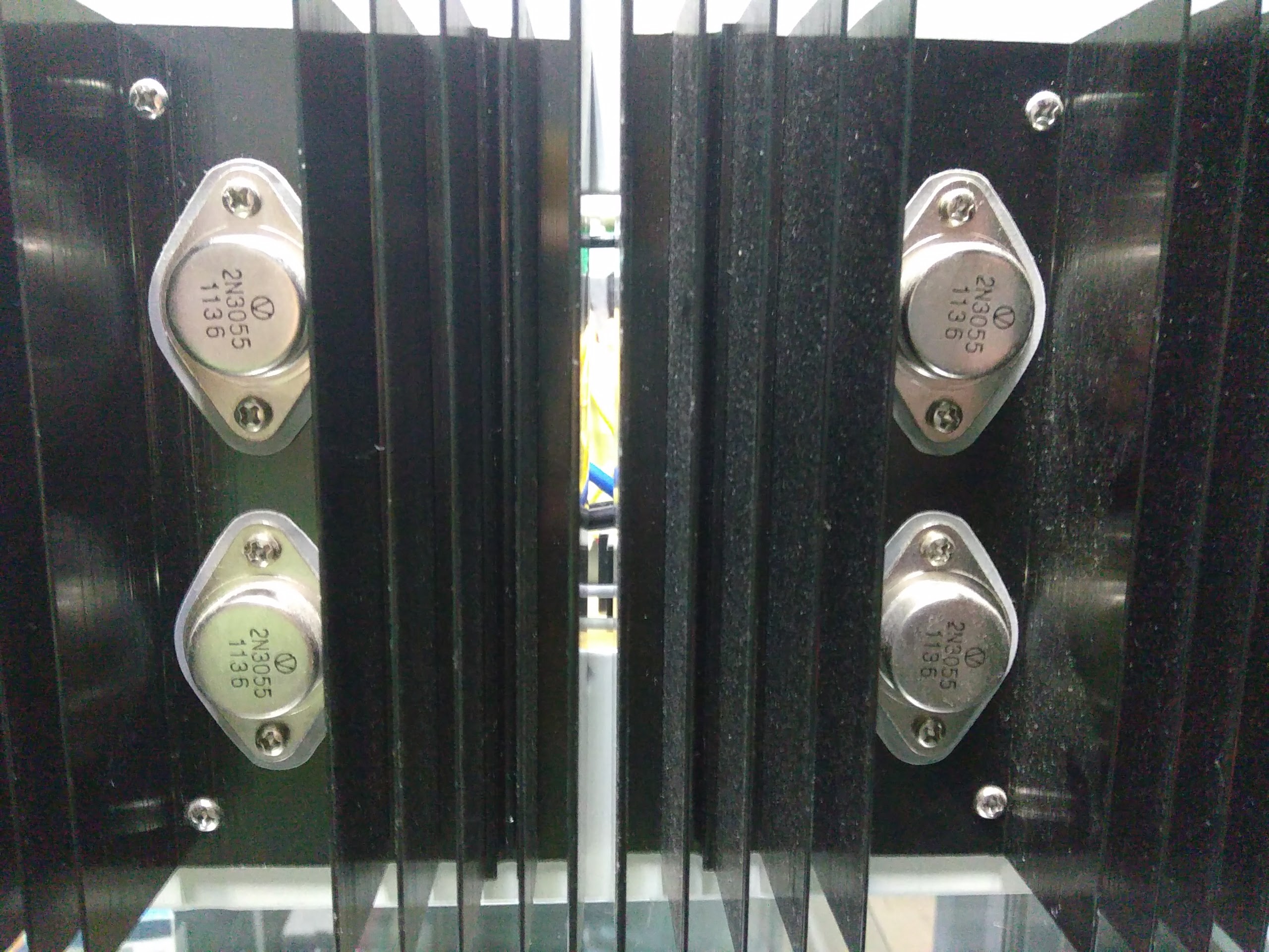

        They seem to be 2N3055
        Here's the photos: http://imgur.com/a/r0P2z
        Forgive me, how do I test the transistors? Solder them out and test for resistance?
          • 31015
          Re: Bench PS Problem (Volteq HY3010D)
          yes, but you probably dont need to desolder them unless they meter bad to begin with.
          i'm impressed that it has 4, they can manage 7A or more each!

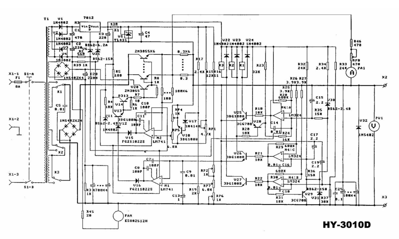

                  This is a different model (Hy3020)but might help, I found this one also (HY3010D)
                    • 31015
                    http://www.volteq.com/volteq-regulat...new-model.html
                    looks like a rebadge of:
                    http://www.mastechpowersupplies.com/...h-hy3010d.html

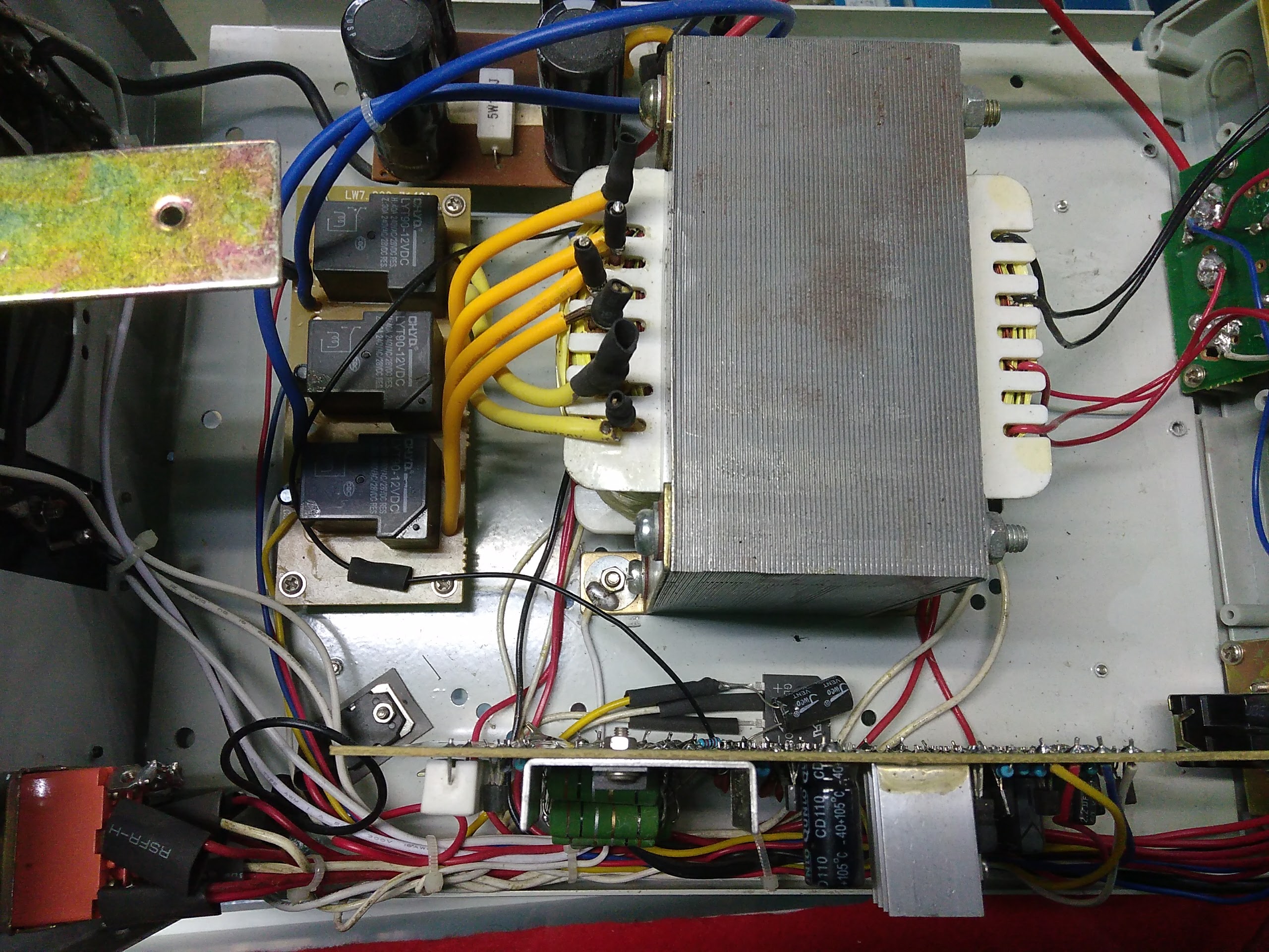

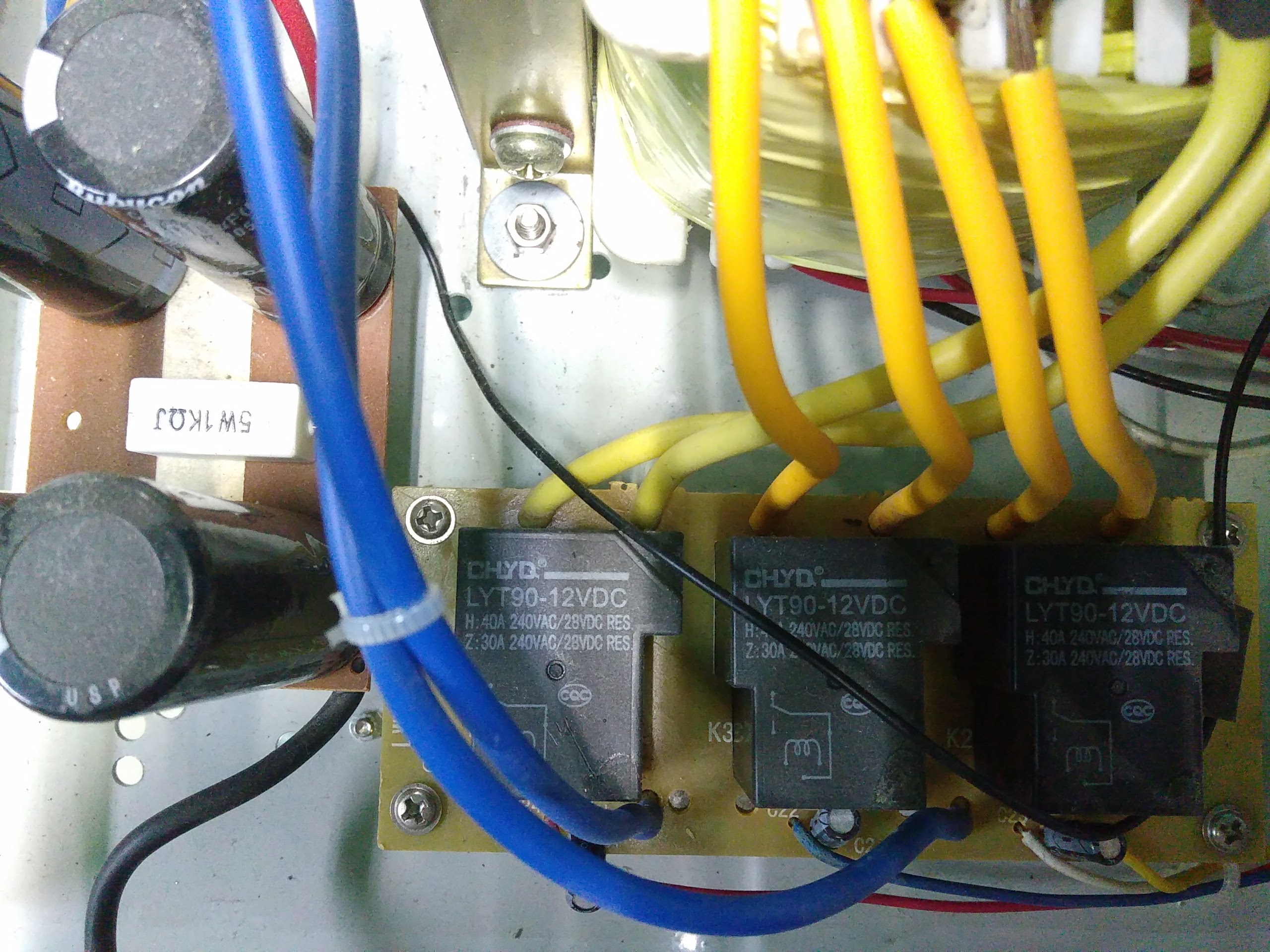

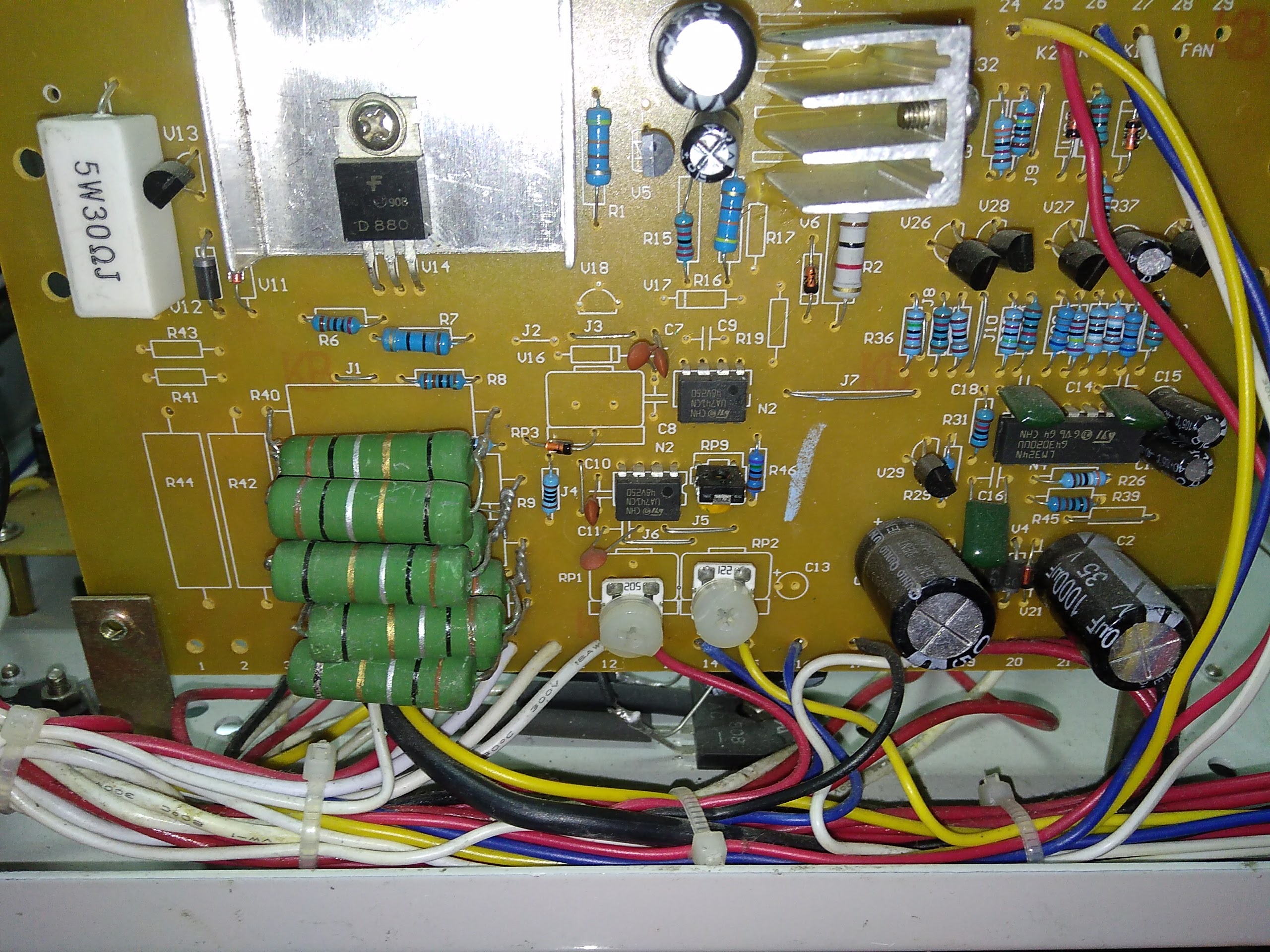

                        I tested the 4 2N3055 in circuit and they don't appear to be shorted. I'm gonna have to desolder them and do this test ( https://www.youtube.com/watch?v=xyKzUCrwTpA ) to make sure.
                        I attached better and more focused pictures (log in to see) so you get an idea of what's inside.
                          • 31015
                          shit, that's some scary foto's!
                          the cap almost? touching the heatsdink, the rectifier just bolted to the case without sleeving on the outputs, the soldering!

                            I just replaced the 4 power transistors (2N3055) and still got the same problem.

                              So you verify that the Output transistor driver V13, V14 are good?
                              • redwire
                                • Dec 2010
                                • 3907
                                It's the usual circuit, where the pass-transistor (array) is normally on (R4, V11) and the control op-amps turn it off through an OR-gate (V15,V16).
                                Like budm mentions, check the driver transistors. I would check the +12V, -6.2V rails.
                                Circuit-common for the control op-amps and stuff is the power supply's +OUTPUT, once you get a handle on that, these chinese bench PSU's are easier to repair.
                                But like this one, a potpourri or kludge of parts.
                                    Ah... problem still exists we thought you fixed or gave up!
                                    Well M1 and M2 (LM741s) are the error amplifiers - M1 being the voltage error amplifier (M2 is the current limit feedback). What is the voltage at each of the pins of M1 when you have the voltage turned down all of the way?
                                    In case it's not clear, M1 is the LM741 that has the unpopulated C8 near it and J7 on the other side. M2 is the one that's between C10 and RP9.
                                    Oh gosh 45V??? I think that will kill the LM741, you may need to replace them regardless now. But still report the voltages an the pins. A proper working PSU probably should look like:
                                    (Note: voltages reference to GND, or output negative pin)
                                    Pin 8 - NC - ignore
                                    Pin 7 - V+ 12V over what your output voltage is
                                    Pin 6 - OUT your output voltage minus somewhere from ~3 to ~11 volts.
                                    pin 5 - Offset - ignore
                                    pin 4 - V- 12V under what your output voltage is
                                    pin 3 - IN+ this should be fairly low, no more than 1V or so
                                    pin 2 - IN- this should be whatever your output voltage is
                                    pin 1 - Offset - ignore
                                        Actually don't be hasty and replace them, we don't know what's wrong yet. If you report the voltages on those pins then we could help pinpoint the problem.
                                        I tried to make a guesstimate based on the schematic. I referenced "Ground" as the negative output of the main power supply, just to pick an arbitrary point.
                                        And yes, UA741CN, same op amp circuit as LM741.
