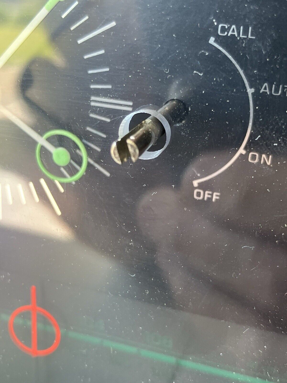

    Here is a picture of the bare slotted post (if I have the term right) the knob should be attached to:
    Click image for larger version  Name:	PANASONIC RC-6900 2.jpg Views:	0 Size:	279.3 KB ID:	3313156
    As you can see, this is an Old School selector switch, which means it's pretty stiff. Put another way: the knob has to fit very snugly on the post in order for it to work properly over the long term. Any play in the fit and I risk the knob coming loose again over time (or breaking off altogether).

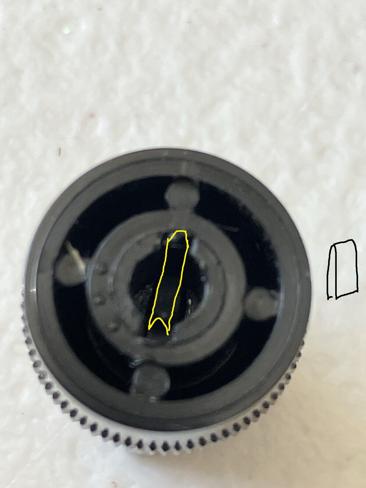

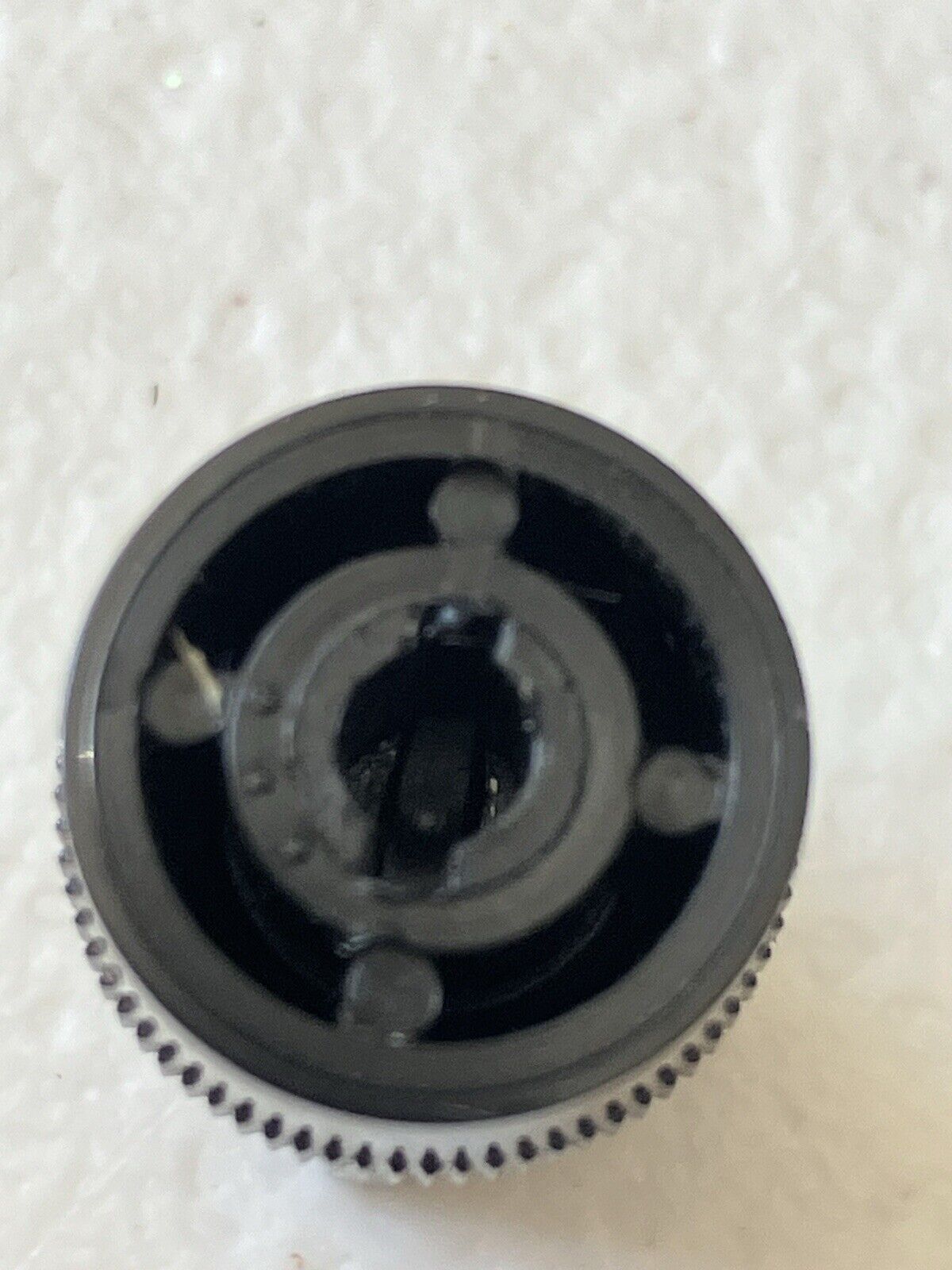

    As for the knob itself, here is a picture of the interior:
    Click image for larger version  Name:	PANASONIC RC-6900 3.jpg Views:	0 Size:	209.2 KB ID:	3313157
    The slot you see is 1mm thick, 5mm high, and 9mm in depth.
    My question is: does anyone know of a small piece of metal something-or-other approximately that size that I could work with a file so that it forms a tight friction fit?
    Apart from manually filing down a small piece of metal to get it to fit tightly in that slot, I have no idea how to effect this repair in such a way so as not to damage the knob. However, if you, the person reading this, do have an idea, I am all ears.

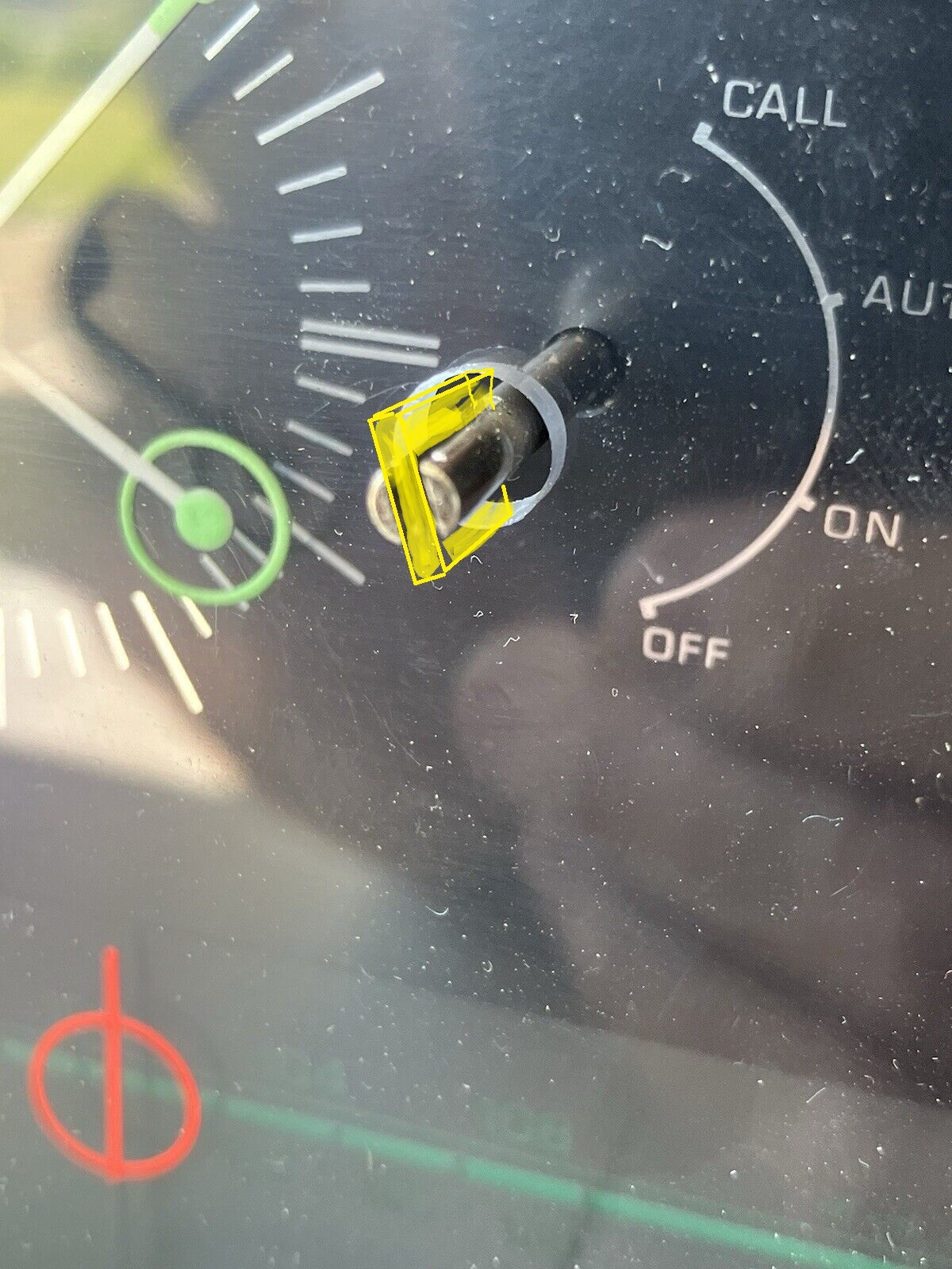

    Click image for larger version  Name:	PANASONIC RC-6900 clip.jpg Views:	0 Size:	317.9 KB ID:	3313183 There is a small spring steel clip that is missing it fits in the knob slot and goes between the split in the shaft, something like this. You could try using a piece of stiff plastic to make it as well
      And or use hot glue to keep it in place hopefully you do not need to remove it for some reason later down the road because of some kind of repair

        I usually see a knob like that with a small steel pin in that slot. It ends up in the shaft slot, splaying it enough so the knob grabs tight.
        If it fell out and vanished, check the knob for cracks. The pin is hollow, it's like a keyway or something. I would find the exact diameter rod and cut a short piece. Coathanger is a bit too big I think.
        Hobby store will have what you need.
