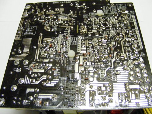

                      • i4004
                        • Oct 2006
                        • 2029
                        Re: Bad Antec experience, need a new PSU
                        >I HATE OSTs and Teapos which they use in their newer units.
                        why?
                        have you seen them bulging in the psus?
                        i would buy earthwatts in a heartbeat, as delta and seasonic are making them, and delta is ok..seasonic too.
                        also, looking at that delta pcb from under....it's a fuckin' piece of art..so neat.
                        for caps...i have teapos in fortron, and i think it's just fine that way.
                        no need to recap it...
                        • i4004
                          • Oct 2006
                          • 2029
                          delta pcb...yummi!
                                        Originally posted by i4004
                                        delta pcb...yummi!
                                        Minimal SMT components I like that.
                                        I just hope they don't use proprietary ICs on it like they did on the Xbox.
