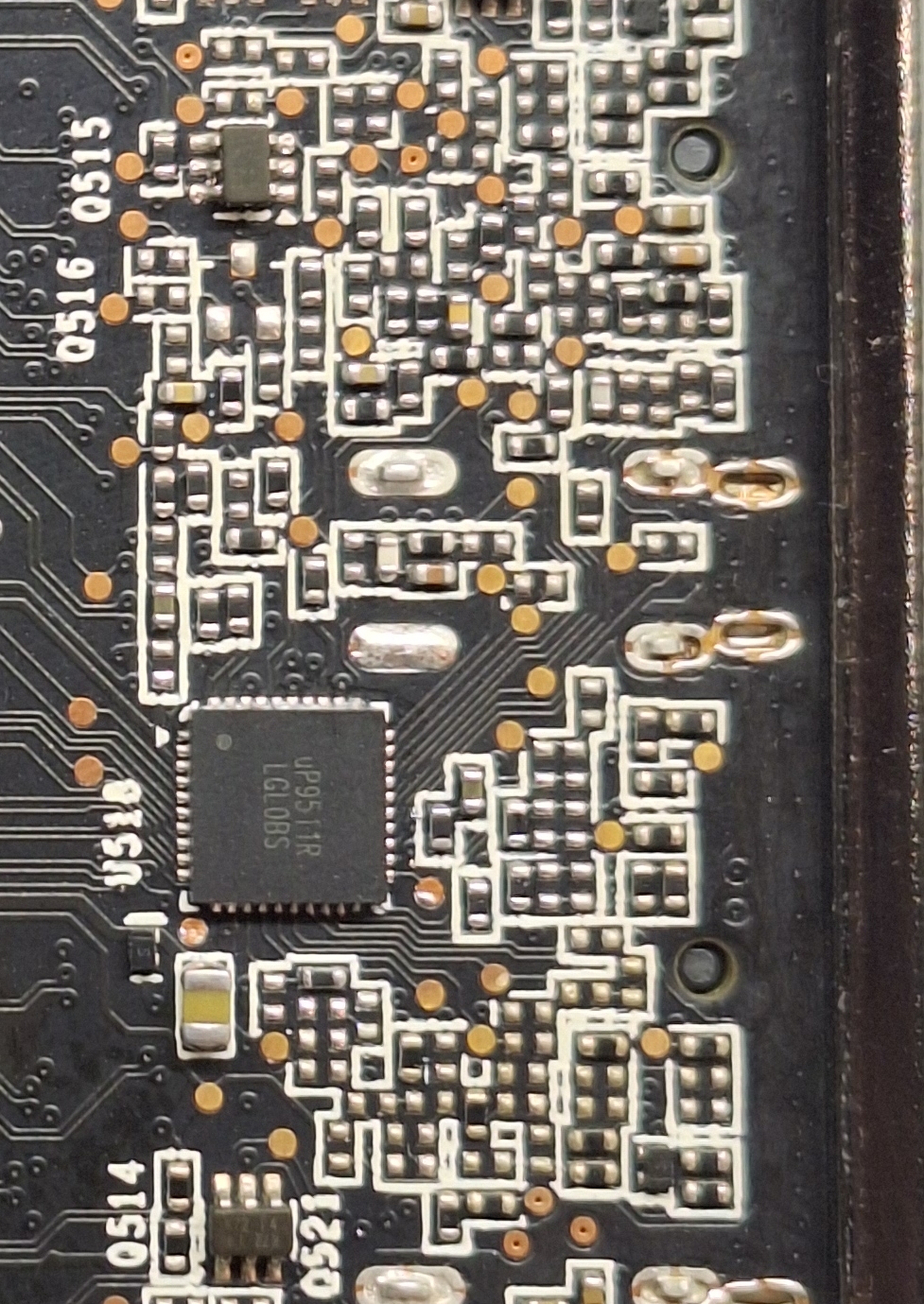

                Measured now the physical GPU VCORE voltage with DMM, and surprise, it is only 0.540V instead of ~0.85V showing at GPU-Z - seems there is something wrong with the voltage measuring network on the card.
                90Ninety - could you pls kindly post a high resolution picture of the area around the vrm chip on the backside, from your card, eg. like the below area:
                I have the suspition, that somebody messed around the vrm chip before, so I'd like to compare which elements are populated, which not.
                I have some BV of a similar MSI card, but there are much more elements populated, so can't compare with it, and a ZOTAC BV is not available.
                Below the link to the BV's.
                The one similar to my cards is V397_v40.
                https://www.badcaps.net/forum/troubl...=90093&page=55

                  Tried to change the VRM controller to:
                  1. uP9511P -> VCORE present but card not recognized by the BIOS
                  2. uP9511S -> VCORE not present, card not recognized in BIOS
                  3. A second uP9511R -> same bahaviour, so VRM chip seems to be OK.
                  I wounder if it shoudn't be a uP9512R, will order one.
                  Would try also another BIOS, but no BIOS'es for this card available at Techpowerup.
                  Link to my BIOS request:

                      • 90Ninety
                        • Aug 2011
                        • 102
                        • UK Mains Voltage 240V 50 Hz
                        Hi buddy
                        Thanks for your input on this thread, I hope it helps with your card also. Sorry for the delayed update, here is the image.
                        Click image for larger version  Name:	IMG_20250214_142854490.jpg Views:	0 Size:	3.25 MB ID:	3571649
                        Click image for larger version  Name:	IMG_20250214_142807609.jpg Views:	0 Size:	2.14 MB ID:	3571650

                            This card is driving me insane
                            After changing the PWM controller, there is no difference, still no VCORE.
                            I am beginning to lean on that there is a faulty/ blown component on the logic circuitry. I checked the card with an IR camera, there seems to be one SN74LV1T08 (of a pair) that is heating up to around 60 degrees. As shown on the right of the IR photo
                            The IR image is slightly off center but I am sure it is the component below
                            Here is a closer up
                            I removed this component, the resistance is much higher on the legs, though there seems to be low resistance (24 Ohm to ground) on the Data pads on the PCBA board where A & B (see 1 & 2 in image below) legs go . I presume this is why the component is heating up? Compared to the exact component next to it, the resistance a lot lower.
                            Click image for larger version  Name:	image.png Views:	0 Size:	3.6 KB ID:	3582714
                            I have no idea where these data tracks go to .. I would like to send this card to someone who can diagnose better. I am now out my depth

                                    So I am looking at a board view suggested above, believed to be for an MSI 3060. The board I have shares a very similar PCB but does not have all the components populated compared to the MSI
                                    Here is the progress so far, tracing out where this enable signal comes from.
                                    PICTURED BELOW
                                    From pin 36 of 9512R to a 10K resistor
                                    To a SC70_6 (Pin 3) PS_NVVDD_EN_R
                                    Click image for larger version  Name:	Enable Trace.png Views:	0 Size:	9.12 MB ID:	3592619
                                    Click image for larger version  Name:	image.png Views:	0 Size:	57.4 KB ID:	3592625
                                    To a 0Hm resistor
                                    To a SC70_(5 Pin 2) PS_NVVDD_AND_IN2
                                    Click image for larger version  Name:	image.png Views:	0 Size:	52.1 KB ID:	3592626
                                    So next is to check voltages on the above,.. what voltages I should be looking for on the components above, and how much further I need to trace back to find the voltage drop off. Is there a typical failure point for this kind of fault?
