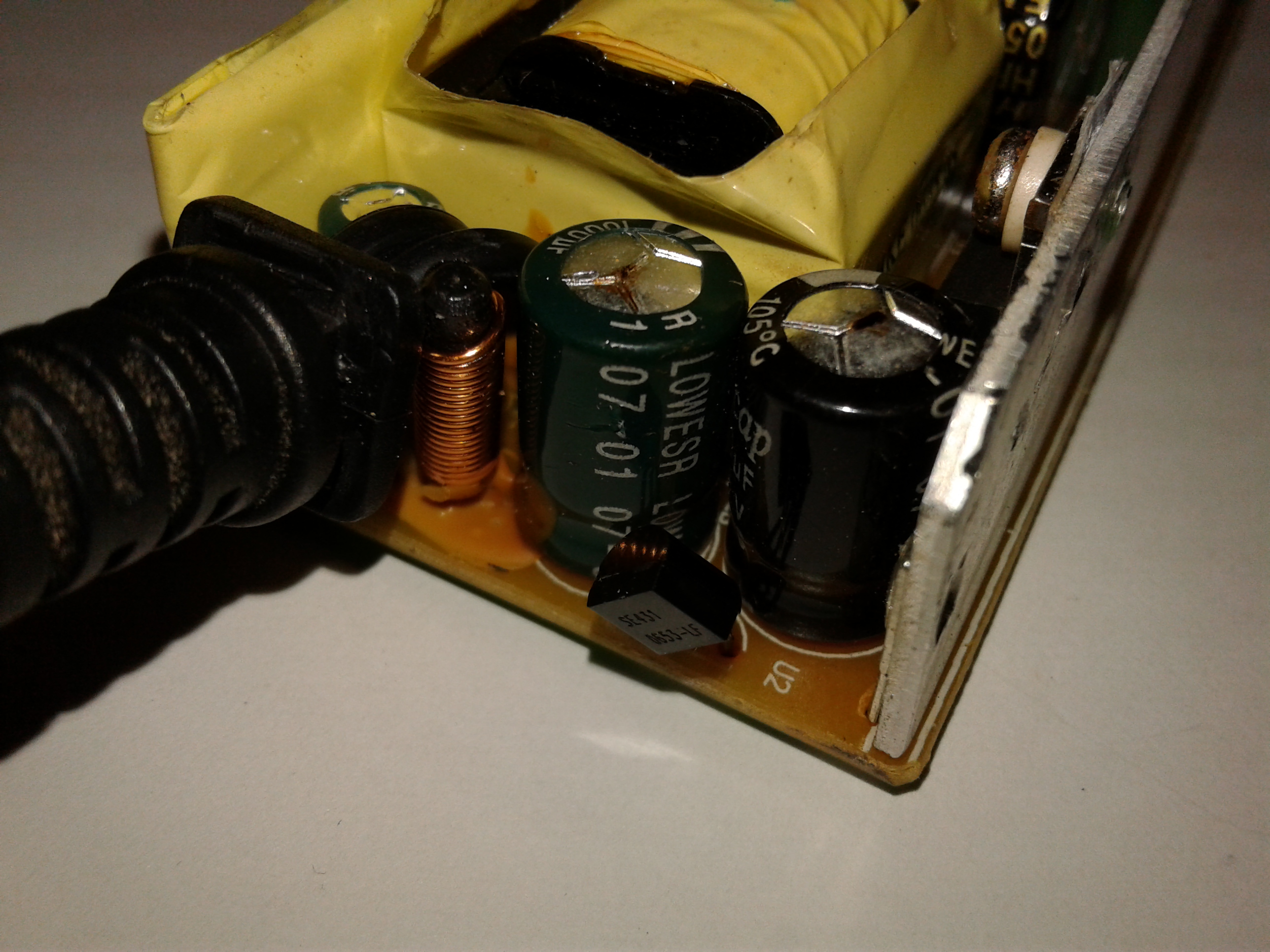

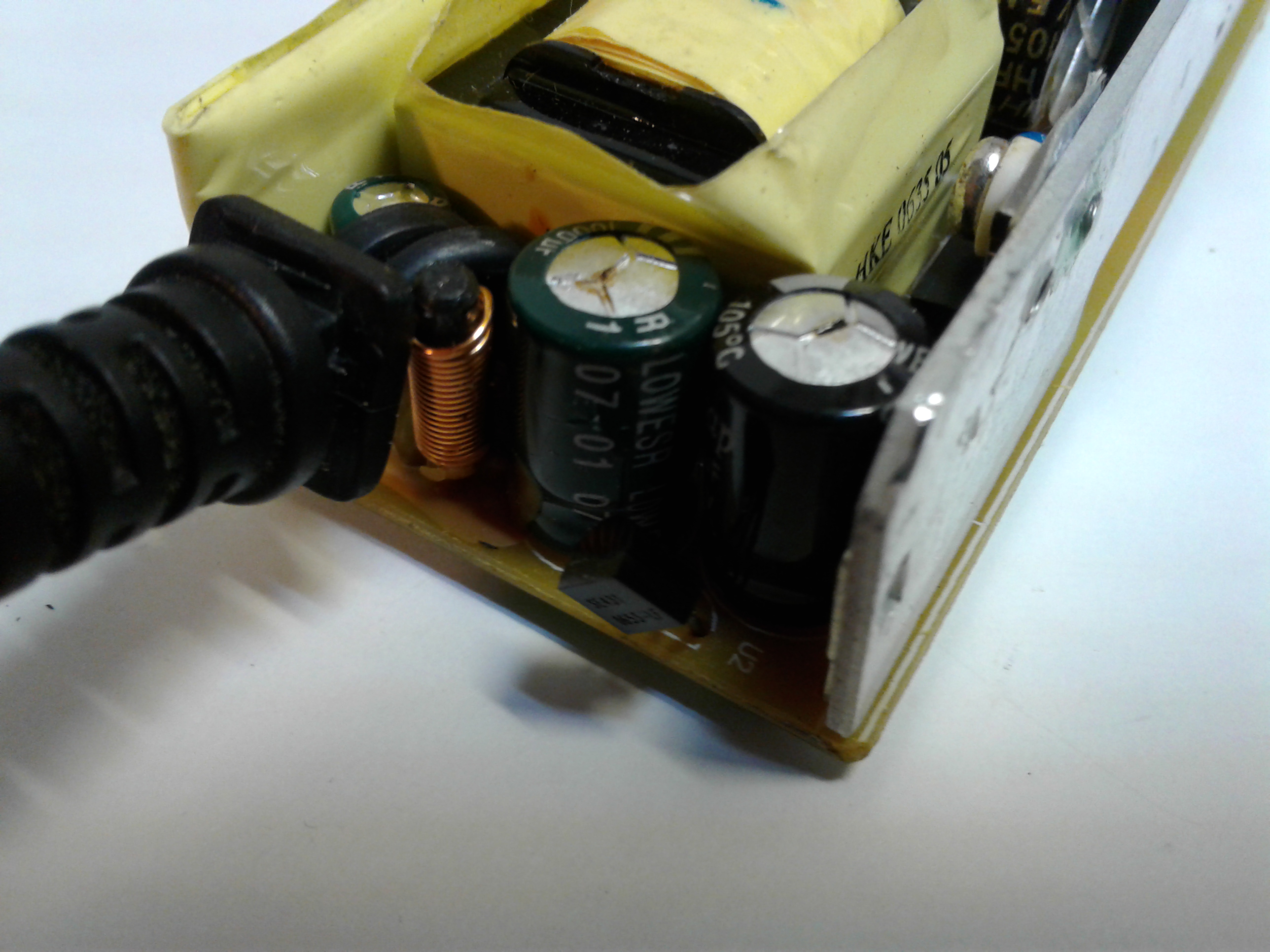

    Hello, i have a [i think] 10 year old power supply.
    This power supply has been waiting to be repaired for 8 years now.
    i opened it up to see what went wrong and i noticed that 2 1000uf 16V caps had vented and a 220uf 35v cap was on the verge of venting.
    Capacitors brand: suncap
    I had 2 power supply's of this kind but the other one was in WAY worse condition so i scrapped it.
    Now with this one removing the caps may be a bit tricky do to how everything is arranged inside and because there's this weird rubbery glue holding them down.
    Finding the right caps to replace the dead ones in here will be tricky too since the caps can only have a max diameter of 10mm and a max height of 15mm [if i want to get it back into it's original case.]
    If i was to guess why the cap failed in the first place i would say it was because of the capacitor plague.
    Here's a photo of the caps...
    Also the legs on the transistor in front of the caps look rusty.
    I'm not a expert, I'm just doing my best.

    I can not find 1000uf caps of the 10mmX15mm size.

      Rubycon YXJ series 16V 1000uf is a 10x16. Panasonic FR too cording to they pdf file...

        Thank you.
        The rubycon YXJ cap is smaller [and cheaper] then the UCC KYB cap i was looking at getting.
        Now i need to know what to get for the 220uf 16v cap.

            Same thing... Panasonic, Nichicon, Rubycon... plenty there. Just make sure you get a low ESR, high ripple current, 105C temp rating. Tons of them on Digikey.

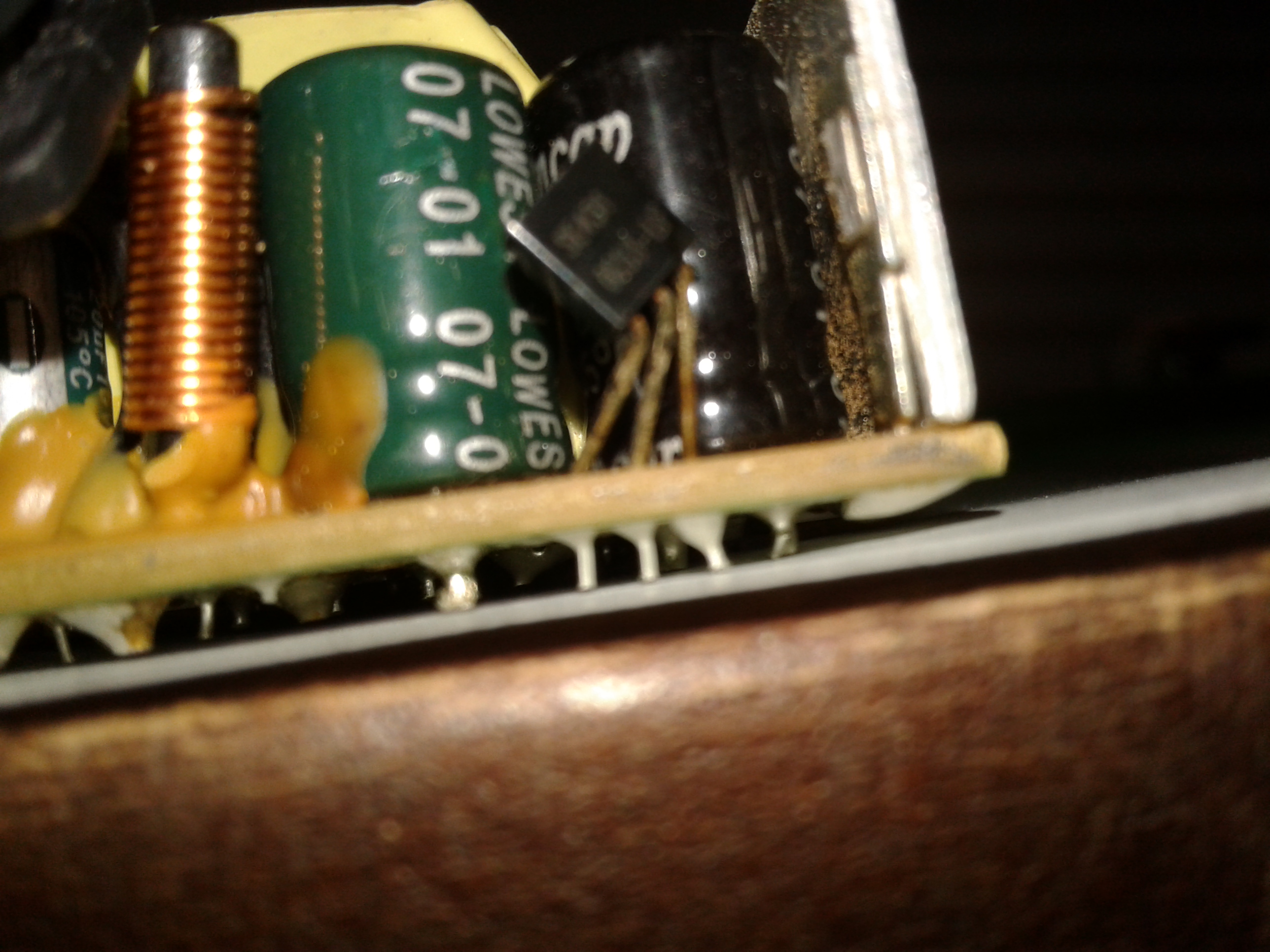

                Here's a picture of the transistor with the rusty looking legs

                  Not the Nichicon UVZ. Look at UPV, UPX... Keep the hour rating, temperature rating and ripple current in mind. Or again the Rubycons YXJ, or Panasonic FM / FR series...

                    what numbers on transistor ?
                      The numbers on the upper back of the transistor are...
                      SE431
                      The numbers on the lower back are...
                      0633-LF

                        Just gonna throw these out there: https://cdn.badcaps-static.com/pdfs/...2f69dce0c9.pdf
                        SamYoung NXR series. 10x16mm for 16v 1200uF.
                        I would've recommended KMF series, but they don't make them anymore, and the series that replaced them are high voltage only.
                        These are meant for power adapters like that and are rated for long life applications. I've seen these used in older Samsung adapters. Obviously they're not Rubycon or Pannys, but they'll do the job just as well.

                          431 is reference/regulator, it's in almost every device, if you feel it's bad just pull any 431 from something else and replace it

                            I don't trust samyoung caps to last long in a power supply.
                            And the HV input cap is in good condition and dose not need to be replaced.

                            Ok i have a few power supply boards i'm using for parts and the one i'm looking at has a '2431A' on in.

                              Seems like another such clone, from Astec most likely.
                              As for the cap, are you sure you won't squeeze D10x20 in there? There seems to be a few mm extra room from the pictures.

                                  The upper back [where the brand would be] says KIA in big letters.
                                  guessing that's the brand.
                                  And why i don't want to use 20mm tall caps was i wanted to fit the power supply back into it's original housing [which now i know is not possible.]

                                      If you don't have the room just use 1000/16 D10x16 caps. It's not like it won't work or so. After all, it was working for months or even years with failing caps with already smaller capacity. Some of the new series will most likely have much lower ESR so that may somewhat outweight the slightly smaller capacity.
